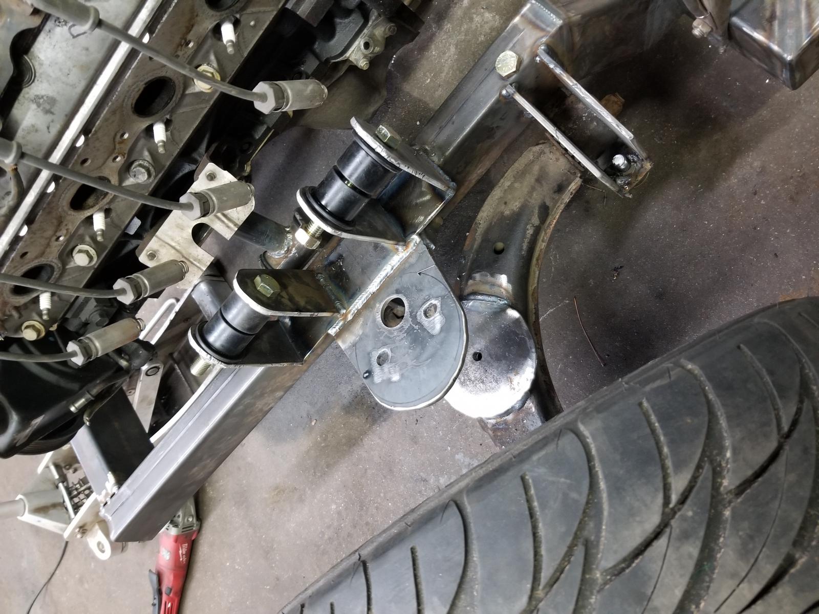

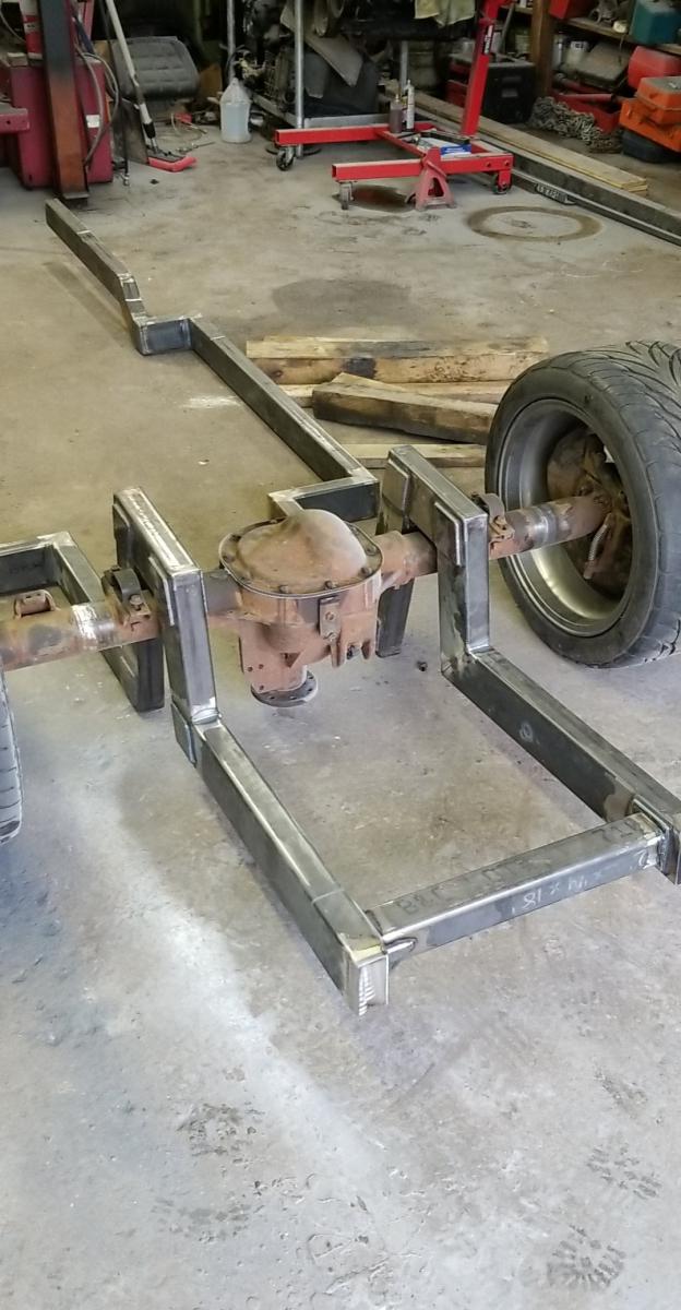

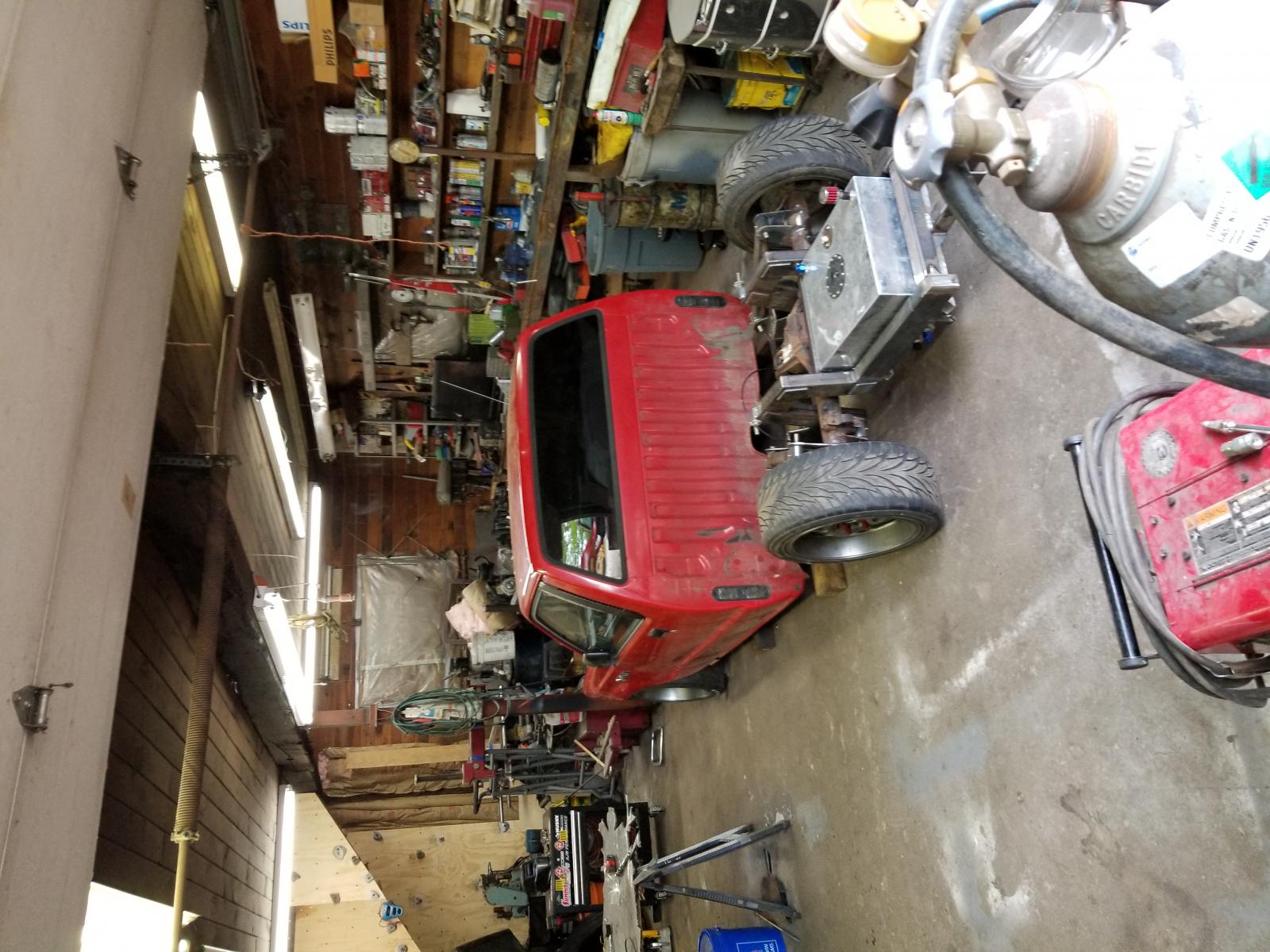

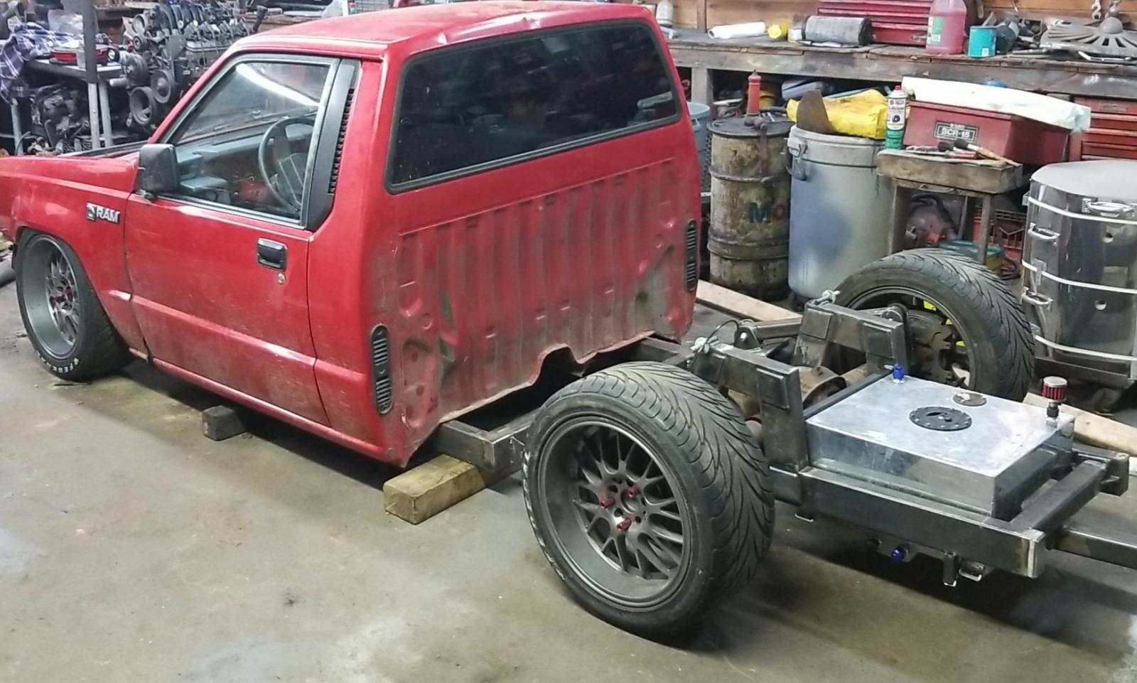

    Im still far from done with my project but i thought I would post a few pictures. Its an 89 ram 50 that originally cam with a 2.0 g63b. I built the frame from 4x2 square tubing, using a narrowed ford 8.8 rear end, 4 link suspension, slam specialties bags, 5.3 LS with a 7875 turbo and an AR5 transmission using a fabbot adapter kit

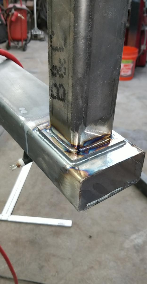

    A+ welding and fab skills - very nice I think the Mitsu cab suits the 'feel' of this build more than the S10 would. Nice wheels too!

    The truck has an interesting story behind it. My parents in law got the truck from someone who owed them money for plowing, after they received the truck it sat in their yard untouched for 13 years. They offered the truck to me and of course after loving mini trucks my whole life I took it home with me. I installed a weber carb, new headgasket, plugs, starter, and bunch of other stuff and got the truck running. After driving it for over a year I decided it needed more. The truck had 93hp when it was new, no power steering, no AC, no radio, and it rode terribly rough. The cab and bed where still in great shape but being in NH in salted roads the frame was starting to get tender and the motor was getting tired. So I decided it would be easiest to just start over than try to fix an old frame that might not last. and the LS... thatll solve the 93hp problem
    Thank you! the wheels are actually off my old subaru, Due to using subaru front hubs, and the ford 8.8 (5x114.3) they bolt right up!

    Got some more done on the front end. Hoping to have the cab on by next weekend

    Got sick of tigging everything, going to mig together the rest of the front end, just have to build my upper control arms and it will be done
