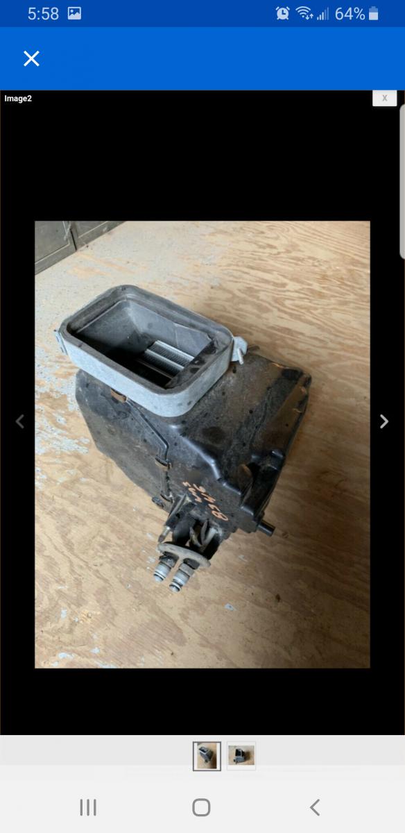

    Good news! I contacted a few people on Ebay parting out ram 50's and was able to buy a complete evaporator and enclosure! Looks to have the style fittings as my big condenser I bought, and the adapter fittings for the GM ac compressor

    08-29-2016
    225
    Siskiyou County, CA
    cool. make sure you get the condensate drain hose and grommet for it too so it can drain properly and the dash button, clutch relay, and the harness to connect it all together unless you are doing a custom dash or something.
