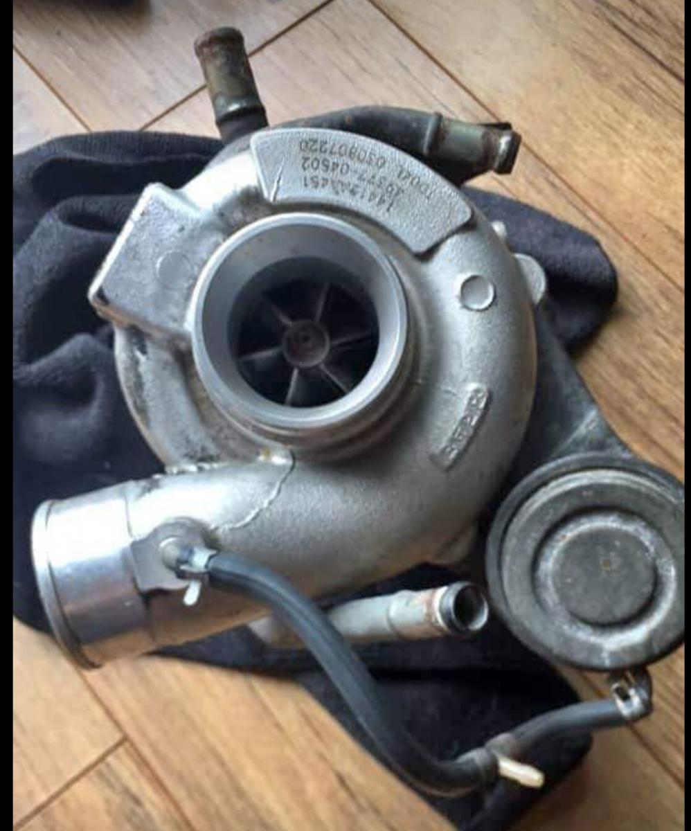

  12. #62
    Bargain. This will change the game in your favour
  13. #63
    06-27-2015
    424
    Bothwell,Ontario
    Dodge V8
    I jumped on it...
    Now I have a blower and a turbo..LOL
    Now to keep gathering parts.
    I have heard the stock ECM can handle up to 6 psi? Is this true?

    I certainly don't want to melt down so I will wait until I have the correct electronics. You wouldn't want too much boost without changing the gap in the rings anyways. I was just thinking of starting at 6PSI. I do have to figure out how to adjust the wastegate since it is done by a vacuum canister.
    I found a Neon SRT intercooler for $100 so I think I will pick that up.
    There is a 19t upgrade for this turbo also..
    Baby steps.... I still have to make an exhaust manifold... or.... mount the turbo under the bed

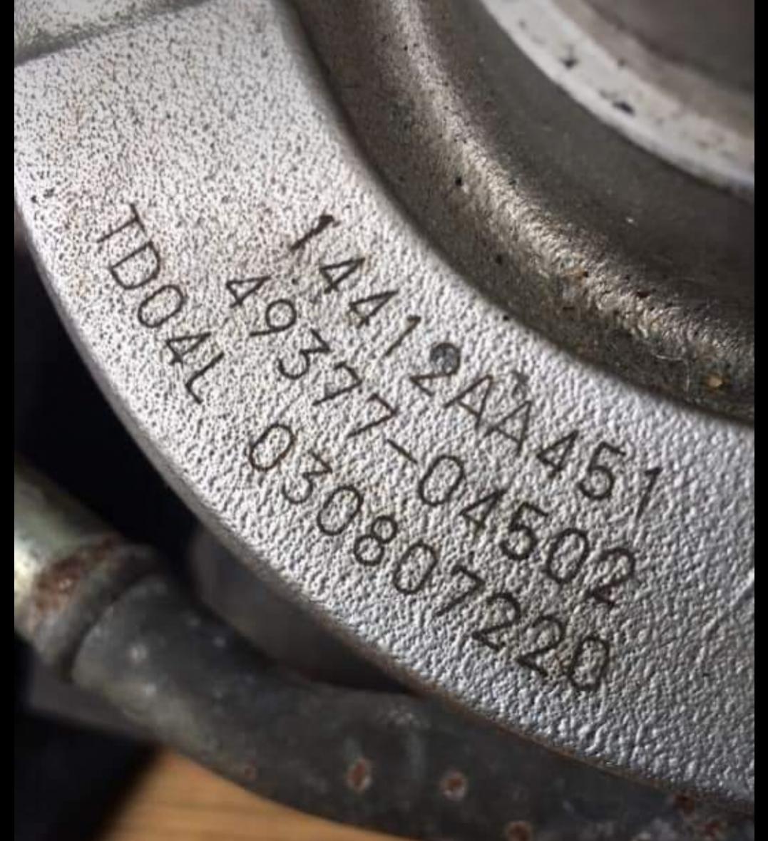

    td04 is small. Subaru? Volvo? Always get a turbo from an application with much bigger displacement
    U plan running blower also? Need an even bigger turbo still. Heat from blower + restrictive turbine... smells like cracked pistons
    twincharging only successful if components sized properly. HUGE challenge will be blower-to-turbo transition
    A handful of supercharged 1.6 toyotas pulled it off. Stock SC12 blower + big ol T04 turbo to pick up where the SC ran out of puff
    Work so well, torque curve had zero downsides..... mashed in the seat from off idle to 7500rpm... all from a puny 1.6
    Very complicated endeavor tho. You must love doing things the hardest way

    This is a subaru turbo. If is probably a little small. There is a 19t upgrade for it. Now.. I'm not looking to make a tire smoker. If I ran 14.90's I would be happy.
    According to some math, I need 150 hp to the back wheels to run 15.00. At 19.20 I made 70 hp at the rear wheels.
    I would need to double it. Not sure if boost and fuel can make that must of a difference without super high boost levels. I would really like to stay under 10 psi with the stock pistons. Stock, the wastegate on my turbo is set to 8 psi.
    I have talked to a cam grinder in Australia that has a few grind profiles he could put on my 2.4 litre cam but I would have to ship it around the world for that.
