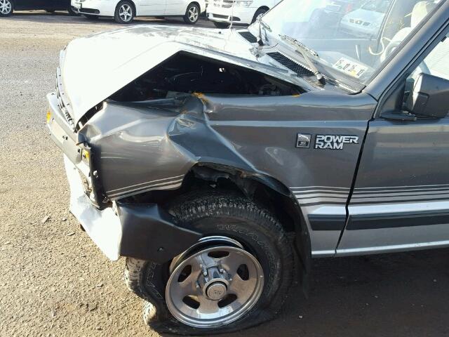

    Quote Originally Posted by Chargerx3 View Post
    You might be onto something. Wow, that low of miles, that's a keeper. Was the damage to the vehicle pretty bad?
    It was not nothing, but not too bad either. But I guess the cost of repair was more than what the insurance company wanted to pay.
    The left fender, hood, front bumper, wheel, and grille were all replaced. No damage inside the engine bay, or to the frame. I finally had the frame checked at a proper frame shop and got an alignment, they said it was straight and not compromised. It drives straight.
