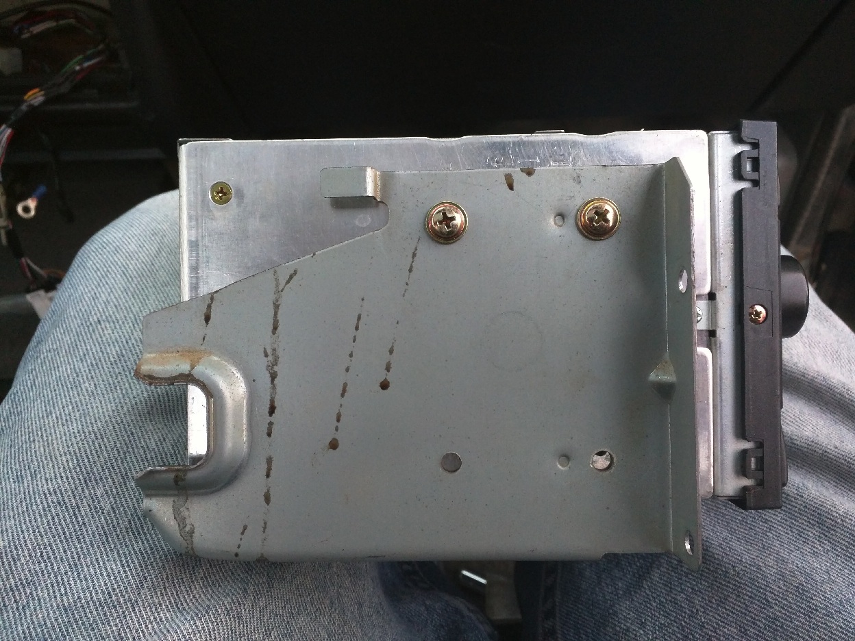

    On the 2nd gen, the radio mount is pretty basic. Just 4 holes in the plastic dash fascia. It's not very sturdy. The factory mounting brackets are what really gives it structure. The brackets also tie into the metal frame that the plastic dash fascia attaches to.
    Let me know if you need a template for the factory brackets. A very generous friend hooked me up with some OEM brackets. I can pull them back out and make some cardboard templates or something.

    I had to pull the radio to fix a problem with my heater controls, so I took a couple pics while it was out. Hopefully it helps.
    It's odd that I'm using OEM brackets with an OEM 93 3000GT radio, but only two of the holes line up. Mitsubishi stuff is pretty standard from 1990 until ~2004 when they started going to the model specific faceplate garbage along with most of the other OEMs.

    3000GT brackets are a similar shape, but they won't work. They flanges aren't wide enough on the front where the screws go.
    I'd be careful with the Galant brackets. The plastic dash is carrying the whole weight of the radio. The notch in the rear of the factory brackets slides over a metal frame further back in the dash. That helps to carry the weight of the radio and reduces the fatigue on the plastic.
