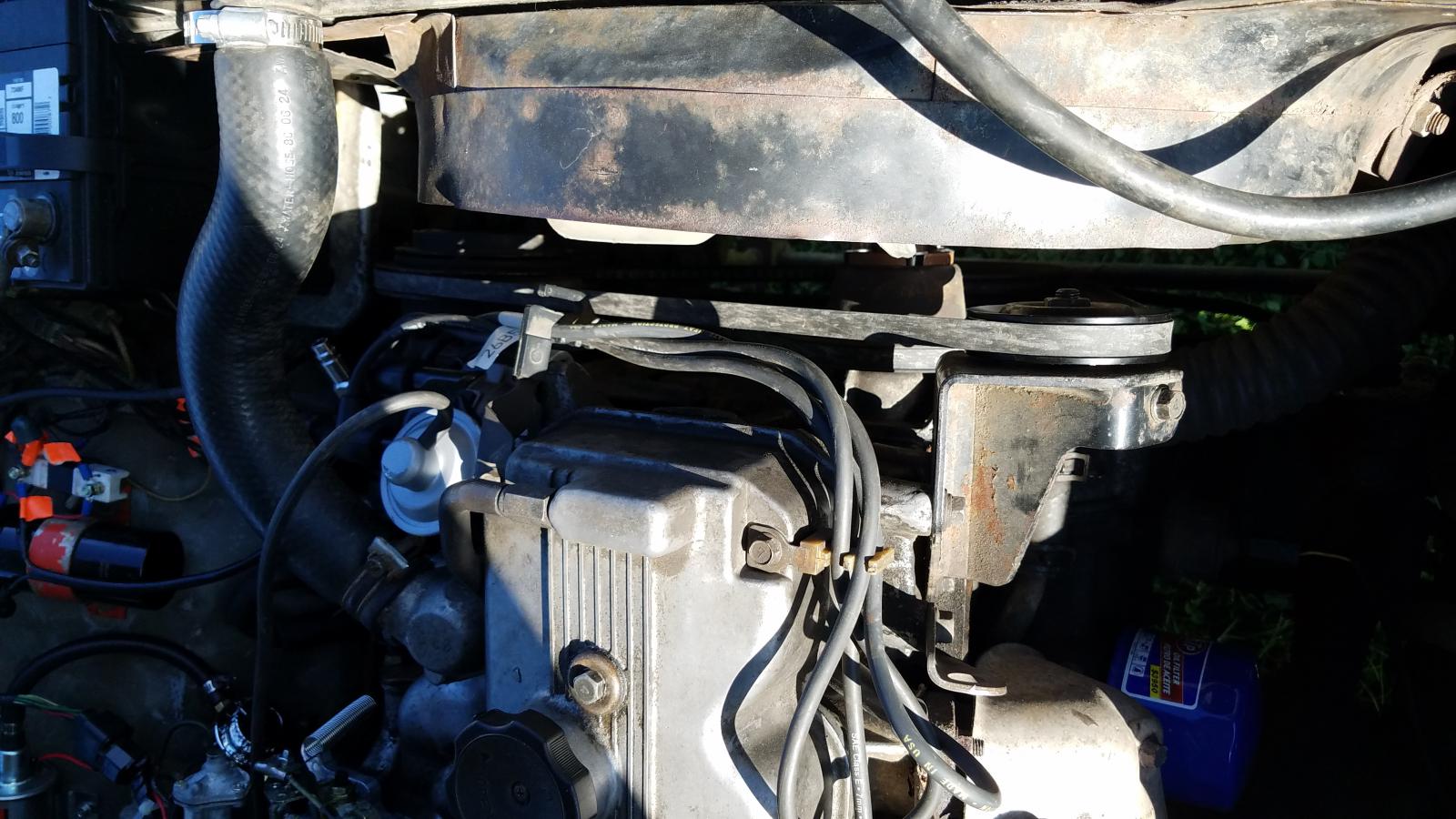

    Installed new idler pulley for a/c. PO said that's all that was wrong and so far it's been true. For 80* out it cooled it down quite nicely.
    04-08-2018
    212
    Hurricane wv
    1987 Mitsubishi Mighty Max
    Whoa, that's a big belt set up for A/C. Never seen it routed like that before!
    That is the way Geronimo's was also - it runs in front of the other belts and requires an additional pulley on the crank. Starquests have them as part of the crank pulley, the trucks were a bolt on.

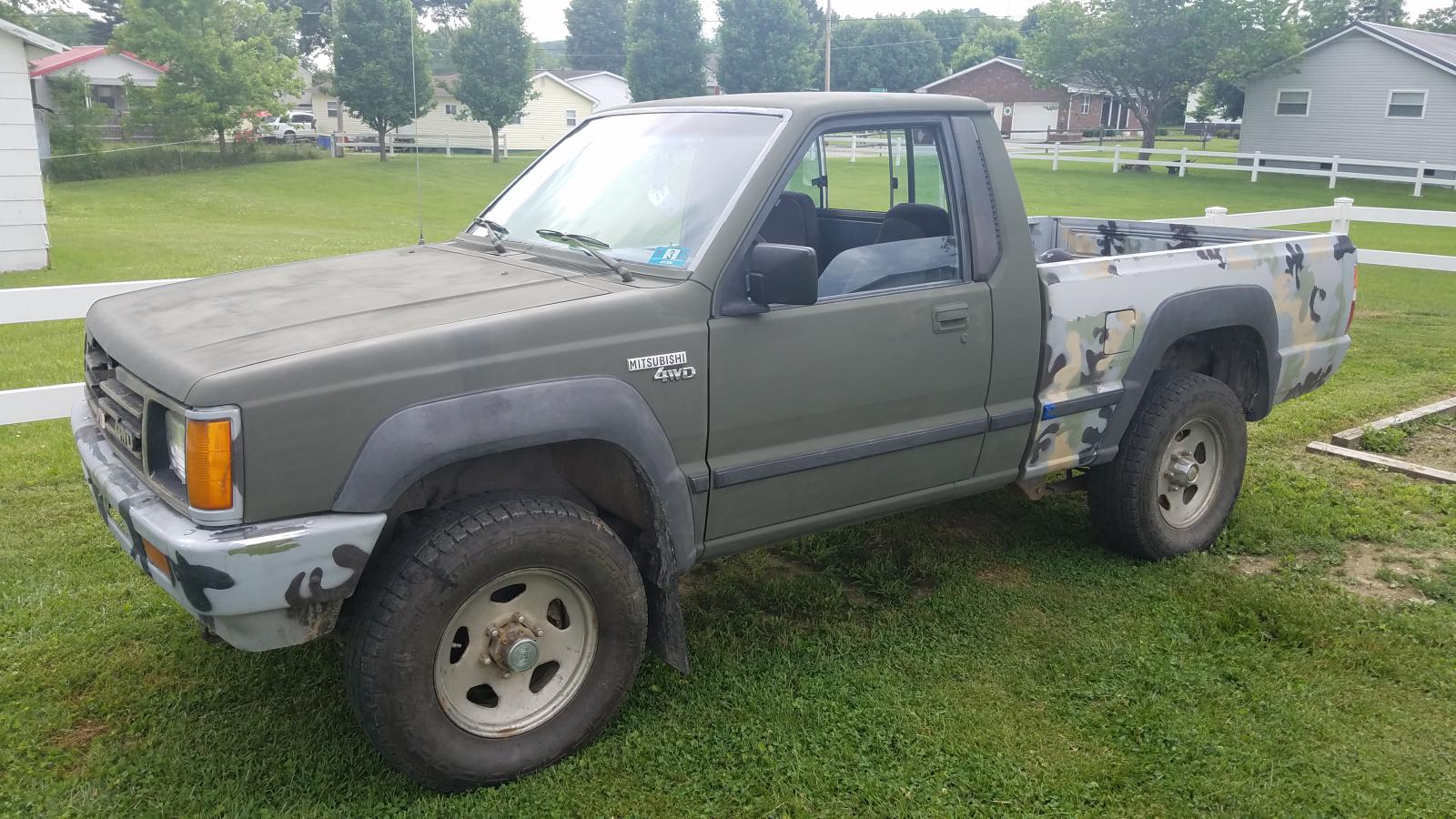

    Poor boy paint job is half way done.

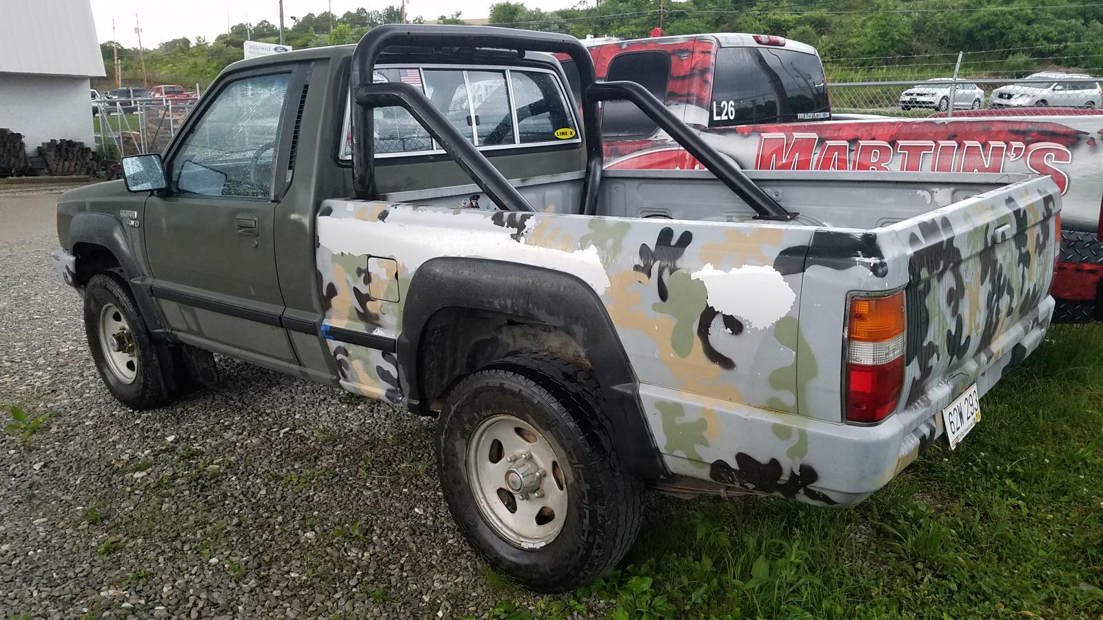

    Picked up a cheap roll bar for looks.
    If you are ever unfortunate enough to end up on your lid, you'll soon realise that bar is worth every cent. I want one for my Gen1 as the turret on the cab has all the structural integrity of a chinese take away box. You got a rear slider window too? The 'junker' is shaping up nicely - very cool

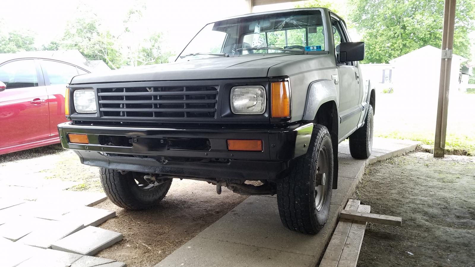

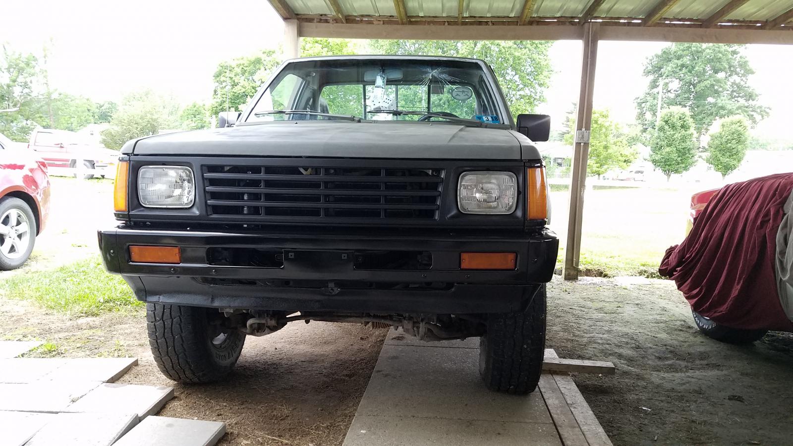

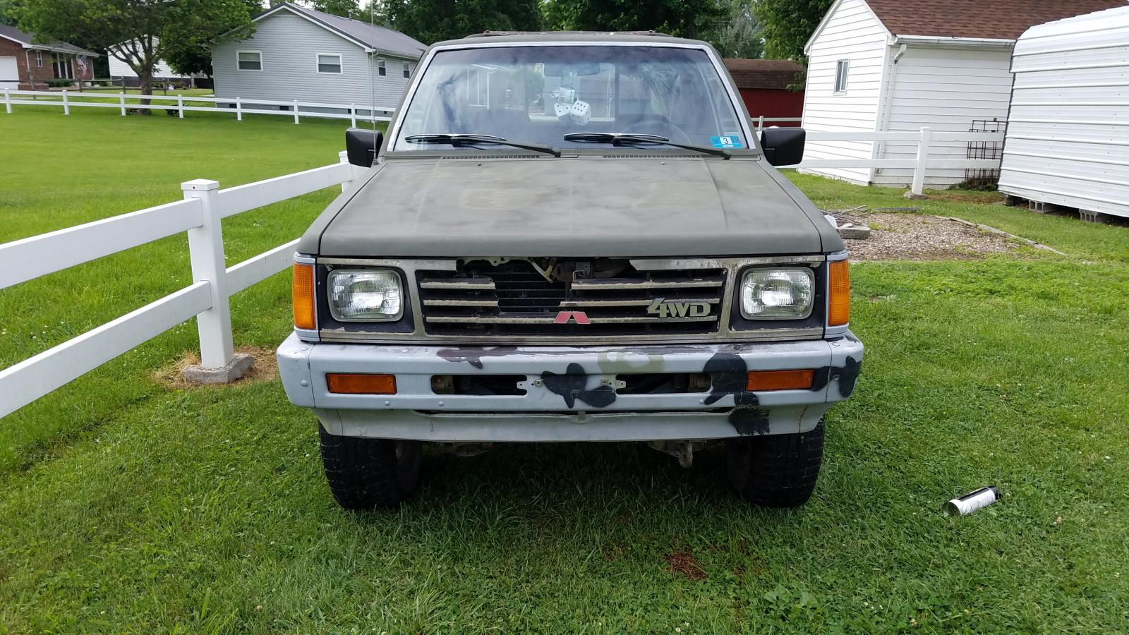

    Before new grill and some paint.

    After paint and new grill. I wish the old 4wd emblem would come off but I don't wanna break it.
    1,267
    Perhaps you could carefully cut it out and sand down the rough edges, then find a way to mount it.
    That's sort of what I did with my Ram emblem, except I used a belt sander to bevel it.
    My Mitsubishi emblem is toast. But the 4wd has a screw that won't budge and is trying to strip out. I'm gonna let it soak a few days and see if I can get it. Most likely I'm gonna break it.
    Get some locking pliers onto the head of the screw, it should come undone easy as it's only threaded into plastic.

    Did a little cosmetic work this evening.
