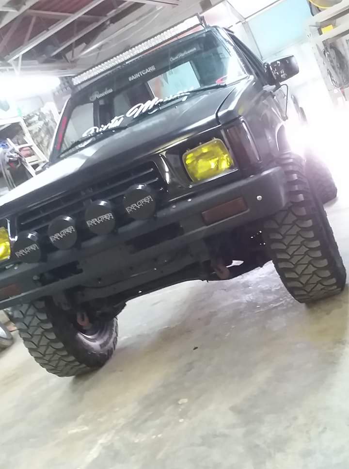

    Hey there got a 91 mighty that I'm trying to lift alittle. It rides kind of rough because my torsion keys are maxed out but it didn't really gain any lift maybe half an inch on both sides. Would you suggest removing the sway bar? Let me know!! Got procomp es9000 shocks in the front.
