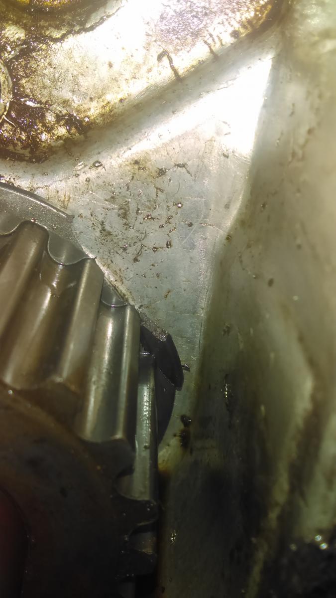

    It has a key slot on it. Do not use a puller it has a plate on the back of it. What I did was use a flat head screw driver and lightly pry it off. I'll post pictures of we're I failed and you can learn. These trucks and motors are very tempermental if you haven't noticed. Plus once you change this seal your gonna have to replace it Everytime you replace the timing belt. It will leak. I always get the best seal for the money. Also when you install it make sure it is flush with the block lightly tap it with a hammer. It is kinda tricky. If you have any other questions I can help or pm me! IMAG0038.jpgIMAG0037.jpg
