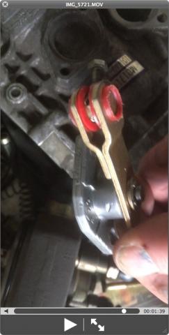

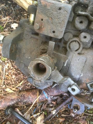

    Mine is a pump from the 85(I think was actually built in 84) DieselKiki (before zexel) pump that I had rebuilt at Diesel Injection Service in portland. The only cold weather provision is a high idle pull cable. Rudimentary as heck.

    Actually now I'm curious about my pump.
    The head from my 4d55 has the larger injectors than my 4d56 head. And I have a tc05-10a turbo, which I understood were on earlier. When I took my pump to be rebuilt they ran the numbers and said it looked like it was originally an N\A motor's pump with a turbo top half(diaphragm and such) put on. So they rebuilt the pump and set it up according to turbo specs. Anyone know a good place to run the numbers off pumps?
    If it looked like it had a timing advance function but also accomplished a fast idle at the same time. This is a diesel kiki from early 80s and is probably more desirable then the wax motor apparatus, or even the VW piston direct mechanism I'm trying to build

    The 83 model injection pumps were made by Zexel, and the 84 and newer pumps were made by Diesel Kiki. They are identical except for the AFC on the top of the pump. The 83 ones had a screw on the top that allows for easier adjustment of the AFC, which is what controls how much more fuel is delivered based on boost. The diesel kiki pumps can be adjusted as well, it just takes removing the cap off of the AFC. Otherwise the pumps are the same. Cam plates are the same, head/plunger size is the same, and so on. Depending on the year the castings of the pump cases may be different depending on if there were some pump mounted accessories available, but that's about it.

    There certainly is, Dancingecko. Ah, yes. The Mazda pump without boost reference (though with aneroid) will be unique. I wondered if the big injectors in the early Mitsubishi were the same body style as my Mazda s2 because, well, they are bigger too. I've gained some familiarity with nozzle options for these.
    THanks for the suggestion I'll see if those numbers can be found online. believe it or not the little crush and shoulder washers are easier for me to find.
    Another difference in configuration on the older diesel kiki is the cable actuated cold start advance/high idle mechanism:
    I've seen the two styles of the pump tops and wondered. but what is it about the '83 pump size that makes it desirable by some? Bigger, plunger/head?
