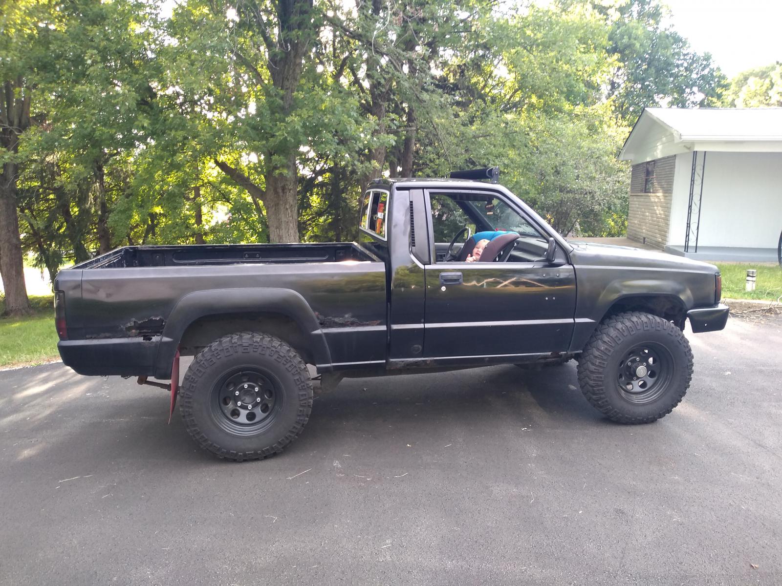

    I have 16 inch procomp steel wheels and 31 inch Mickey thompsons with 1/4 inch spacers it sits nice
    bolt pattern is 6 x 5.5 (139.7 mm) with a 108 MM center hole - the center hole is critical for the rim to fit flat on the hubs.
