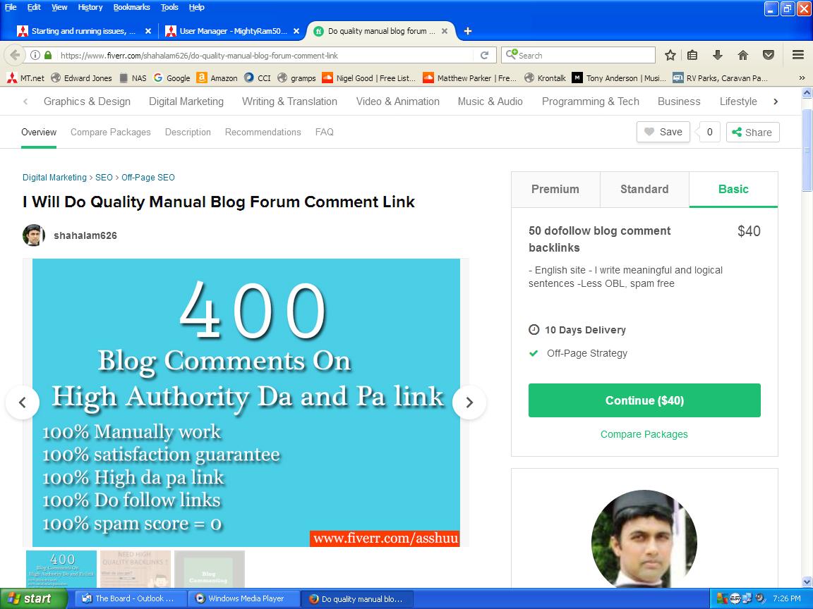

    A big thank you to SubGothius for spotting the spammer. Upgrade given.
    Spammer gone. It has been a long time since someone actually posted.
    It was a guy from fiver. com that was paid to post crap.
    He was out of Bangladesh.
    So another Bangladeshie is out of a job. HAHAHAH.
