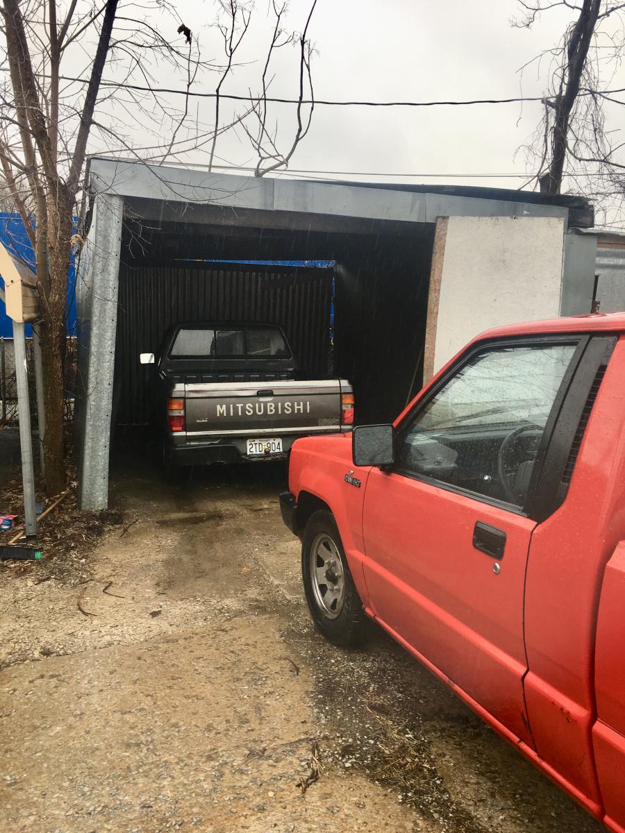

    I'm lucky to have two problem childs! Red one is my main driver. Starts but won't run good in wet weather. Dies at stoplights unless I hold brake and rev. Starts and runs great in dry weather. New cap+rotor, wires, plugs... mechanic said they cleaned the mass airflow sensor... is that even a component of this truck? 91 Ram50 4G64.
    Gray one started good and died 12 times as I drove it across town. Had to keep it revved. Now it's parked across town cuz after sitting over there a few hours it decided to click but not start anymore. Has new battery. Don't know much else about it b/c I just bought it. I wiggled all the wires a bunch to try to get it to start up again but no dice.

    I went over to tow it home but of course it started right up and drove the 4.5 miles home without even dying once! It's kind of a junker really- I'm thinking of parting it out. Glad to just have it back home in the driveway! Thanks for the help y'all! I'll post up the exact engine and components here first for those who would like parts.
