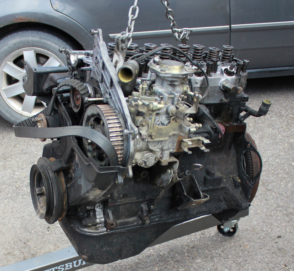

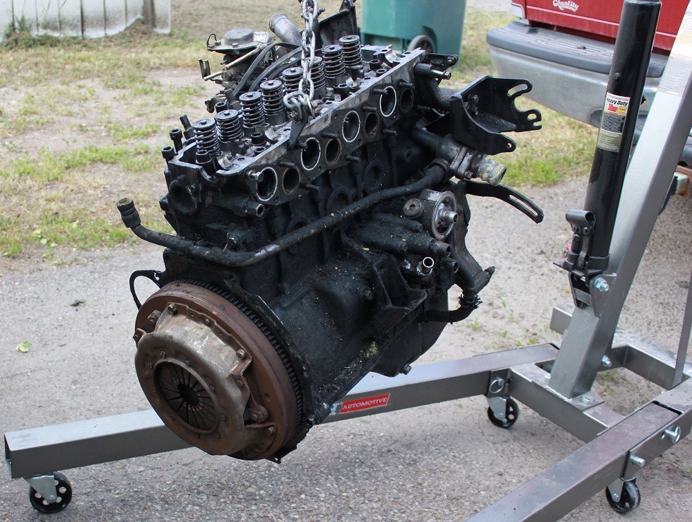

    Got the engine pulled. Disassembling it fully now. Think i'm going to upgrade to the 4d56, so i'm really just parting this one out.
    Turns out the belt for the balance shafts was shredded completely. Everything else seems fine. Knocking the pistons out slowly as they were very well seized in there. I think I was supposed to pull the transmission out with it as nothing is really holding it in there right now. I put it on a stand so it wouldn't bend something that shouldn't be bent. I'll try and dig it out in a bit, might aswell give it a once over while i have everything gutted.

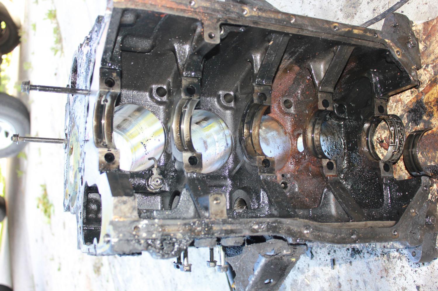

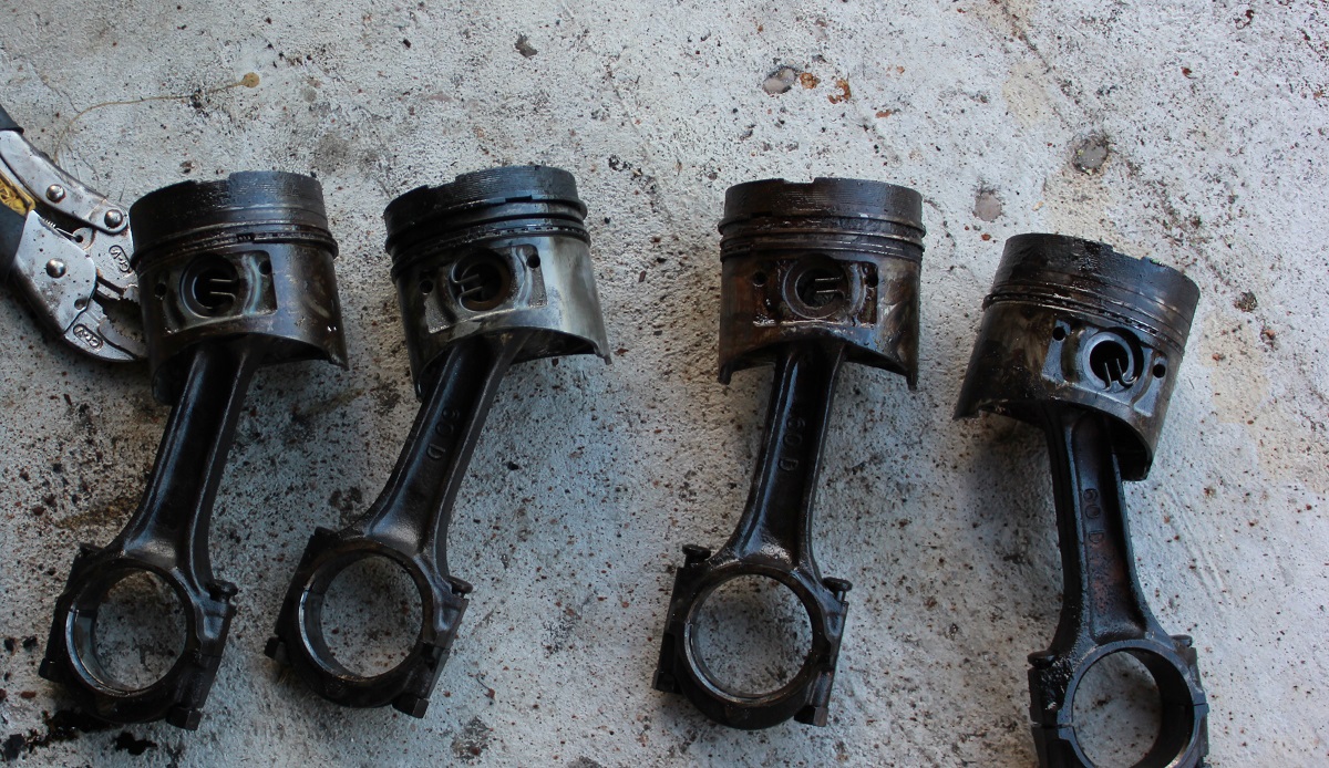

    Flywheel should just be the six bolts holding it on to the crank, you'll have to take the clutch/pressure plate off first to get to it. May be a little rusted on so it might need a little convincing with a pry bar to get it off. Pistons do come out the top, just pull the oil pan and unbolt the connecting rods from the crank. DO NOT TRY TO FORCE THEM OUT THE BOTTOM! There are oil squirters that spray the underside of each piston, if you try and push the pistons out the bottom without removing them they will bend and get broken

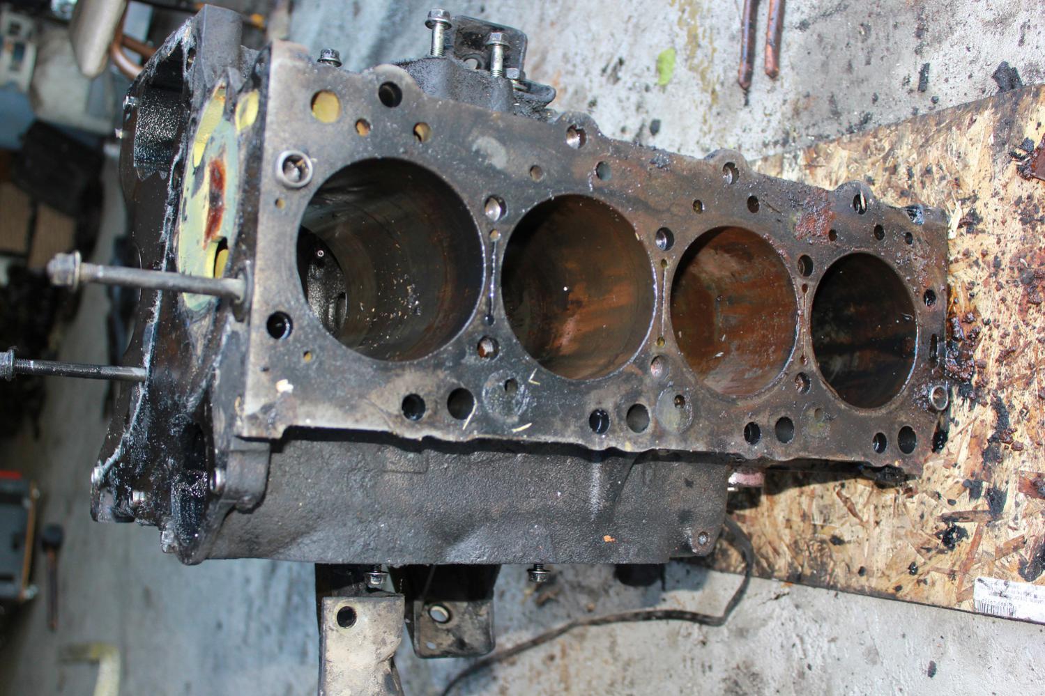

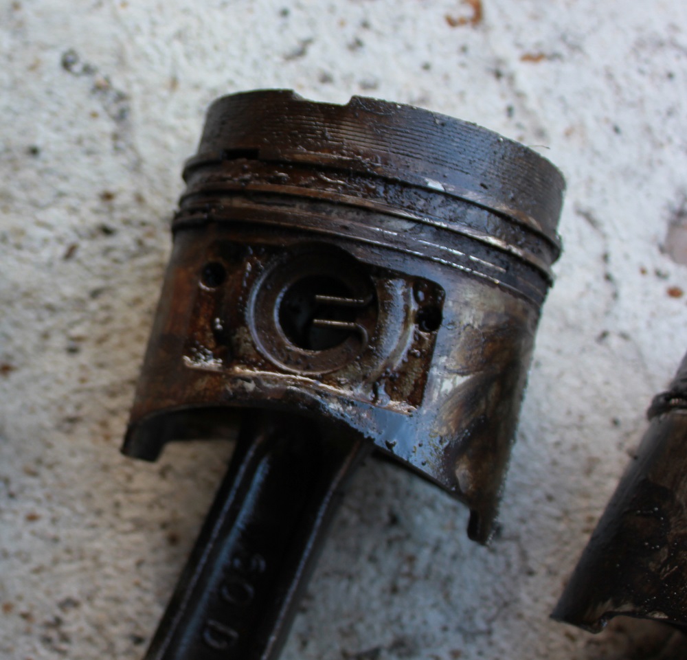

    Got it. Flywheel came off pretty easily. Nice groove worn into the fingers, plate itself didn't seem too bad, but well worn for sure. Taking off the rear engine plate for the crankshaft I noticed a very large amount of blue snot. I don't think i was the first one in here. It looked like RTV sealant. Nevertheless i got it off and the crankshaft out and i spent a few hours wailing on the pistons to get them out. The first one came out without much issue after I could get a direct blow on it. The rest took some time. Piston 3 in particular took an even bigger hammer and zero regard about damaging it. Time to start degreasing and cleaning everything to see what can be salvaged. Are the cylinder walls something that can be replaced at a home shop relatively easily or would it be best to find a place locally that can replace them?
    Need to pull out the transmission next to see how bad it is. Might know someone that knows someone really good at rebuilding them, might try and work something out with them to give it a clean bill of health.

    Oh yea. For future reference the pistons actually can't go out the bottom. I removed the oil sprayer and started pounding it down, but the walls that support the crankshaft are actually larger than the piston hole and physically prevent downward movement past them. So back up it went.

    These are a dry sleeve motor, so the cylinder liners can be pressed out, but it takes some work and a tool to catch the bottom of the sleeves without catching the block. The new liners just press right in, can be done with a regular hydraulic bench press if you're careful.
