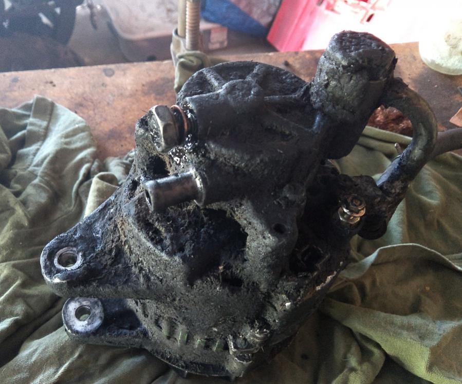

    I went ahead of pulled the alternator for cleaning since i was right there anyway. It seems i have a melted wire. Whatever the solid yellow one is was just blowing in the breeze. the rest looked fine. Took the oil pump (I think thats what bolted to the back anyway) and it looks fine but extremely dirty. The alternator itself might be near end of life. The brush barely has anything left and it looks like it doesn't make full contact anymore, the rotary bit itself is fairly rusty. Havn't figure out how to pull the coils out yet, I unscrewed everything but its either stuck in the back or I'm missing a fastener somewhere. Whole casing is coated in gunk, if this still works I will be extremely surprised, it should of died of heat.

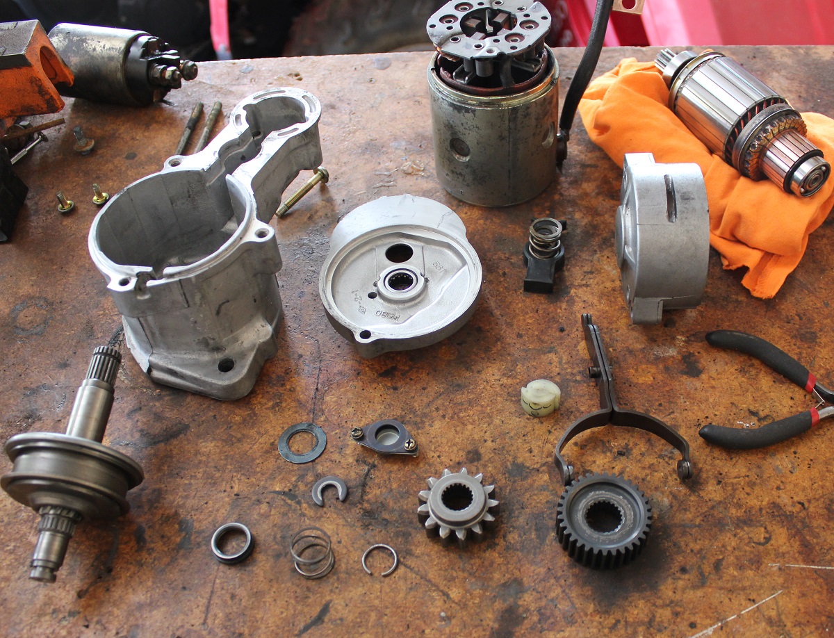

    Got the starter motor off, Used a 3foot long extension and a wobble socket for an impact wrench. lifted the front up and just carefully ratcheted away.
    For anyone who follows this: Leave the bottom bolt in when you go after the top (hard) one. The whole unit and bolt will flop around hopelessly without the bottom to anchor it, and the bottom comes out much much easier.
    Cleaned all the internals, cleaned the connectors and regreased the gears. Also managed to reassemble it in the proper order, though i couldn't get that ring to pop into the collar. Its kinda half out half in right now, won't pop out unless i pry it, but it seemed impossible to get it in the collar and in the grove on the pinion at the same time. I had the bright idea to pop it into the collar first and it was pretty much stuck there until i bashed it out with a socket. I assume this needs a special tool.
    Anyway hook the motor up to a battery and after a few attempts it started to spin and jump around. On a whim i put the solenoid back on and it decided to play ball this time. Not sure if the contacts are just bad and it was the old hammer trick to get it to work or what. I'll see what happens in the coming days, might get one on order just in case anyway. Time to put it back together and see if it fires up now.

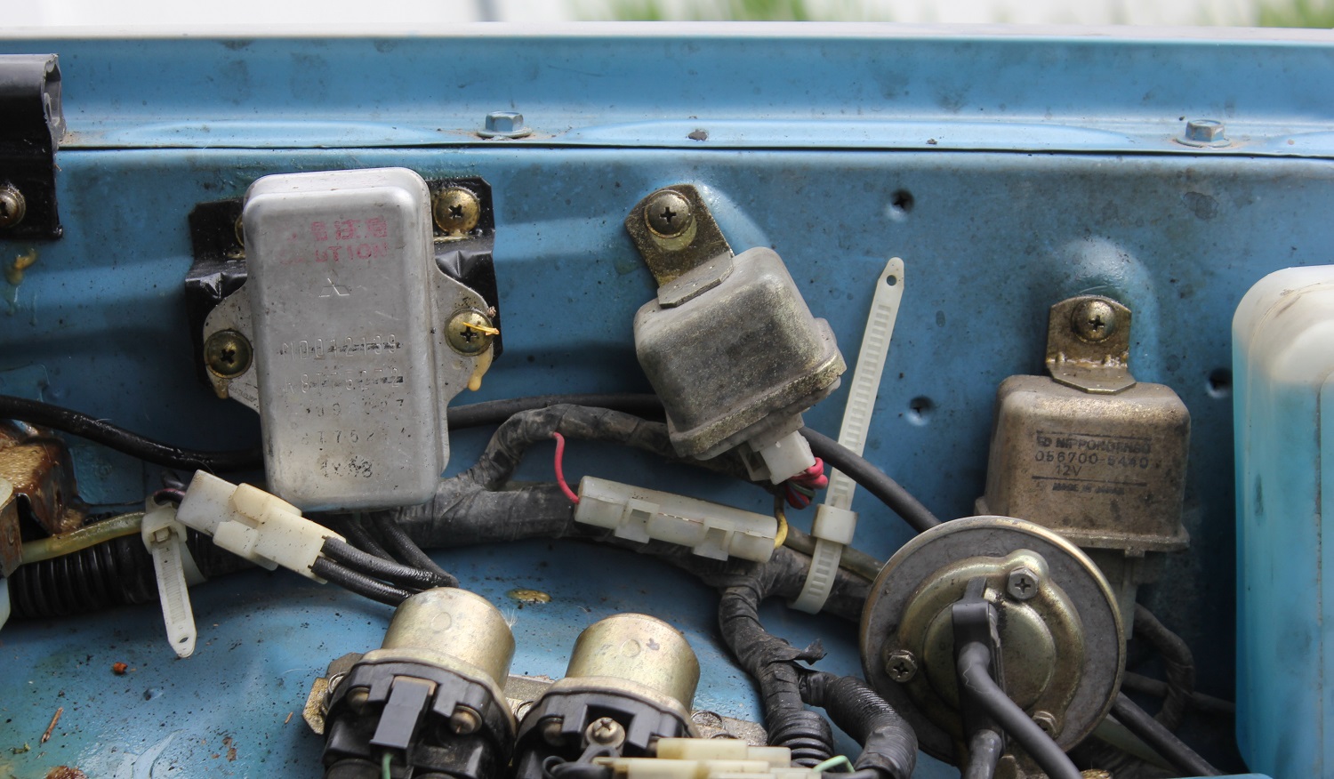

    Fyi,these trucks have a starter relay on the drivers side fender well.
    10-29-2014
    1,261
    Earth, the Solar System
    I found out the hard way that there are two different starters for these. if you or the previous owner installed a rebuilt it may be one with the kickout of the starter gear is too short for flywheel contact.

    Hmm. I have two relays that i can't identify as the part numbers have worn off and there is no mention of these in the manual i've been using. Any idea what one it is? How do you properly test a relay?

    I think i have identified the two relays as the starter relay on the right, and the Tail Light relay in the center. Part number 056700-5440 and 056700-3060.
    I took apart the relay. (Good old times when things were made to be fixed!) and cleaned the contacts. I test the coil with a meter and i was able to physically test the unit by applying power to the leads and testing the circuit. It all seemed to work fine. Reinstalled and no change to the motor, The starter still won't turn on.

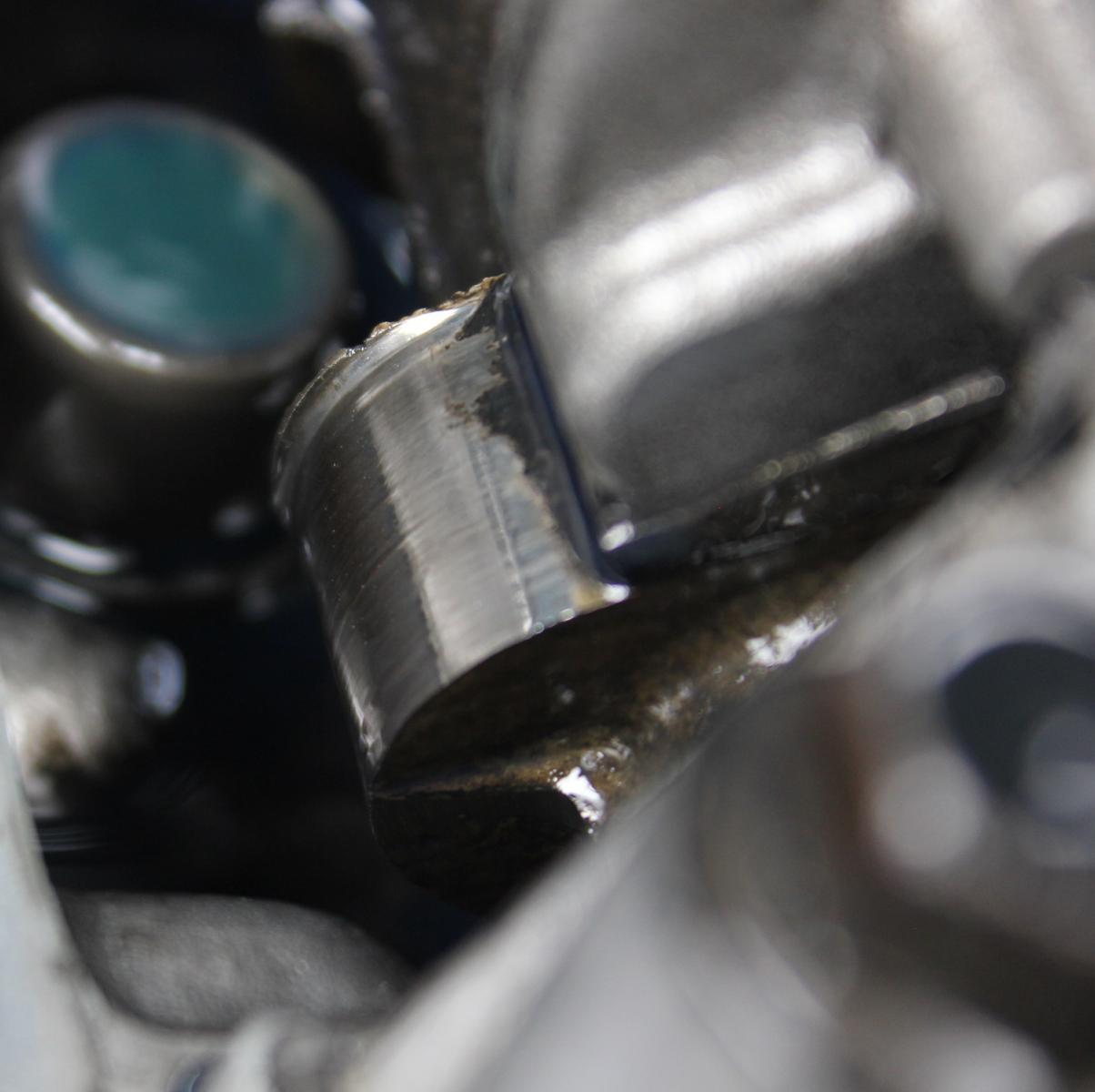

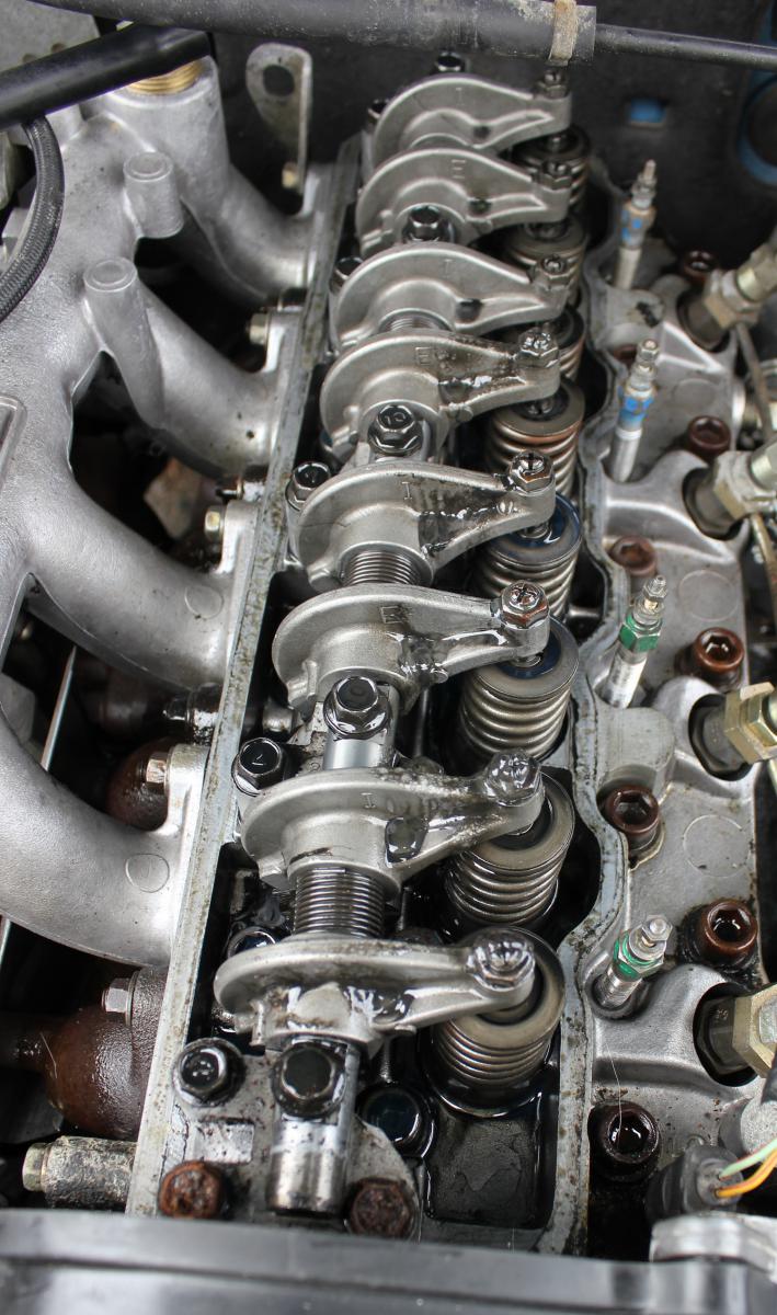

    Alright pulled the rocker cover off. I'll dig in deeper once i figure out what bolts are bolting what down. But heres the photos.
    Nothing looks absirdly off. There is water under this cover though. almost looks like condensation. I'll leave the cover off for a bit so it can hopefully evaporate. Most of the oil in this is from when I change it and added the full amount as per the manual. Will probably have to strain this oil after i get this fixed, but hopefully it won't be in vain if it all helps it get loose again.
    The front two bolts holding the (camshaft?) shaft in are severly rusted, everything else looks fine.
    I have also noticed some pretty heavy wear on some of the lobes. Is this normal wear or signs of abuse and in need of replacement?
    Any cam that has worn like that is dead. Looks like you are in need of valvetrain replacements.

    Aye. Pulled it out. the rockers look fine, but they'll get replaced also i suppose. Trying to pull the head off now. Its like a puzzle trying to find what comes off first. Right now I'm trying to pull the turbo off so I can pull the exhaust manifold off. so i can get the head off.
    I have been labeling everything and putting bolts back in their holes when possible. Definitively the way to go. Thus far all of the bolts came off without much complaint. I hope this is a good sign for things to come. Slight burnt smell as i'm tearing into this has me worried about whats under the head, I'm wondering if i should pull the pan off first as I now expect there to be a mountain of sludge gumming up the works.

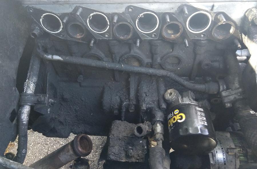

    That little thing on the back of the alternator is your vacuum pump. And just wow, that is a nasty engine. Cleaning it will make your life a whole lot nicer when it comes time for working on it.

    Vaccum pump? How does it work? One side was coming out of the engine block below the oil filter, the other line went to the turbo. I thought for certain it was the oiler for the shaft. The manual i've been using it for the non-turbo version of course and doesn't list it. Isn't the vacuum pump the giant tank on the right in front of the driver side firewall?
    I gotta say, that has to be the filthiest engine I've seen. All that crap in the back of the alternator would roast it due to lack of air flow. I'm not a diesel guru (in fact I'm an ignoramus...) but the pump on the back of the alternator is what generates braking vacuum for the master cylinder, so it will need a reserve tank so there's a vacuum source available during high demand or an engine shut down (my semi-educated guess)

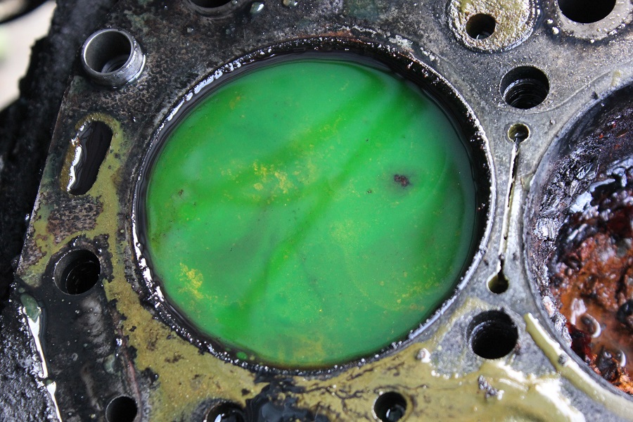

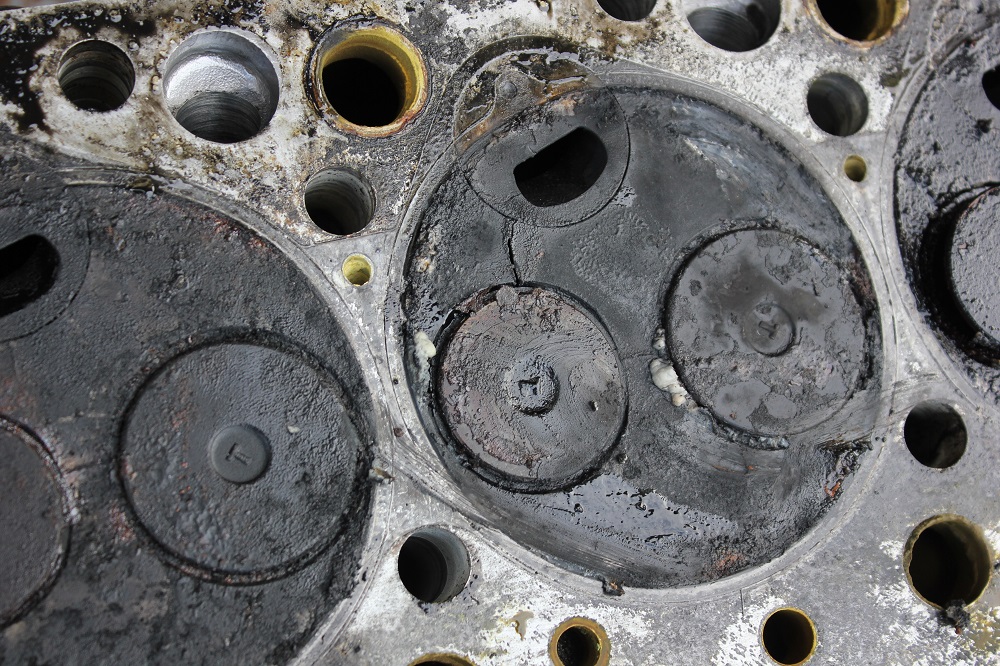

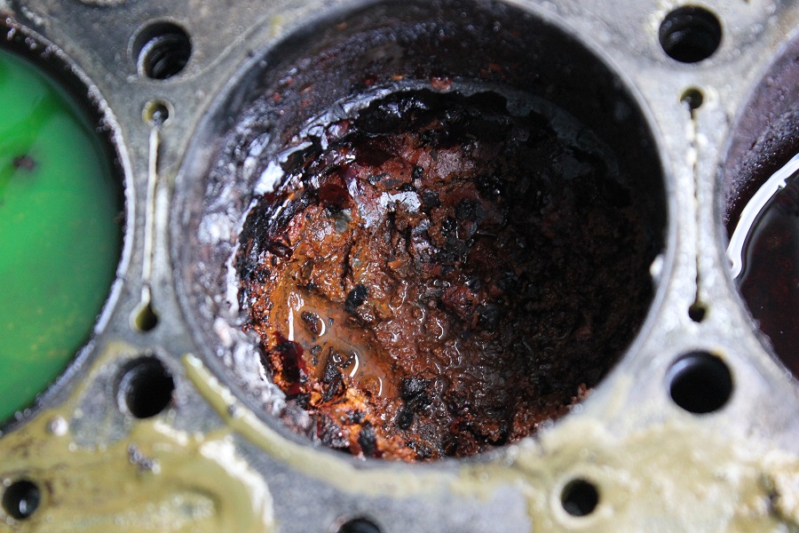

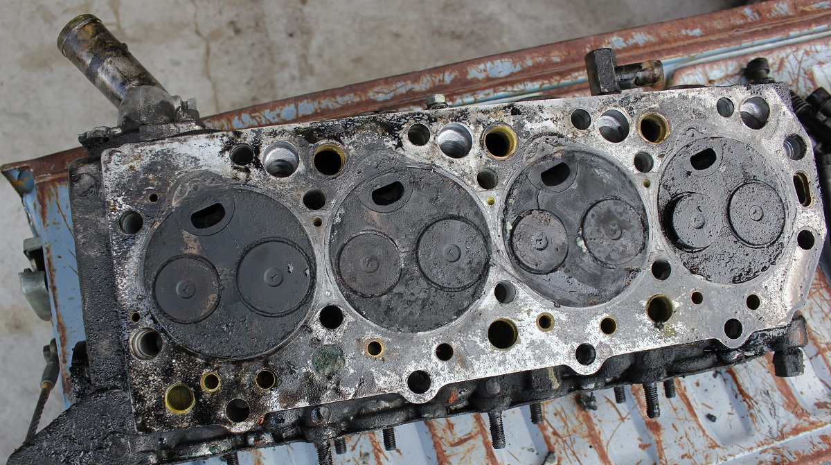

    Well. I found the problem. Its safe to say this whole project was a waste of time.
    The head is cracked. the gasket was apparently blown because piston 4 is full of coolant, and piston 3 is full of chili.
    I read that the block should have sleeved cylinders, which might make this salvageable. but honestly i feel like i should just start parting it out. I'll have to look at pick and pulls farther away if I have any hope of getting workign parts for this. I don't have the cash right now for a korean 4d56 right now.
