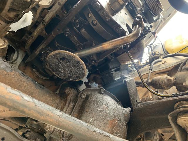

    The truck’s running well after some major work, to me anyway. The truck was smoking badly and had severe valve lifter tick. I changed the valve stem seals and all the lifters. Smoke cleared, tick became intermittent. A new sound developed that was like a dry bearing sound at the front of the engine. Removed all belt driven accessories. No change. I changed timing belt and tensioner. No change. Water pump next. No change. Distributor. No change. That left the oil pump. The pickup tube was clogged with a 1/4” of burnt tar-like oil. Cleaned the pickup and changed the pump (pump was fine but I had the part). Mystery squeal is gone. Valve lifter tick is nearly gone. My theory is that the sound was caused by cavitation in the pump due to it being completely dead-headed at the pickup tube. I suspect the previous owner didn’t care for the truck as well he said. Probably ran the same oil for 30k miles. I’m afraid some of the oil passages are clogged with tar.

    If you hadn't gone to the effort of changing out the lash adjusters and removing the pick up tube I would've recommended an engine oil flush. It's interesting to note that you had found the pick up to be restricted with crap. It's not something anyone would normally check (I know it's a PITA job to remove a sump to get to it) This might have to be added to the list of things to check. Thanks

    Gnarly.
    Oh man, this engine has suffered. Oil pressure would've been crap - you were wise to check this out this engine was destined for bearing damage. Good save!

    what is going on in this pic? noob here
    1,219
    That round thing in the middle is the oil pick up for the engine (4wd truck, sump removed)
    It's a mesh filter to stop stuff getting sucked through the oil pump and the through the engines bearings.
    It's totally clogged with sludge, so engine has probably never had maintenance, oil pressure would be very low

    A year later, the engine is still running great but the sound is back. I’ll pull the pan on the next oil change. As geezer101 claimed - PITA.

    I would now do an oil flush. If the pick up looked like that, then all of that crap would be stuck to oil galleries, oil drain return, crank case/block walls etc. The oil flush will help reduce (or even eliminate) any hydraulic valvetrain noise and also break up the gunk in the ring grooves to restore some compression. May also be time to think about a different engine oil? I know that some engines run small oil filters that can be swapped for larger capacity filters with the same diameter body and mounting thread. Bigger filter = more oil capacity and filtration surface. Always a bonus. Sometimes the bigger capacity filter is cheaper/easier to source too.

    I started running Schaefer oil after the last batch of work I did. It has less than 2k on the oil but it’s overdue for a change time-wise. I think what got me here, in part, was doing a sea foam treatment and running marvel mystery oil. I suspect it knocked the gunk loose and clogged the pickup screen. The exhaust was smoking when I first got the truck and I tried an easy fix. YouTube told me to do it! Lesson learned. Just do the work. It needed new valve stem seals and new valve lifters, which I did. No smoke or valve tick after that. I started tearing into the oil pan tonight. Not sure how to do an oil flush. I’ll do some research. I’ll clean the oil pickup screen one more time, if it needs it. If it clogs again, I’ll plan an engine swap or, better yet, rebuild mine for fun. At first glance car-part.com looks like a good resource for salvage parts. I’ll research Rislone too. Thanks for the tips!
