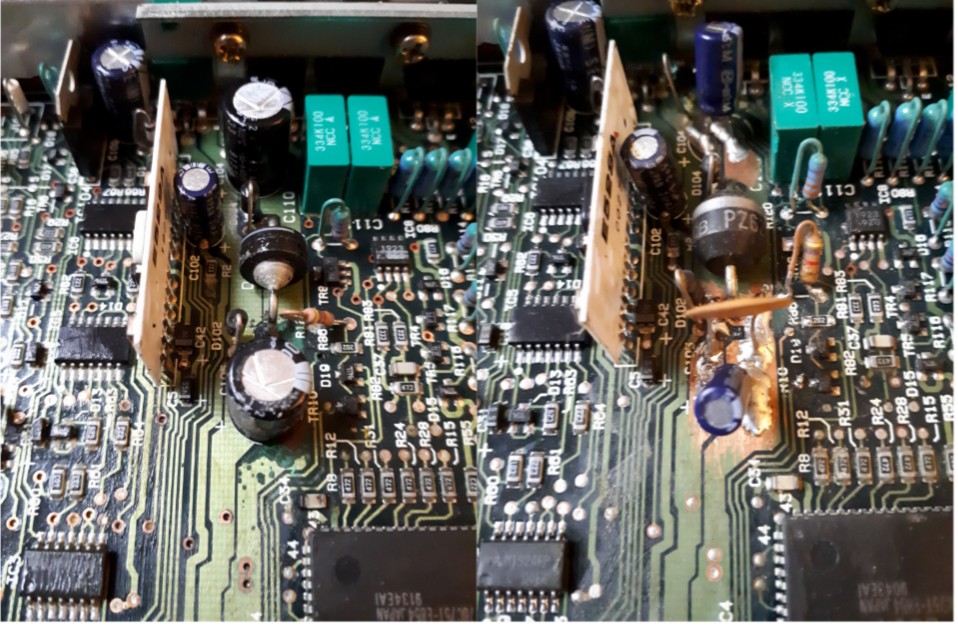

    I pulled the ECM and it has been swapped once before. You can see the markings from a Junk Yard. the ECM was from a 93 D50
    The electrolytic Capacitors look great.. nothing budging... The ECM was MD163056

    I took the ECM out into the bright light and one of the electrolytic caps leaked and ate 2 tracers. So.. that is the source of my issues.

    Well.. I got the used reman today and it fixed the issues. It still had the seal on it from 2002 so I cracked it open to have a look. This ECM was a mess to fix. This laid down solder to replace the traces, put an electrolytic and a ceramic in serial to get the 100uf they needed for the one capacitor value.
    But... it works and the truck is actually idling better and smoother than before so I suppose the caps have been an issue in mine for a while.
    The ECM I have has a board in WAY better shape than this one was so mine should be easy to fix for a replacement.
    The nasty thing is cleaning the conformal coating off to get to the copper.
    If I can figure out a way to post a picture I have a side by side of an original this repaired one.

    The left is the original, the right is the reman from 2002.

    Now that I look at it. The reman only has 2 of the 4 caps replaced.... I would have thought they would replace all of them since 2 leaked.
    I'm lucky that only 1 leaked on mine. I will have to do a continuity test on some of the traces on mine.
    It also looks like they reflowed the bottom of the board as all of the through holes are filled with solder on the reman one

    Electrolytics are terrible in the heat.. your correct. If haven't been able to find a schematic but it looks like the capacitor that failed on mine could be for smoothing the input 12v from the alternator. That could be why it's rated to 105C and 16V,, lots of heat cycles and it gave up the ghost. This would be the third computer in this truck since 1991.
    On the advise of a friend, I will be replacing my caps with tantalum caps. There is only 4 so the cost isn't that great.

    Oh, I just had a look at the ECM board pics. Nasty...
