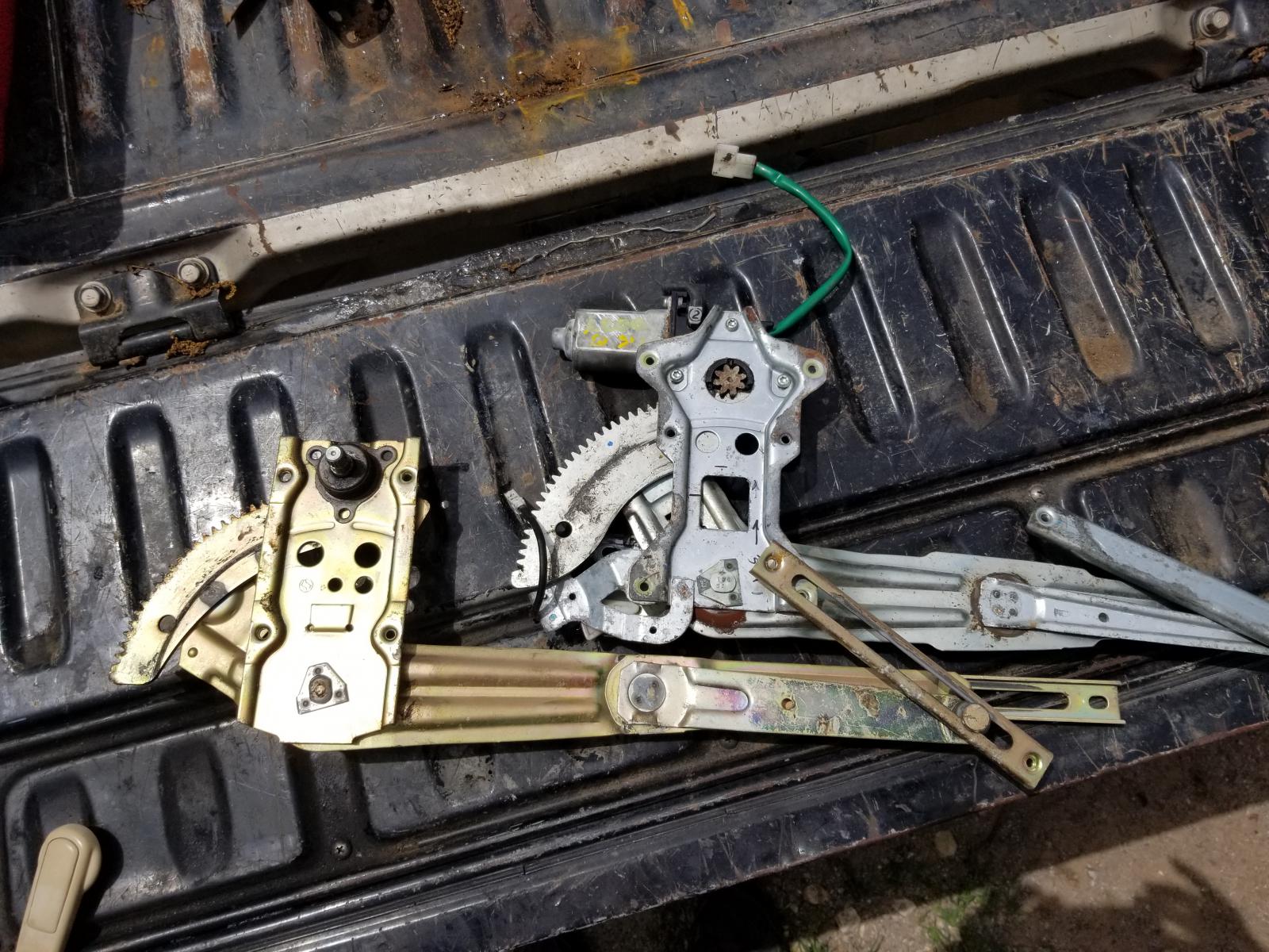

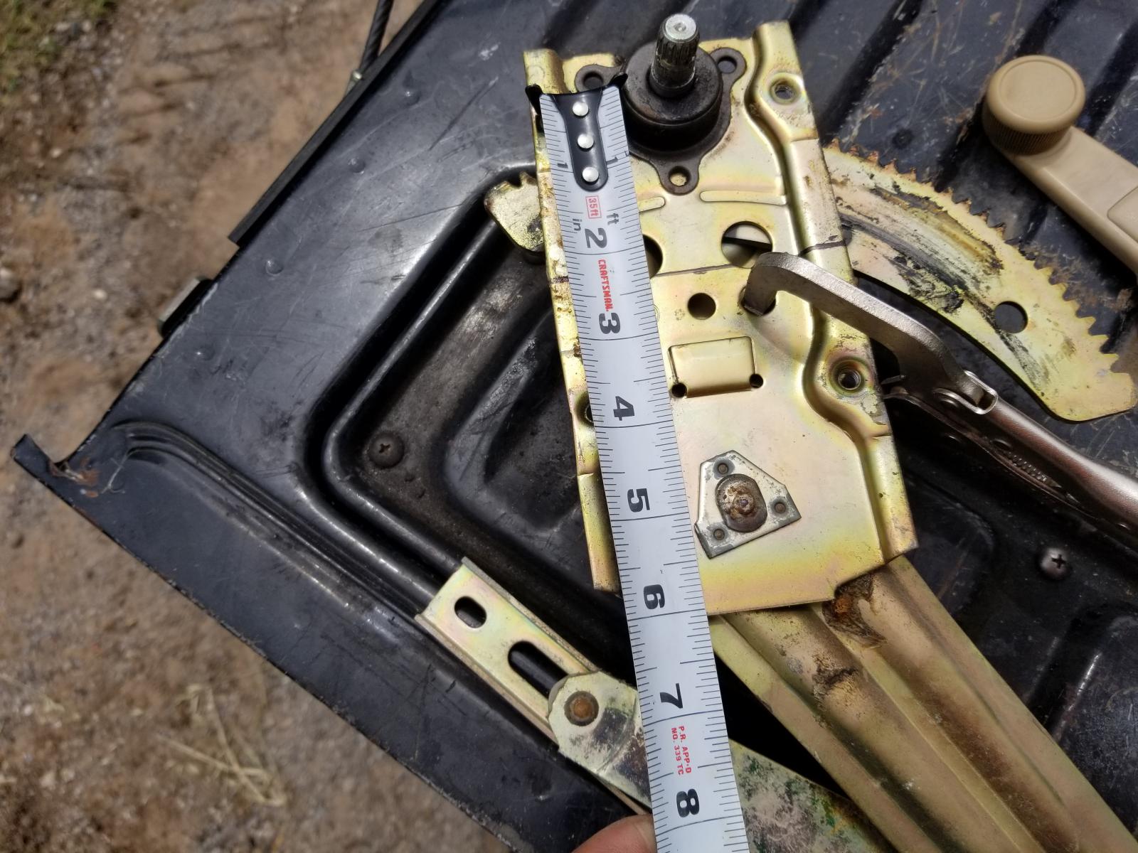

    Weeell,power window regulators from a L200 k74 are not a perfect fit.... they either closed all the way,an not go all the way down,or vise versa. So I cut the brackets apart from the manual and welded the bracket that holds the motor on it. Thinking if they were from the older k34,probably been chilli.

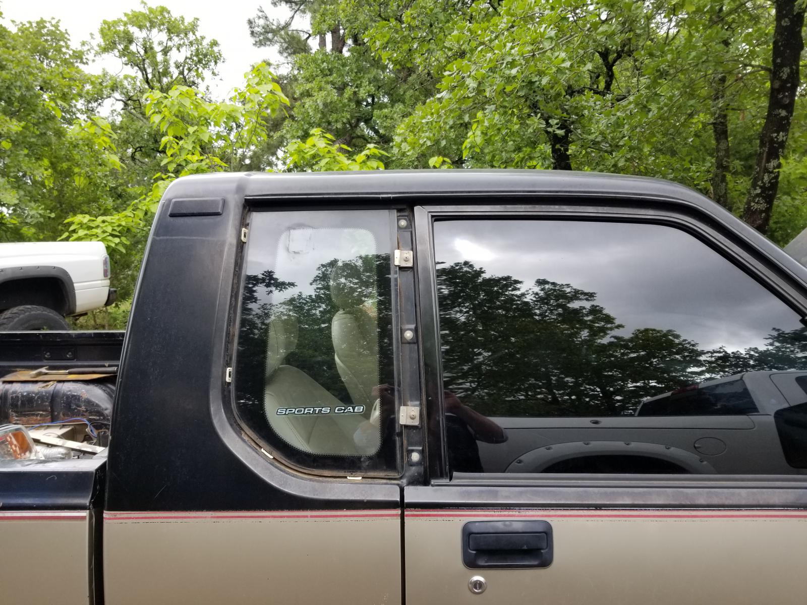

    Passenger side done! Really easy solution to power windows if anyone is interested. Im sure the L200 K34 would be the perfect swap,but it works just as well with the K74 with a little fab work. Just waiting on the switches I ordered off Ebay then the door panels will be finished!

    Everyday something checked off my list!20190511_134350.jpg20190511_160741.jpg20190511_161930.jpg
