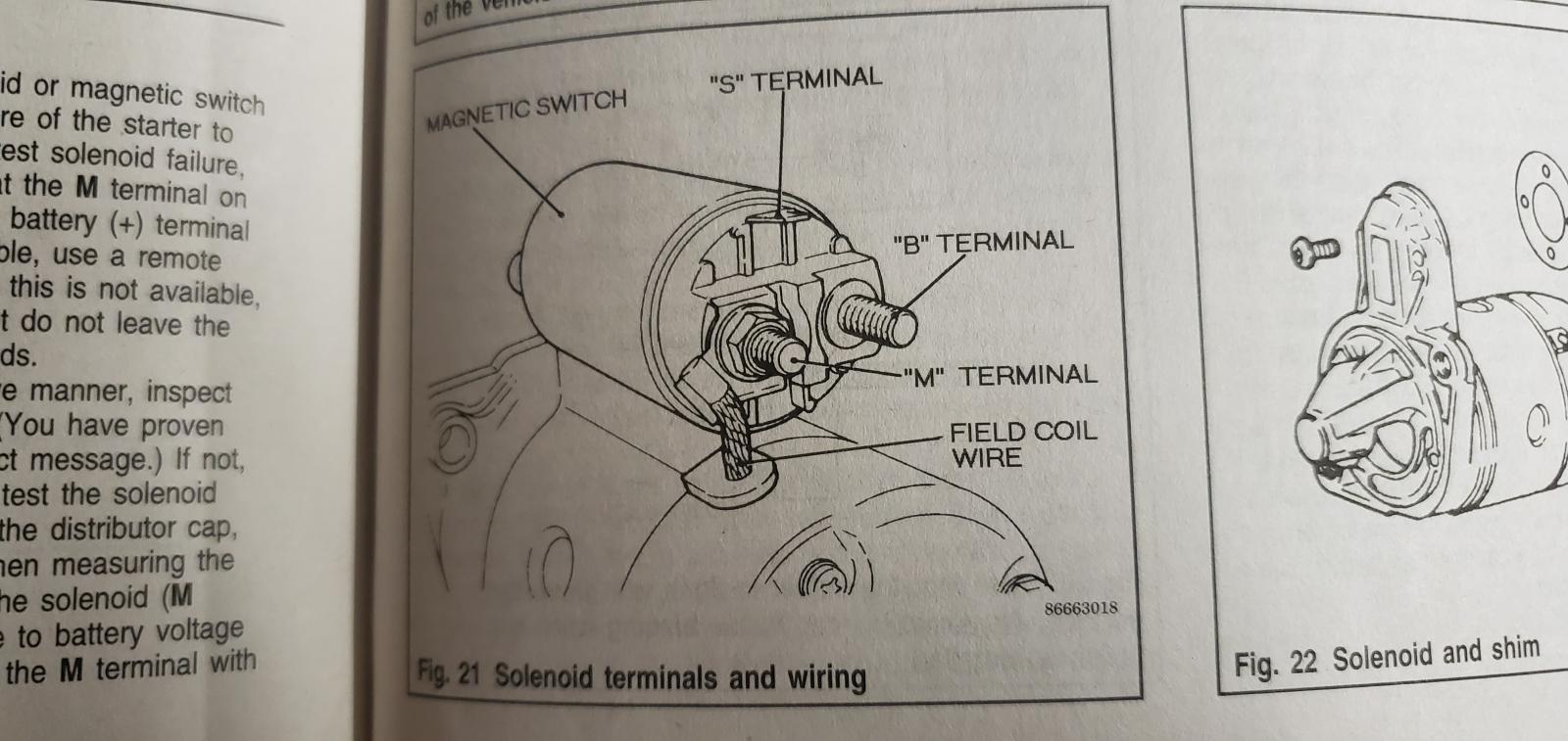

    This is so perplexing! The airtex video demonstrated an oil pressure sensor with three terminals on it. The first terminal is power, that one is easy, it hooks up to the electric fuel pump.
    The second terminal is for the starter solenoid that is powered up when the engine is cranked. Lastly, the third terminal is for ignition power. In guessing the last one is for a keyed ignition wire. What terminal on the starter do I wire the oil pressure sensor to? There is "S","B","M" terminals on the solenoid according to the manual. Here is a picture from the manual:
    The last terminal on the oil pressure sensor switch is for the ignition. I'm guessing a keyed terminal?
    You have it. That link I posted explains what wires to connect to. You have to T splice the starter wire or I guess connect to the same post on the starter, and the other wire which is hot only when the key is on and supplies the power while running should be hanging loose since you removed the Mikuni. It powered the Mikuni shut off solenoid I think.

    Connect the S(tart) terminal on the oil pressure safety switch to the S terminal on the solenoid.
    Auto parts, hardware, or electrical supply stores should have a spade terminal adapter that has 1 female and 2 male spade connectors on it. The female end goes on the S terminal, then the male ends take your stock starter signal wire and the new wire to the safety switch.
    (EDIT: These are apparently called "double male" terminals/adapters and come in "chair", "flat tab" and "piggy back" types -- Dorman part# 85412 comes with 2 of each for about $3 at Pep Boys or $2 at O'Reilly. Or, you could find a piggyback crimp-on terminal for your safety-switch wire, which has a female spade connector with an extra male spade forking off of it for your starter signal wire.)
    The way these safety switches typically work, there's an internal switch that flips whether the (P)ump terminal is connected to the (S)tart terminal or the (I)gnition terminal. At rest, P is connected to S, then oil pressure flips that to connect P to I instead. This can be handy to know in case the switch ever fails, as you can probably just swap the I wire over to the S terminal to get going again until you can replace the switch.
    Ideally, you'll also want that P(pump) wire triggering a relay that sends power directly from the battery (+) terminal to the pump, rather than having power from the ignition switch go thru the safety switch directly to the pump.
    Thank you so much for clearing this up for me and educating me on how oil pressure sensors work. Also, thank for the tip about jumping the cables to get things working again. That may come in handy in a crappy situation.
    I don't have the time to go to the auto parts store and get the spade terminal adapter you are talking about, so I just made one. Here is a picture of the one I made:
    As for having this setup ideally, what extra electronics would I have to buy. You mentioned a relay, is there something specific you can point me too. I don't even know what the heck a relay is and how I would wire it to the truck.
    So far, the "P" (Power) terminal is hooked up and "S" (Starter Solenoid) are hooked up. I just need the "I" (Ignition) terminal hooked up. Everyone says to hook it up to the existing fuel cut off solenoid that's hanging around in the truck. Although there is other connections hanging around as well. Here is a picture of all the connections hanging around. Which one do I tap into?
