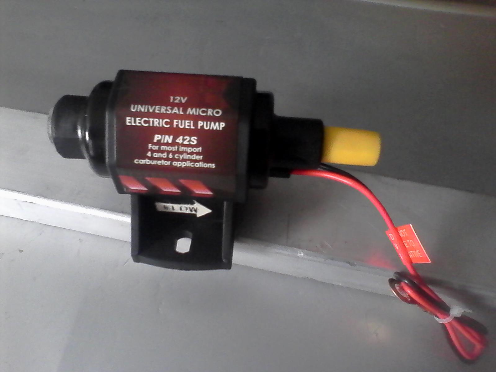

    I just got the electric gas pump and was wondering how you wire this thing up? There is a wire coming out of the electirc gas pump with a label on the cord that says "to ground only", "do not wire to positive."
    Also, how do I wire the electric choke?

    Look at post #37 It should all be the same even though you have a different pump. It is still two wires power and ground. The part about T'ing off an existing wire will help and the electric choke on mine is wired to the coil. Same pin the wire from the distributor connects to.
    http://www.mightyram50.net/vbulletin...9074#post69074
  8. #58
    Ground goes to the shortest path it can on the body/chassis of the truck (requires a good, solid connection). The electric choke is simply live power with the ignition on (like the coil or distributor as 85Ram has indicated). As mentioned, it's the same wire as the fuel cut solenoid on the factory Mikuni carb just repurposed.

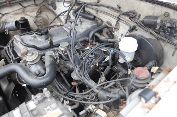

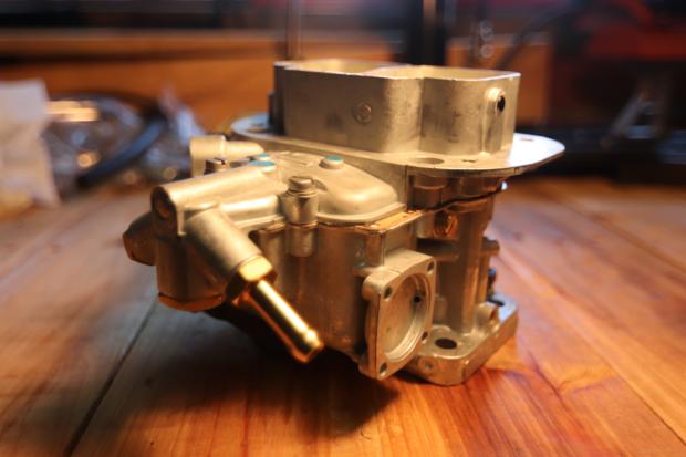

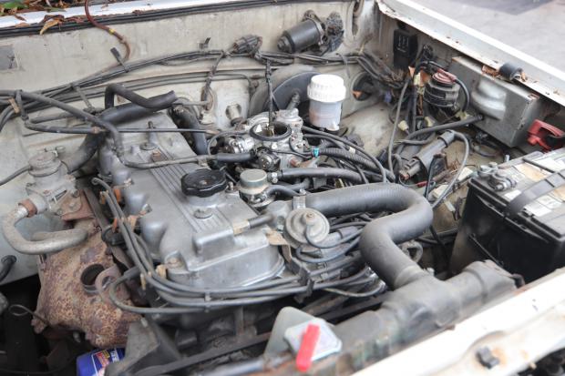

    What do I need to do to replace the Mikuni carburetor to a Weber carburetor? I have a 1988 Mitsubishi Mighty Max 2.6l 4x4 manual transmission pick up truck.
    UPDATE: 11:48 A.M. 6/16/2019 Sunday
    I purchased the Weber 32/26 DGEV K610 carburetor from Carbs Unlimited and received it a few days later. Although, the carburetor has DGAV stamped on the base instead of what I believe is supposed to be DGEV. Anyone know why that is? I took multiple pictures of what you will get when you order the Weber 32/36 DGEV K610 carburetor.
    I received this box that was in another box(inception :
    Attachment 22818
    Overall contents of package:
    Attachment 22819
    Contents laid out on table:
    Attachment 22820
    Pictures taken of the carburetor body:
    Attachment 22824Attachment 22826Attachment 22827
    Attachment 22828Attachment 22829Attachment 22830
    Attachment 22831Attachment 22832Attachment 22833
    Attachment 22834
    UPDATE: 11:18 P.M. 8/11/2019 Sunday
    The following pictures are the components you will receive with the k610 conversion kit. I took a picture of each component to show a closer view.
    Attachment 23103 Attachment 23104Attachment 23105Attachment 23106Attachment 23107Attachment 23108Attachment 23109Attachment 23110Attachment 23111Attachment 23112Attachment 23113Attachment 23114Attachment 23115Attachment 23116Attachment 23117Attachment 23118Attachment 23119Attachment 23120Attachment 23121Attachment 23122Attachment 23127Attachment 23123Attachment 23124Attachment 23125Attachment 23126
    The first three pictures were taken before the conversion started:
    Attachment 23128 Attachment 23129Attachment 23130
    These next pictures, I started removing...
    Attachment 23131Attachment 23132Attachment 23133Attachment 23134Attachment 23135Attachment 23136Attachment 23137Attachment 23138Attachment 23139Attachment 23140Attachment 23141Attachment 23142Attachment 23143Attachment 23144Attachment 23145Attachment 23147Attachment 23148Attachment 23149Attachment 23150Attachment 23151Attachment 23152
    Carburetor removed with it's annoying vacuum hoses:
    Attachment 23146

    A long ground lead is unnecessary as you will (more than likely) mounting the pump to the chassis and by keeping it short you reduce the risk of it failing (running a long ground lead will create resistance = drop in current. The fuel pump might struggle to work at it's optimal capacity...) Testing it - either live (the positive 12v power from the ignition circuit on to the point where you want to ground it to and check your voltage) or with a multimeter and check resistance from a bolt or bare metal and the ground point you're planning on using.
  23. #73
    10-29-2014
    1,286
    Earth, the Solar System
    Quote Originally Posted by BJH324JH View Post
    Also how do you know if you grounded it properly?
    The only way I ever knew I had grounded properly was that the item worked. If it did not and I thought it was the ground I would check to be sure there was bare metal to metal contact. I did not have to do that with my fuel pump and I just used one of the bolts the mounting plate is bolted to the frame with for ground. Whatever bolt you are bolting the pump to the truck with will do fine for a ground spot as long as you are bolting to the frame.
    On the Duralast oil pressure switch I don't see why it would not work, the thing is just a switch that cuts off when oil pressure fails.

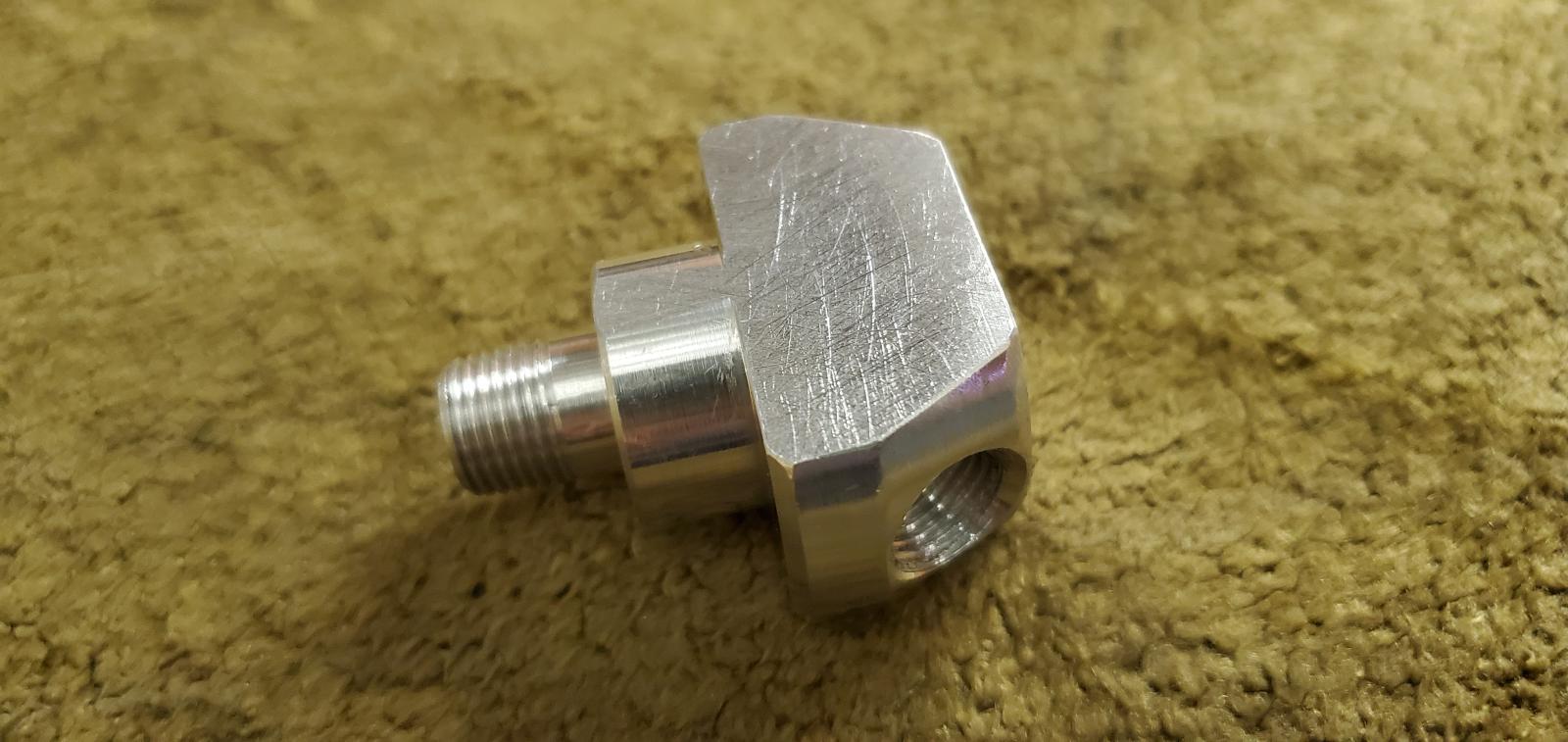

    Couldn't find t-fittings at my local auto parts store. So I machined one out of aluminium with my crappy tools. I hope it doesn't leak oil. Here are some pictures of the homemade t-fitting if you are interested:
