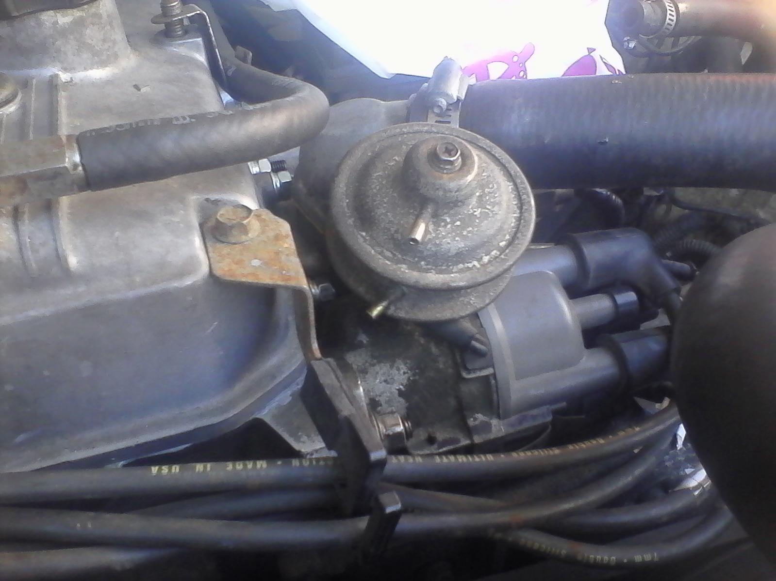

    I'll just save them, just in case they are needed or someone needs them. There are two vacuum hose connections on the distributor, which one do I plug and which one do I use?
    Does the distributor hose connect to this connection on the carburetor:
  21. #46
    Ok, you've got one of those distributors... not sure on which vac barb to cap on that one. I'm pretty sure the circled hose barb on the Weber is the correct location to hook up the distributor advance. Vac advance has to be connected from a source above the throttle butterflies or it'll pull continuous vacuum.

  24. #49
    08-29-2016
    253
    Siskiyou County, CA
    Quote Originally Posted by BJH324JH View Post
    If memory serves right on the dual vacuum advance units used for Federal High Altitude converted vehicles and California emissions trucks the top port is a secondary advance for the "high altitude compensator" that advances the timing by 5 degrees and the bottom one is the main vacuum advance that is used by the carburetor. hope this helps
  25. #50
    I learned sumpin' there from Starquest. I wonder if it's worth experimenting with the dual vacuum solenoid on the distributor by trying each one individually with the Weber? Reasoning behind it is the Weber is a vacuum beast and has a tendency to over advance unmodified distributors, possibly causing detonation
