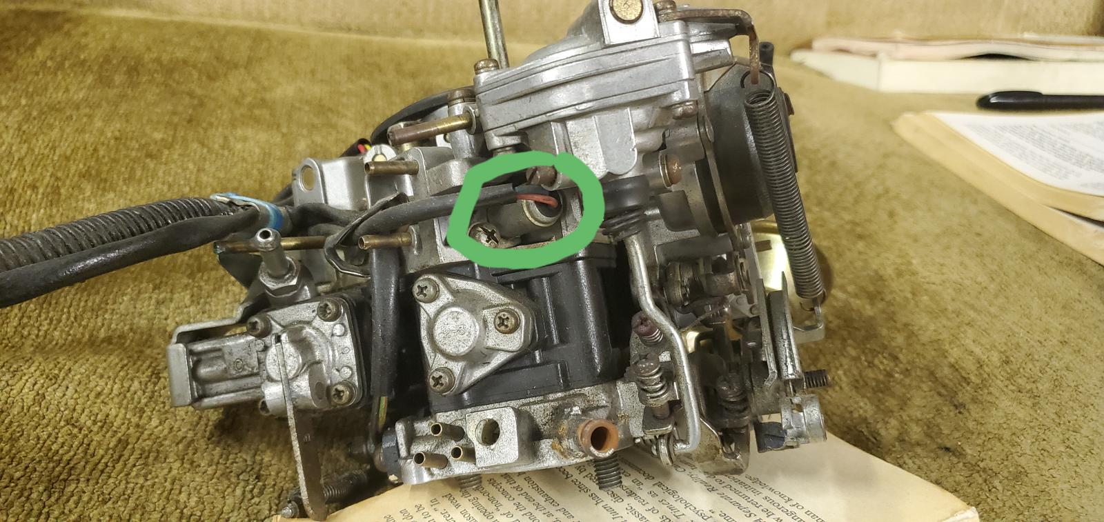

    I think I may have figured it out where the fuel cut solenoid wire is. After looking at the manual for a bit and looking up what each solenoid does, I came to figure out that "Slow cut solenoid valve" is the "fuel cut solenoid valve". Just different names. Here is a picture of the fuel cut solenoid valve on the mikuni carburetor:
    It has red and blue wires going into a connection block, just like SubGothius mentione:
    "If your Mikuni setup is like my '87, the fuel cutoff solenoid terminals are bundled into that multi-terminal connector block."
    Now, there is two wires coming out the fuel cut solenoid. One is blue and the other is red. I believe one is ground and the other is power? Do I use both wires of the cut off solenoid , or just one?

    ...Now, there is two wires coming out the fuel cut solenoid. One is blue and the other is red. I believe one is ground and the other is power? Do I use both wires of the cut off solenoid , or just one?
    You'd only need the power wire but now you are going down the oil pressure switch path you probably won't need to isolate the power in that connection. What would happen is the power that normally would go to that solenoid would be used to trigger the relay in an ignition on/off circuit.

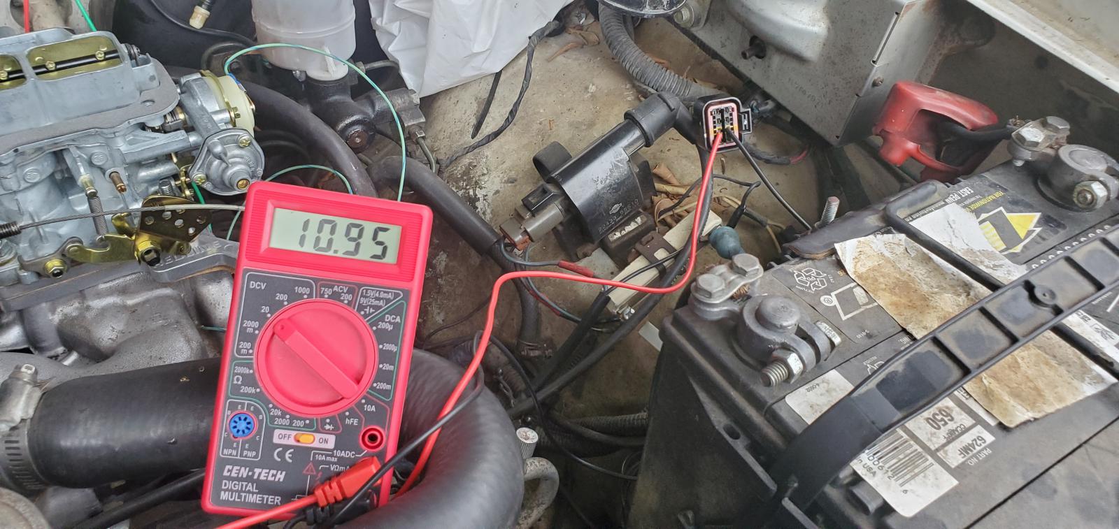

    I took out the multimeter and tested the connection where the fuel cut solenoid hooked up to and it seems to have only about 10volts. Do I need to find another keyed ignition source? Here is a picture I took of the multimeter reading:

    That ~11V reading should be sufficient to trigger the relay. A fully charged battery should push about 14V, so that reading may indicate your battery is nearly depleted and/or needs replacement. To confirm, see if you also get ~11V across the battery terminals directly.

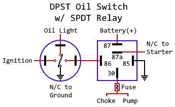

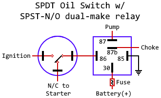

    I worked up some relay diagrams. Here's how it would work with the safety switch you've already got:
    However, when I tackle this same project myself soon, I plan to use a different safety switch that incorporates a terminal for the low-pressure light (instead of a (S)tarter terminal), so I won't need a T-adapter for the stock oil light switch; this setup would use a different type of relay wired like so:
    You are pretty good at this electrical stuff. This stuff boggles my mind. I was wondering if there was a way to eliminate the t fitting because it looks ugly. Glad there is a way. Thank you for the help, I'm just waiting for my power brake booster hose, so that I can start her up. I'll keep you guys updated.
