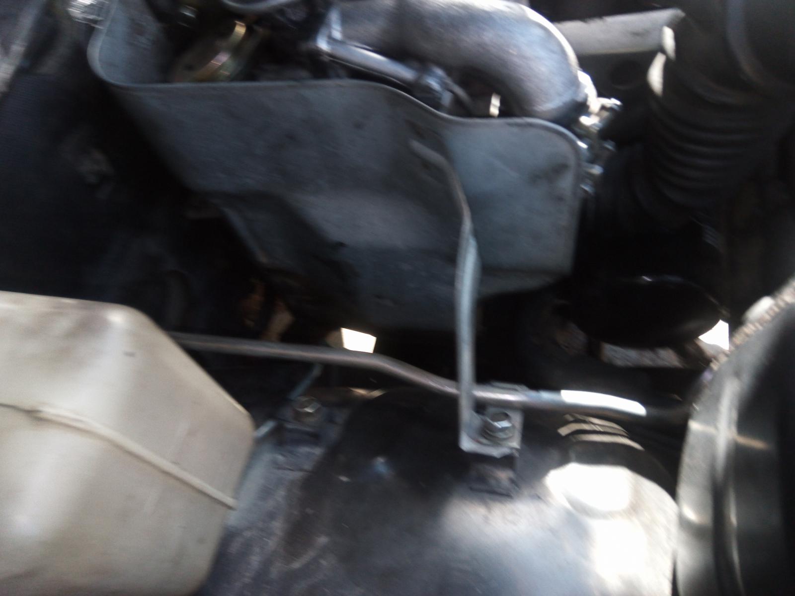

    does anyone have all the heat shielding installed and can send me some pics? I am trying to figure out all of that too.

    Clear as mud?
    these last two are the turbo shield, first from the front then the top
    If any need clarification let me know

    Awesome! Thanks Bjamin. I might have some questions as I break into it, but that helps a ton already.
