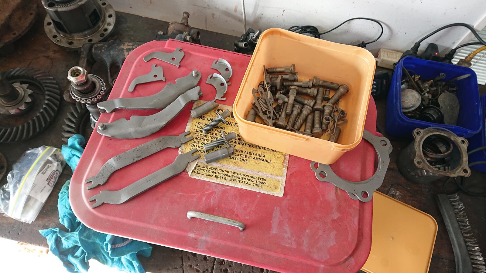

    The axle from the 85 was pretty rough when I got it, and didn't get any better sitting in my garden on its end for a year... I've got it totally torn down and have bead blasted all the brake components ready for zinc plating, and its all come up nice. I've got new drums (Bendix PDR0420), new shoes, cylinders, bearings and all the other misc hardware... But I've broken the cardinal rule of brake jobs, which is to to one side at a time so you can use the other side as a reference for how it all went together!
    Anyone have any pictures of the setup knocking about so I can figure it out? Everything I can find is for either the 10" stuff from the montero/pajero, or the early 9" stuff like the 81' axle that is currently in my truck.
    I've attached a couple of photos, one of the truck and a couple of the brake bits to help identification. Cheers!

    You could just use the complete 2nd gen diff. They bolt right in. They use a slightly different style of brake set up, the brake shoes are cheaper and more available off the shelf (I have a 2nd gen lsd unit in my 81)
    There's some basic pics in the manuals section (I think you have to donate to get access) or show some pics of what you have, I have had both apart

    Cheers tortron, just using what was cheaply available at the time. I've got new drums and all the bits for the late 1st gen housing now, so it should last the next 15 odd years ;-). I'll have a look at the manuals section to see what's what and if I can get any info there. No worries donating, good info is worth whatever is costs. Read through your thread, great to know the starion power steering boxes will fit on, I've got a couple knocking about, so that will be worthwhile, and mean the other half will find it much easier to drive on the odd occasion she needs to.

    Oh, and the manuals section has a FSM for a D50, which has the brake info I need, cheers!
