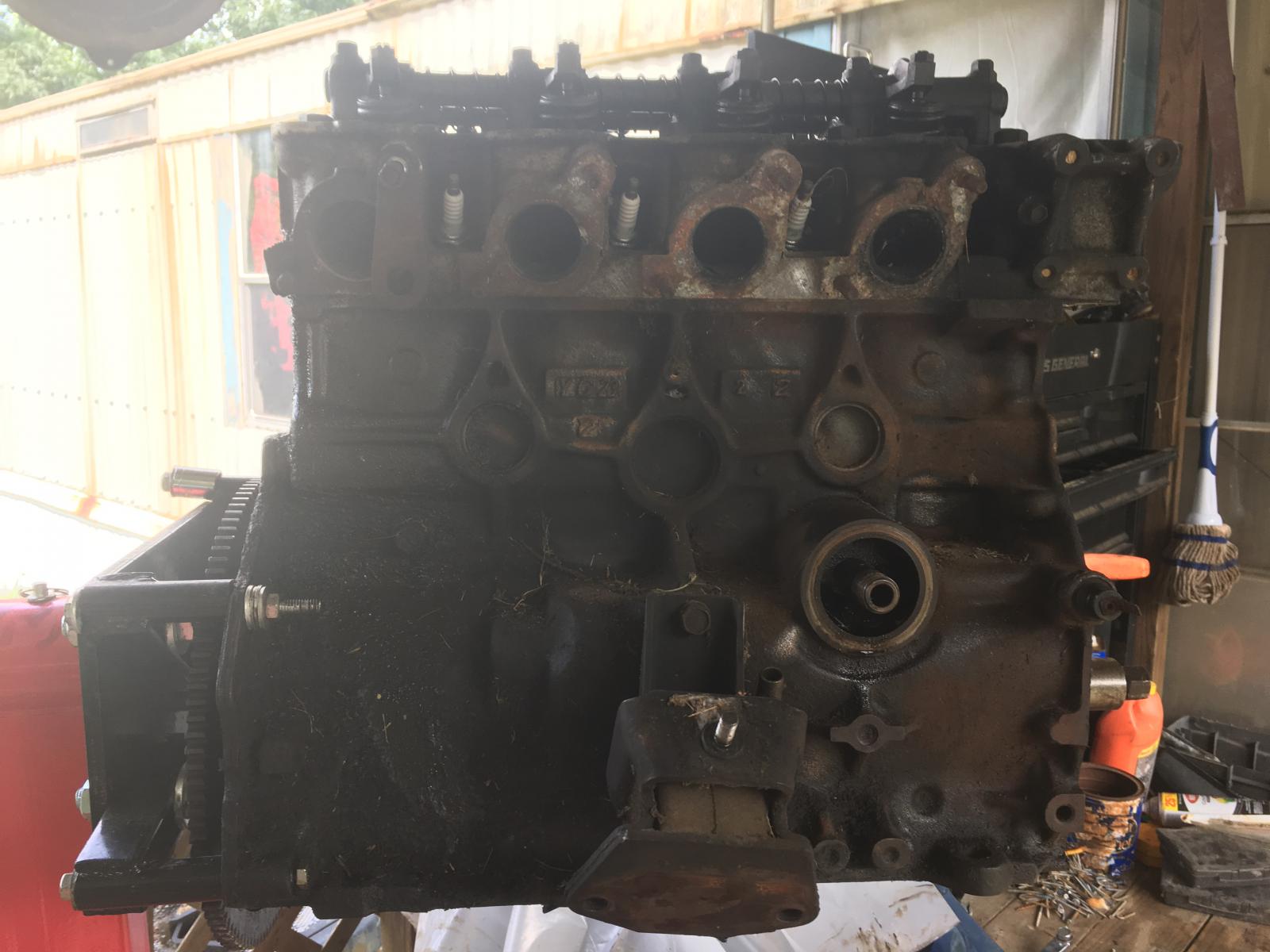

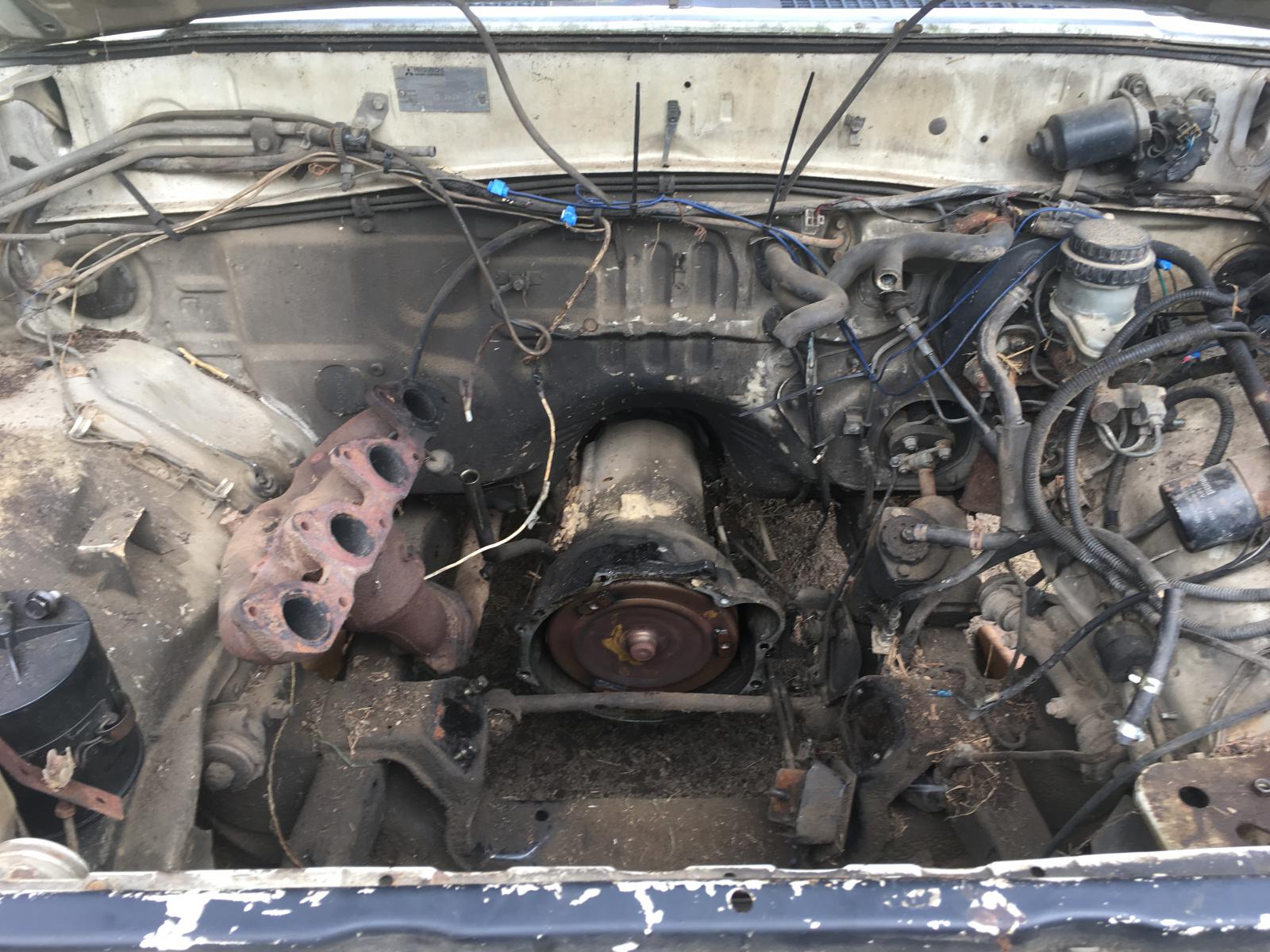

    Take a picture of your engine bay.
    I will take a picture this afternoon but the engine came from a different truck

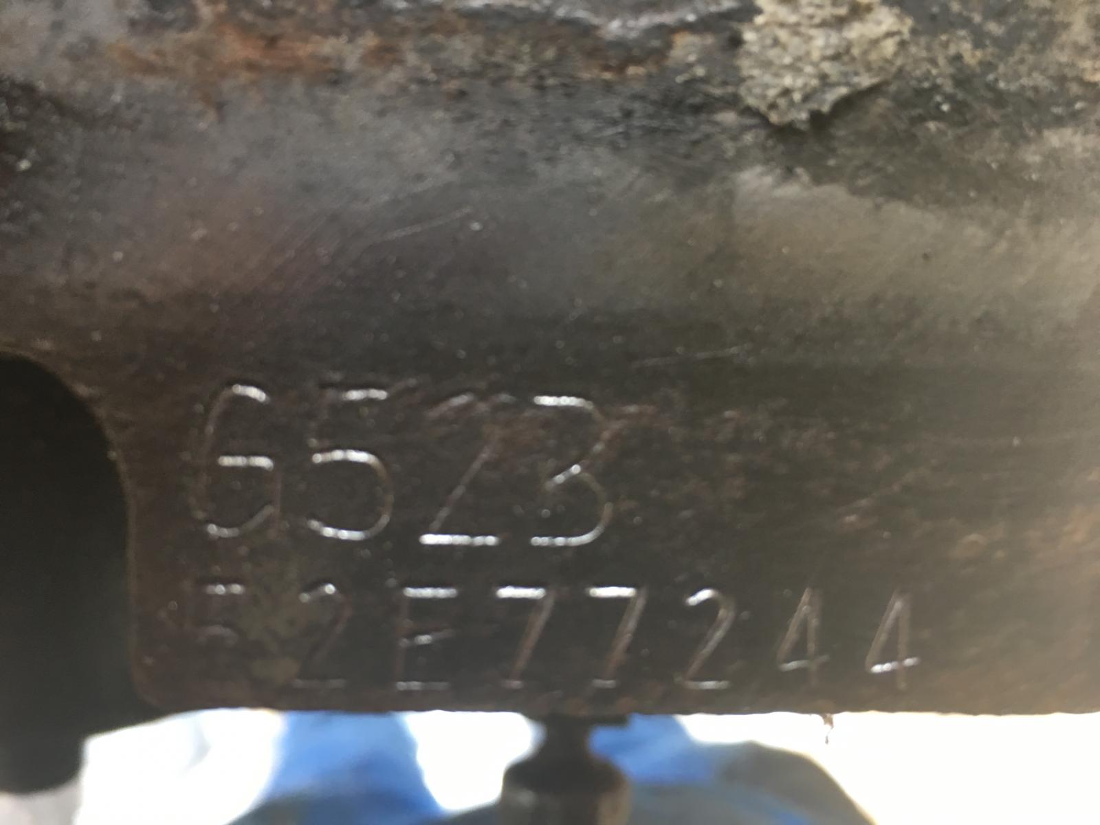

    Get a wire wheel on a drill and give that metal ledge sticking out of the block next to exhaust port #4 (the top face which would be the block deck) a pass or 2. The engine number and block designation code should be stamped on it. Your truck has had both an engine and transmission swap going by the numbers on that ID plate.
    I’ll give a good brushing when I get home from work today. This engine and transmission definitely has been swapped. They came from a d50. The guy that swapped them has no idea of year though. They were swapped out about 15 years ago and the truck has been sitting for about 13 yrs now. All he could tell me is the d50 looked identical to the mighty max.

    I found it. I really appreciate the help guys.

    My next question is, do these numbers help to determine the year model?

    Astron series for sure, (chain driven cam/ oil pump/dual countershafts)
    2.0 litre,? can be verified by 84mm bore & 90mm stroke...

    Hypothetically - yes. You would really need to know your engine number sequencing to figure out when and what the engine came out of though and that data is probably sitting in a filing cabinet full of decaying microfiche. The 2.0 Astron is a good all round engine. If you wanted to build a solid daily driver that can give you modest performance, it's up for the task.

    Judging by parts that fit ie distributor cap and valve cover gasket, my best guess is 1979-1982.
    yes - the g52b was a 79-82 motor, replaced by the g63b in 1983.
