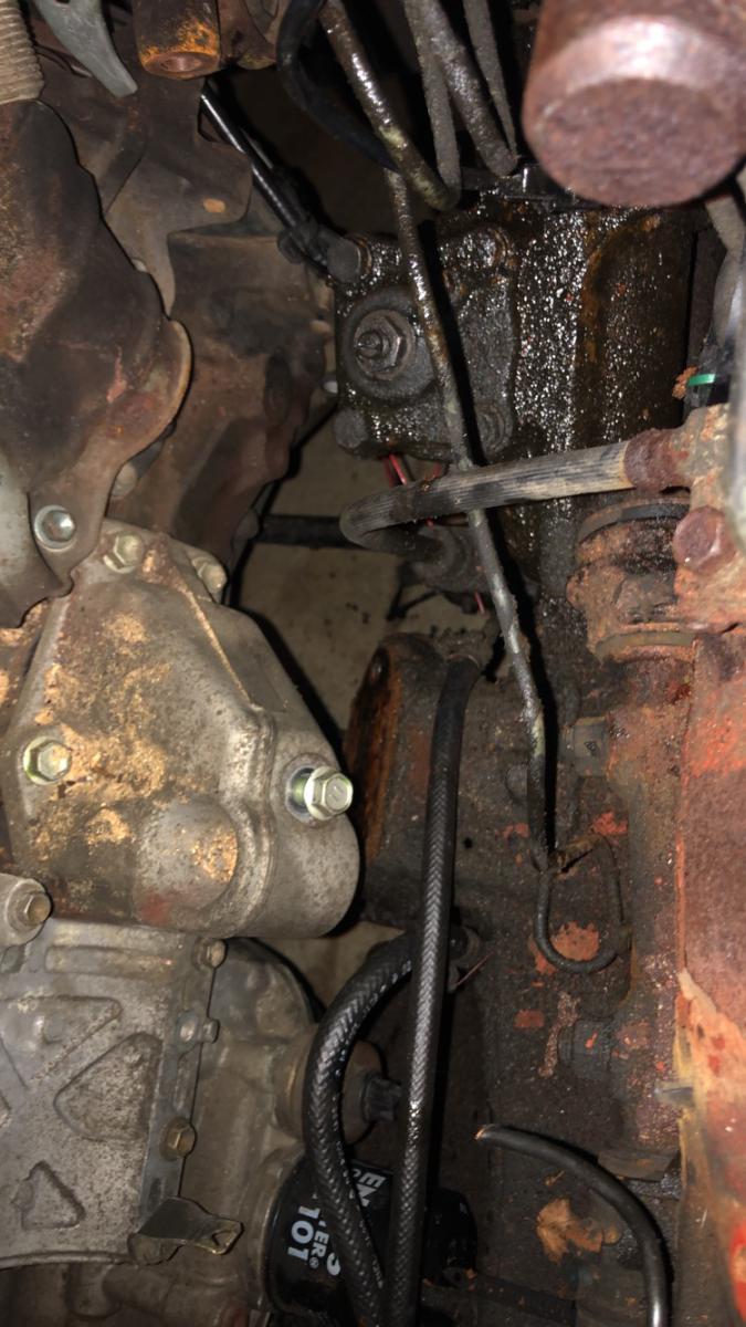

    Time for another update; I had the engine up on the crane, trying to gauge how it would sit and what I would have to do to mount it. It looks like I'm going to have to custom make motor mounts and an exhaust manifold, but it'll sit nice and level in the bay with plenty of extra room.
    Thanks for the pics. One mount looks dead easy to fab up. Other one will need a bit of thought. Straight into it - top marks! Theoretically all you'll need is a hybrid tail shaft, modded headers, a way to get all the instrumentation together and working and the engine and trans mounts and it'll be about ready to go (some monkeying with hoses but you can go through the racks at the local auto parts shops and eyeball them to problem solve that). Got A/C? If the 3GSE has the compressor it would be awesome to make use of it (maybe power steering as well...?)
