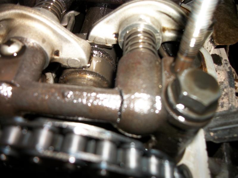

    Haha, that would be cool. But I went ahead and took the valve cover off to see what was making all that chattering noise, and to my surprise the timing chain, sprocket, cam and rocker arms all looked like new, I have had a bad oil leak for some time so I went ahead and cleaned the valve cover while it was off. I started to check out the rocker arm gaps and I noticed cam tower 1 had a HUGE crack in it, not a hairline fracture like the mitsu had I mean I could stick a flathead screwdriver in there, so I found where the chattering noise is coming from. Here are some pics
