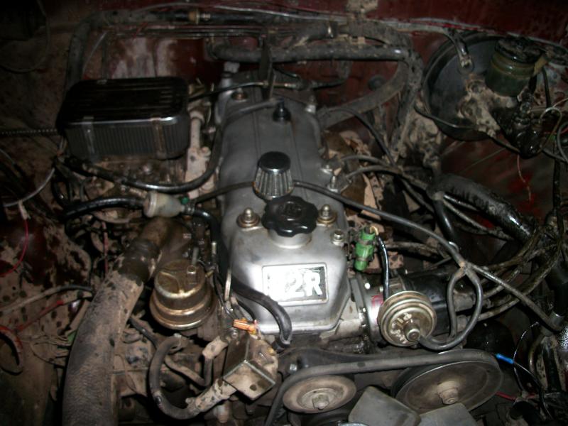

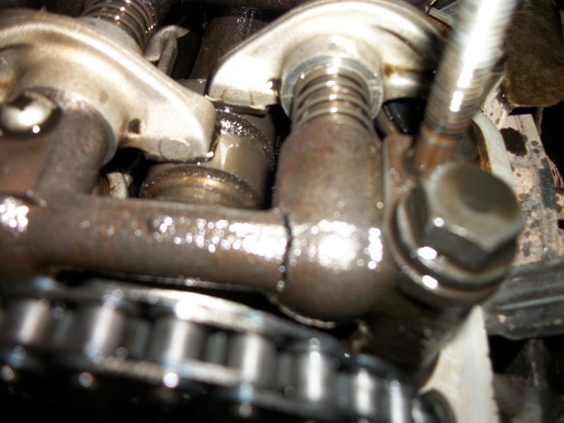

    Haha, that would be cool. But I went ahead and took the valve cover off to see what was making all that chattering noise, and to my surprise the timing chain, sprocket, cam and rocker arms all looked like new, I have had a bad oil leak for some time so I went ahead and cleaned the valve cover while it was off. I started to check out the rocker arm gaps and I noticed cam tower 1 had a HUGE crack in it, not a hairline fracture like the mitsu had I mean I could stick a flathead screwdriver in there, so I found where the chattering noise is coming from. Here are some pics

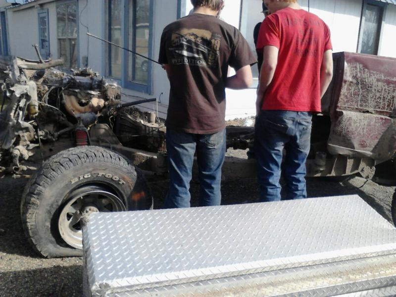

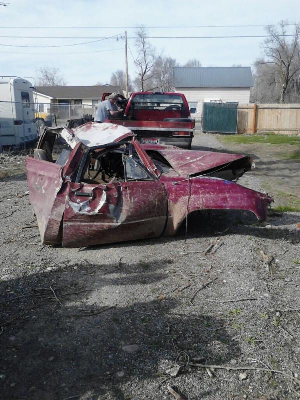

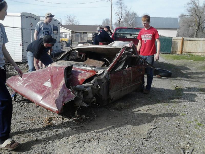

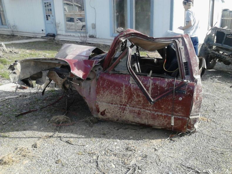

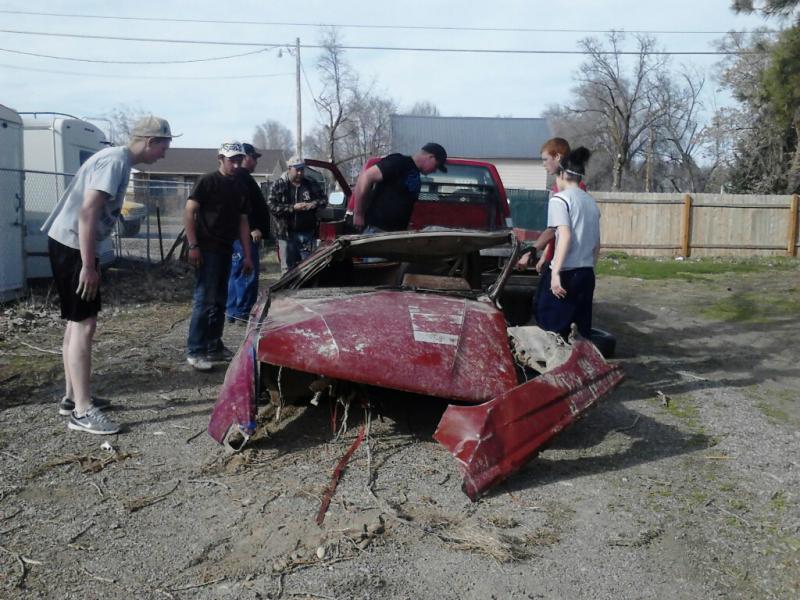

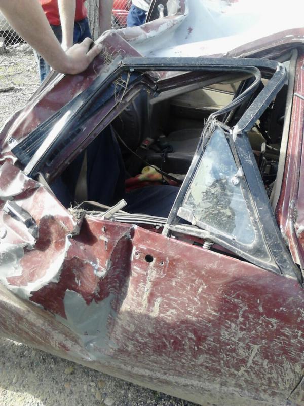

    So i know i havent been on this site in a loooooong time since i sold my last D50, which i bought with the money from this truck... I sold this truck to a friend of mine back in october and he has drove it ever since, not to long ago he put a cheap 3 inch body lift on it.. He was driving home from a party with a friend of his, he was doing around 85-95mph and he was going around a sharp corner and he started to drive the fog line, he corrected and then over corrected and rolled the truck, during two rolls the cab stayed intact, then the bolts ripped out of the washers and the mounts of the bottom of the cab and it flew about 20-30 feet into the air, rolling 7-13 times more until he landed in an ajacent feild, the cab and the frame were about 30 feet apart.. they had friends following along and watched the whole thing, they had to roll the cab back over and destroy the window frame to pull him out, the friend just crawled out, they walked minor scratches and bruises... I got to drive the truck one last time on friday... Its sad seeing the truck, but so amazing they lived through it...

    my friend who wrecked the Toyota just sat like he was getting surgery done while my girlfriends mom who is a nurse cleaned 5 very large wounds on his head...
