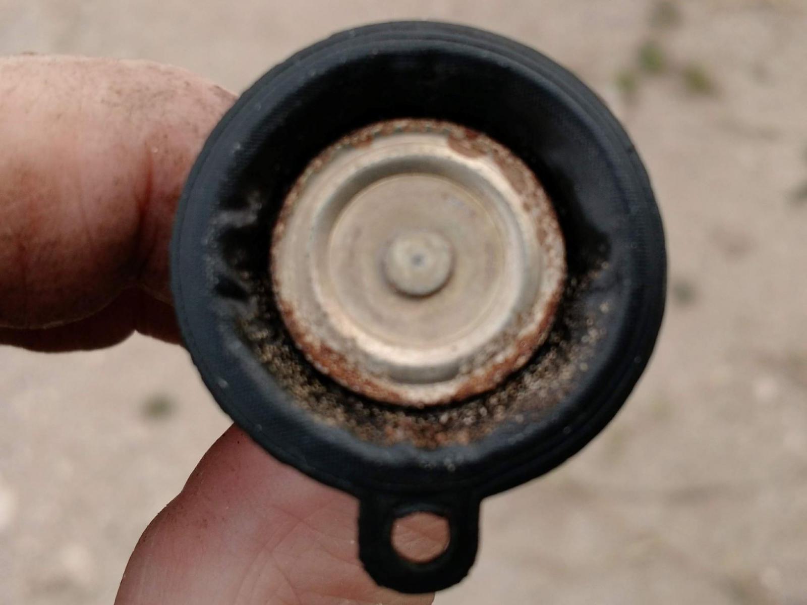

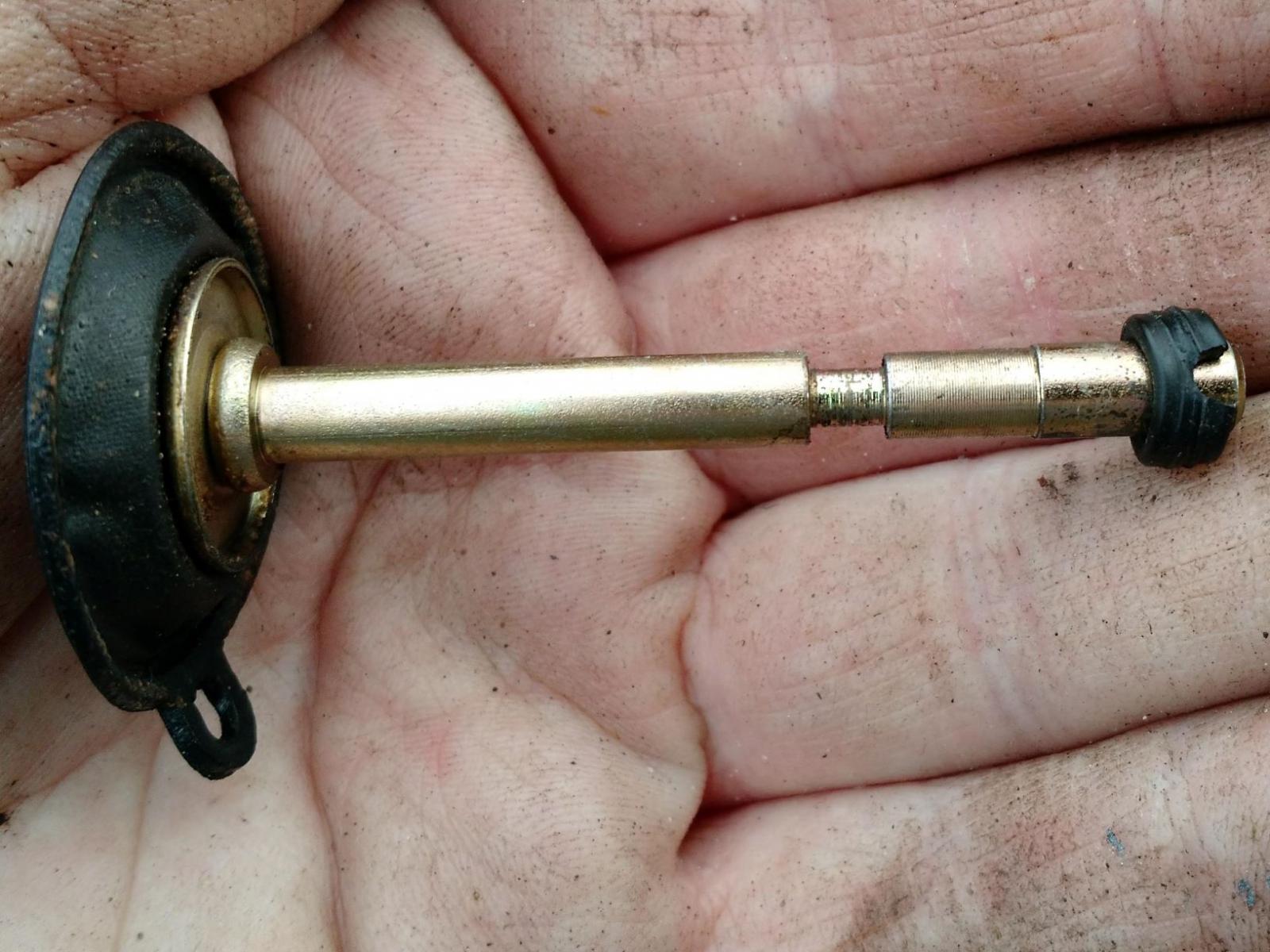

    Got the diaphragm part today (Tomco 7404, mis-listed as a "choke pull off") and went to install, but the old diaphragm appeared intact when I removed it. There was a bunch of crusty deposits around the outside face of the diaphragm and around the carb face it seals against, so I thought maybe that could be breaking the seal. I cleaned those deposits off the carb and was gonna install the new diaphragm anyway, but the o-ring midway along the old diaphragm shaft started to tear when I tried removing it to transfer to the new one. It's not a typical o-ring, more cylindrical than donut-shaped, with sorta ridges on the outside.
    Could I replace that with a regular o-ring (maybe doubled up in series?), or is there some known replacement part for it, or is it something only available in a full carb-rebuild kit?

    Unfortunately, this isn't good. The diaphragm shaft should have come out cleanly, but what you got is the center of a rubber disc that is the vent valve. Here's a diagram of the bowl vent system. The circled part is the rubber valve:
    The center of the rubber valve tore out because it was brittle or degraded with age. To replace it now requires removing the carb and it's top portion. But if you're going that far into it, and given the amount of internal crud seen in the pictures, it may be wisest to replace the carb. The Mikuni is very difficult to rebuild successfully, and rebuild kits don't include the rubber valve, which I haven't seen available in decades.
