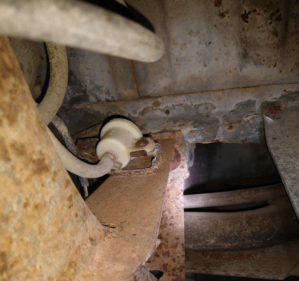

    My 87 is a standard can, short bed with a manual trans and the fuel filter is in the same place as Mr. Paco's. Right above the front of the fuel tank.
    There's no filter there right now, because the old one was clogged and full of water. The fuel tank was already out of the truck when I bought it, and I've tried reaching up there from underneath the truck. If I go from the left, with my left arm I can just barely get to the bracket that holds the filter, but whether I could get the stock filter back into that clamp without dropping the tank...

    Any luck with accessing the fuel filter? I recently bought an '88 MM, 2WD with the standard cab and 6ft bed. I can see the fuel filter in the same location that MrPaco has been describing. If I really work at it, I can fit my arm in there to reach it, but actually removing the fuel lines from the filter, and getting it out of the mounting clip would be a minor miracle. Some sort of access panel would be great...

    my 89 long bed 2wd automatic had one mounted on the drivers side inner fender. I have a small inline filter now between my carter fuel pump and the carb. I was looking at my fuel lines along the frame the other week as they are getting pretty crusty and are ready for replacement. I was surprised to see a second fuel filter up near the tank like your photo. Interestingly, I had replaced the one on the inner fender long before going to the electric fuel pump. I remember seeing a whole bunch of filters on rock auto that looked like that one, and one of the fender mounted which is what I purchased. So my truck has two filters

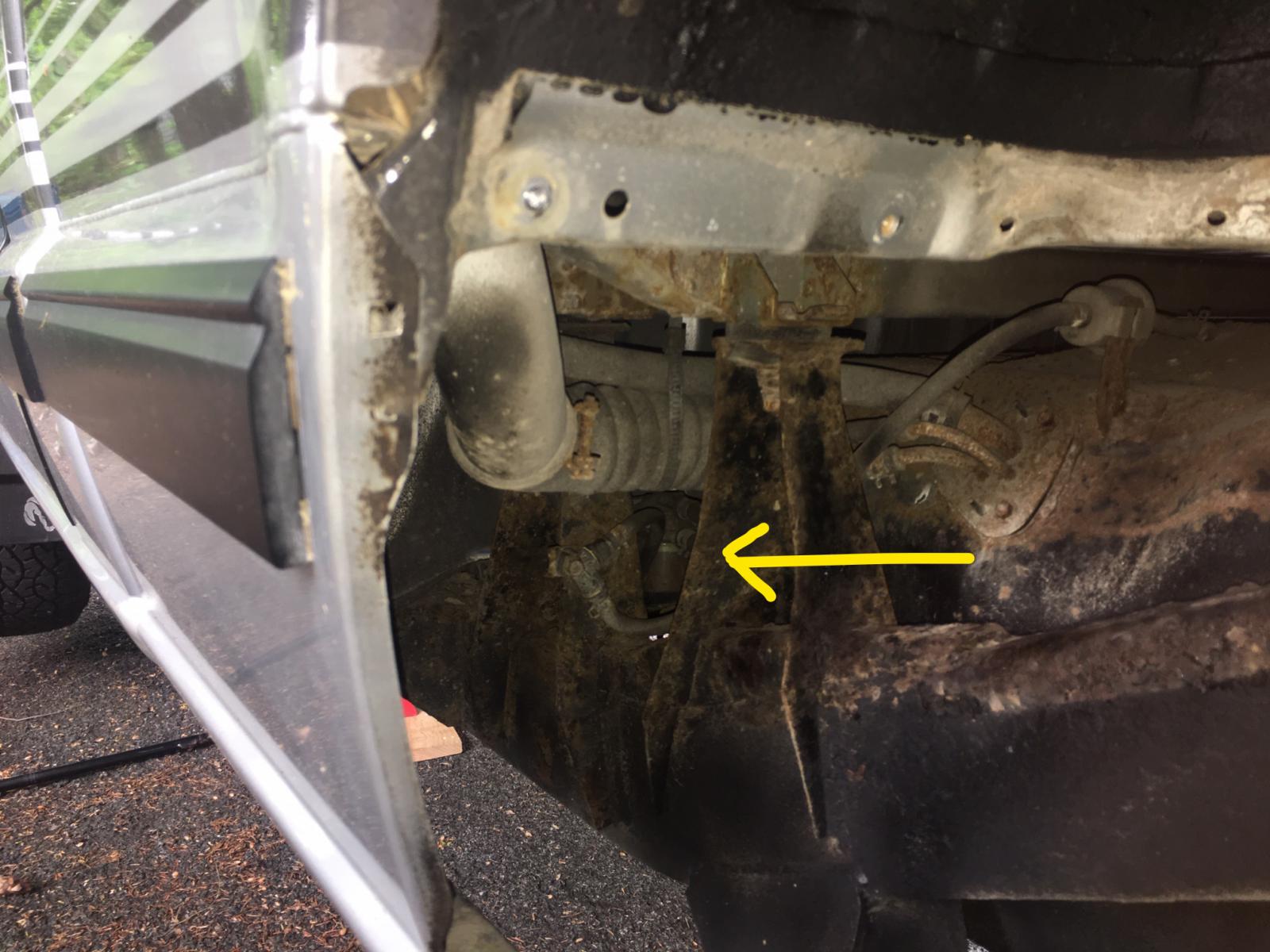

    Quote Originally Posted by HHmightymax88 View Post
    Hello, and welcome.
    As you can see from this thread, the particular configuration that you have (2nd gen, carbureted, reg cab, short bed) has the filter in a very hard to access place. Most likely because the space where it goes on macro cabs and long beds is too tight on the regular shorts.
    I figured out a way to access the filter, it's still pretty tight, but doable. You have to lift the truck and remove a panel in the rear wheel well, and then you get a semi straight shot to the filter location. It's still tight, but at least you don't need to bend your arm in unnatural ways.

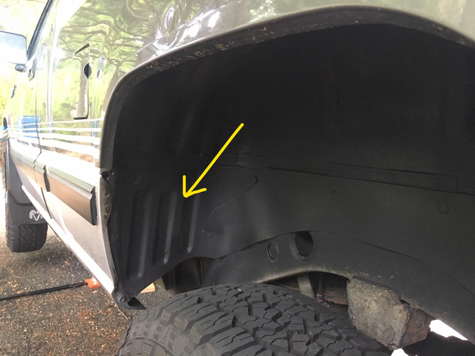

    Lift the driver's side from the frame (not the rear axle, you want to the wheel and the well to go on opposite directions. I actually had the truck lifted from the front when I did this and it worked fine.
    Then take off this panel by removing the 10mm bolts

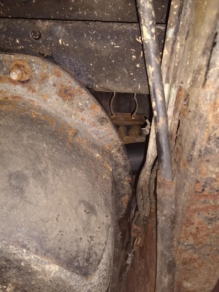

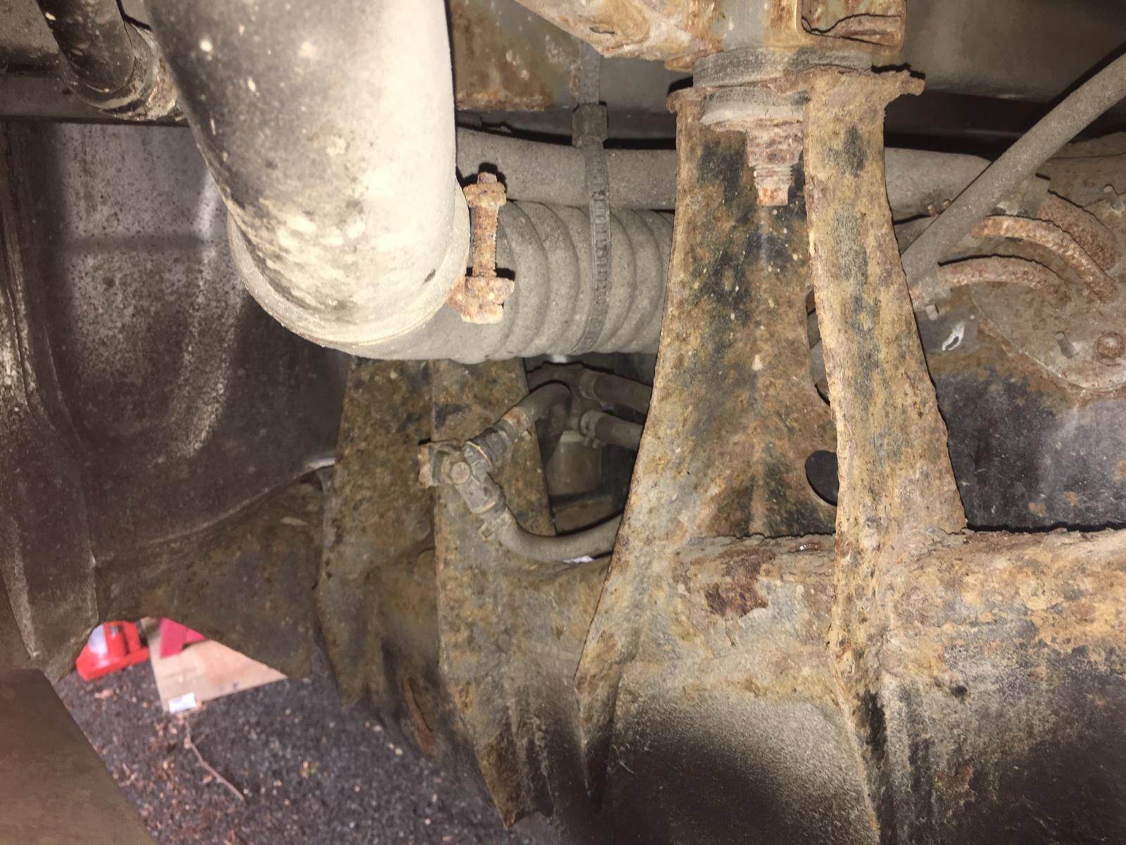

    You will have a straight shot to the filter from there

    Like I said, still tight, but you can get to it. First get your hand on the filter, unclip it from the mounting clip, and gently pull it out to towards you, there's enough slack on the hoses to do this.
    I didn't actually change the filter when I did this, didn't have a replacement on hand, just wanted to see if I could get to it. Unclipping the hoses and replacing the filter will be hard to do one-handed, and to get both hands in there you will probably need to remove the wheel to give you more room to work.

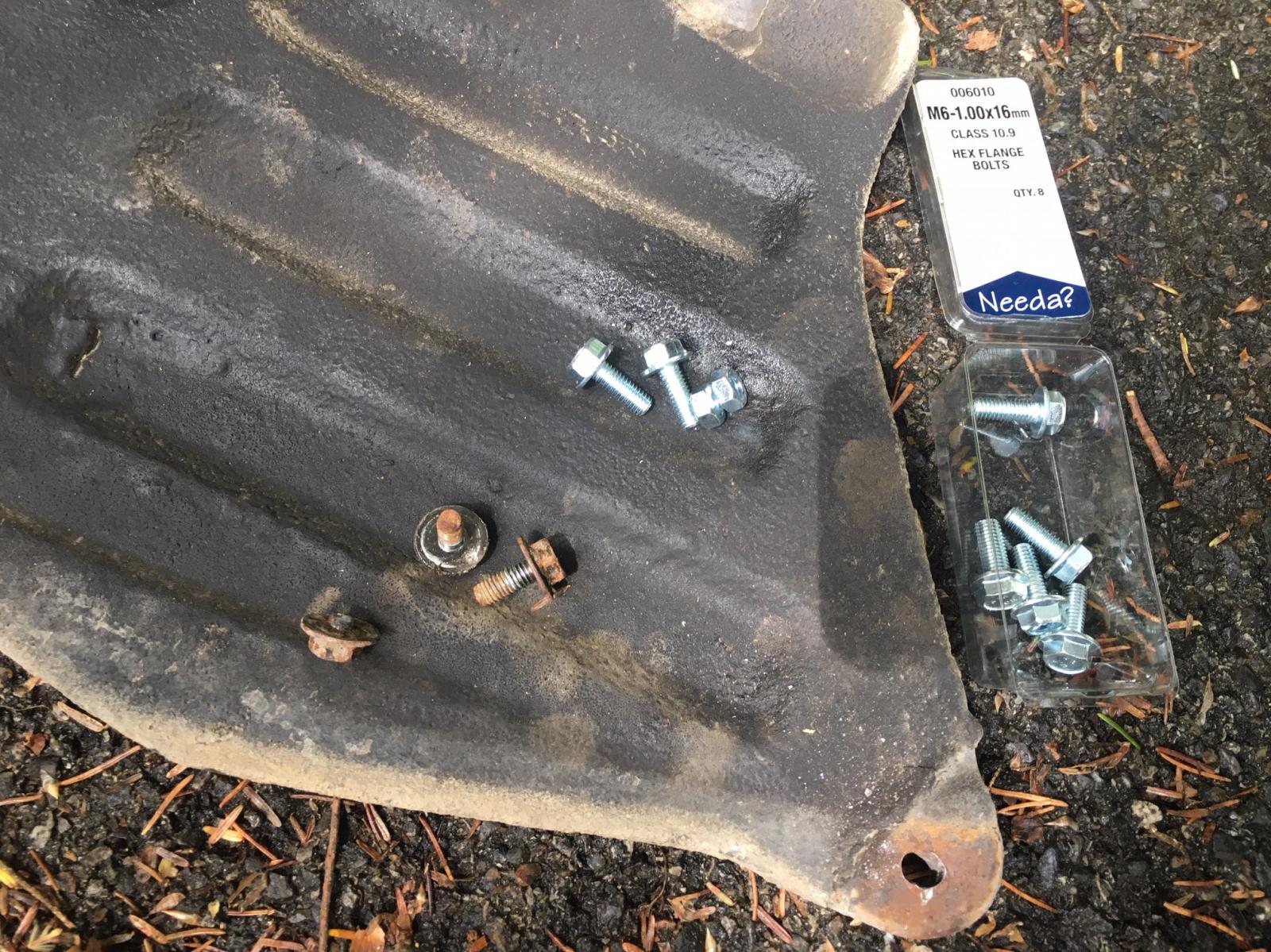

    Let us know how it goes once you attempt this. And you might want to have some extra nuts and bolts on hand for that panel, I broke two of them trying to get them out. Luckily they didn't really create much trouble, the panel still came off and I was able to drill out the remaining stems and replace with new ones like these
