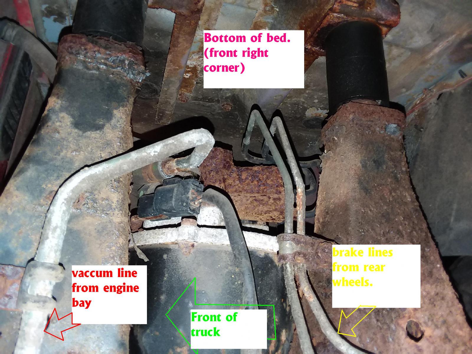

    i forgot to snap some pics of the rear brake lines and the odd capsule/canister i found in front
    of the right rear wheel, tucked up under the bed corner, has brake lines and vac lines going
    into it. i was following the 2 brake lines as i want to delete the load/pressure regulator unit
    that is mounted over the rear axle.... hoping i can delete all that shit and just have a brake
    line ( or even if need be) to the rear brakes. ill snap some in a bit & slap em up show u wat
    im talkin bout.

    I just don't know what this thing is. I'm leaning towards a vacuum tank to keep the booster & brakes harder if u stall out on a steep incline maybe, idk?????

    More pics from different angles ???
    What are these (marked in red)
    Attachment 22082

    those are the bed mount towers coming up off the framerails, the black cylenders atop them
    are the 4inch lifts. that shot is from above the driveshaft looking to the right over the right-side
    framerail. ill take more pics soon.

    Charcoal canister?

    nope its not the charcoal can. thats up underneath the hood.
    heres sommore pictures of the mystery can and where it is:
    Attachment 22085 Attachment 22086 Attachment 22087
    Attachment 22084 Attachment 22088 Attachment 22089

    IDK wat happened to the 1st mystery can post. mysterious.....
    try again
    realized theres a vacuum line that comes out of the top of this thing and into the rear right
    corner of the cab. im puzzled by this.:
