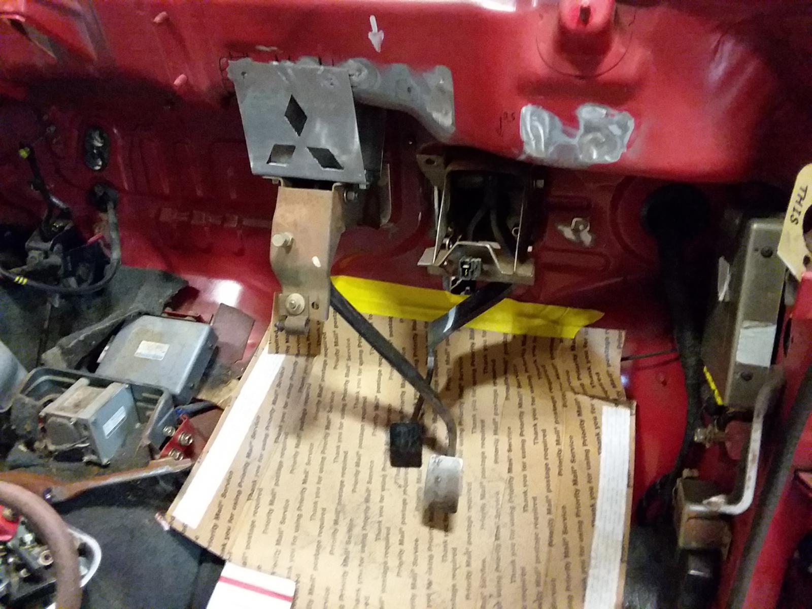

    heres where im at with the wipers. the linkage is mounted, but theres a tiny difference between
    the RHD & LHD linkage, i have to clock the end of the arm which bolts to the motor, see:
    need to get clocked 90 deg from 12 to like 3 or so.
    the wiper blade arms are also R/LHD specific, theres a wee little tweak that needs to go
    the other direction:
    and heres what they look like now:
    still need a little tweaking but theyre close. ive got it nextdoor tonight in the
    welding/body shoppe. gonna tryin get some firewall stuff welded in. hopefully
    weld in the wiper motor mount & fix the linkage. ill post up whatever i get done.
    gonna have a cup of tea and a schmoke & get to it. more pics in the wee hours
