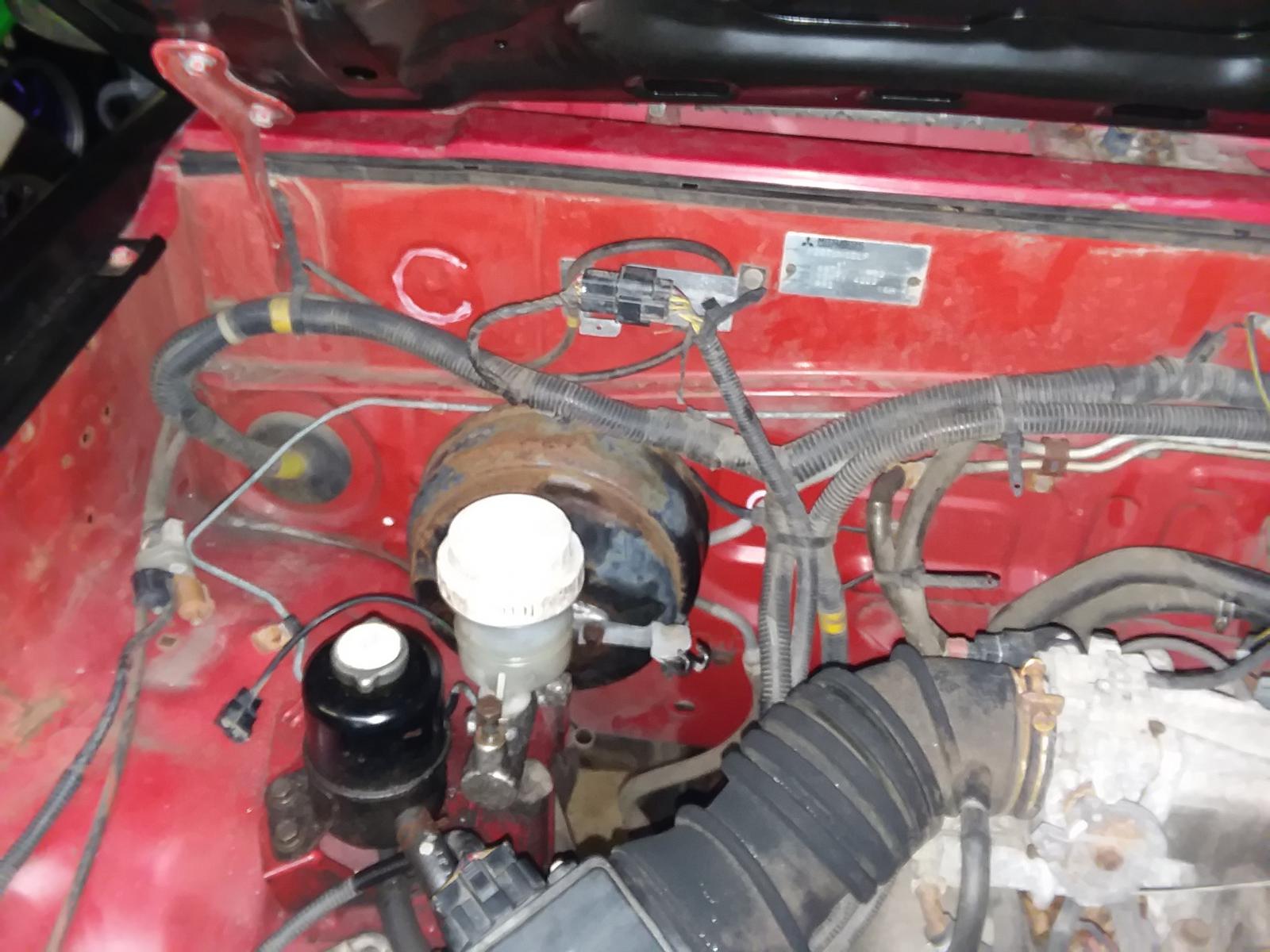

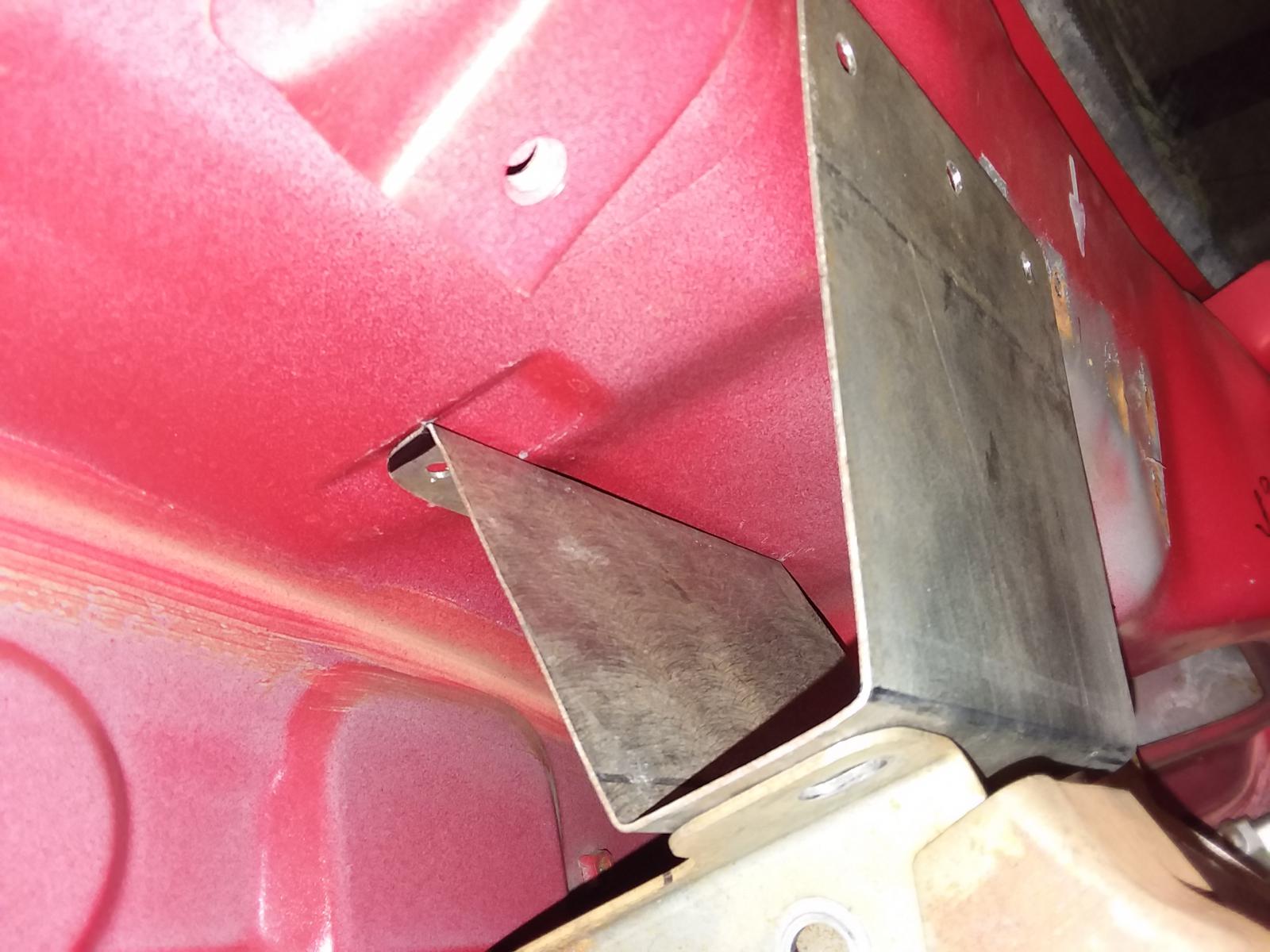

    so the brake booster is done. i still have to make the firewall re-enforcement plate. you can see it here better, it actually
    goes all the way down and surrounds the steering column port as well as the gas pedal mounting holes.
    i still gotta make mounts to the raintray inside the cab, and tweak the pedal arm a bit.
    but its damn close i think.

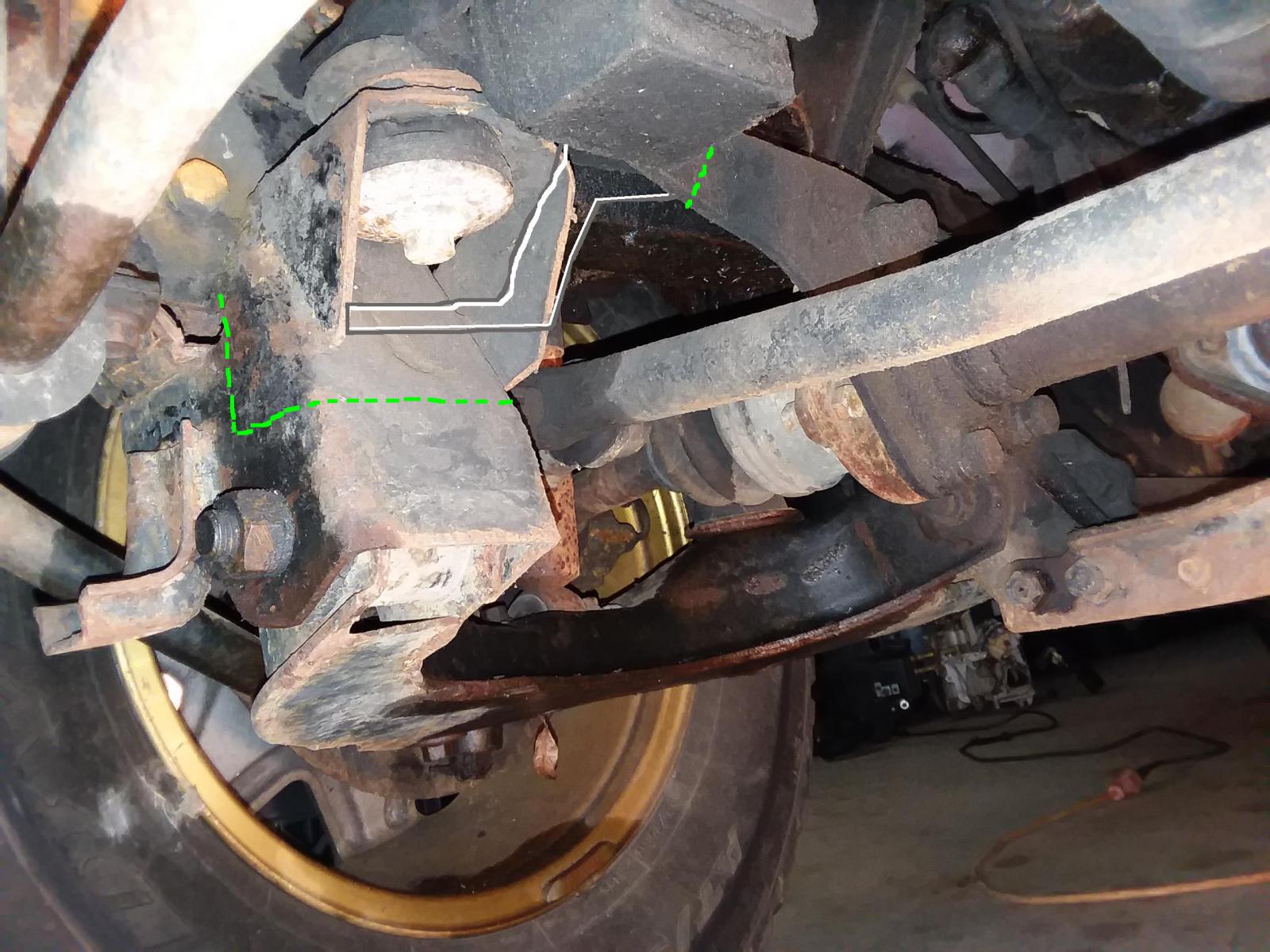

    so i been looking at the steering box and the frames mounting holes, i think that modding the right front axle
    mount arm to go down, and if one cut off the front most mount and moved it down & out of the way of the steering
    box pivot to the drop link (hope thats the correct name) somthing like this:
    the green is the cut and notch of the lower c.arm bracket, the grey is kinda how the arm would need
    to go to clear the frame enuff for the LHD box to mount inside the framerail instead of a mirrored RHD steering box
    it wouldnt change the offset over the framerail but maybe an inch towards the center of the rig.
    from the OEM angle the column is on from the wheel to the box right now, i dont think this would be any
    more of an angle. the only thing that would be off is the distance between the pivots of the steering box
    and the idler arm. i was hoping the idler arm mite take up the difference, idk my experiance w this kinda steering
    is a week old.....
    perhaps someone with some deeper knowledge of steering setups might help dissuade this idea????

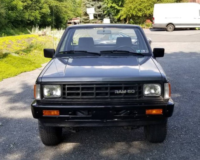

    Oh, I see. But again, it looks like the bezels line up with the hood, the same way the square light bezels do. So it looks like what's too big is the parking/turn signal lights. If you trim the bezels it wont line up with the hood and might look weird.
    I bet you that if you used the Ram 50 parking lights it would be the correct width.
    There's a version of the lights (sold in the Australian market, I'm told by my friends here) that is two tones, amber and clear like the Montero, and fits two bulbs, one for parking light and one for the turn signal. Here is one with the silver trim, could't find a black one just now, but I know they are out there as my truck has them:
    https://www.ebay.com/p/MITSUBISHI-CC...GHT/1229981465
    Here's a picture of the front of my truck, you can see how the two tone corner lights look like (and also confirm that the square bezels line up with the hood, like the round one do)
    Just a suggestion, might be worth considering, as the trimmed bezels could end up looking weird.

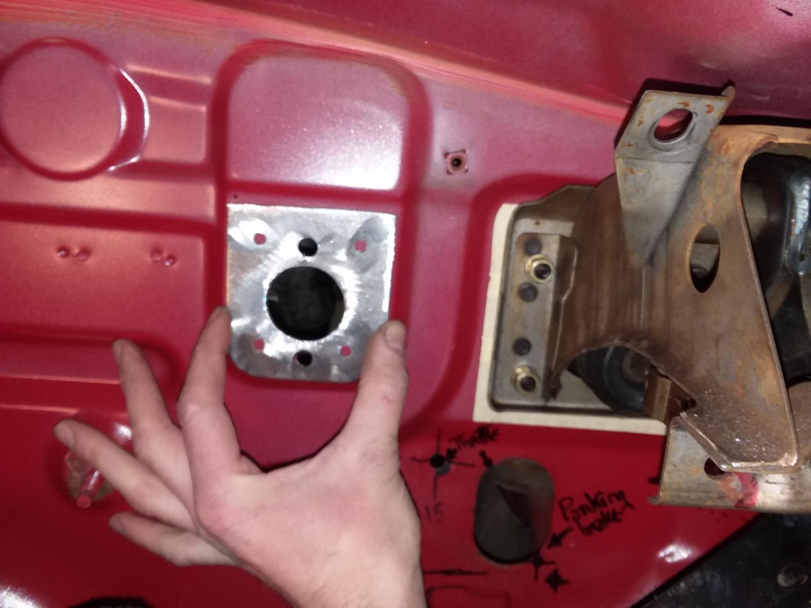

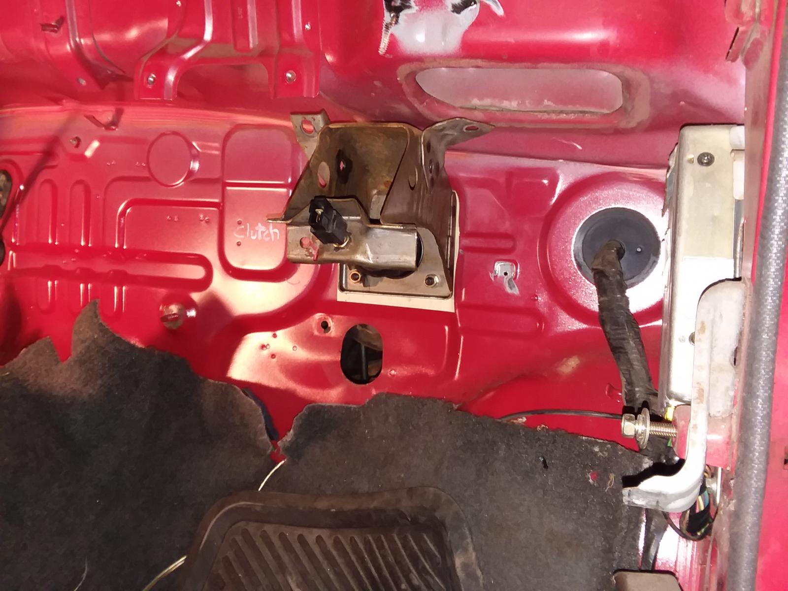

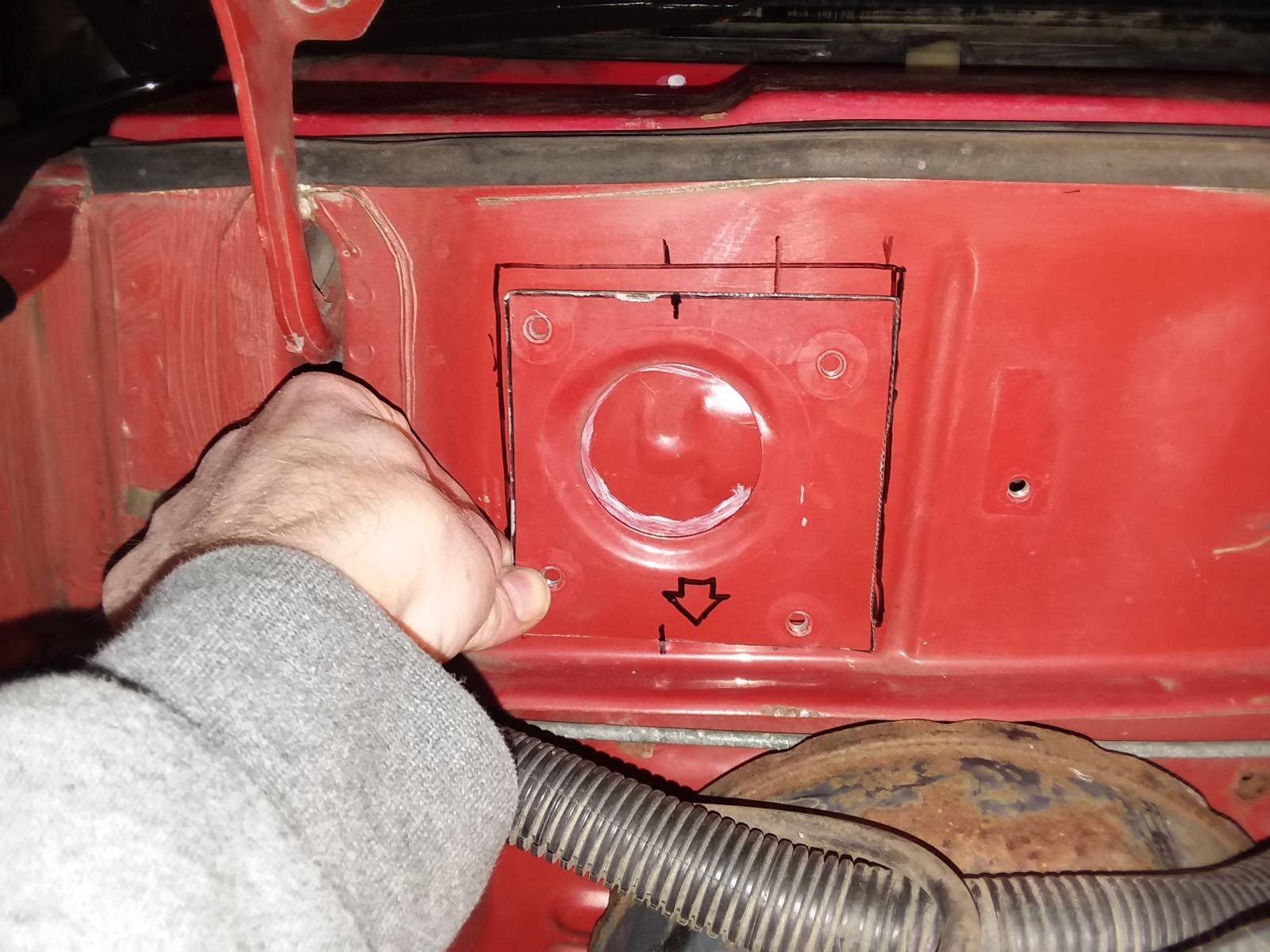

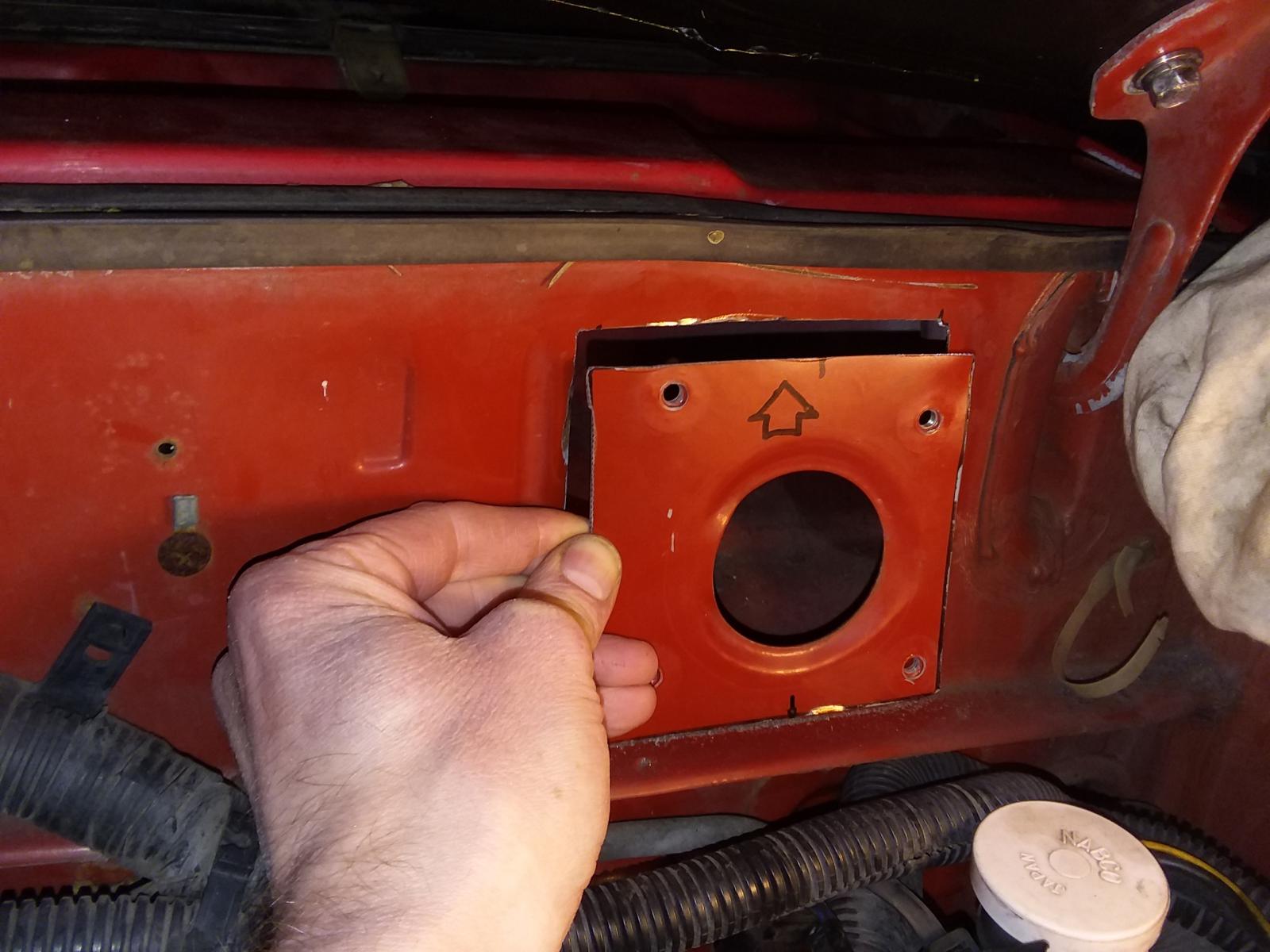

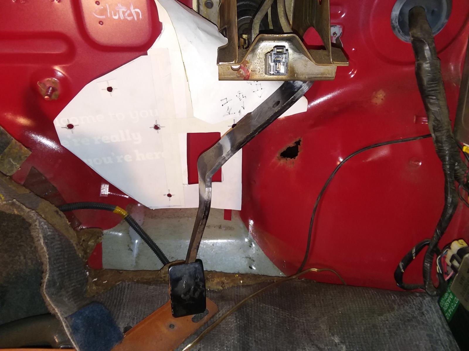

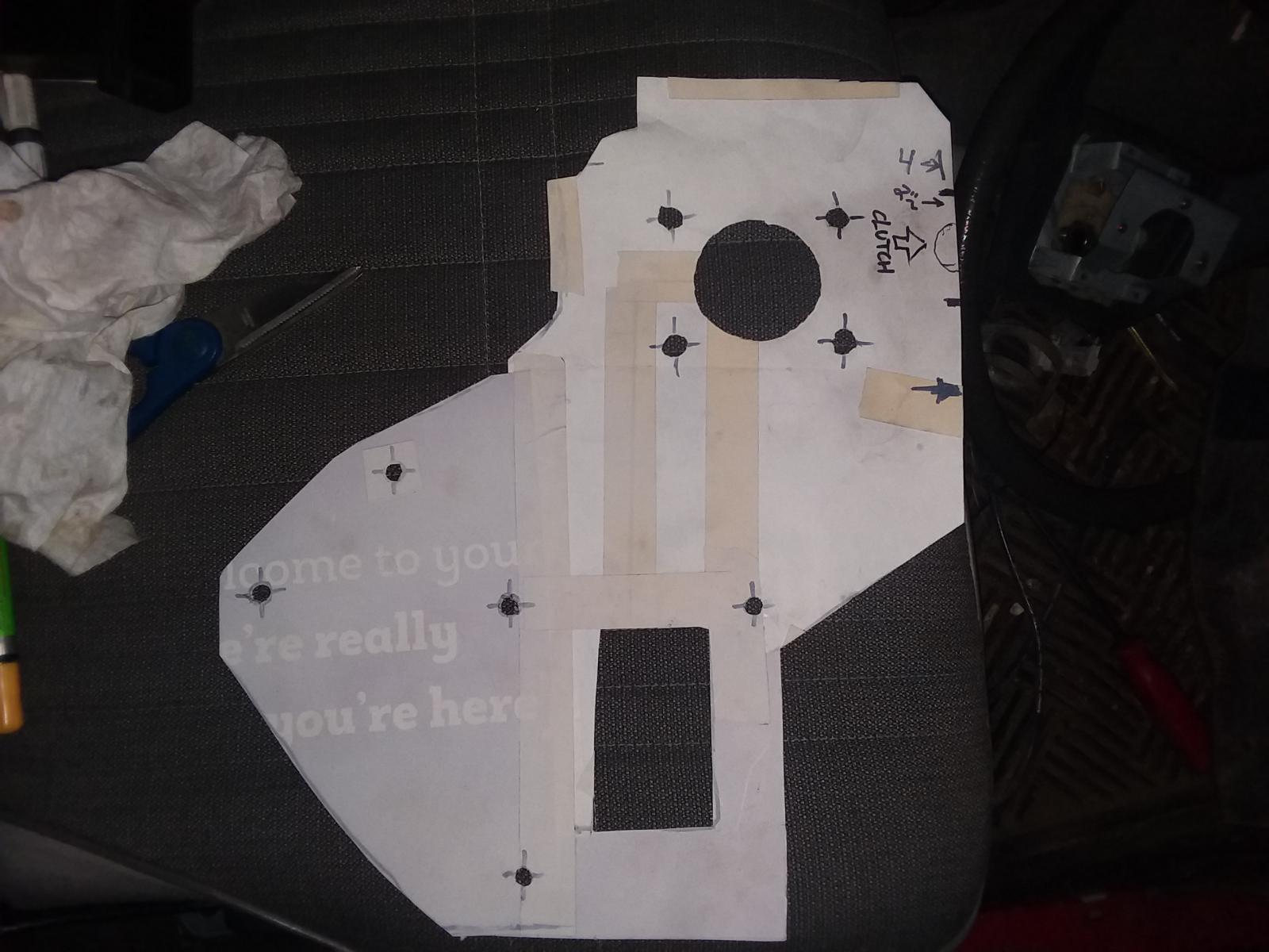

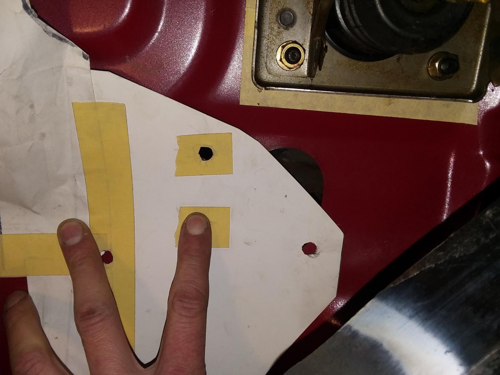

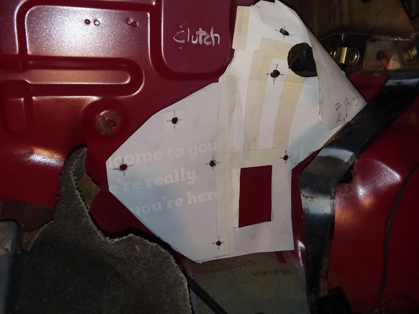

    so i made a template of the OEM firewall re-enforcement plate for whatever stupid reason
    as afterward i realized that its a totally different layout on the right side of the firewall...
    whatever.

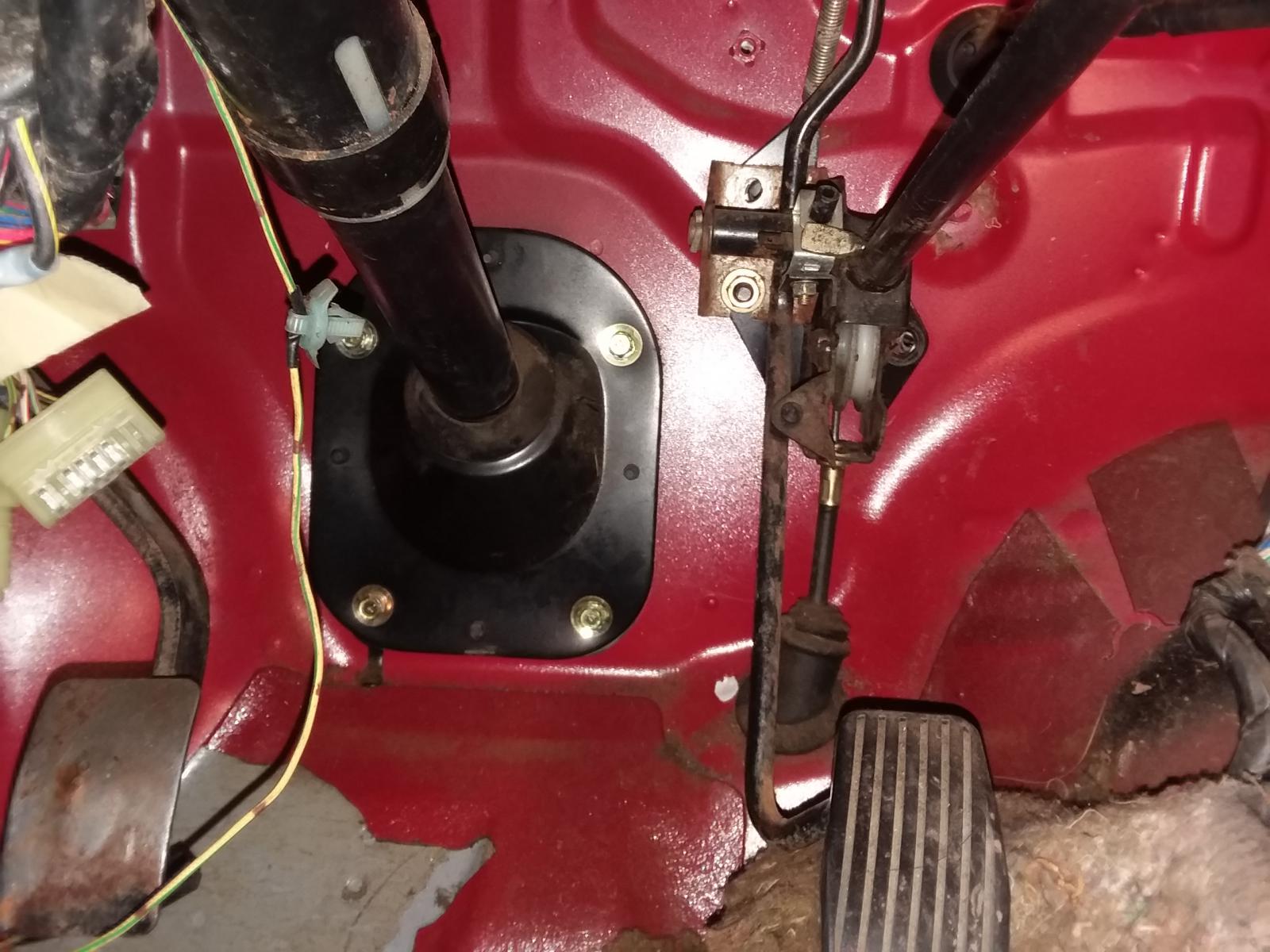

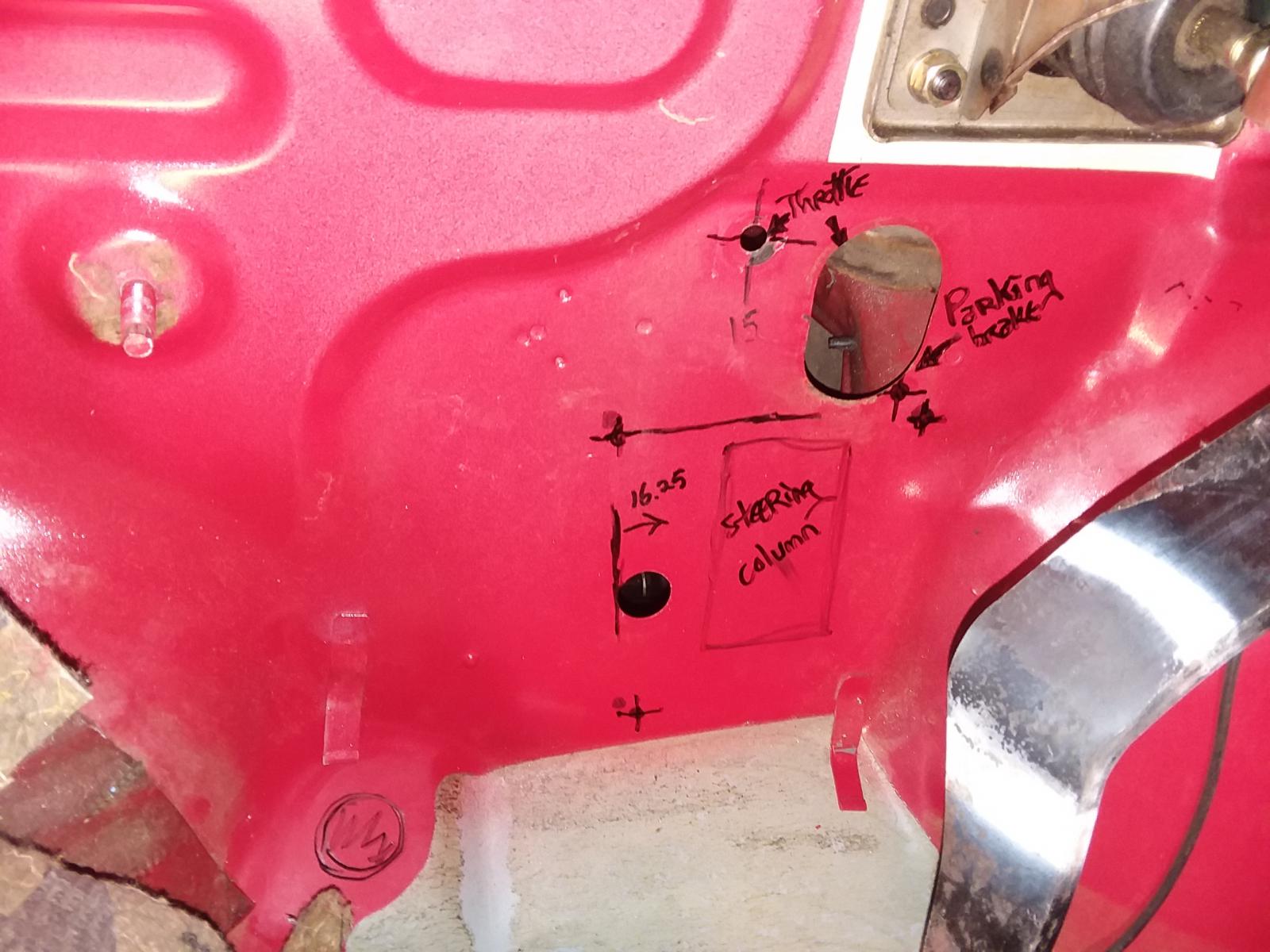

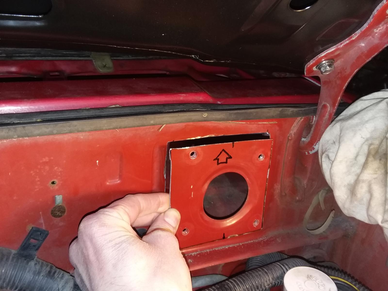

    and i started to lay out the steering column port, its actually kinda in a similar spot as the
    LHD template, im not going to drill/cut anything until the box arrives and i can move the
    steering wheel permanently on the RHD-side. then i can see where the hole needs to go.

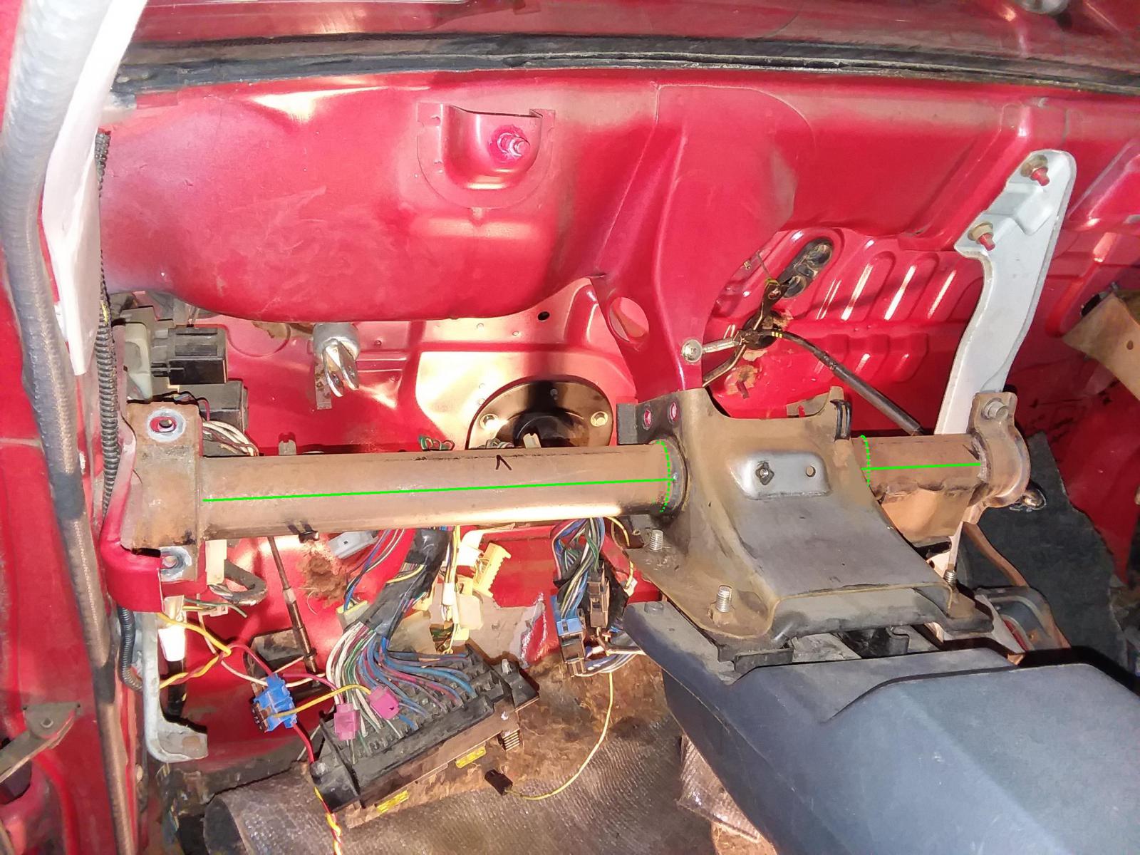

    i dont think there is ANY kind of flex or u-joint INSIDE the firewall, the 1st on the column is
    just past the firewall in the engine bay, the 2nd is down at the box. so the firewall hole/port needs
    to be in the correct spot, then the shafts bushing/seal unit can get bolted to the firewall round it.
    20190310_001543.jpg20190310_001242.jpg20190310_001318.jpg20190310_002530.jpg20190310_002428.jpg

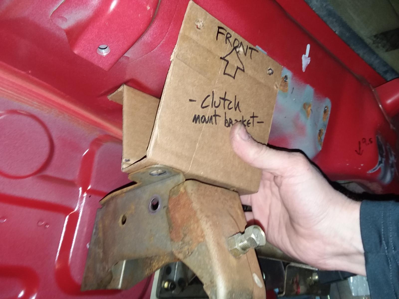

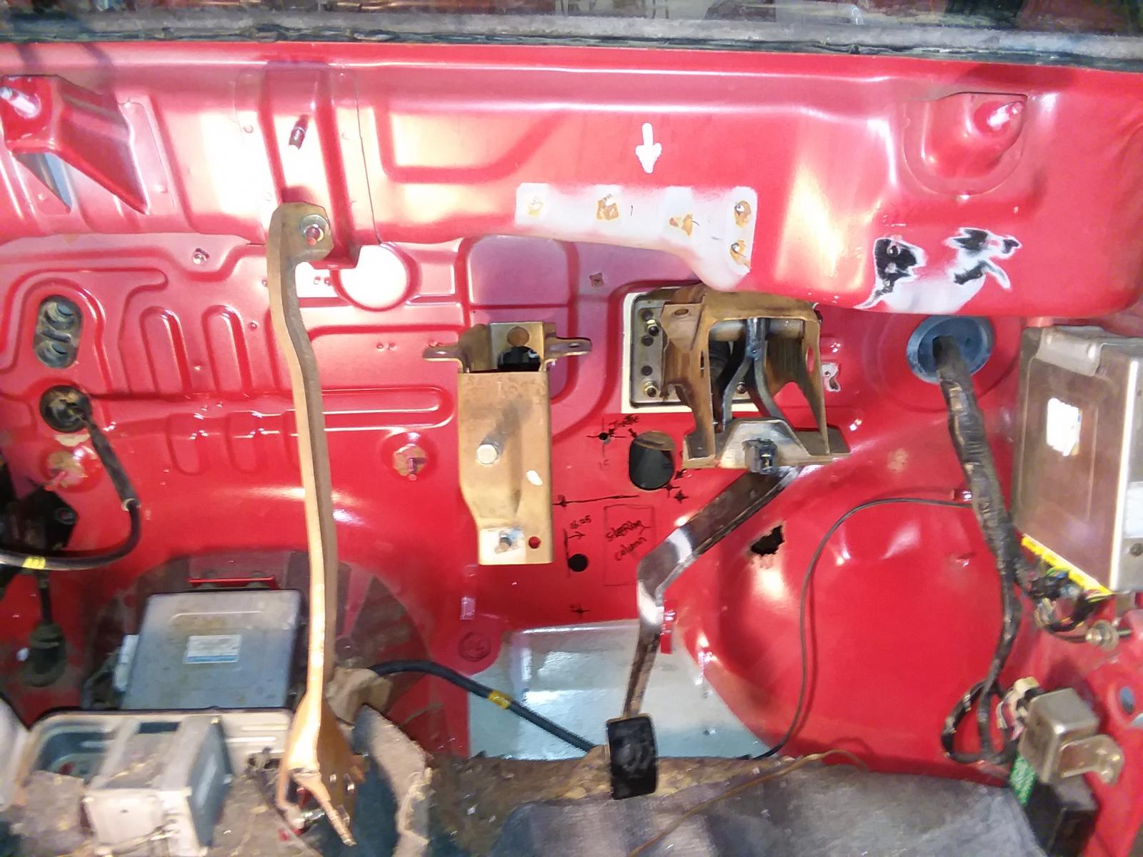

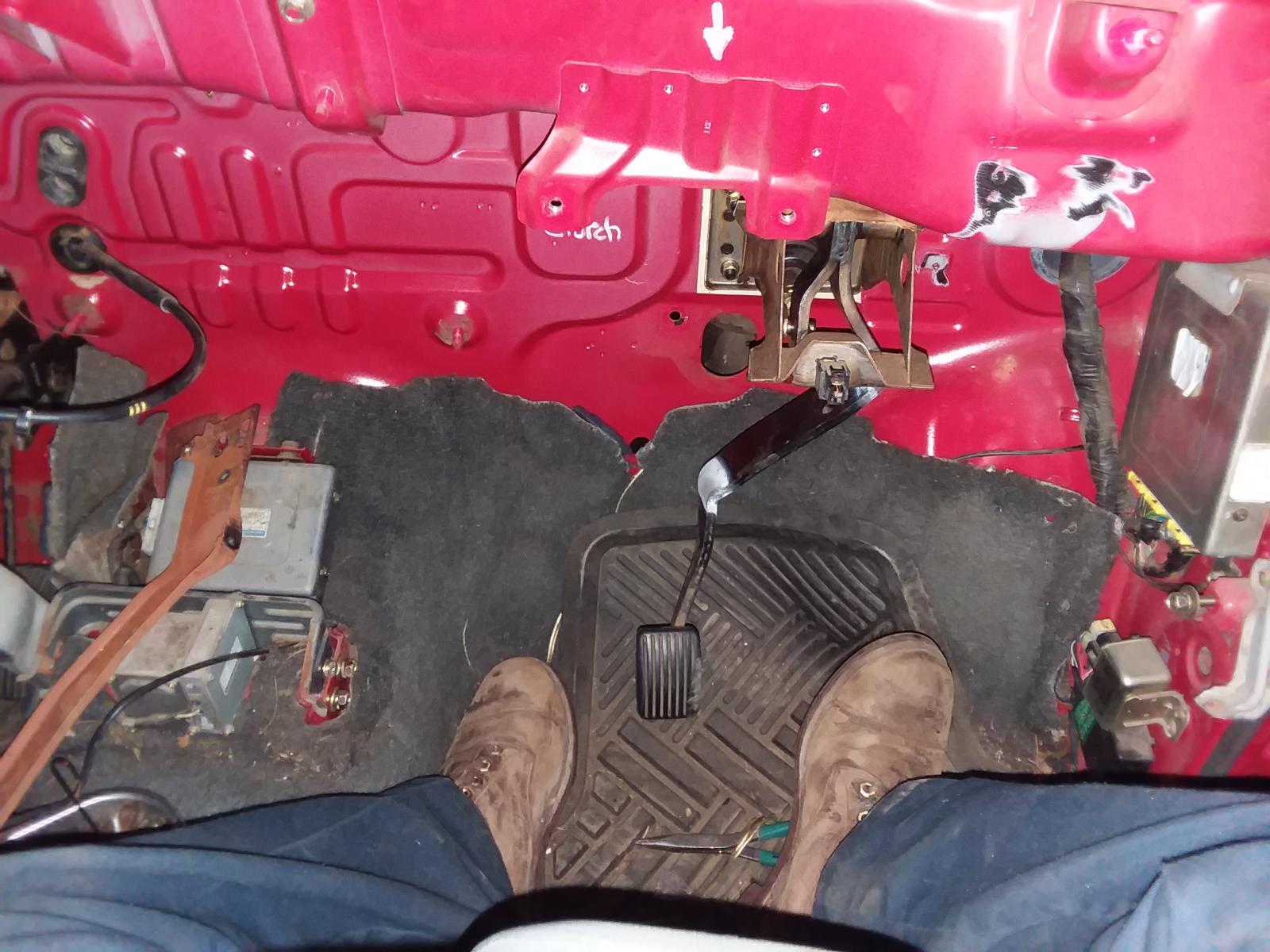

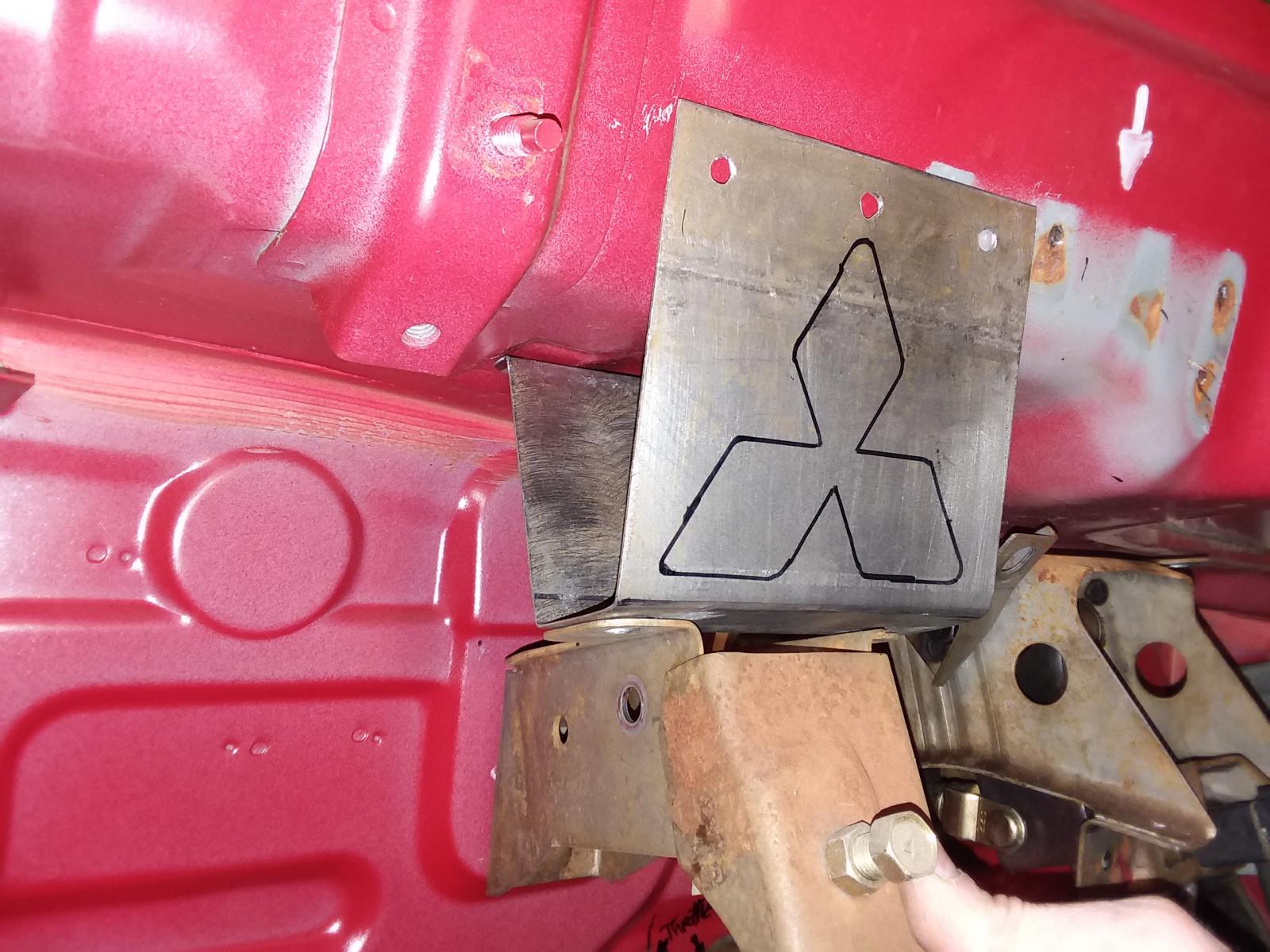

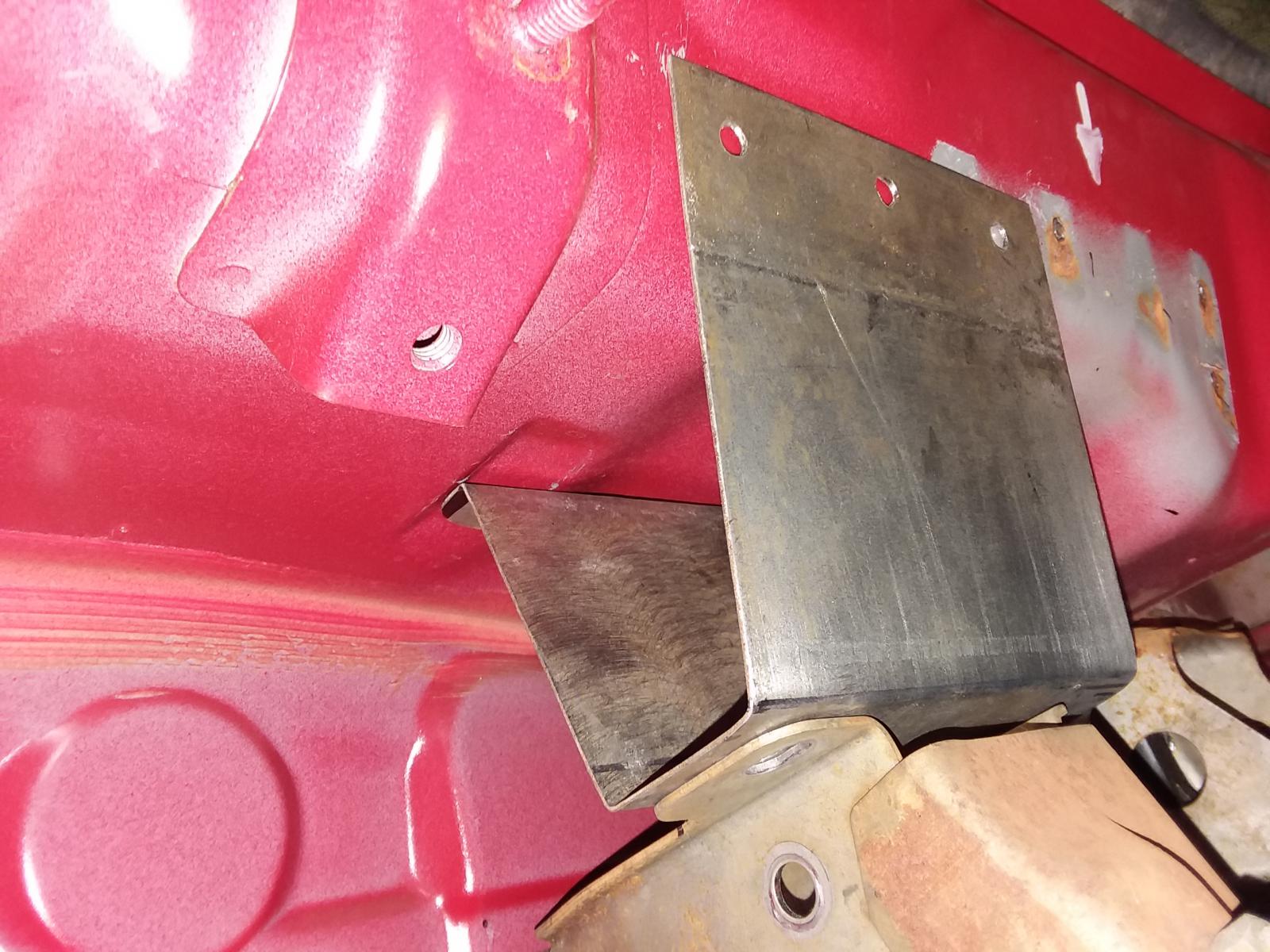

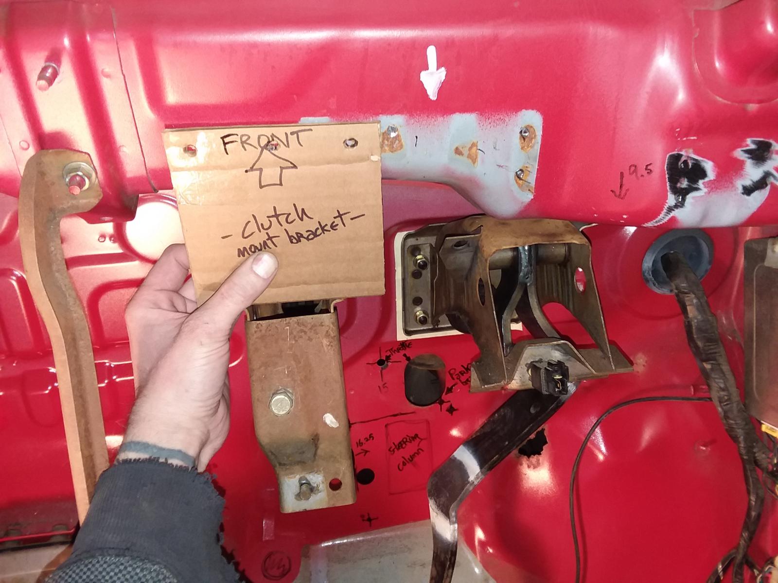

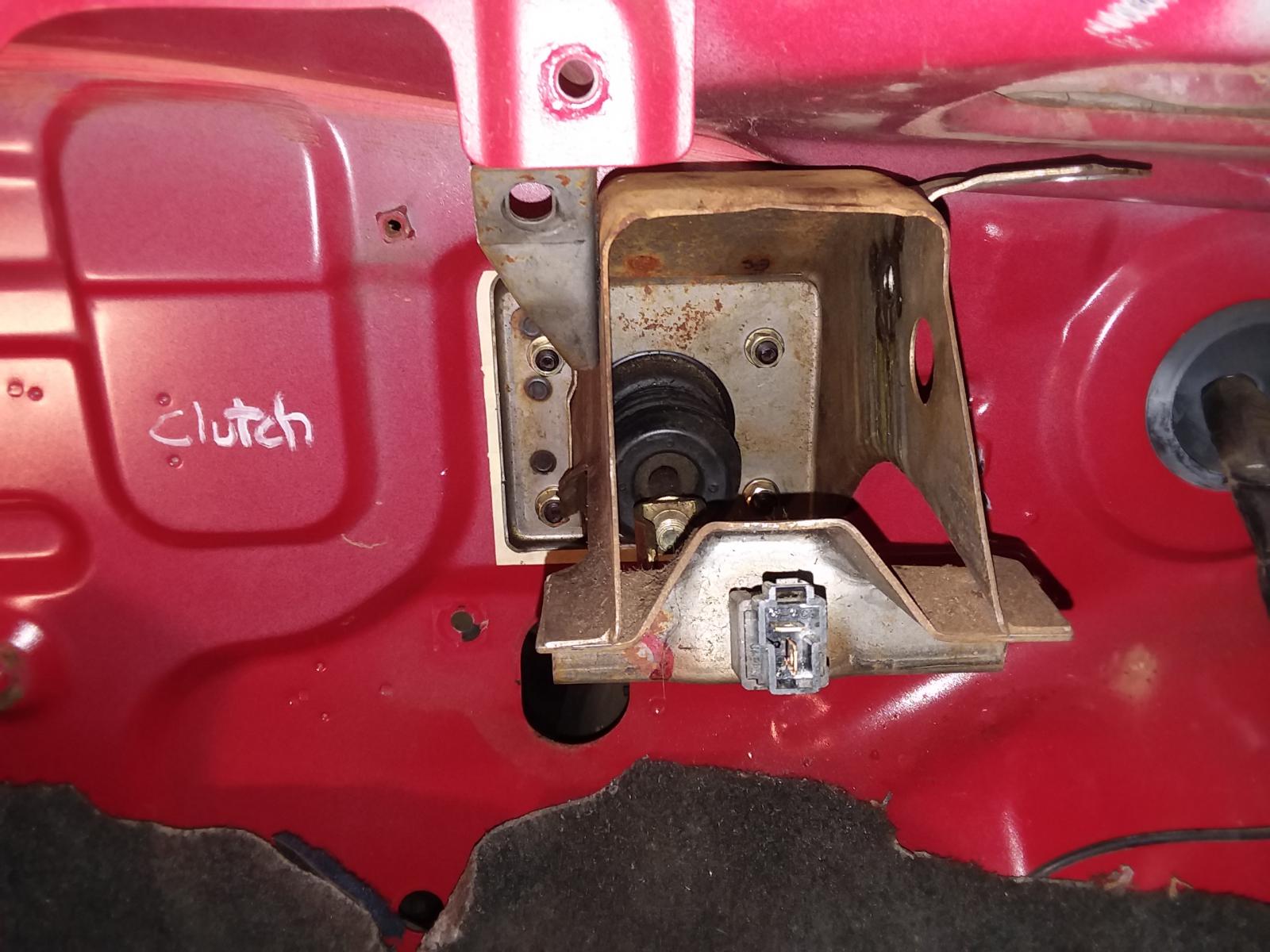

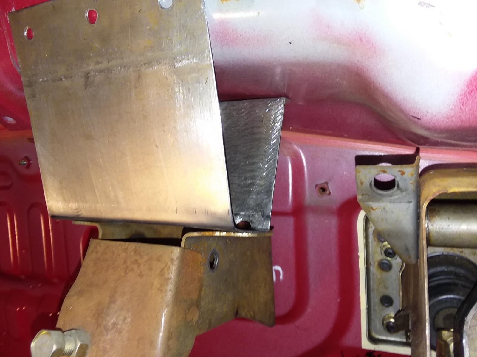

    But i got the clutch located, hole cut and stud holes drilled, the support plate cut out, ready to spot-weld onto the wall.
    mounted the pedal unit and started fabbing the support bracket that gets welded to the firewall under the windshield:
    and got my wiper linkage pulled out to move over. what a bitch. only x2 of the x6 nuts were NOT rott-welded onto the studs
    managed to get a small set of needle nose vicegrips into the raintray and grabbed onto the bases, after i ground off the tip
    of the studs flush with the nuts, so as to ease removal and not have to spin the nut over crusty blown up rotted metal,
    but still saving enuff of the stud to re-use the linkage assm.

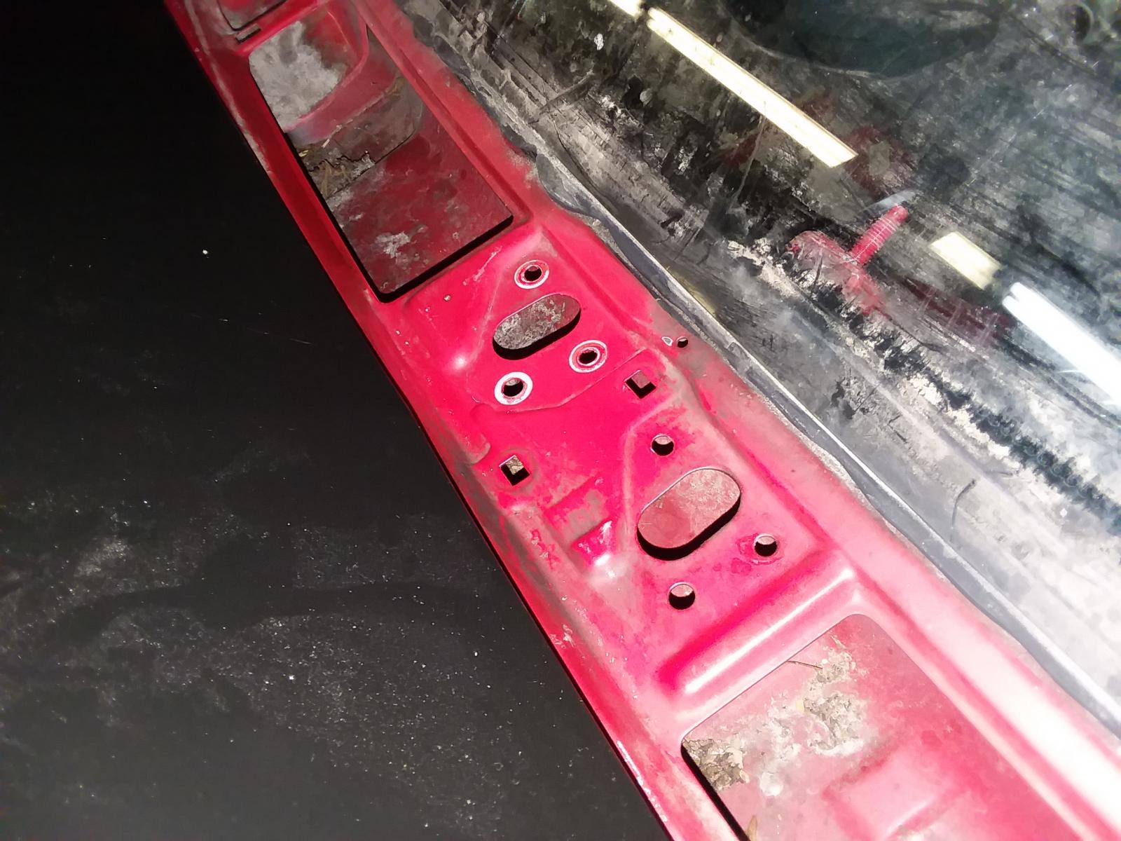

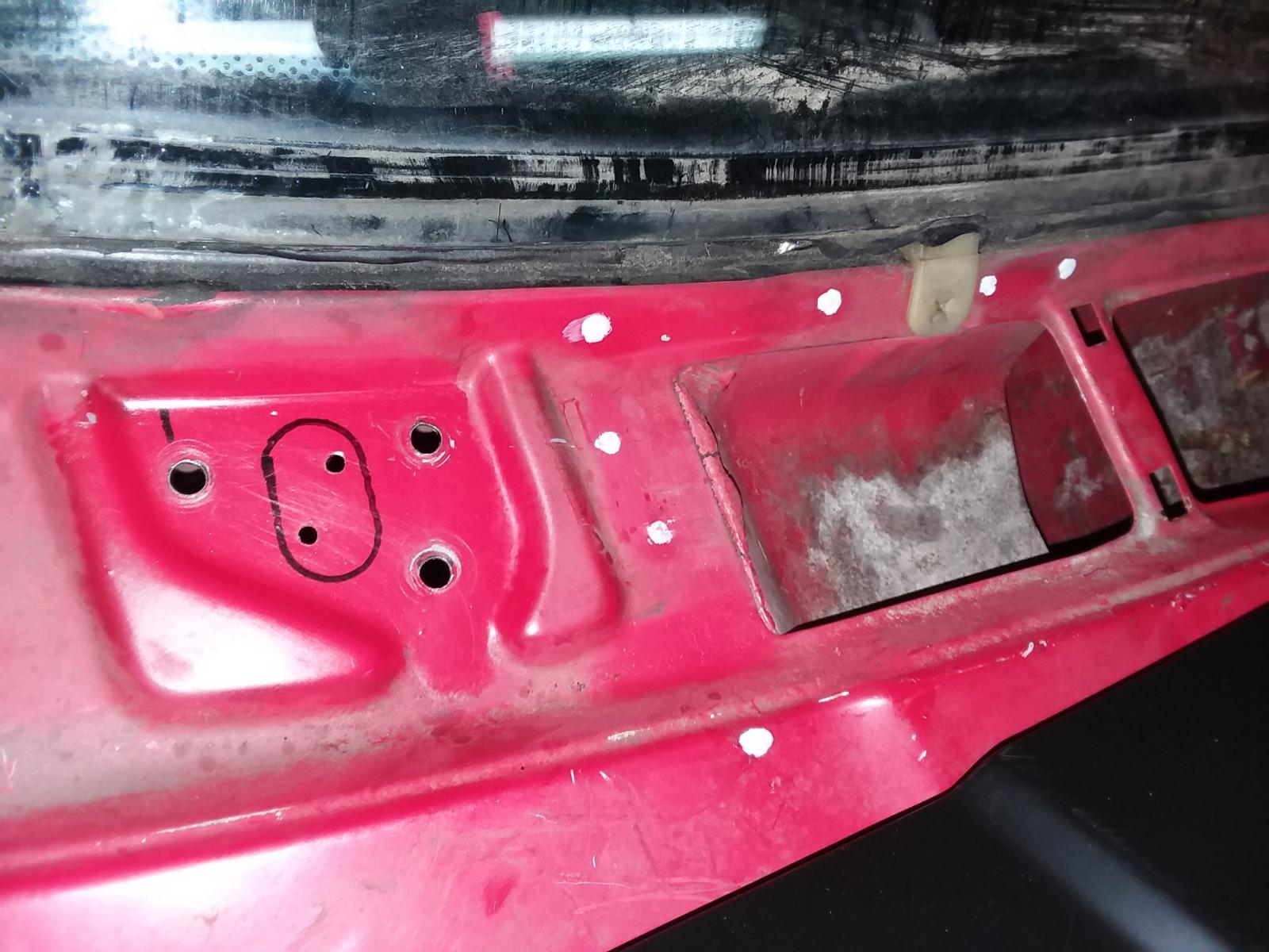

    the factory punched out the 1st hole pattern for the wiper-stem & studs of the RHD set, but the furthest set is not theref
    or whatever reason. so i transferred the pattern over and drilled out the stud holes, ive yet to cut the big slot for the stem.

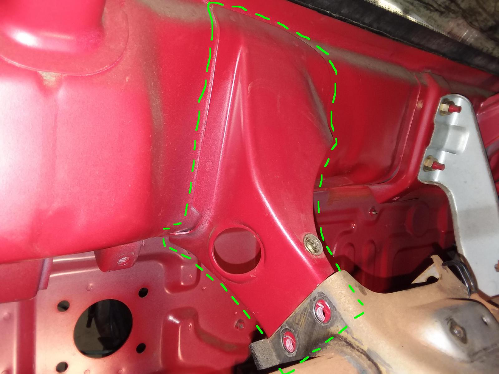

    you can see there is this drip shield thing to cover the inlet of the blower motors fresh air intake, ive gotta cut that out
    because the wiper linkage doesnt clear it. i was going to tryin drill out the spot welds, u can see them in white paint marks
    but then i thought better of possibly blasting holes thru my cowel and firewall, so i think im gonna use a cutoff wheel and
    slice iit out flush under the cowel, then weld a flange back on it and transplant it to the left side for the new blower intake.

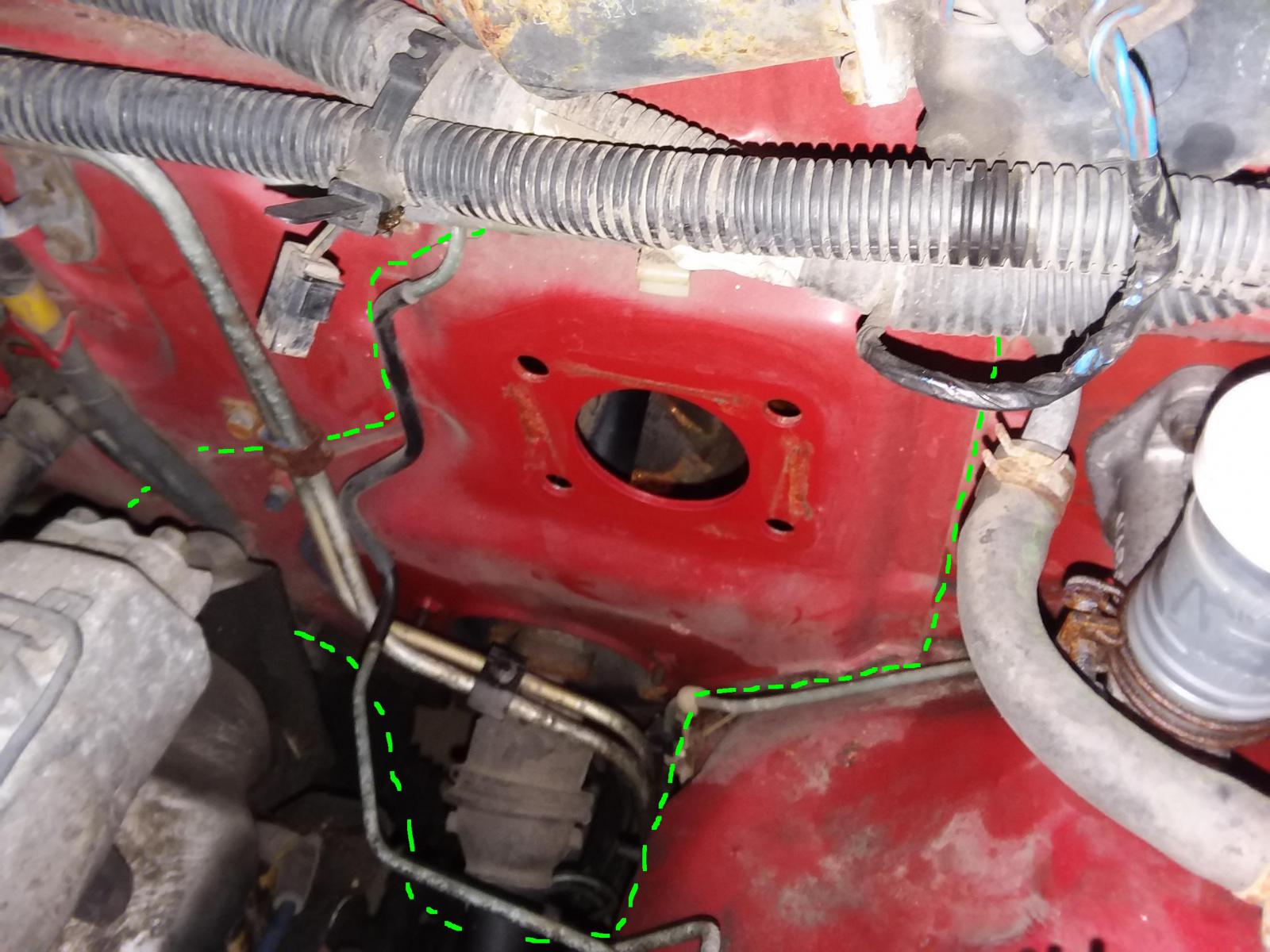

    And the wiper motor has to get moved over as well, so i cut out the part of the firewall/raintray wall that the mounting
    bosses/weldnuts were on (which i only did when i couldnt reach the 4th of x4 wiper linkage studs w the vicegrips, like a jerk)
    so im swapping the pieces of the firewall so the Left side looks how it would OE RHD, theres a funky C-shaped indent where the
    motor mounts up to the firewall, see:

    body panels. i finshed the clutch pedal support backet, just need to weld on m8 nuts and spot-weld the whole
    onto the firewall above the column:

    i finshed the clutch pedal support backet, just need to weld on m8 nuts and spot-weld the whole thing
    Attachment 22026Attachment 22027Attachment 22028Attachment 22029
    IF that damnable steering box and idler arm ever show up, the next thing is going to be cutting and modifying
    the steering column support bar that mounts under the column from the side of the cab to the bolt-in upright
    at the center console. the long side needs to switch with the short side thusley:
    Attachment 22030
    then i think im going to re-use the upper column support, its just so pretty.
    but in all honesty, i can actually re-use it because the firewall on the right side is the same height and
    shape as the left. most of the other parts were at different distances from things in there new RHD locals...
    im planning on replikating the OEM pajero dashboard out of sheet steel, its all straight bends across the span
    of the wind screen so i shouldnt be too difficult to do. ill probly omit the middle vents as i never
    use them:

    jesus WTF.
    heres the 1st 4 pictures:
    20190312_212754.jpg 20190312_212834.jpg20190312_212841.jpg 20190312_220808.jpg
    and hell yeah im gonna plasma out the mitsu emblem on that bracket.
    and the 5th pic that didnt load properly

    Definitely NOT looking forward to adding 4 foot of wires individually to extend that chassis harness to get it to reach
    the right hand side. I don't wanna wait or pay for the proper one so F it. Give me something to do while I wait
    for these steering bits to arrive....
