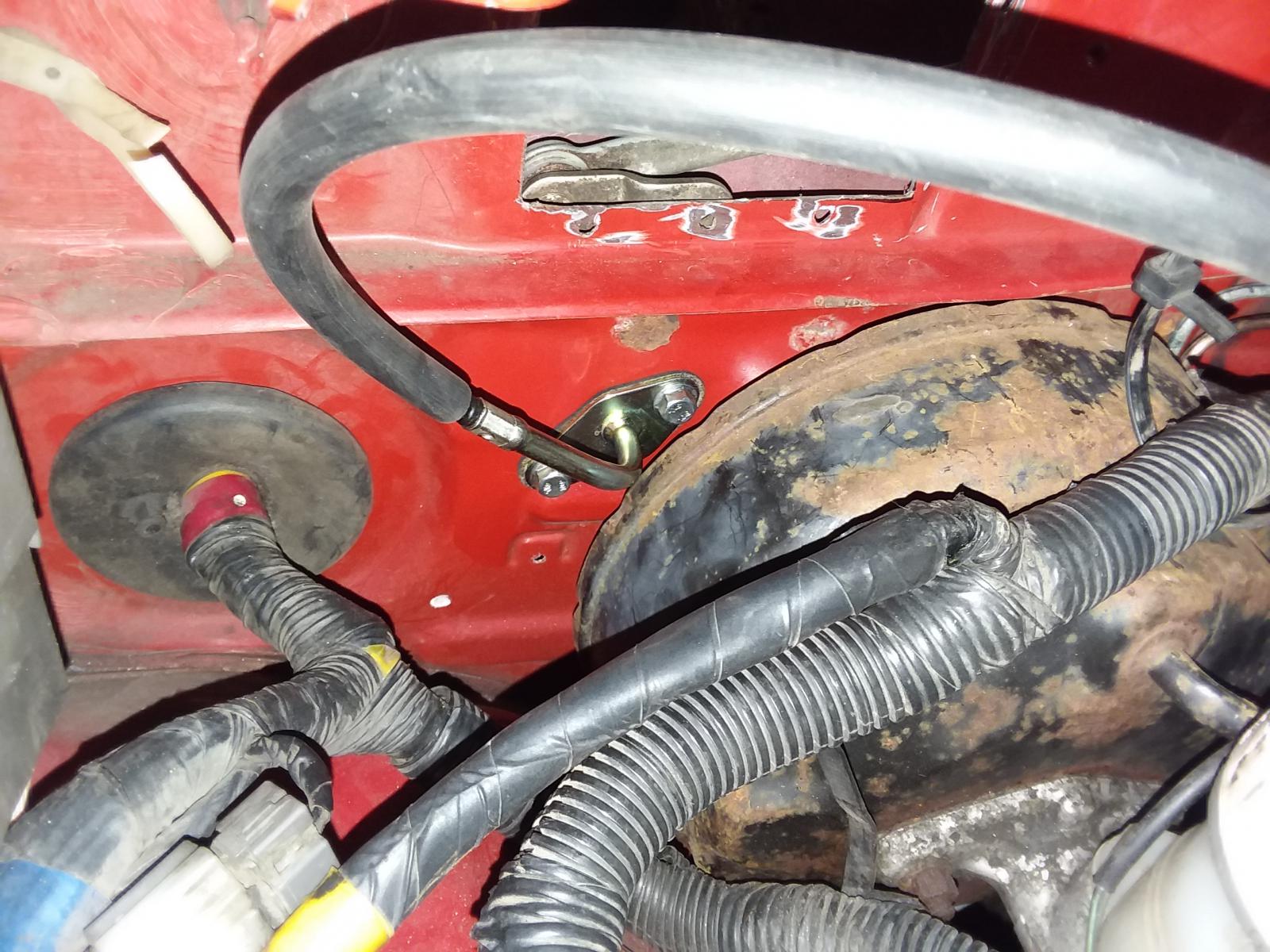

    Wasted a bunch of time running around looking for a new fitting for the return line w nothing to show.....

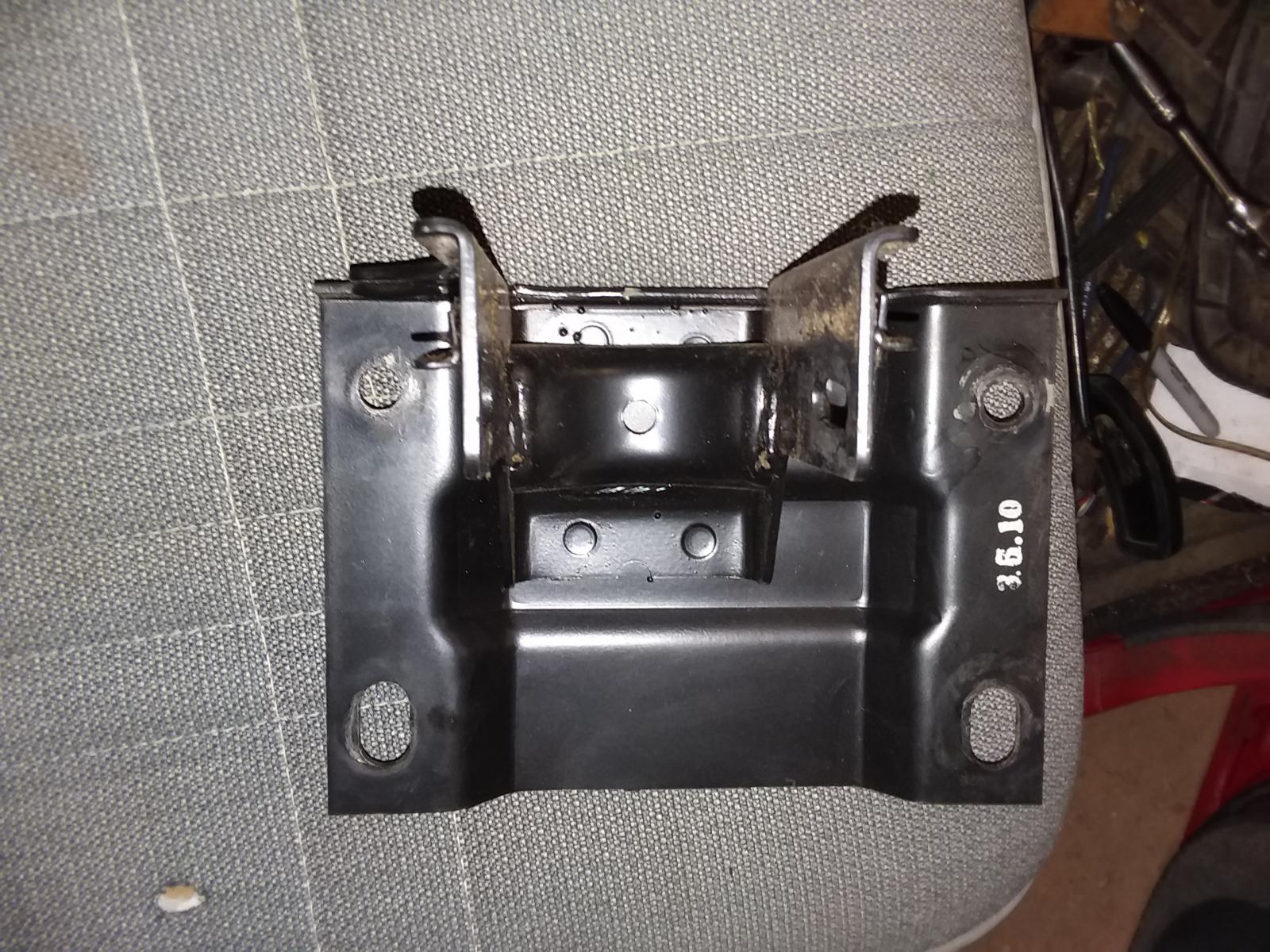

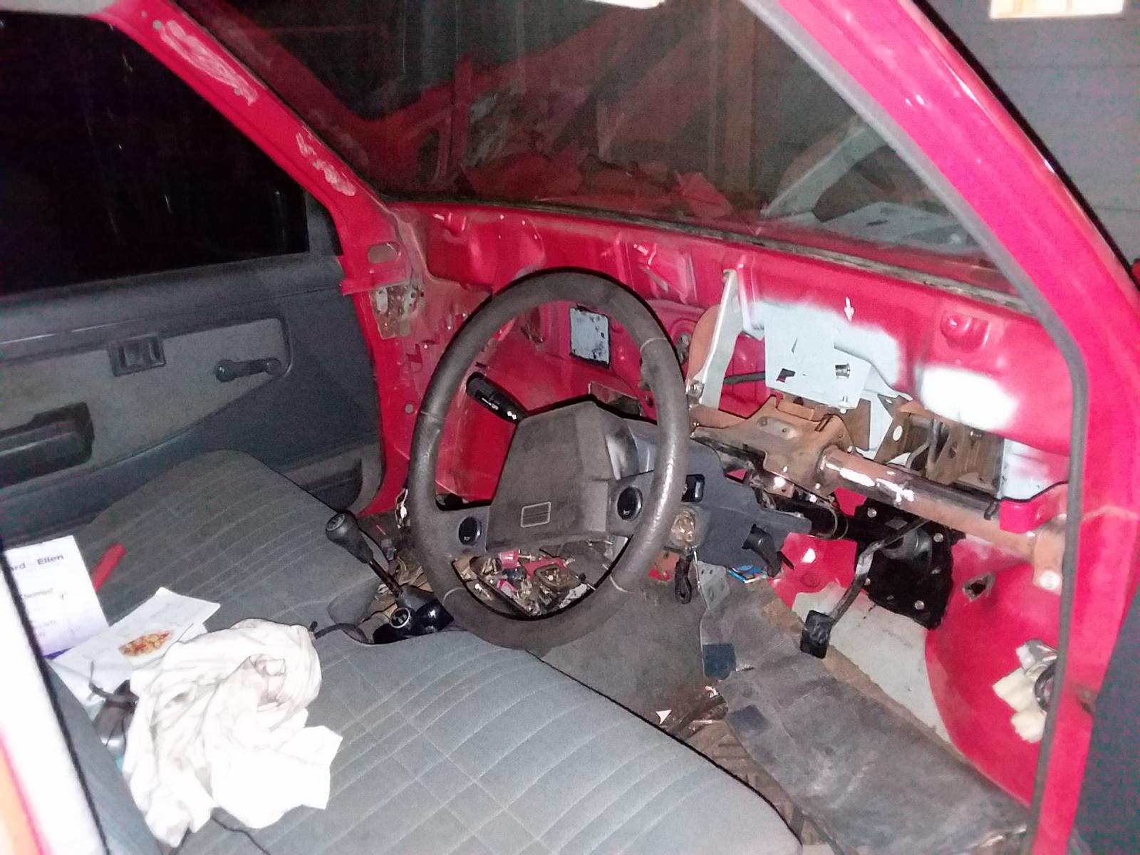

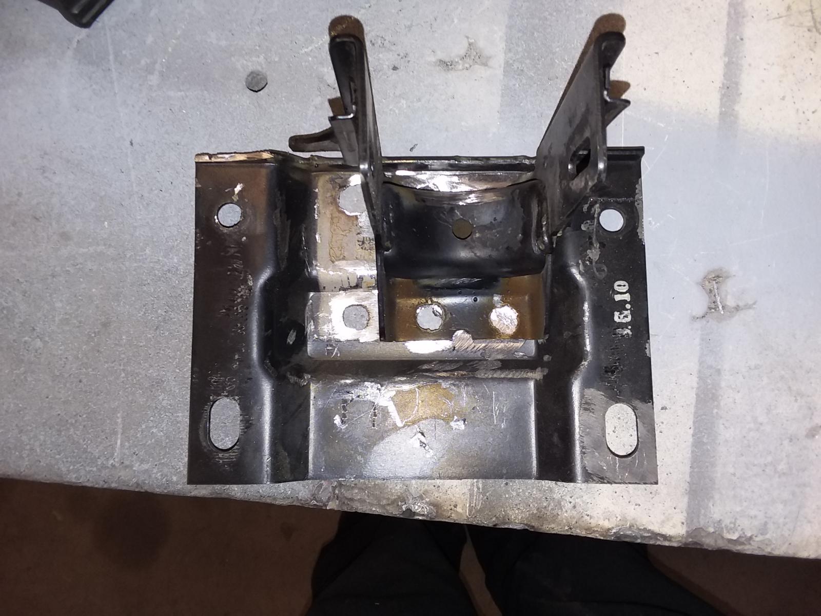

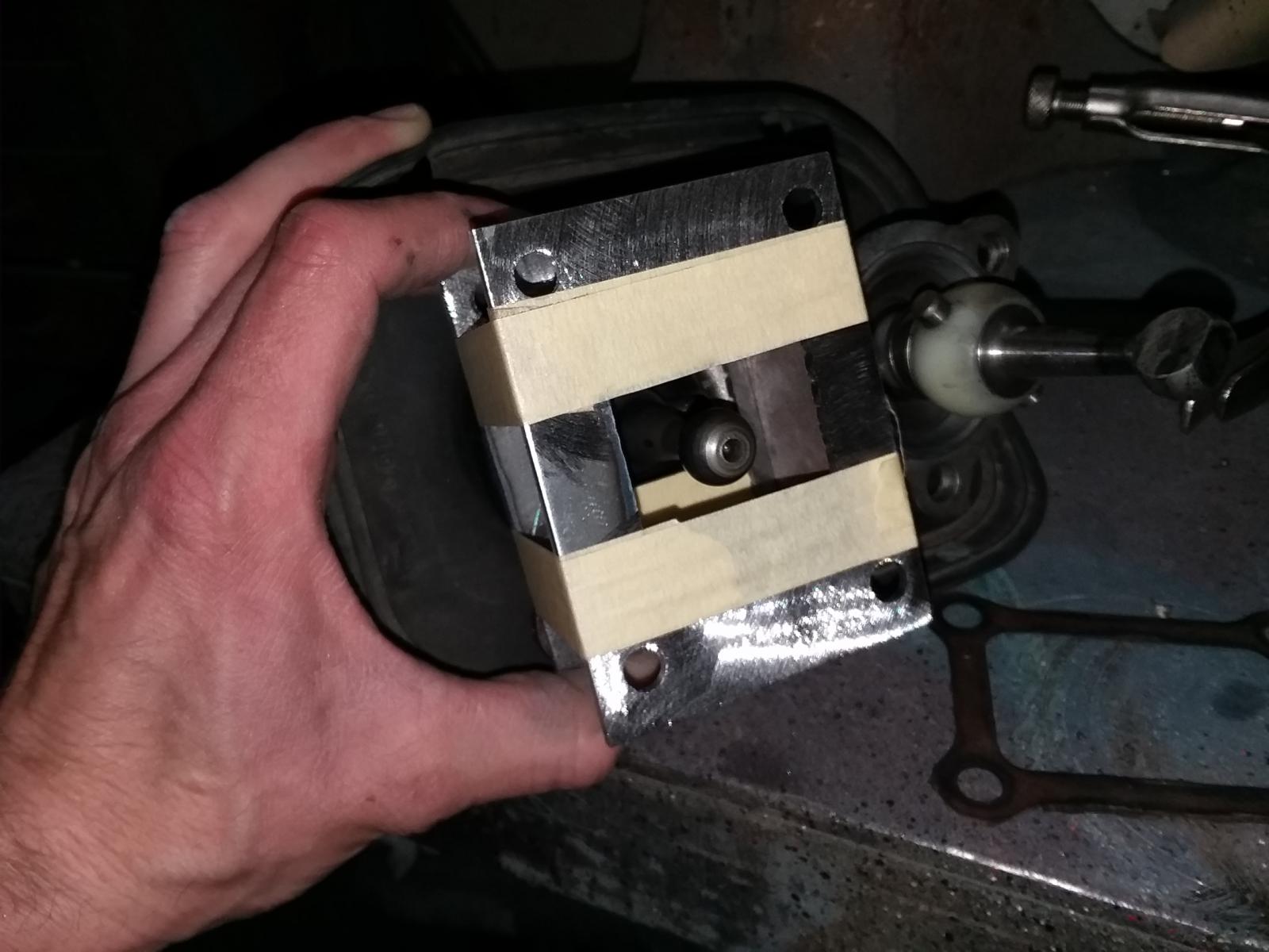

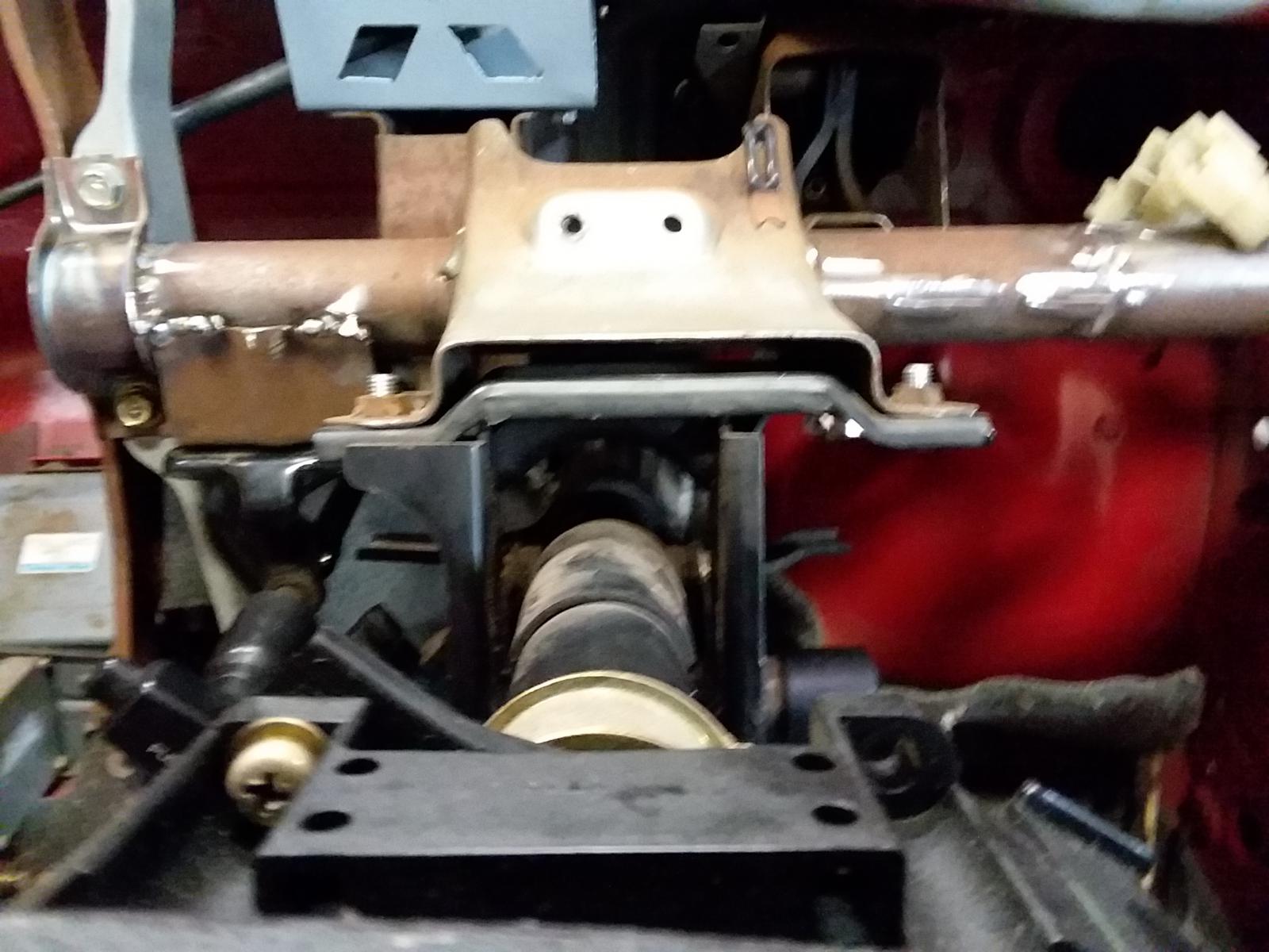

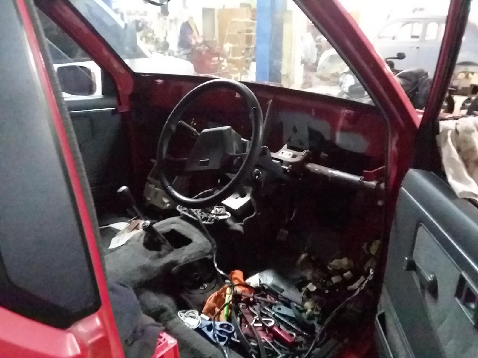

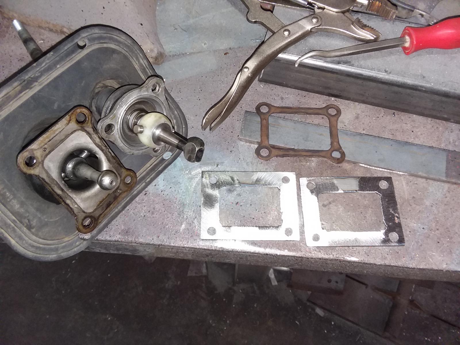

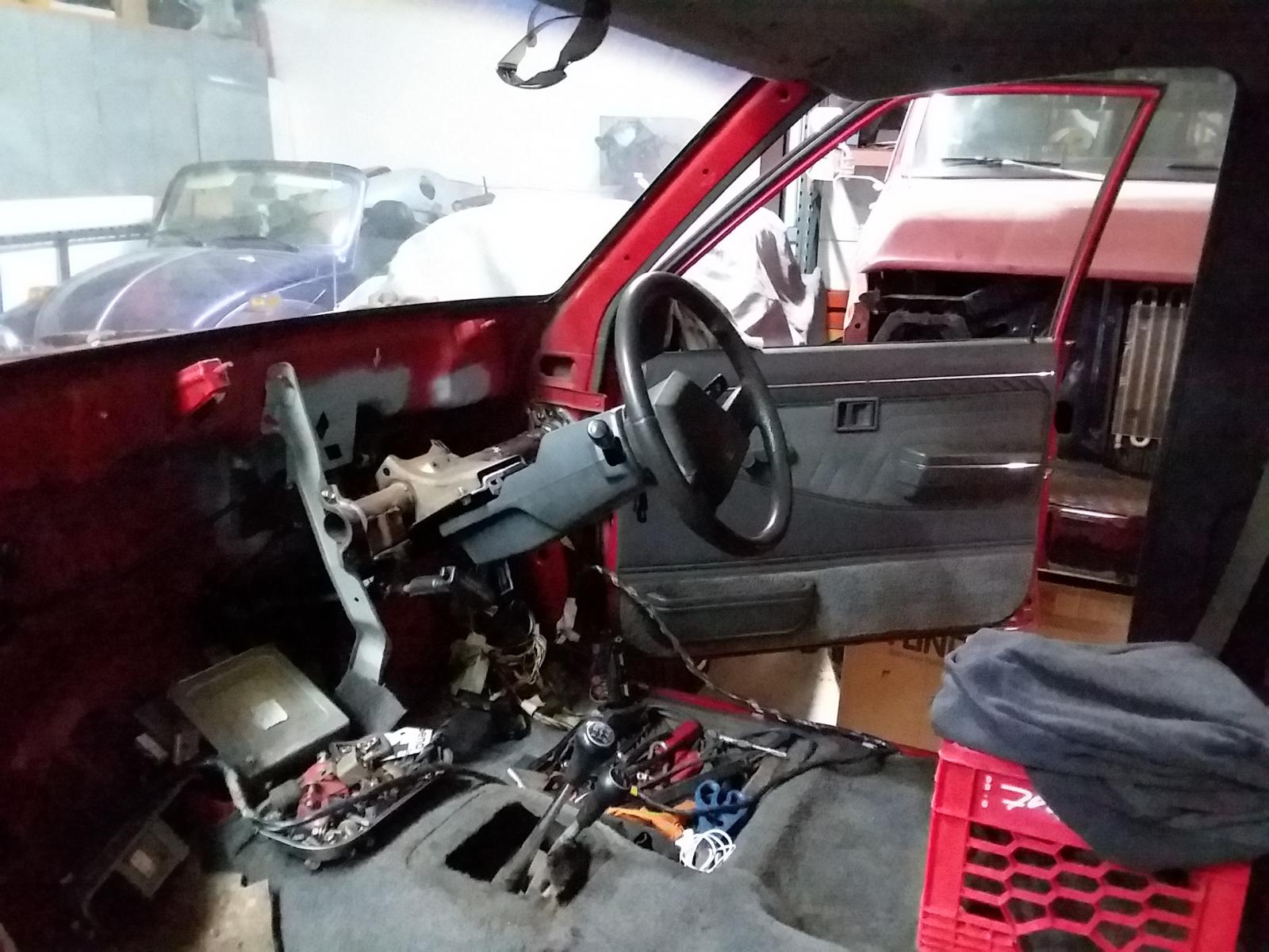

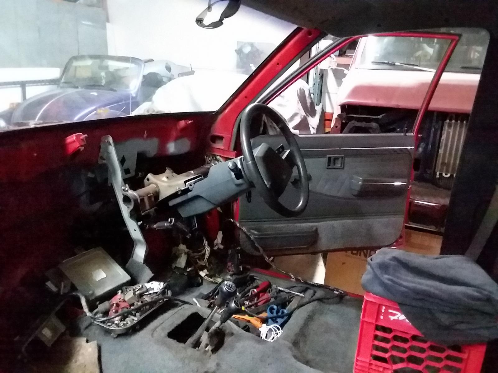

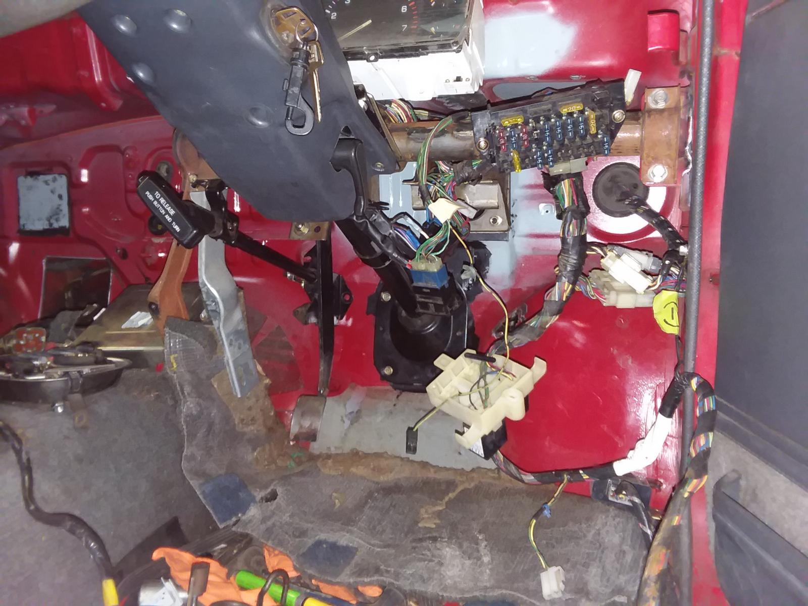

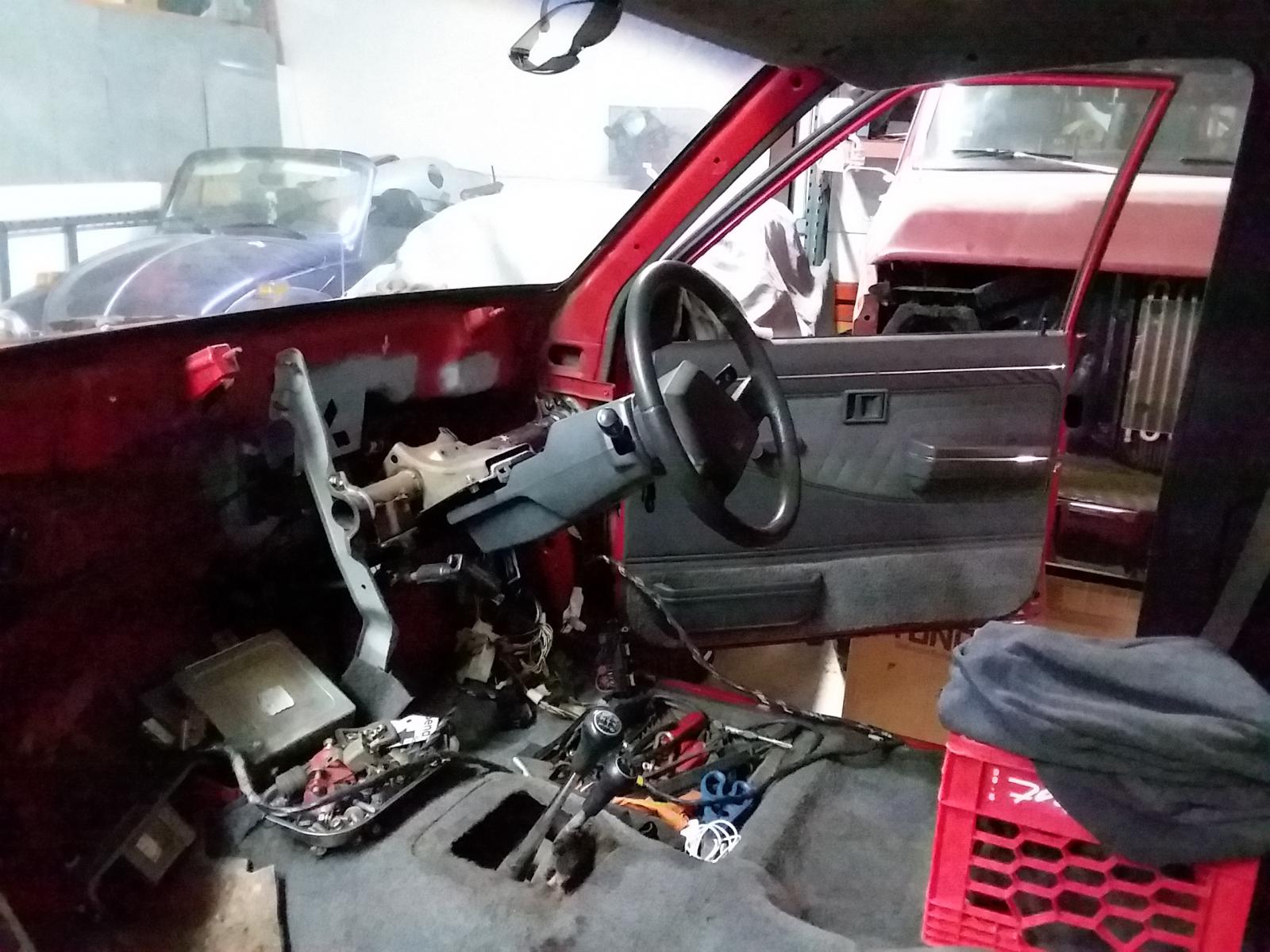

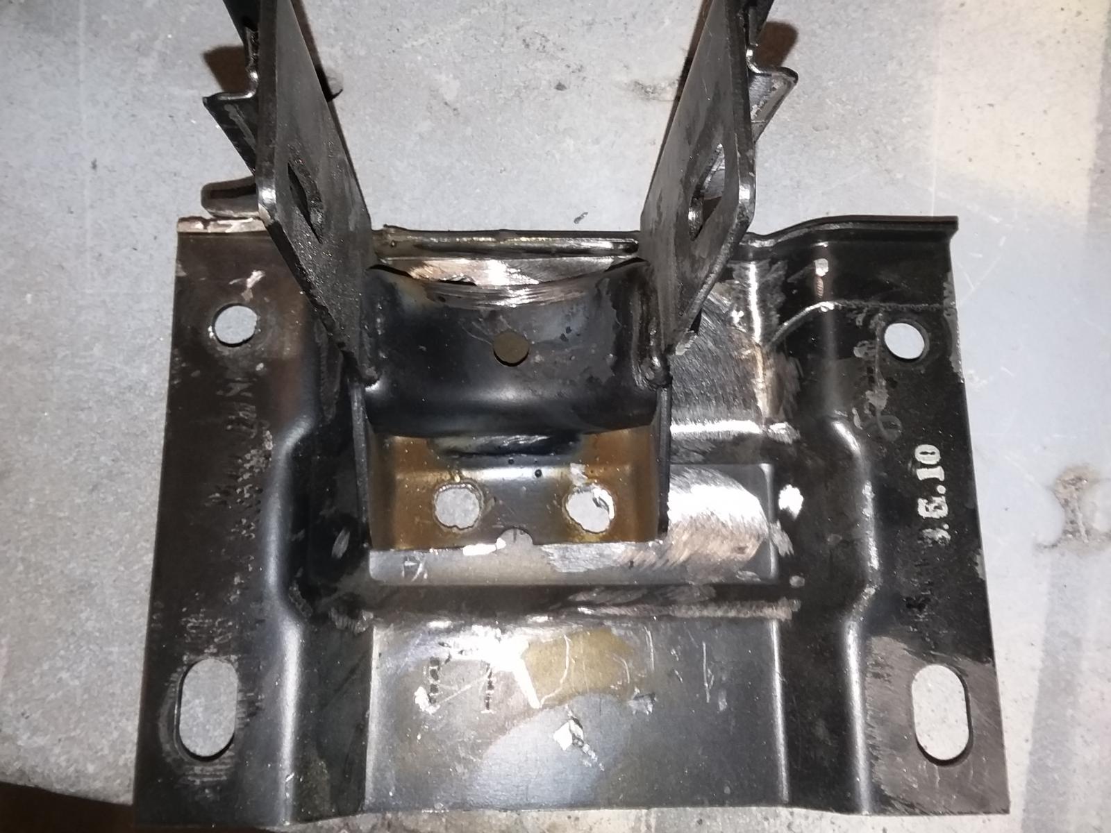

    so i was sitting in the truck last week, and the column just still seemed too
    far to the center of the cab. i noticed that the column tilt bracket appeared to be
    RHD/LHD specific, so i had to cut that apart and sckootch it over to the right:
    the after-shot is in the next wave of pics, my bad.....
    More shortly, for realsies

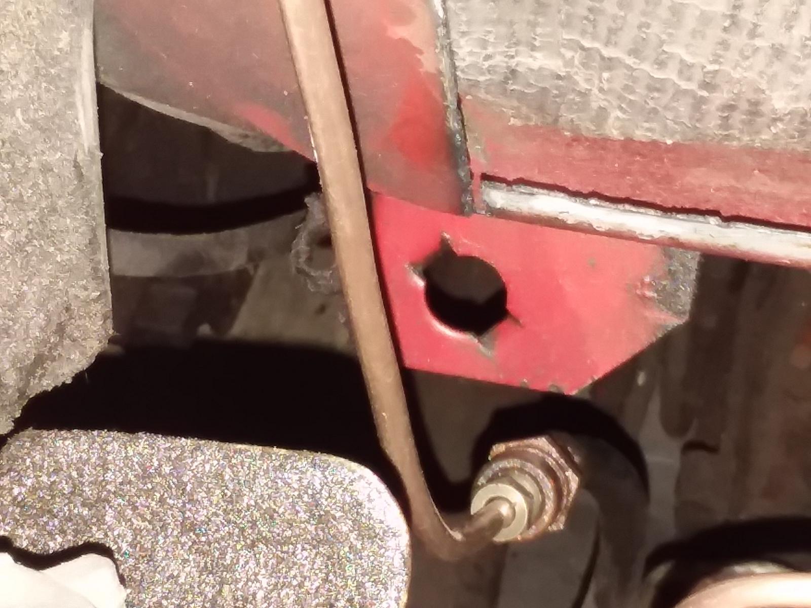

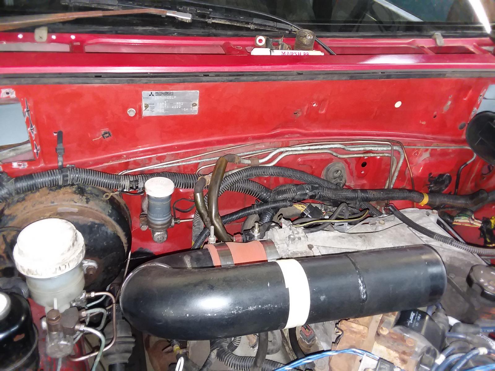

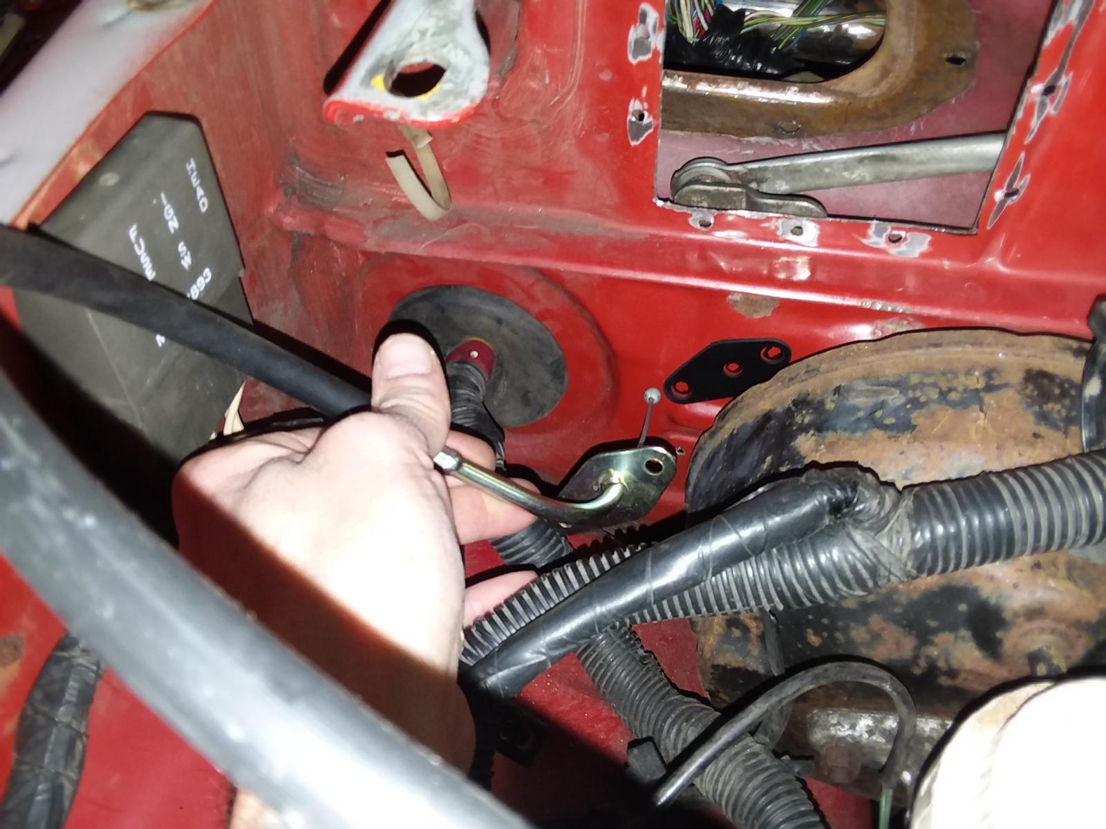

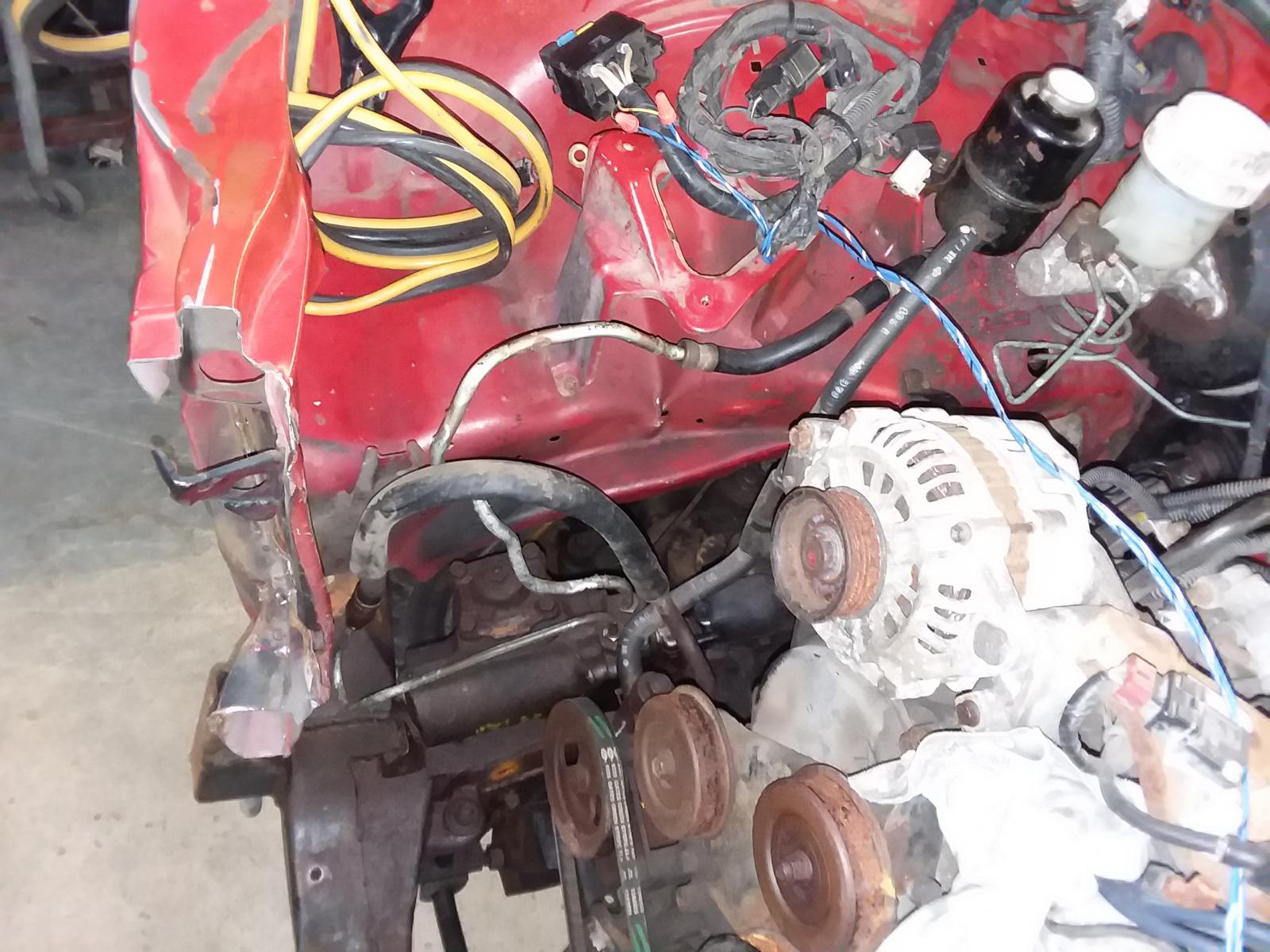

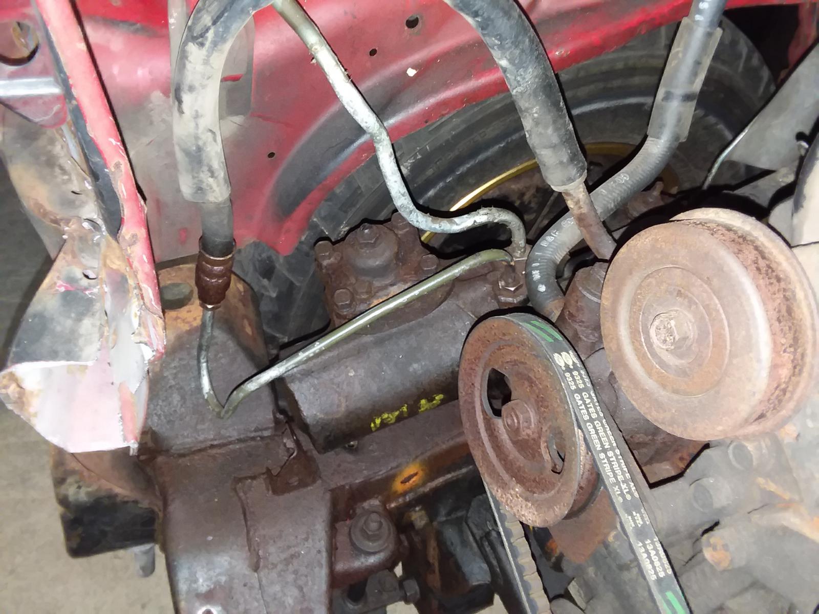

    Lines didnt come out great, but i want to put in a cooler eventually,
    so ill probly run a -AN hardline adapter on the return fitting and then i can
    plumb in a nice cooler...

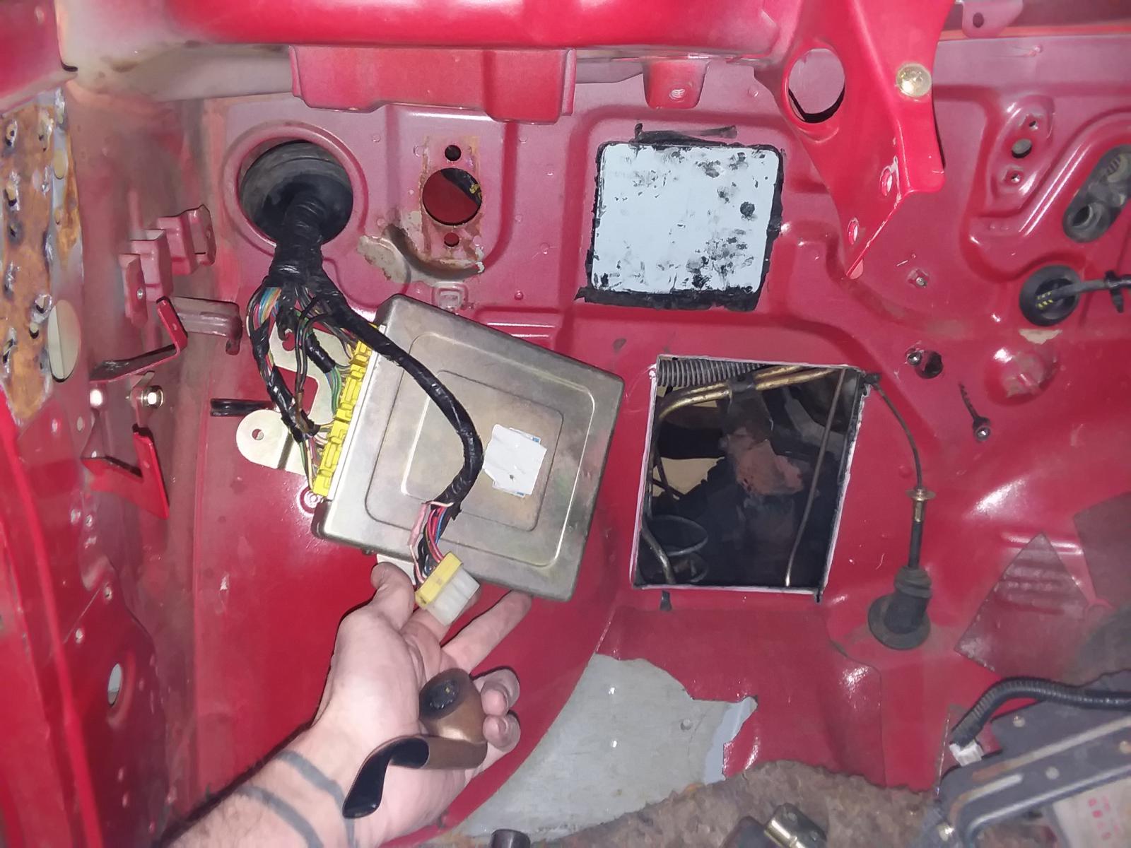

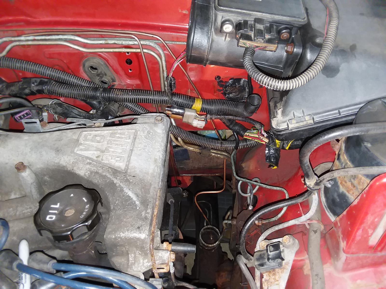

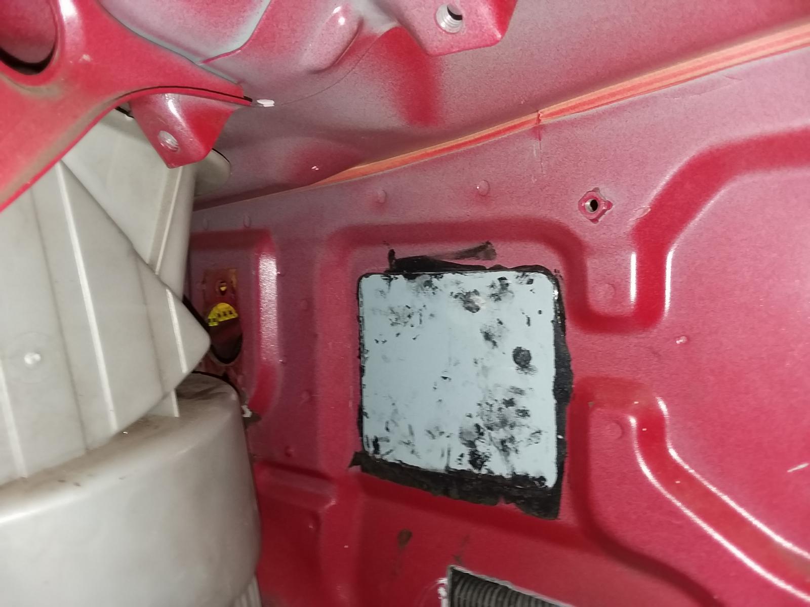

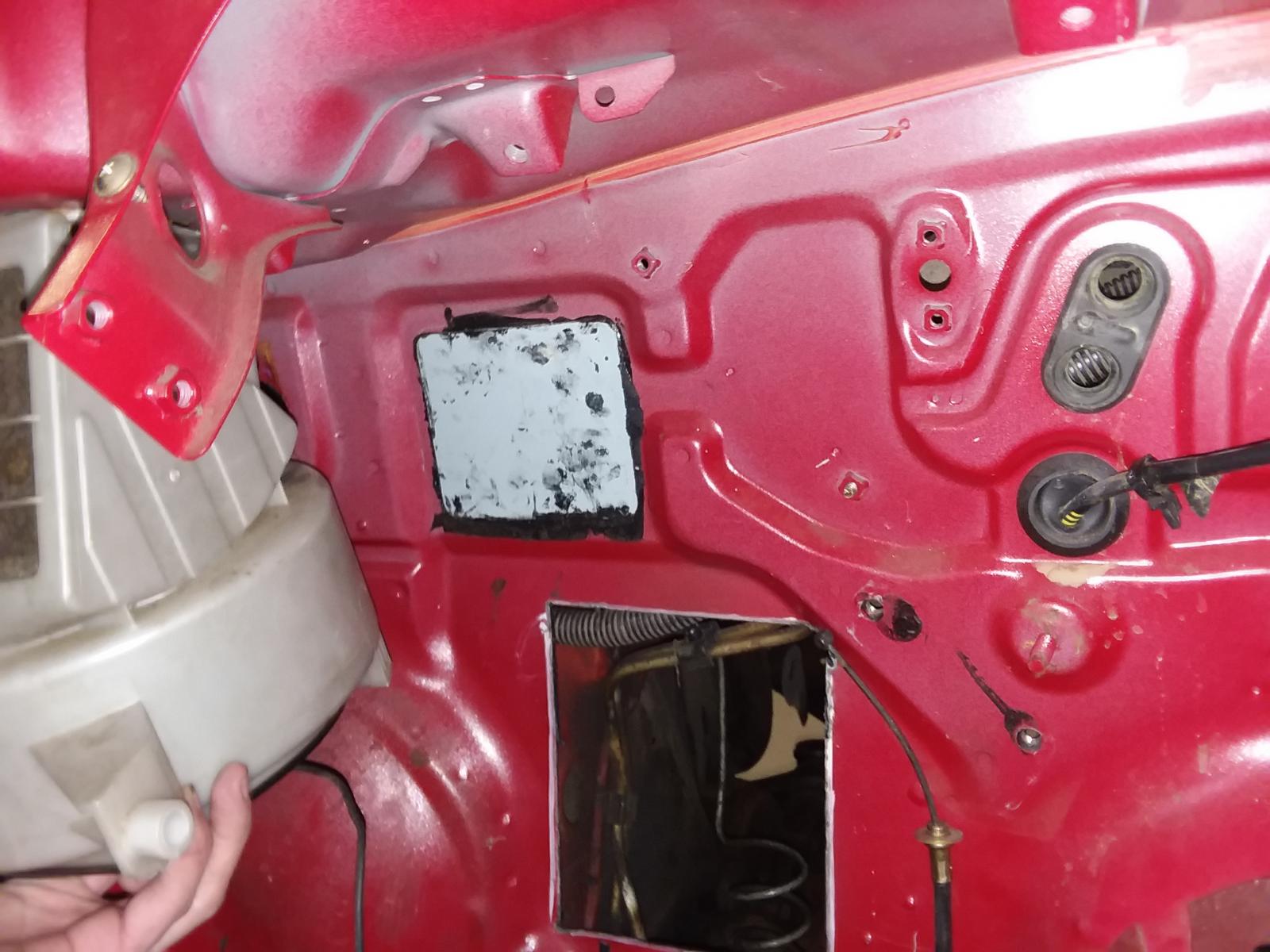

    now the left hand side is gonna be tight with the ecu, LHD blower motor assmbly,
    and LHD heater box. im going to have to make some very slick, low-profile ducting
    to hook up the blower outlet which is up against the A-pillar/firewall corner,
    and the heater box inlet which is on the right hand (now drivers side)

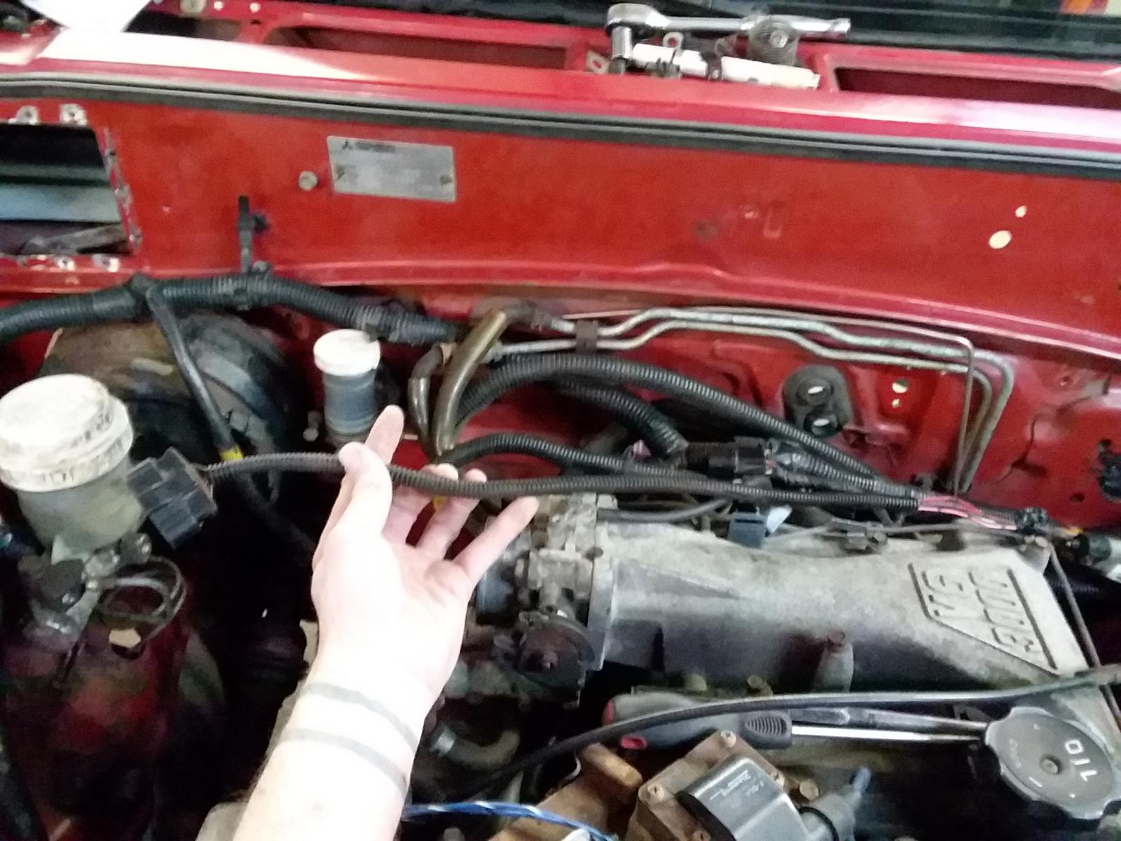

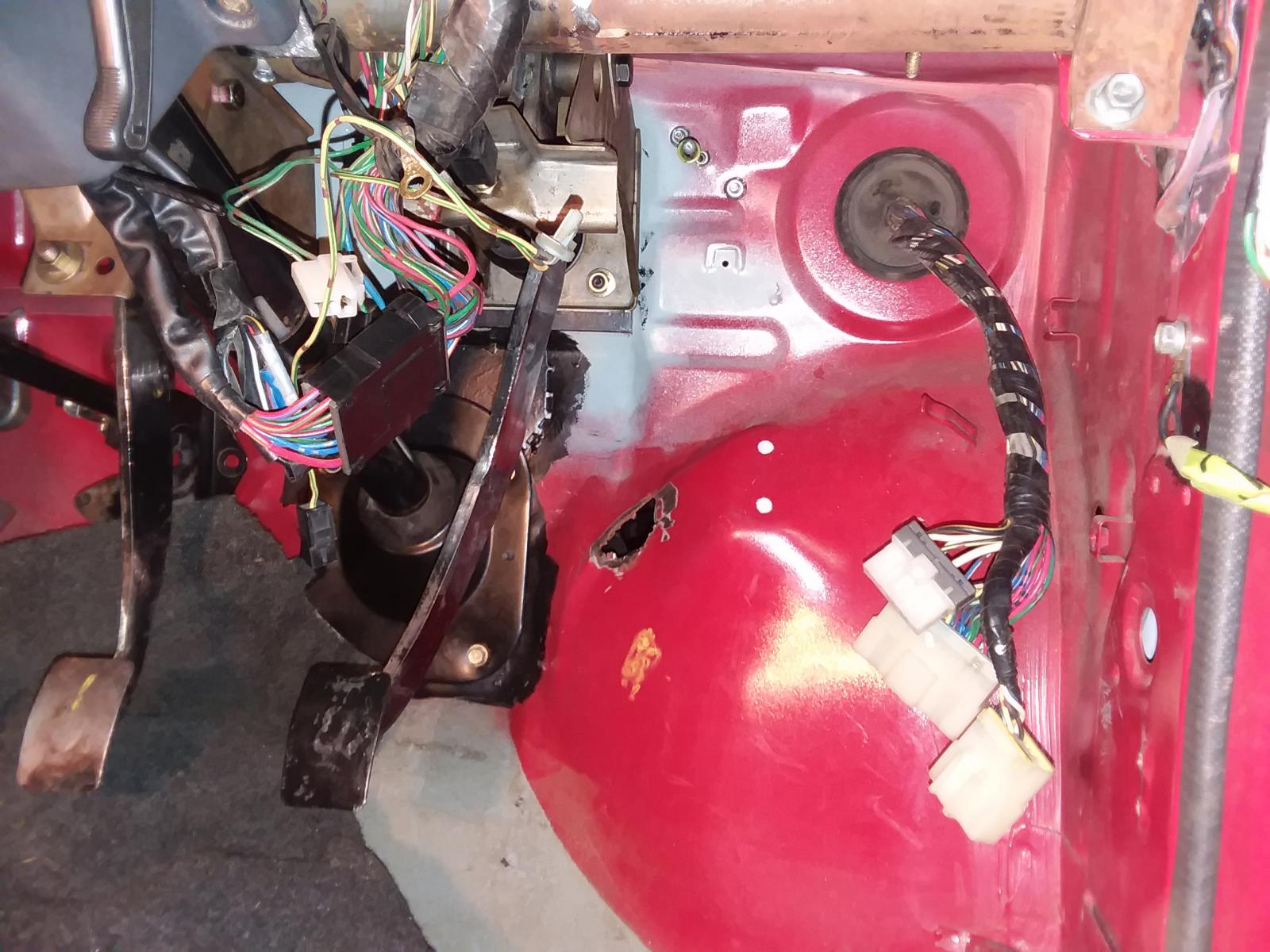

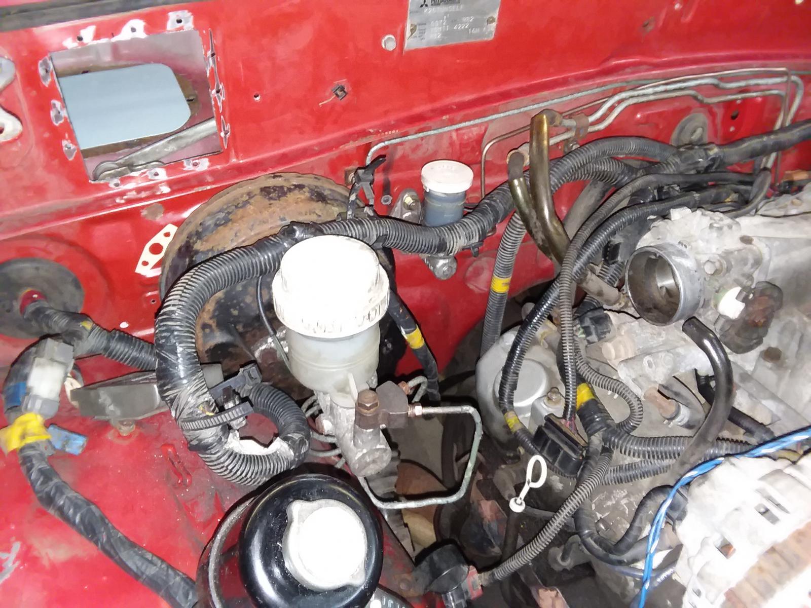

    these others are of the harness on the Right side, its gonna fit nicely.
    ive only got to lengthen the interiour light wires, maybe a couple others...

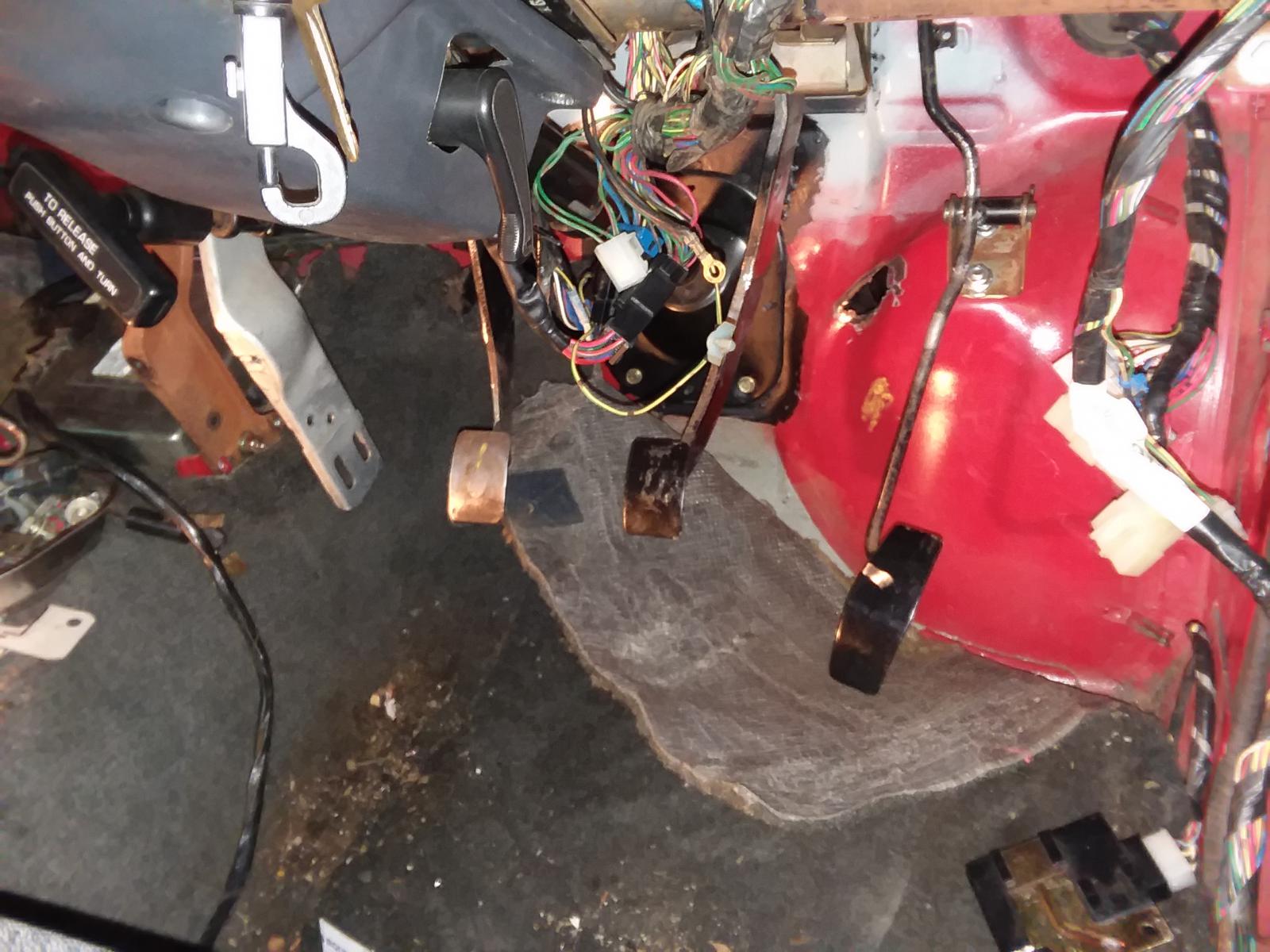

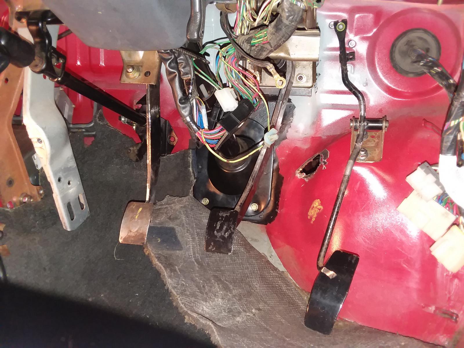

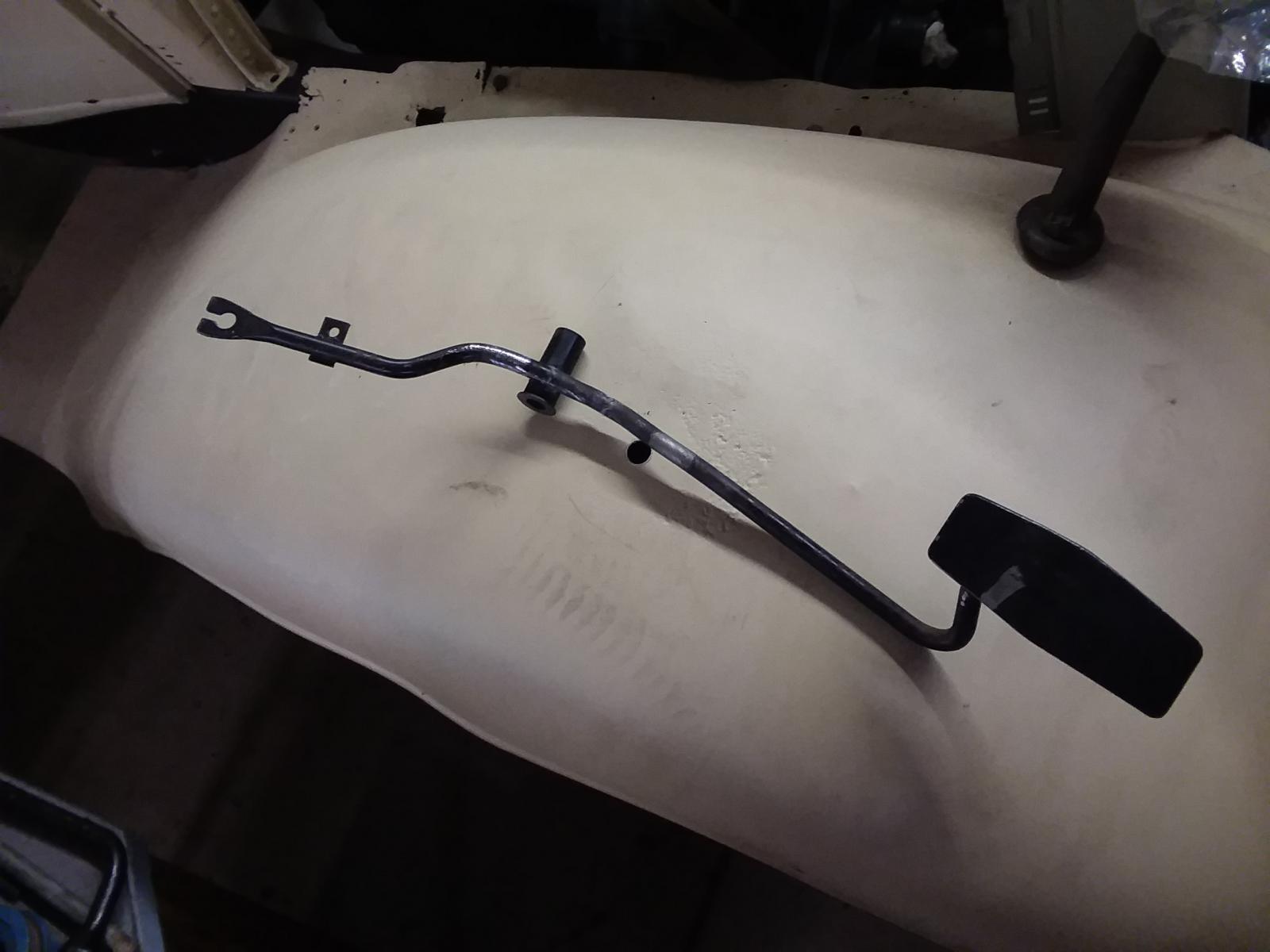

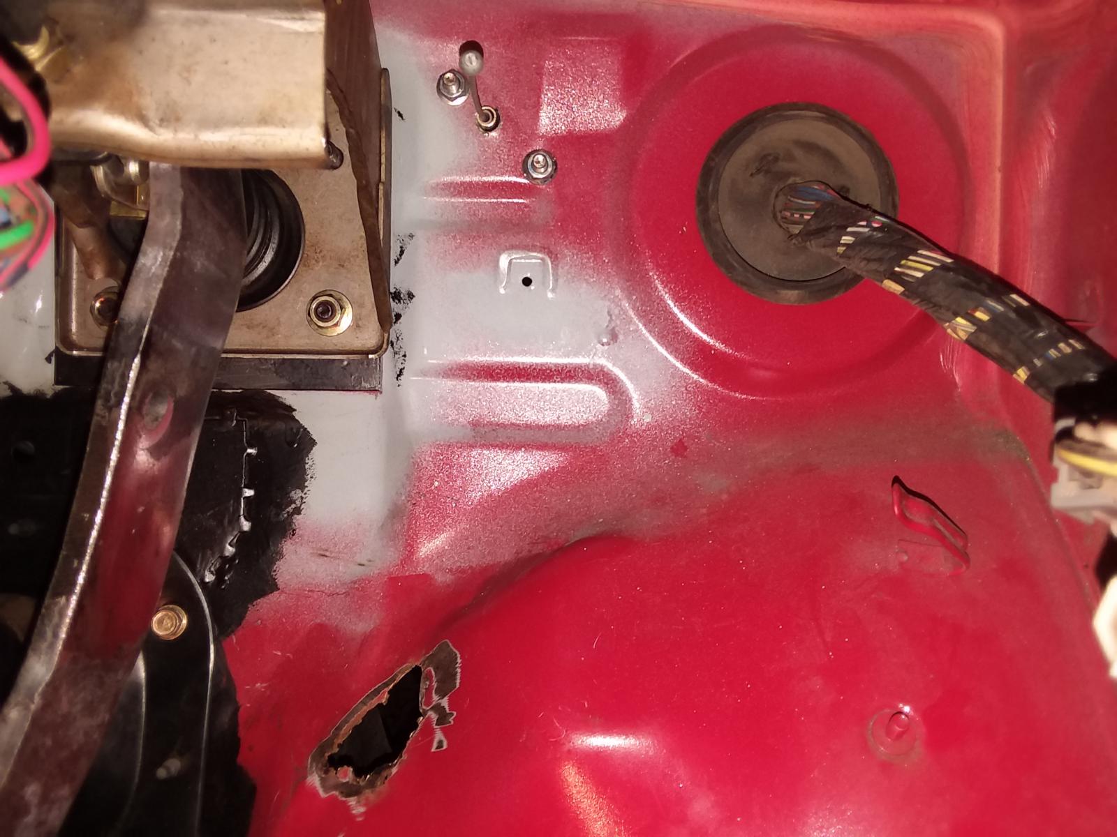

    still need to mod the brake pedal, clutch pedal needs tweeking, and im going to tryin
    replikate a RHD throttle pedal. hafta make 1 more brake line to connect the rears up, ive yet
    to delete the rear ABS can or prop valve...
    more pics soon.

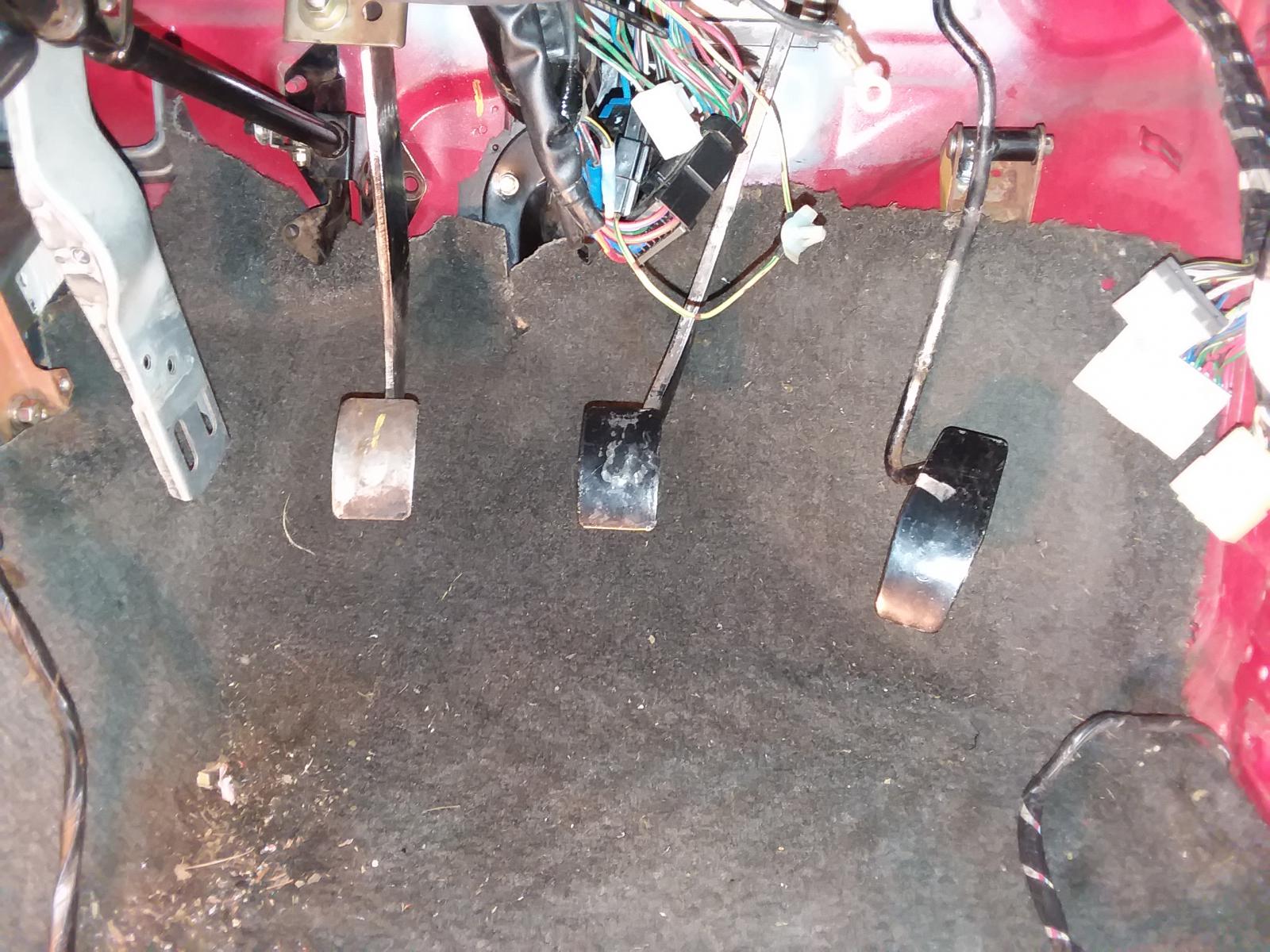

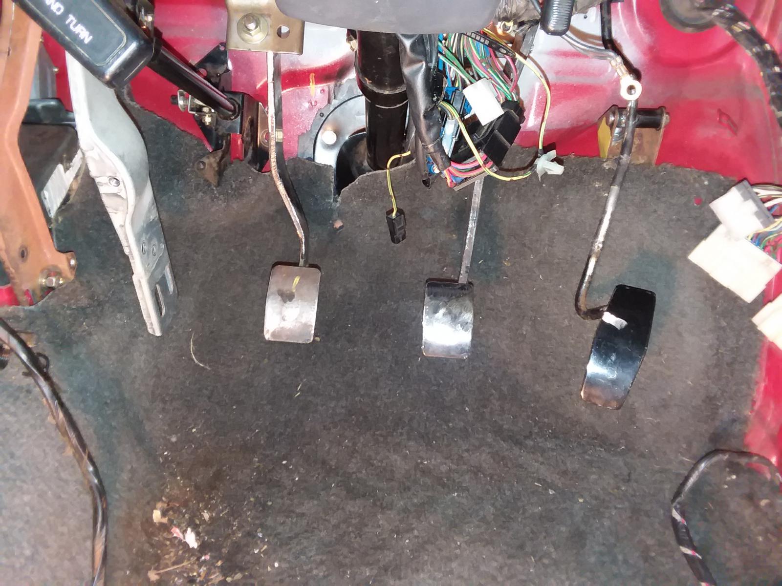

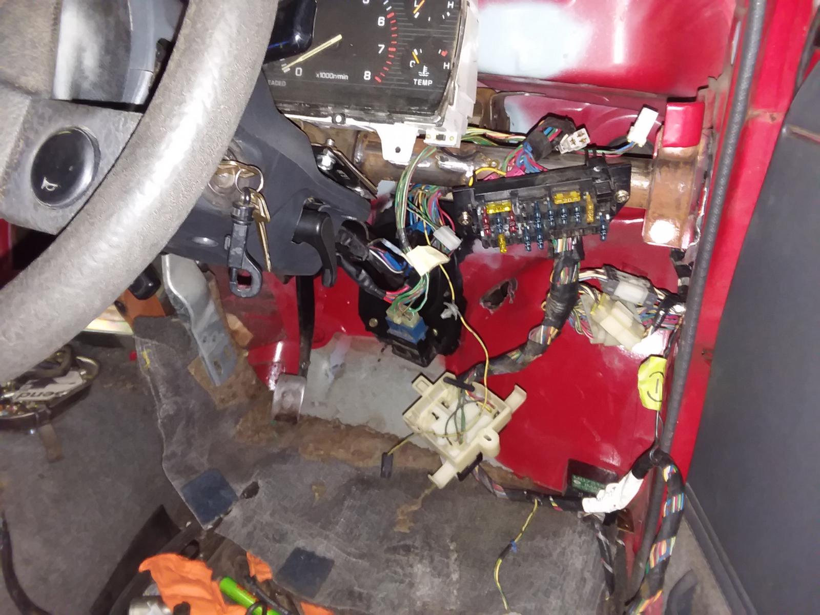

    Got to excuse my ignorance but does the Gen 2 have a safety switch in the clutch pedal?
    yea it does, its a little 1-wire button. ill snap a pick for you...

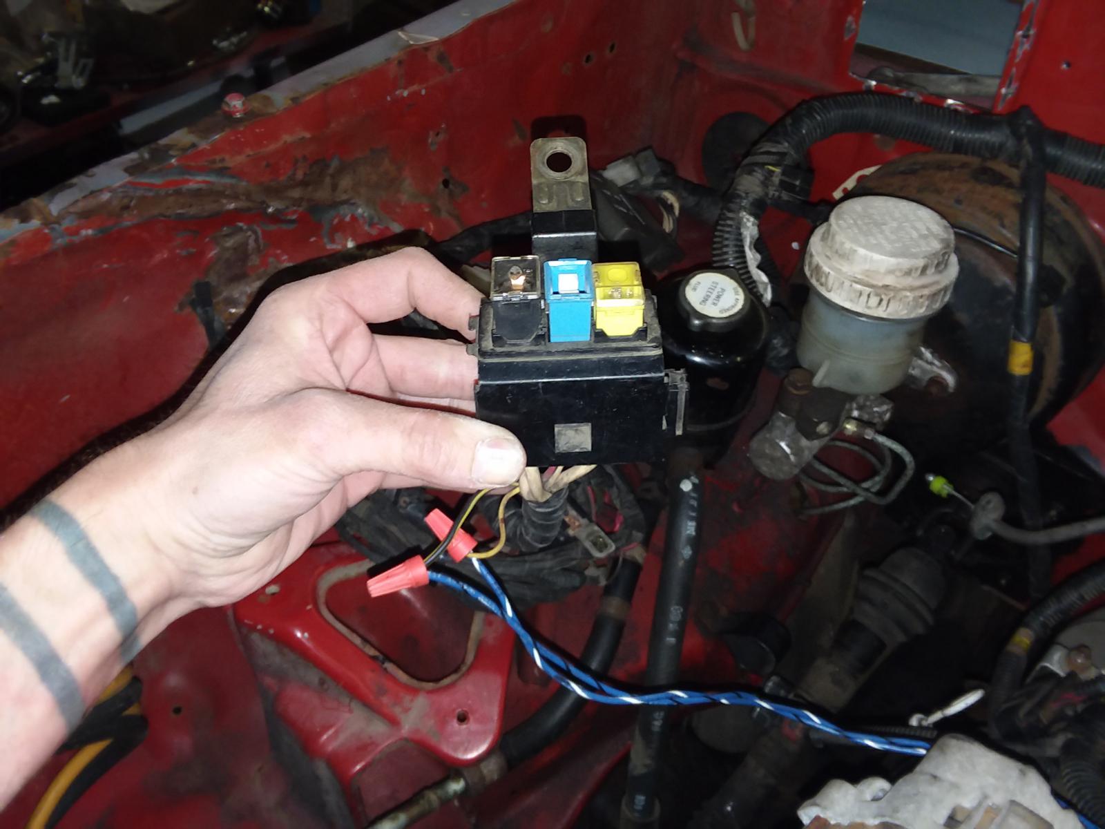

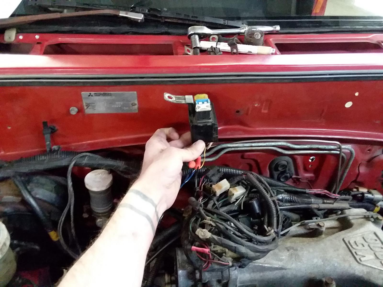

    i need to mount this lil fuse block somwhere, mite go on the firewall.
    i have to run a cable from the (+) positive terminal of the battery to the lug there:
    And i have to add about a foot or so of length to the MAF wires.
    But the harness flip over seems like itll work out alrite.
    need to add some wires here & there but way better than leaving the
    harness LHD.

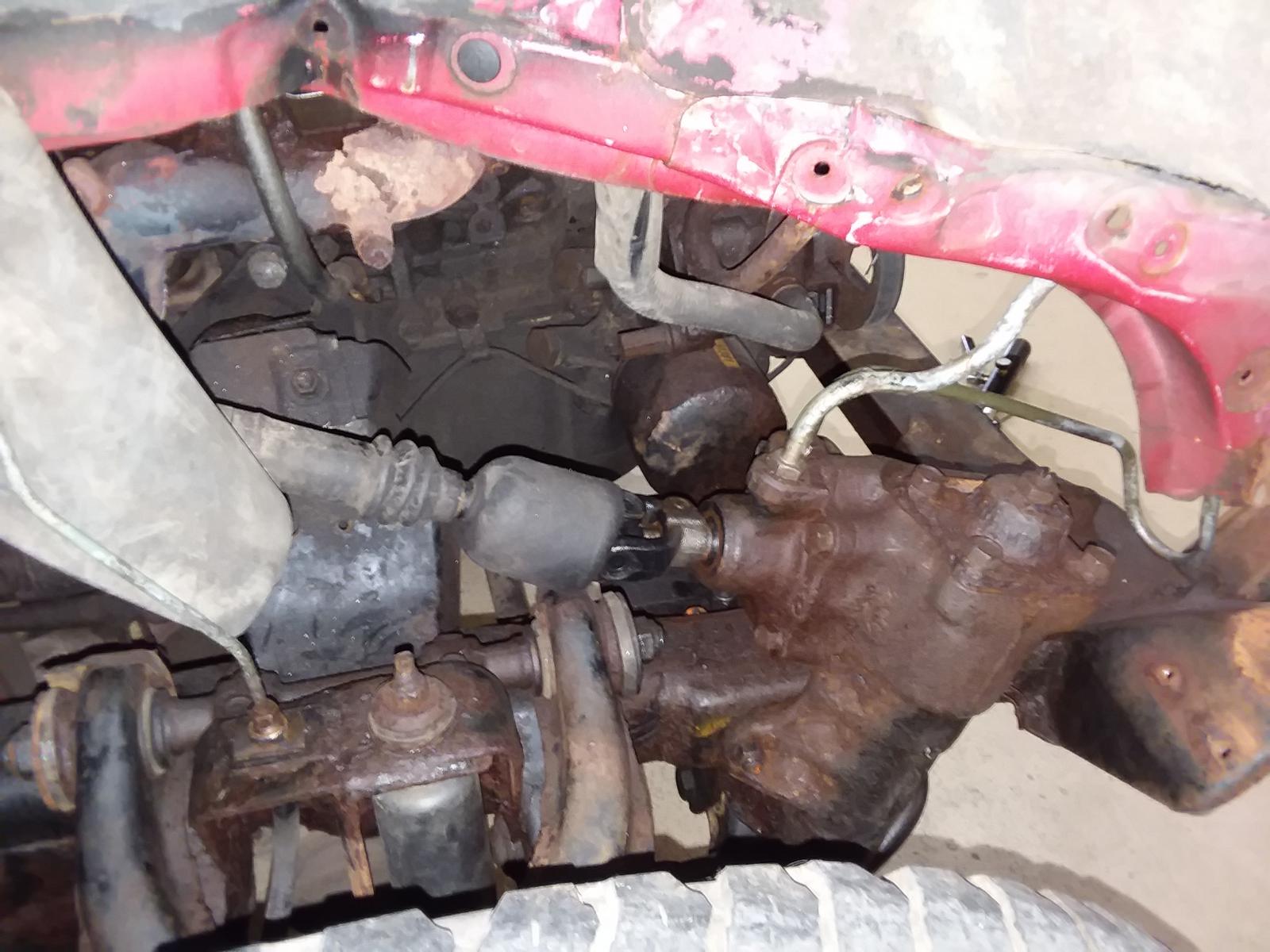

    I almost forgot to post my findings regarding running a mkIII k74 L200 steering box & idler arm on
    a mkII L200/mighty max w all remaining steering & drive line OE mk2 parts:
    The mk3 pittman & idler arms are about an inch longer than the mk2 units, and I had hoped to see
    some difference in the steering or lock to lock turn count....
    ....however, with the longer Pittman & idler arms my lock to lock turn count went from
    about 3 & 1/2 down to just 2 turns L2L.
    I think ralley cars & race cars have like 2 & 1/2 turn racks, so finding
    that my truck is tighter than that was cool, at first. Now I'm thinking that wen I go to turn on the heater or radio
    a small movement of the steering wheel is gonna send me into the woods.....
    I'm going to wait & see how bad it is driving, but worst case hopefully I can retrofit the mk2 arms onto the new box.
    We shall see. Given how crappy the turning radius is it might not be as bad as I worry......
    But if anybody wants to dramatically shorten their steering wheel turn count, 1998-2006ish L200 steering box & idler
    arms on a mk2 mighty max/L200 drop link/tie rods gives you 2 turns from lock to lock.

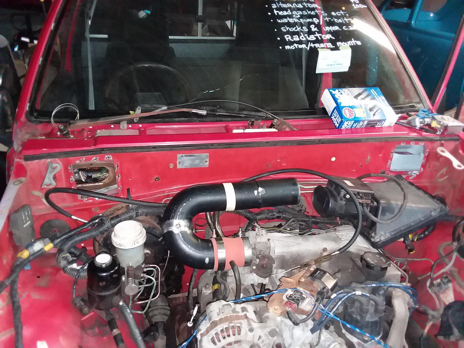

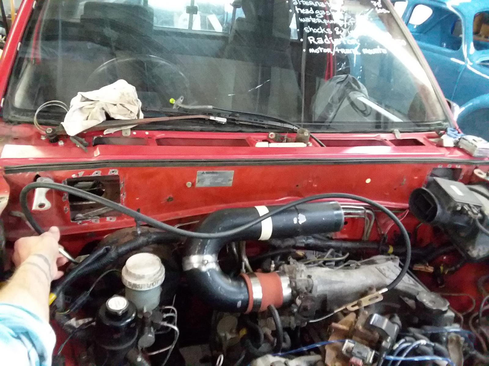

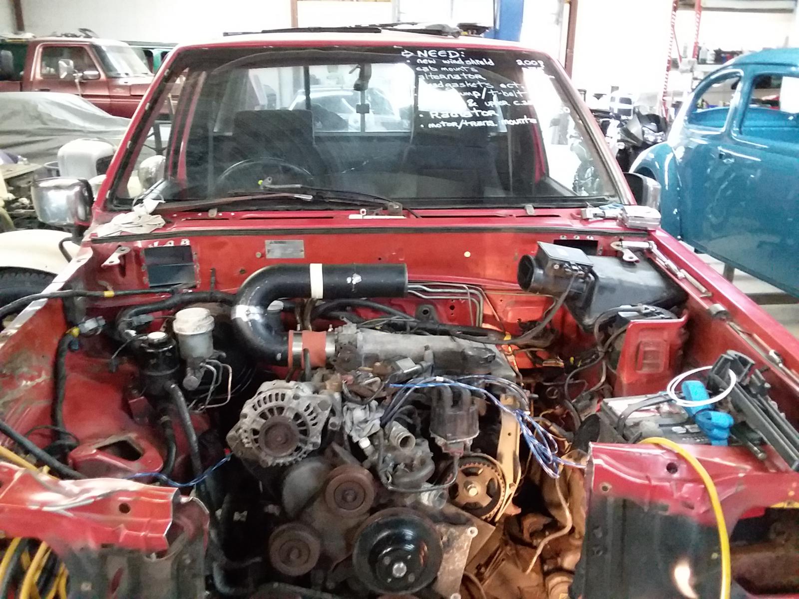

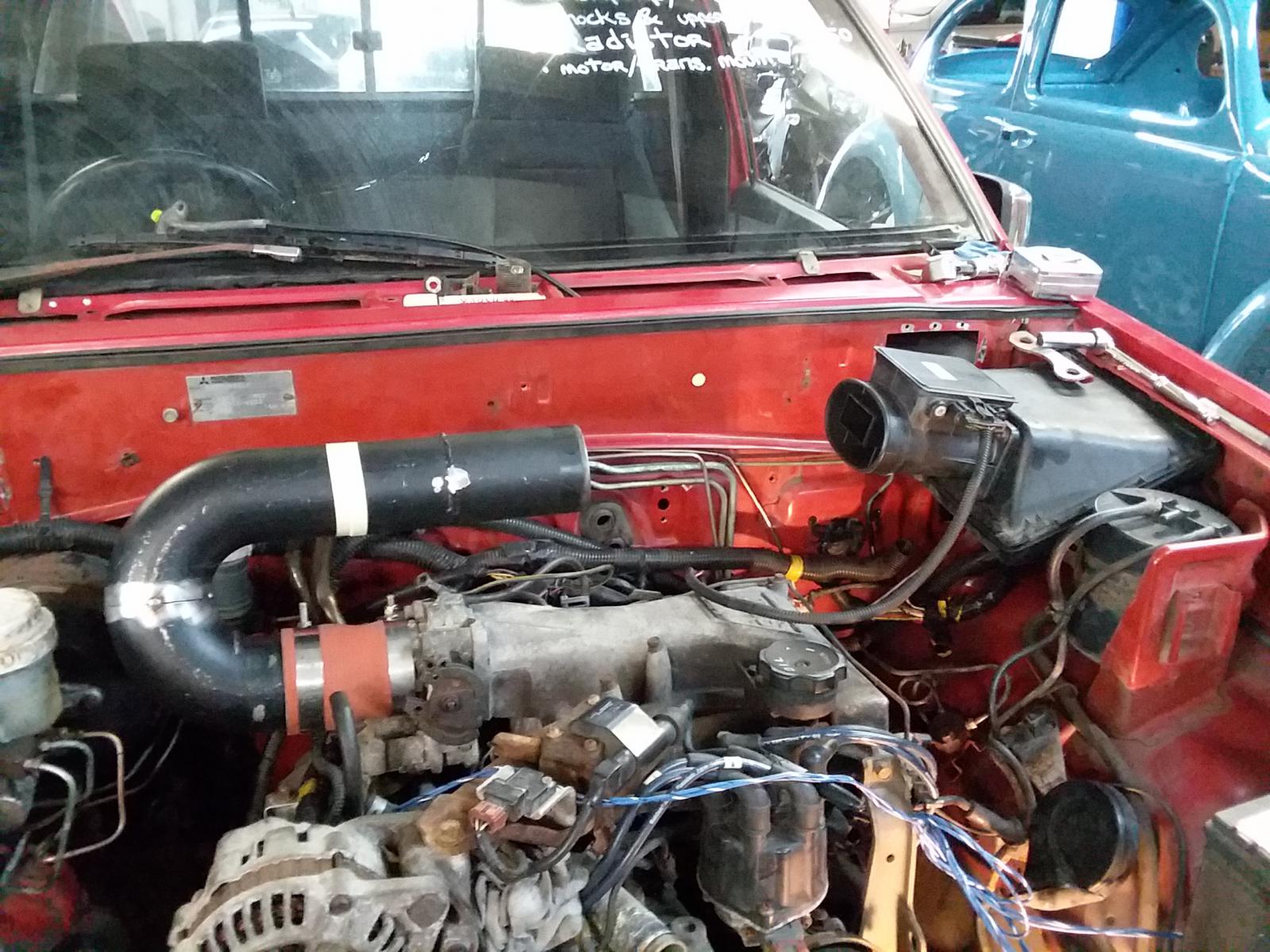

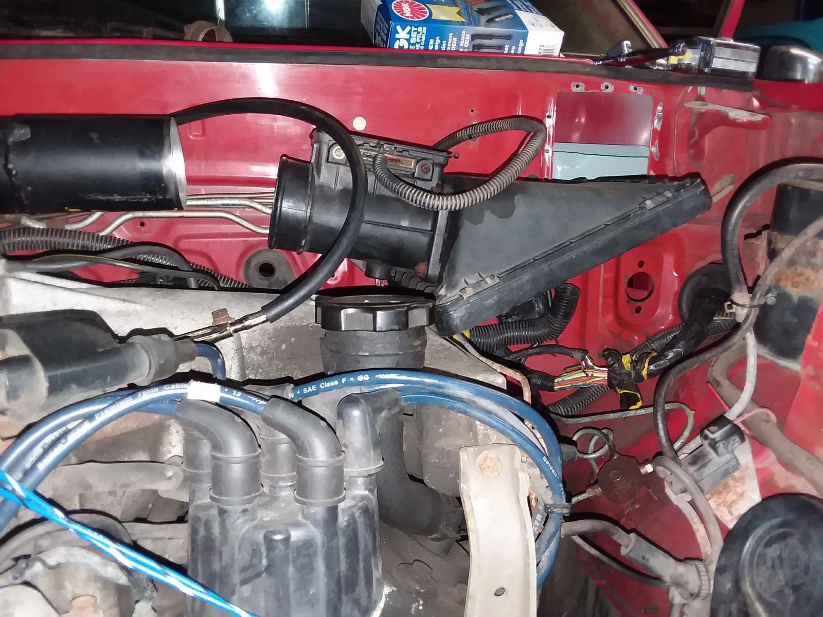

    so i been tryin to figure out a replacement intake pipe, the OE rubber unit is deteriorated as
    every time you touch it ur hands are black. so im gonna replace it w a steel unit.
    i was going to put the airbox in the stock position, but im really NOT looking forward to
    having to lengthen the MAF connector wires so im considering moving it to the left side of the bay
    now that the brake booster is on the other side now. then i was thinking about if i was ever to
    install a snorkel i DONT want it to be on my new drivers side. with this 180* intake it can go right
    out the fender and up the left side A-pillar.

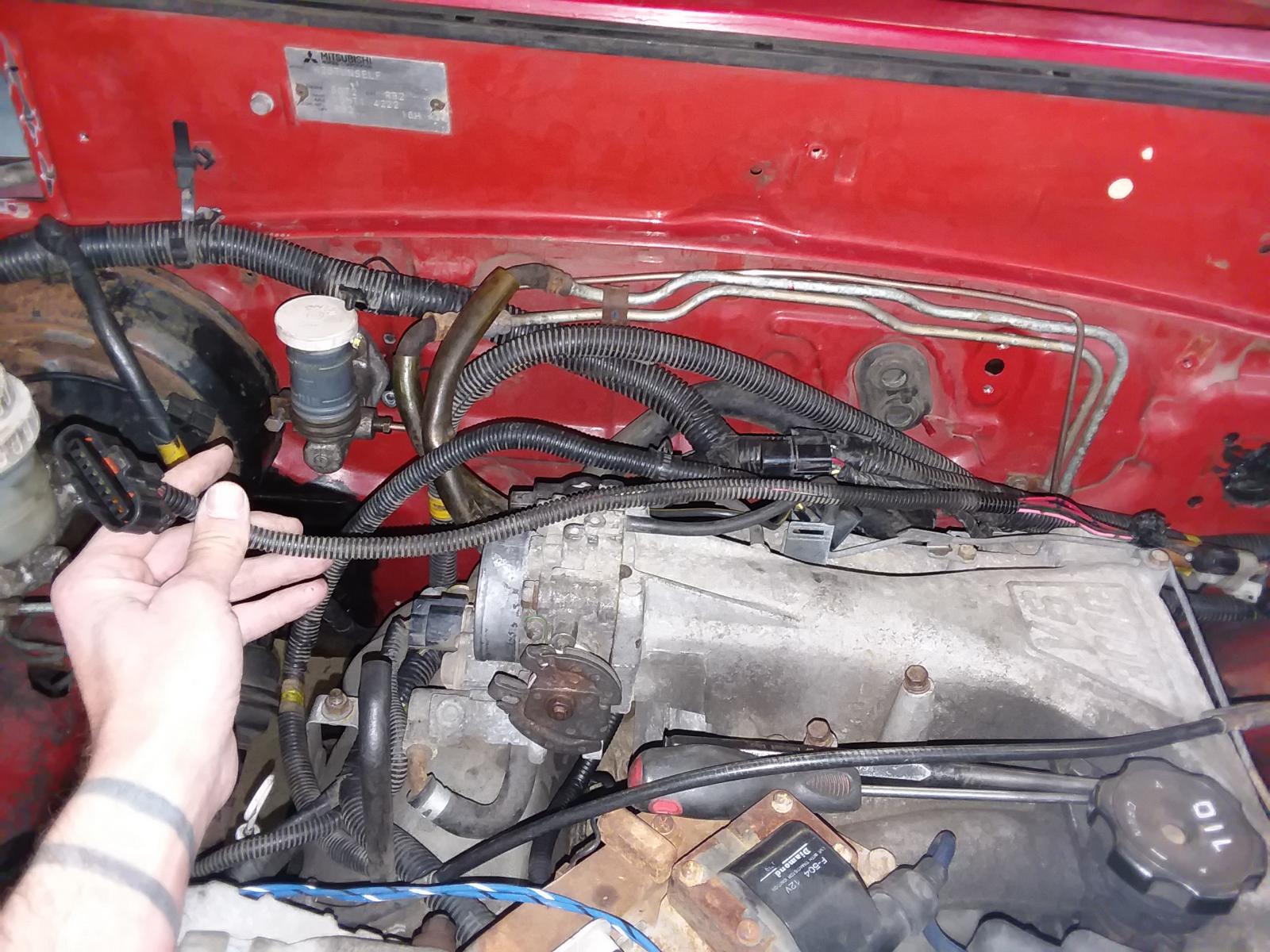

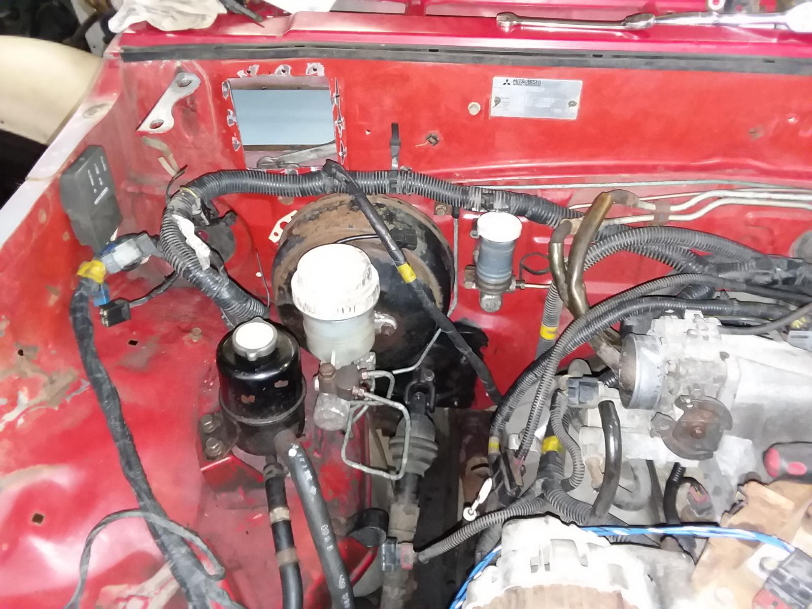

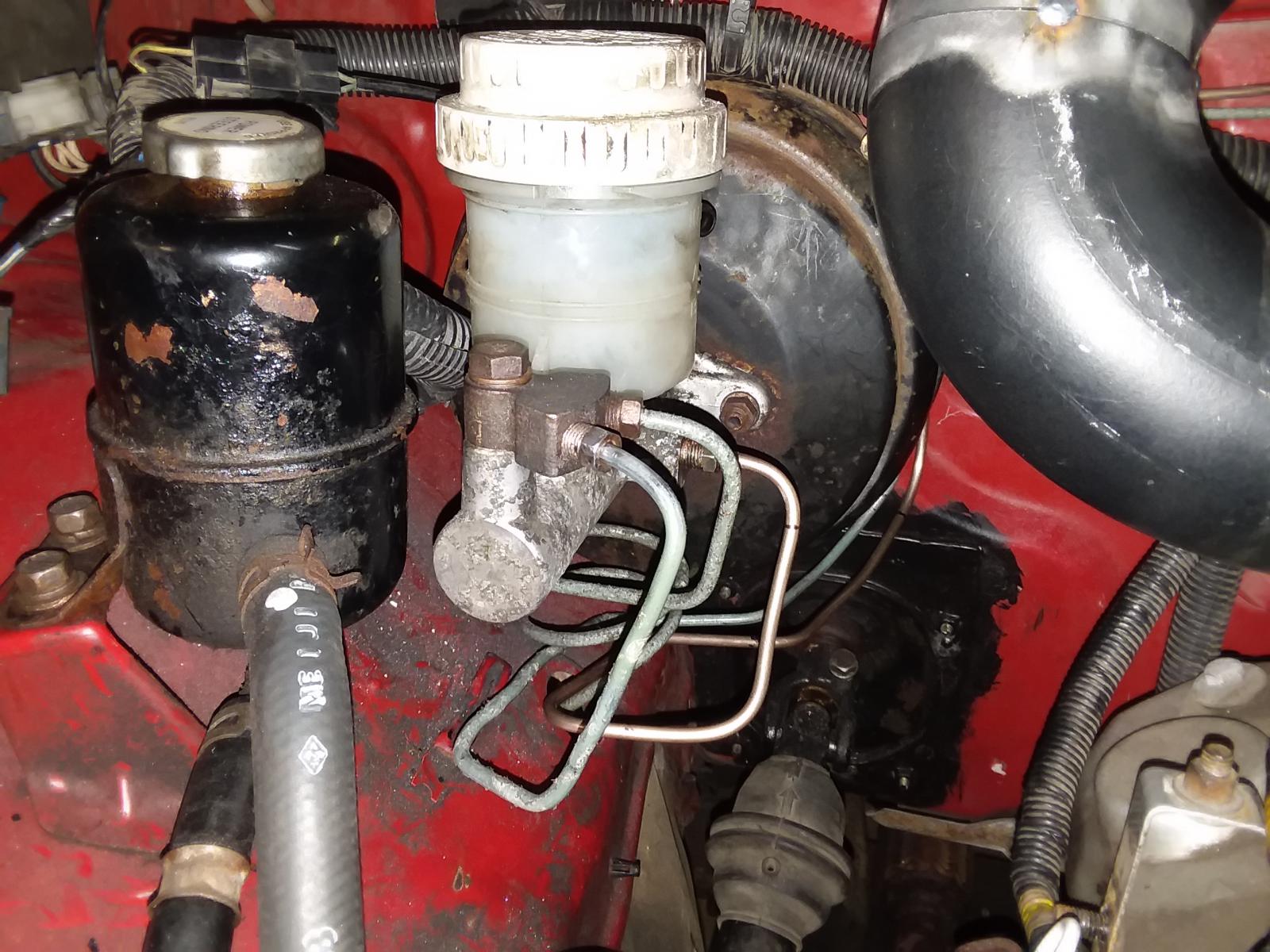

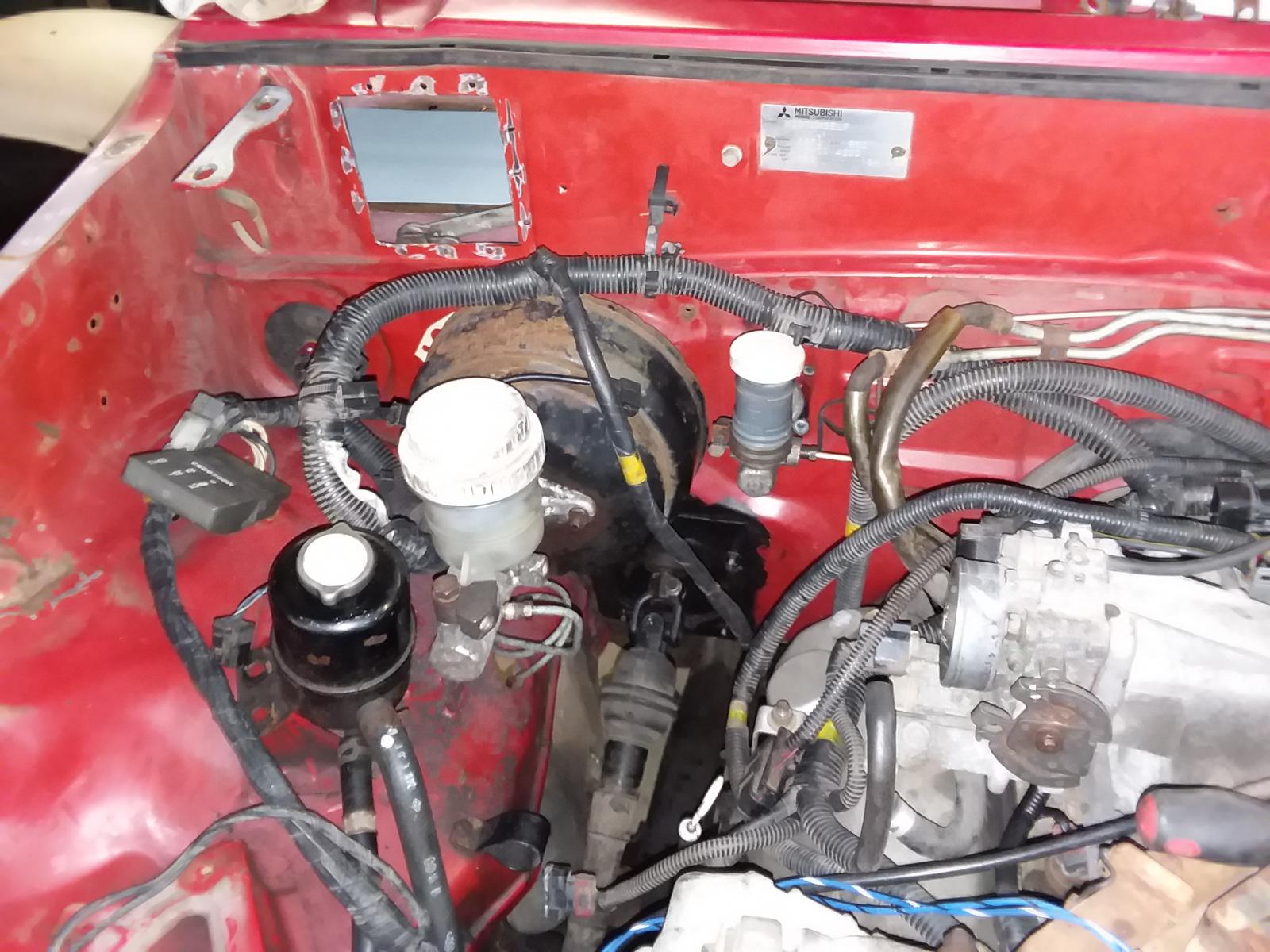

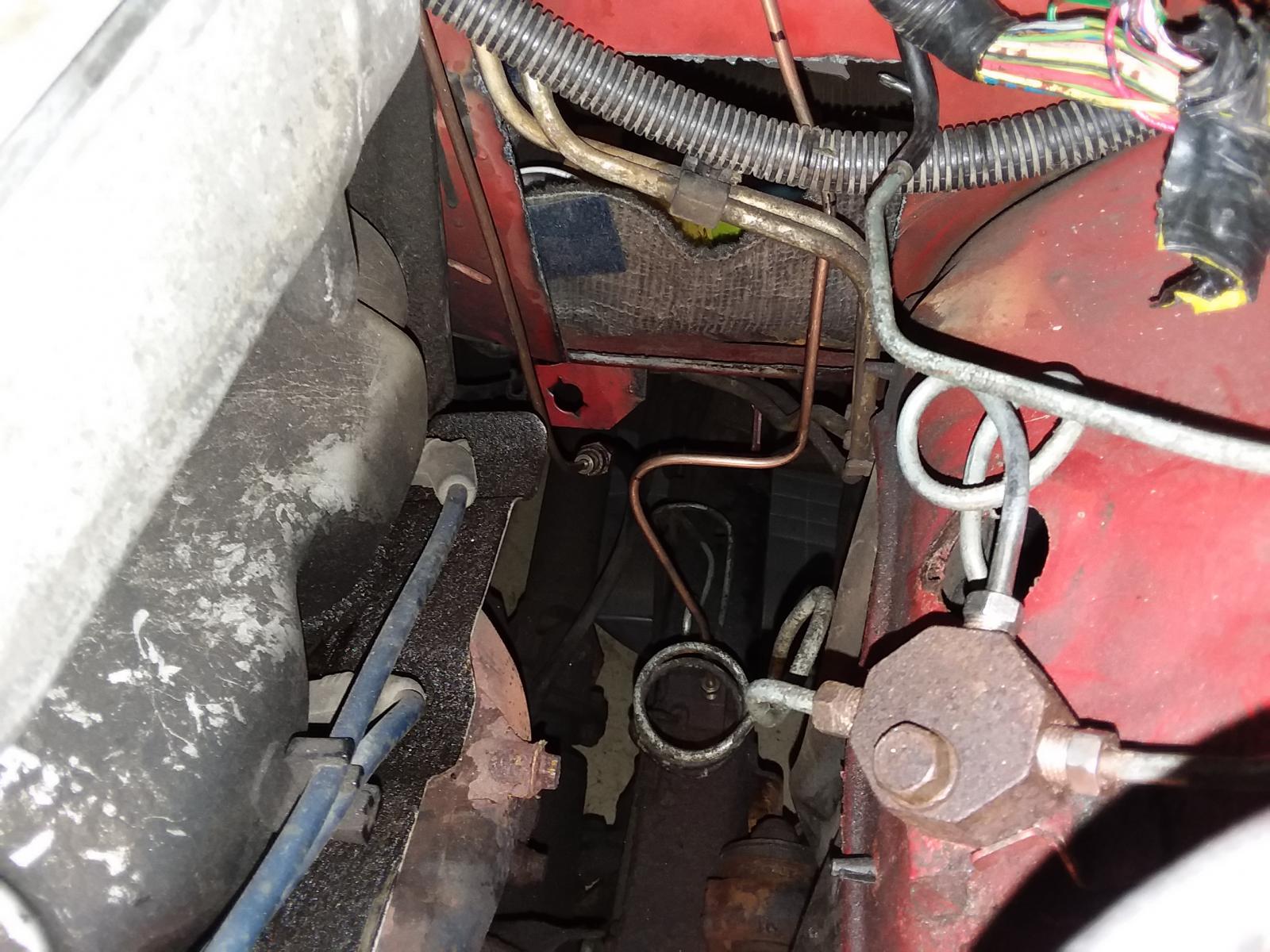

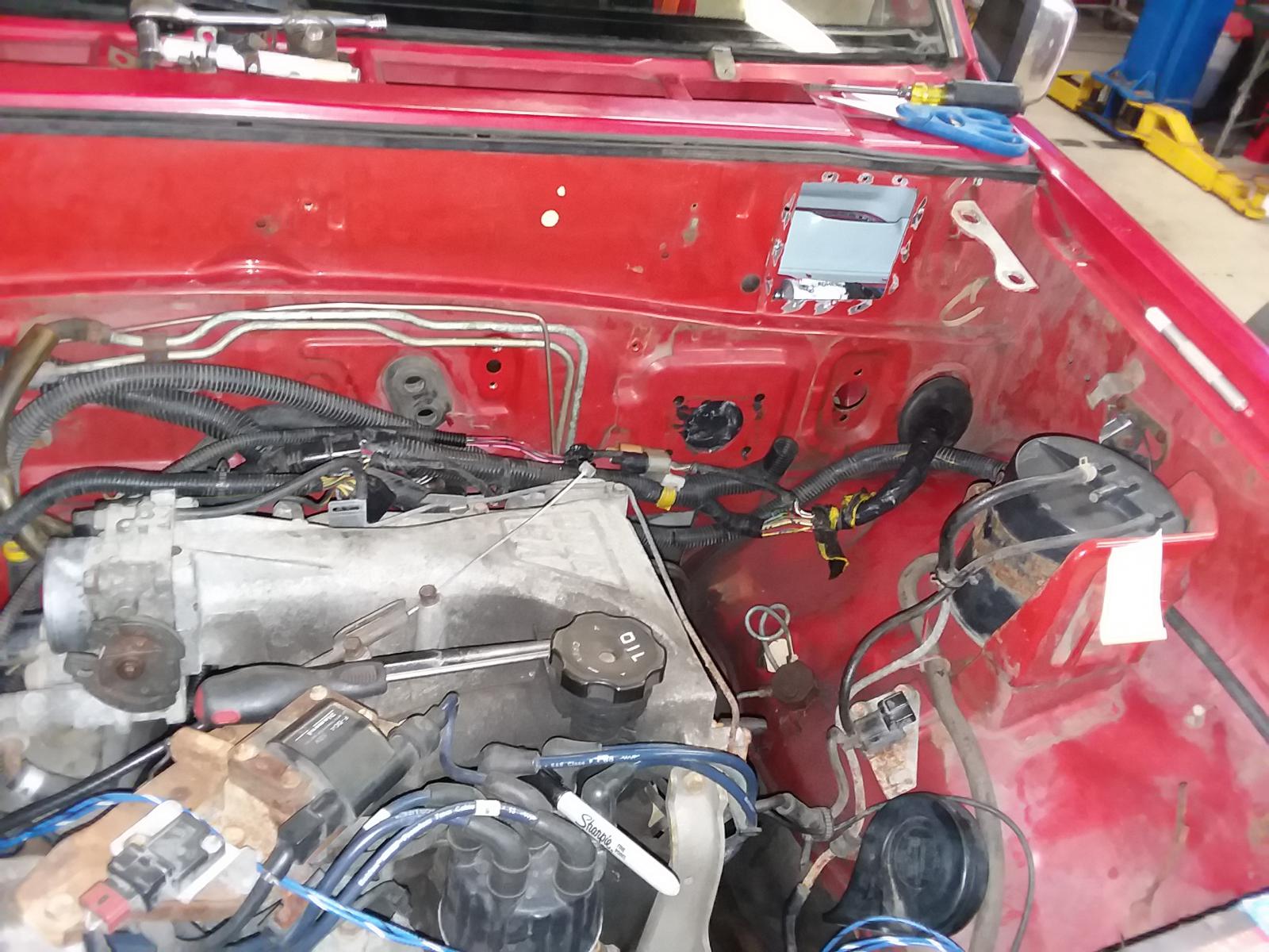

    I finished up the brake lines, at least in the engine bay. its a cluster across the firewall, ive yet
    to lay them out and mount them all pretty like....
    And i hafta hammer out these little tabs that are bent over on the clutch line mount tab.
    im not 100% its for this application, thinkin the clutch cable for the RWD trucks.
    but itll suffice once im thru w it.

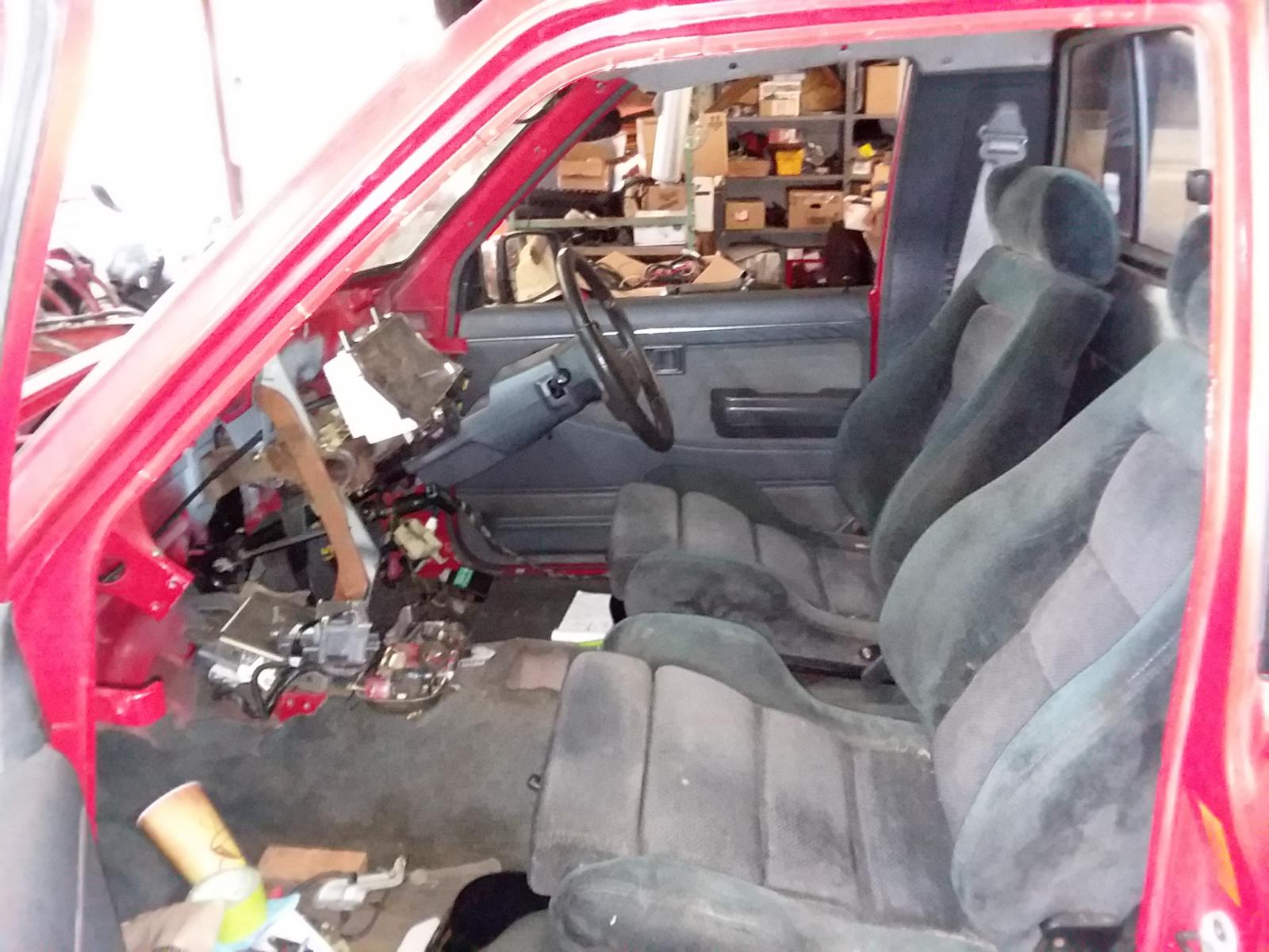

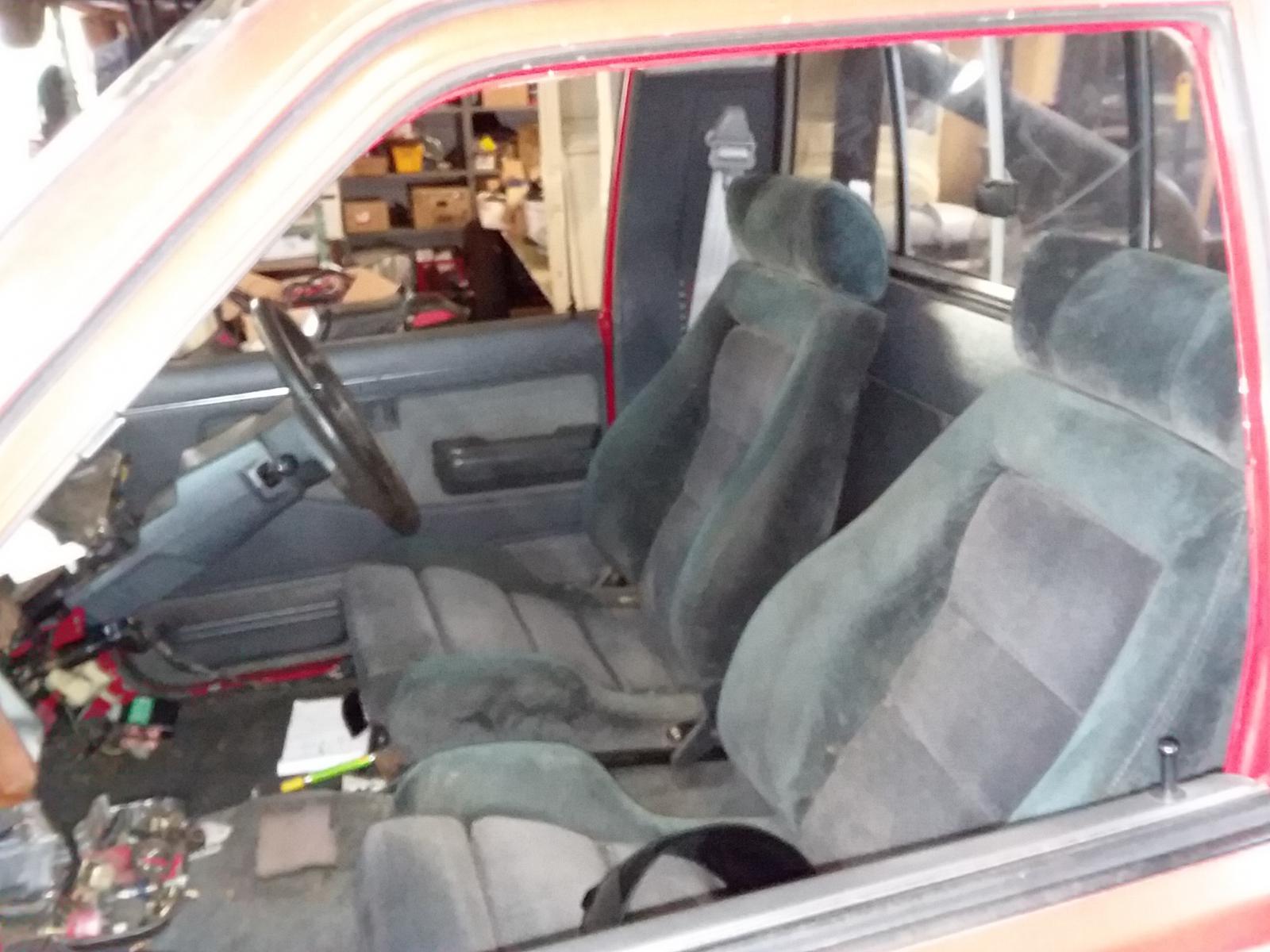

    And heres the seats im thinking about running. theyre kinda recaro knock-offs,
    theyre nice, little heavy, and theyre are stupid stiff. i need to lend them to a 250lb guy to
    drive around on for a cpl months to break them in....
    Ooooh, that air cleaner assembly is close to everything. You've really given yourself a challenge on the swap. We got ONE model of truck that was 2WD V6 - now that would be an interesting performance build (twin turbo V6 swap anyone?) Awesome work

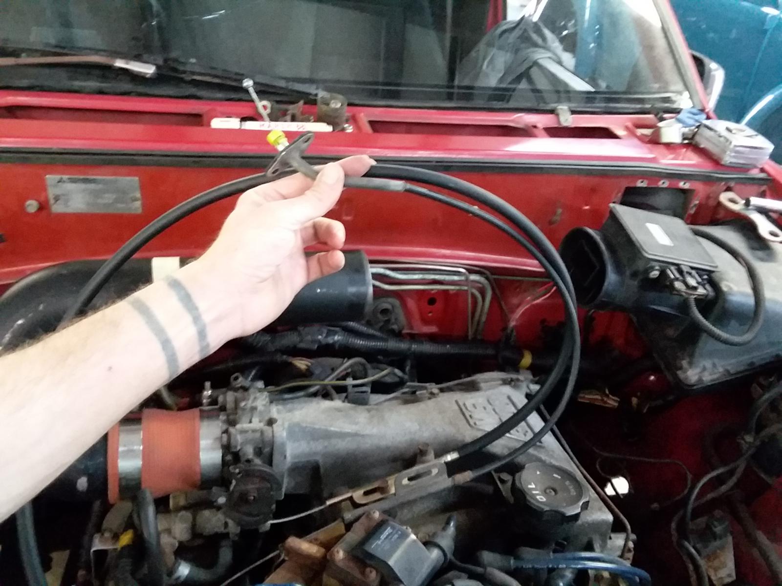

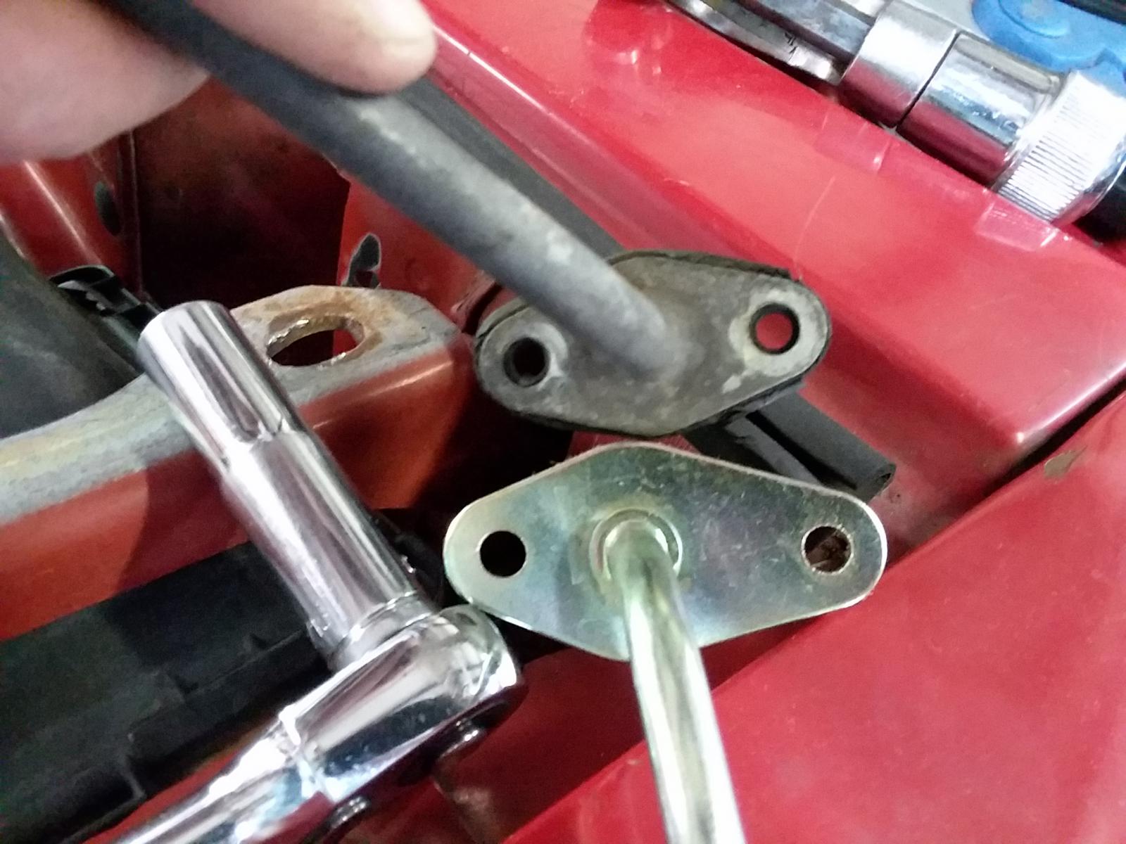

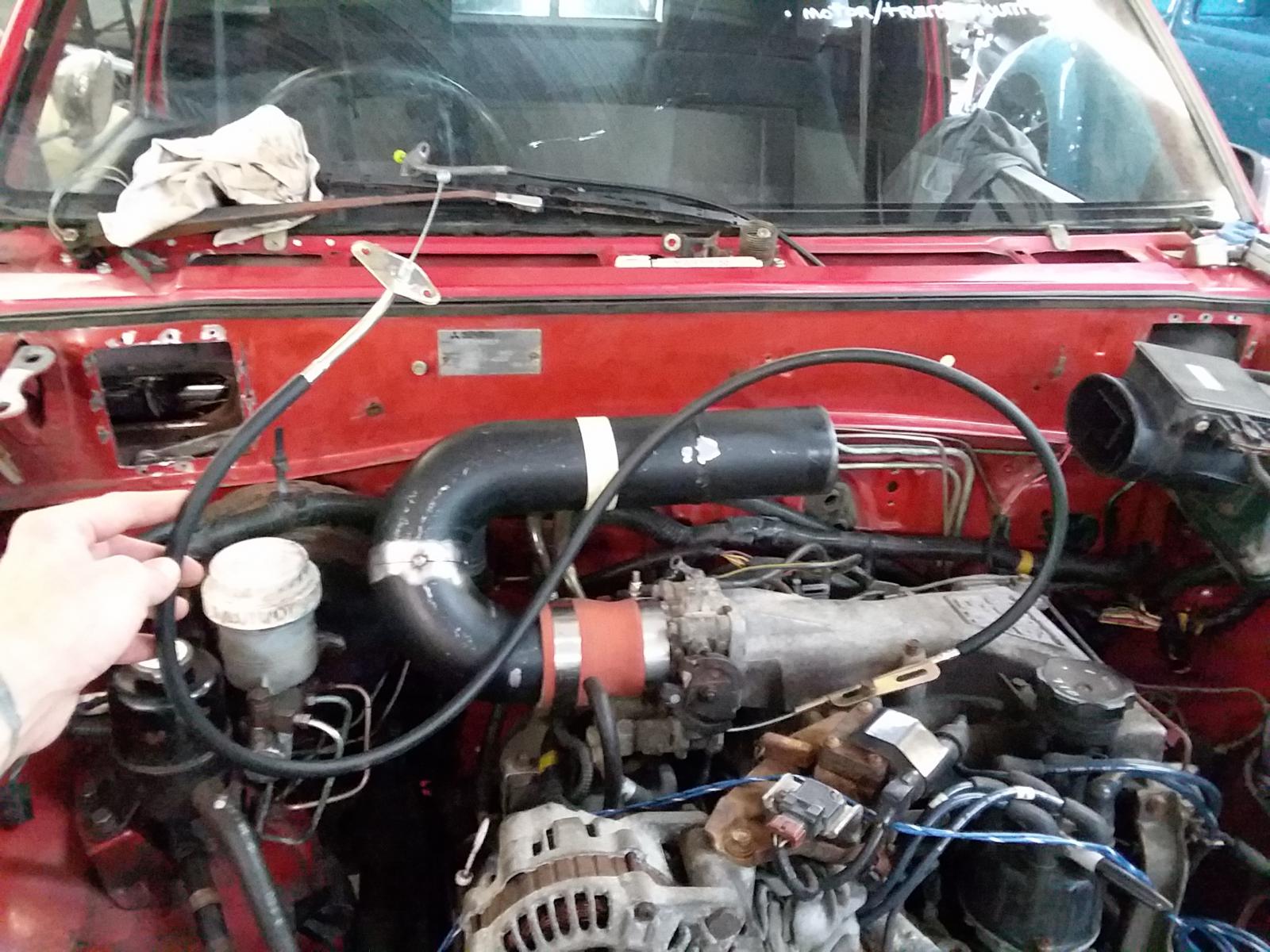

    id nearly forgotten about the throttle cable....
    i ordered a cable from a 1990 mitsu galant, it measures 65 inches rather than the 34 inches of the
    stock 1991 mighty max cable (curiously the rockauto site listed the replacement aftermarket max cable
    at 41 inches, which i almost purchased but didnt want to risk it being too short. and the galant cable was
    on clearance for $10, $20 total shipped, bloody teevs...)
    obviously its far longer at 65inches
    difference in the flanges, as i have to drill the holes to mount it anyway.
    and theres where its going, the black rubber gasket stuck to the firewall is where its gonna hafta go
    theres very little flat surface in the area, its quite multi-faceted

    the air filter housing got damaged when i tied to butt-hump the box truck, im going to run a cone filter
    temporarily until i can fab or find a nice little 10inch cube airbox i can mount there and plumb a snorkel
    into eventually... although i doubt ill ever have to do any river fording that would be that deep.

    throttle cable installed
    this is more where the MAF is gonna go, minus the OEM airbox:
    now i hafta fab the throttle pedal arm....
    ...among many other things.

    1991 Mitsubishi L200

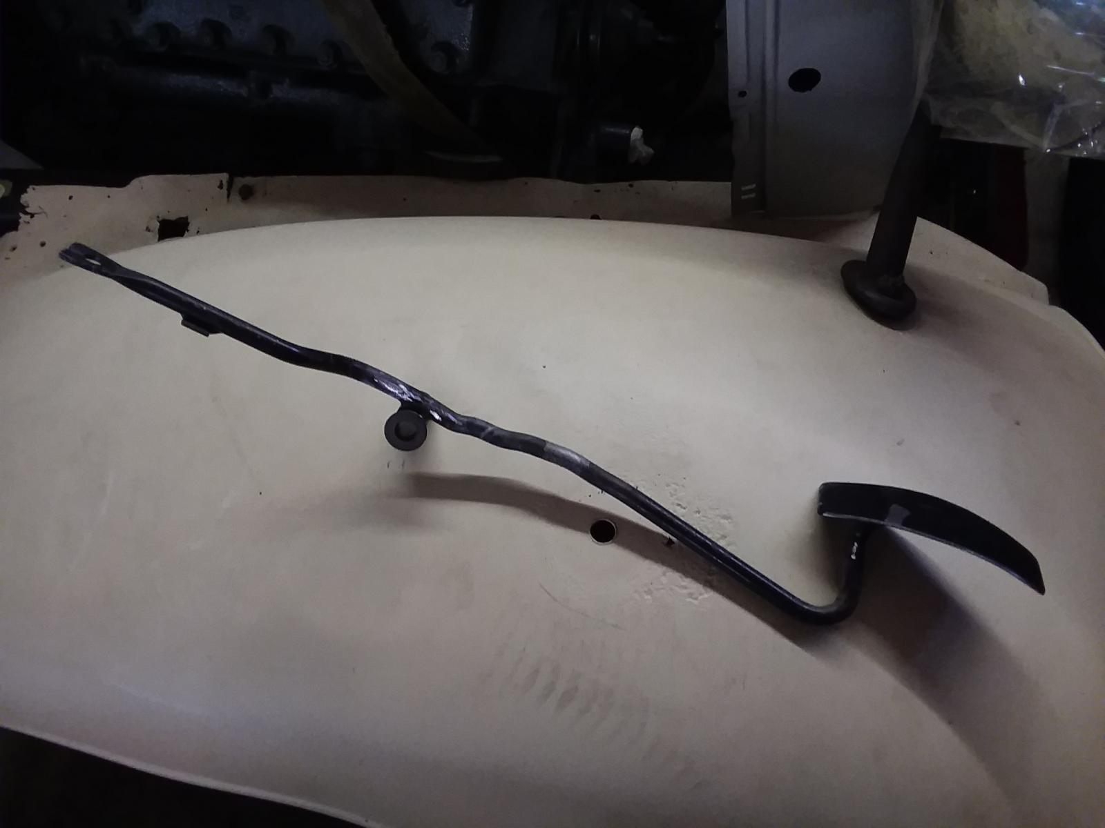

    almost done. its too long, ive gotta cut the arm & shortn it a tad, but it works.
    i had to use a torch and heat up the LHD bends, straightened it out, and bent it where
    i needed it to go. i had to twist the pedal end itself around 180 deg, but i think its gonna work out alright.
    at first i was trying to replikate the OEM rhd arm exactly, but i ended up just doing what i needed to.
    i forgot to take a pic of the LHD arm before i started....
    03-02-2019
    166
    Connectisuck, New England
    fini
    but i hadda scootch the clutch & brake over to the right a tad, now ive got room
    for a dead-pedal on the left next to the tunnel.
    im starting to work on the dash a bit, at least making the cardboard templates.
    drivability-wise all i need to do now is finish tweaking the shifters to the right & weld
    on the short throw extension, then fab a little riser box to pick up the pivot point the same
    as the extension im welding into the sifter to change the length between the pivot point and the
    end of the sifter lever that moves the shift forks, etc.... ill post pictures wen i begin the surgery.
    the process shouldnt be too difficult for anybody with a decent MIG welder to replikate on their trucks.
    The pedal layout looks better. A footrest for lefty would be a nice touch (you get used to them being there in more modern designed cars) You using the stock pedal covers or something a little more flashy?

    short shifter started, should be finished by later tonite. im going for a ride before it gets cool.
    so once this tower is welded together, i just have to extend the shifter end
    the same length and the throw should be stupid short. i decided to go with
    1.5inches instead of 2in, but it should be GREATLY reduced in throw. then im
    extending the upper portion 4 inches or so to make up for the body lift, i like
    my shifters close to the steering wheel.
