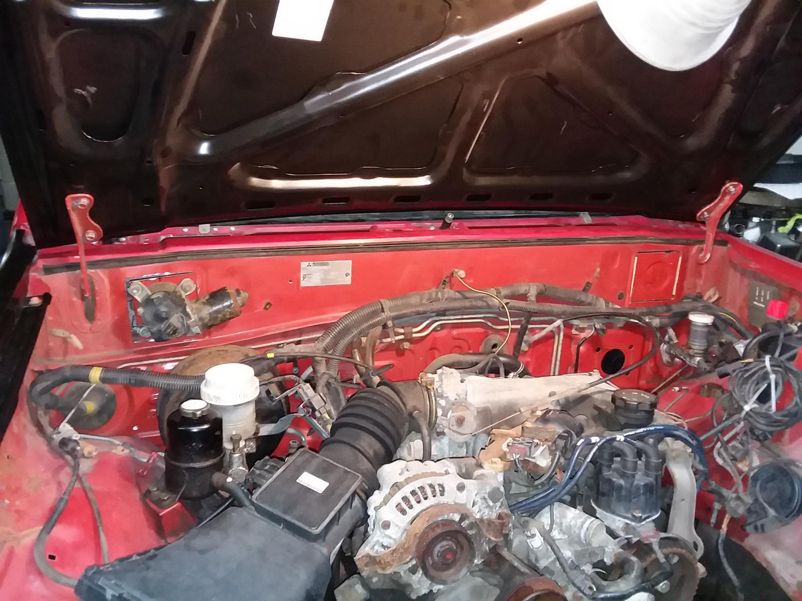

    That canister is for your rear ABS.

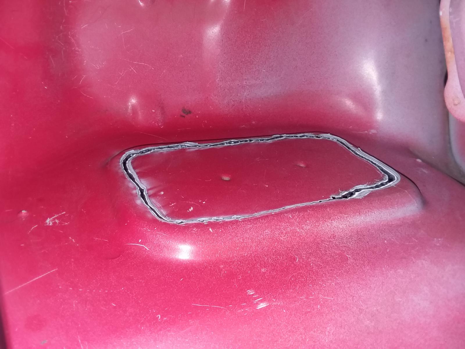

    Grrr of all the places to blow holes in a panel, the roof turret is the worst place to do it.
    i know right? idk if im gonna tryin weld them up, or just dimple eash hole in a little bit, & use this underwater
    fairing filler for sailboats that my dad uses, stuffs even petroleum resistant. ive used it to replace shifter bushings
    on my e30 and covered in grease theyre still tight 5 years later... not big on filling holes but i dont know if heat
    is gonna be a good idea on that paper thin roofskin. i dont want to warp it any worse than it is already.
    ABS? then its outta there! what does that line going inside the cabin go to??? i havent and am not sure if i want to
    pull that rear interiour panel off...
    if i am indeed going to remove that rear load-sensing proportioning valve contraption, as i believe i am, then
    i was curious if i should keep the x2 lines that go back to the rear axle, or just run a single back and tee it
    to either side???

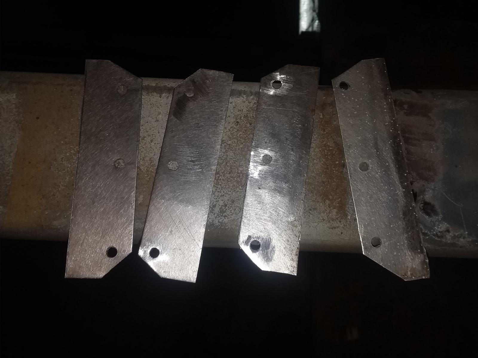

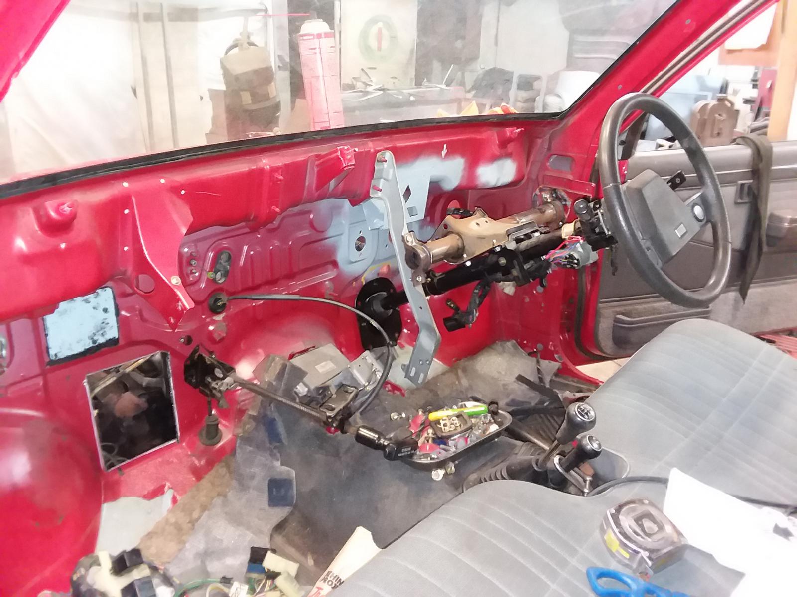

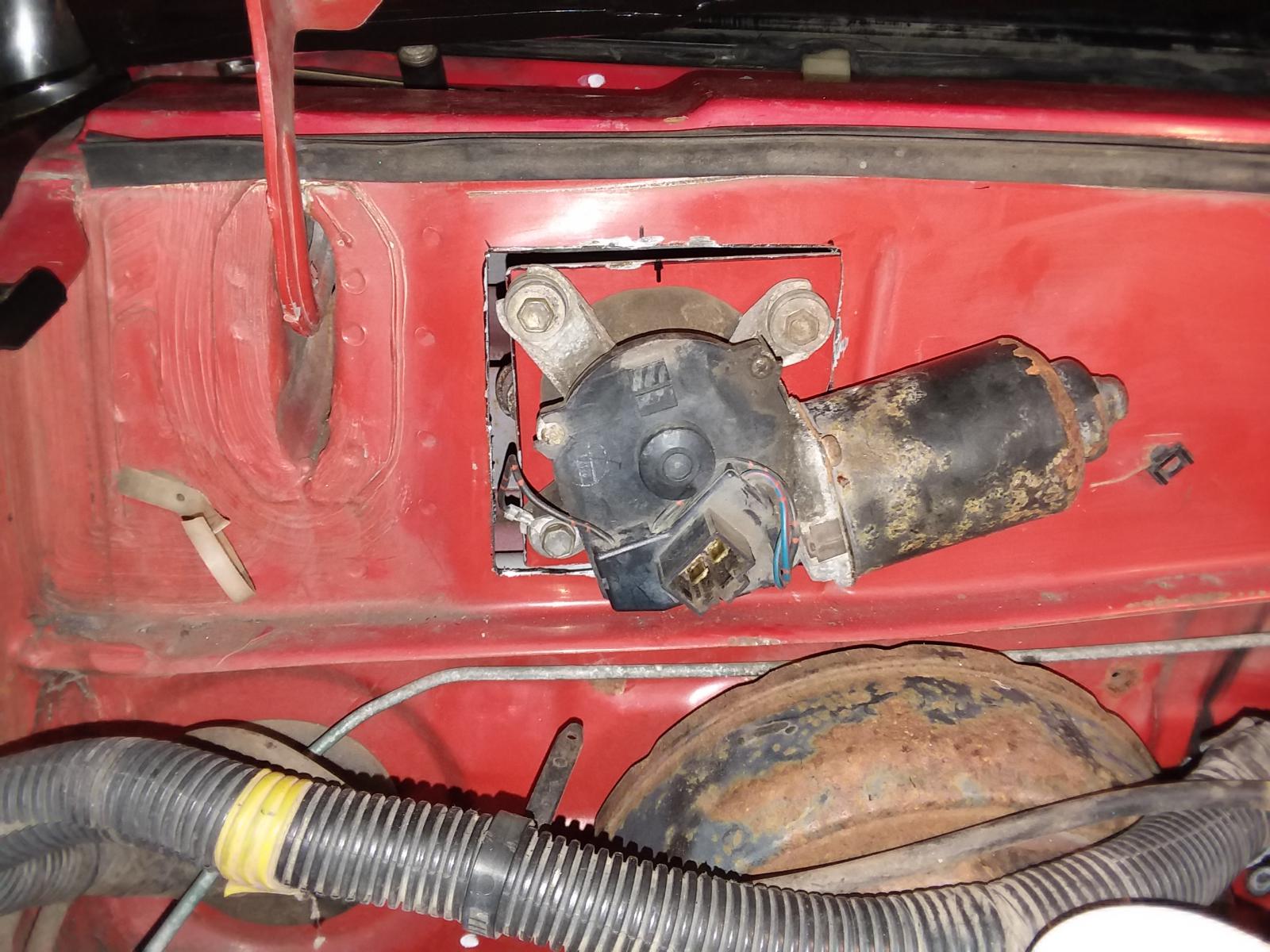

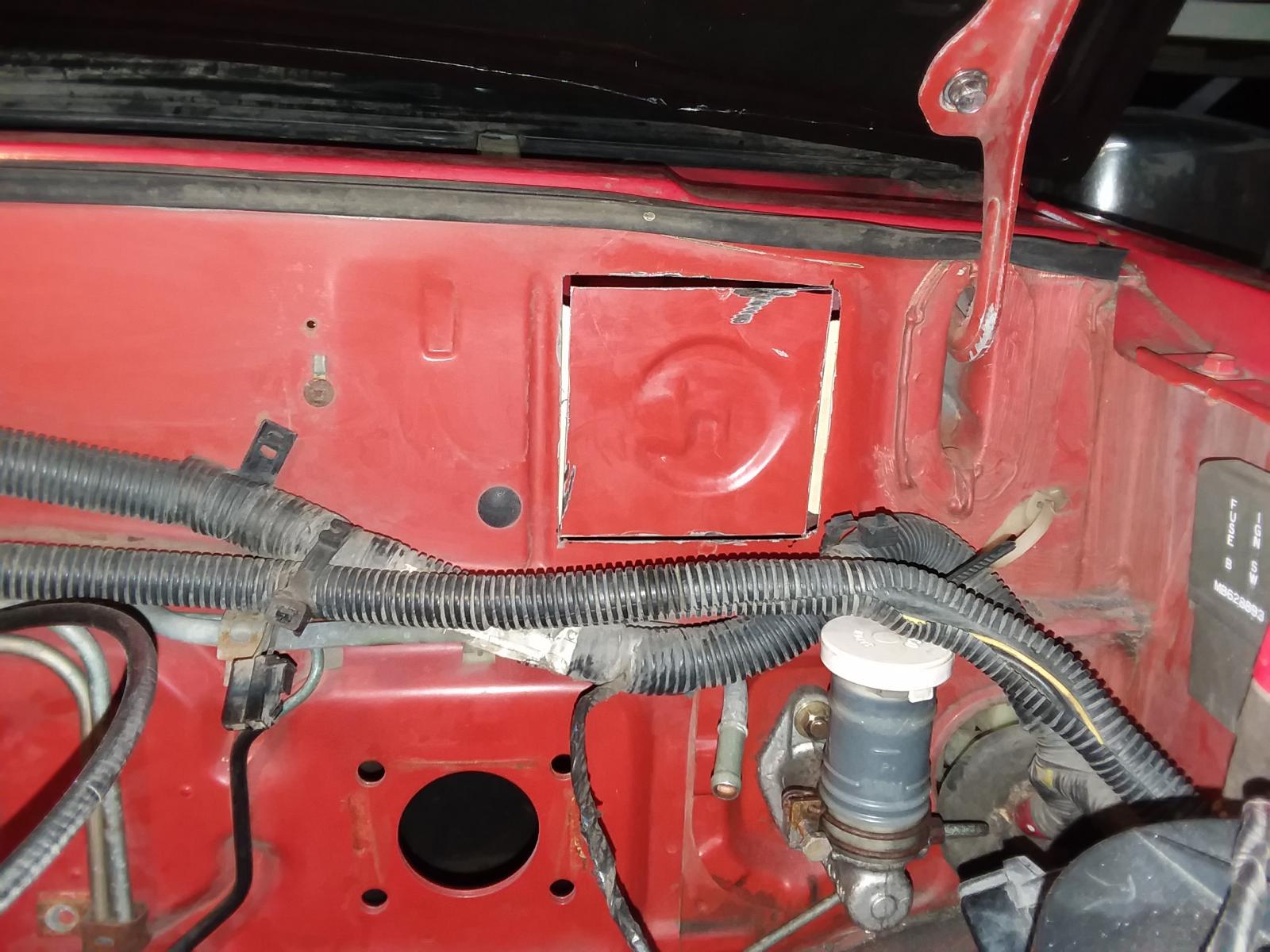

    heres a lil more on the wipers....

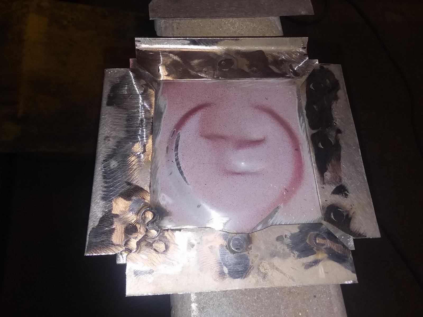

    i still hafta flange the two panels and spot weld them back in, think i got the linkage correct as well.
    Attachment 22133 Attachment 22135
    you can see the harness in this shot, the two leads that go to the engine are almost centered on
    the firewall, so it should flip over and swap sides pretty easy.
    Attachment 22134

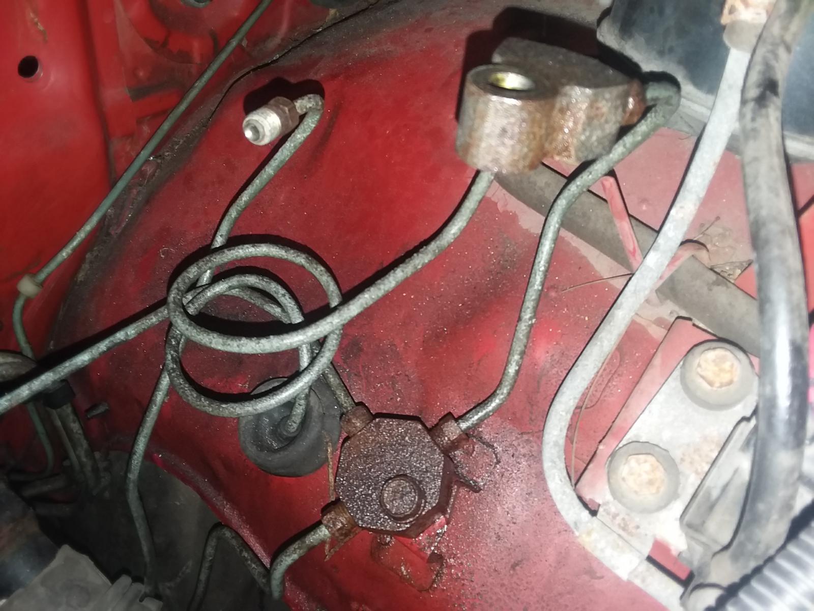

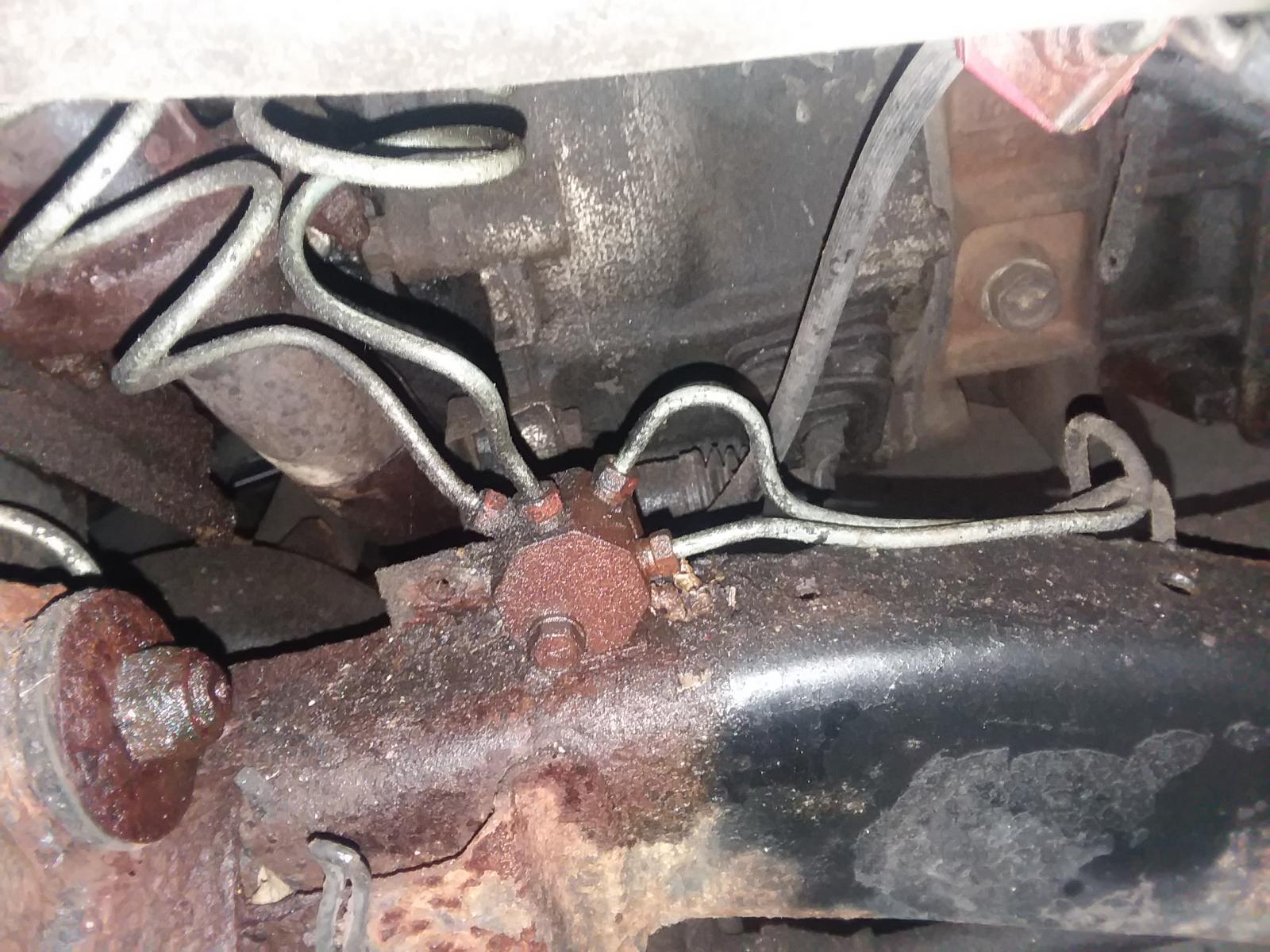

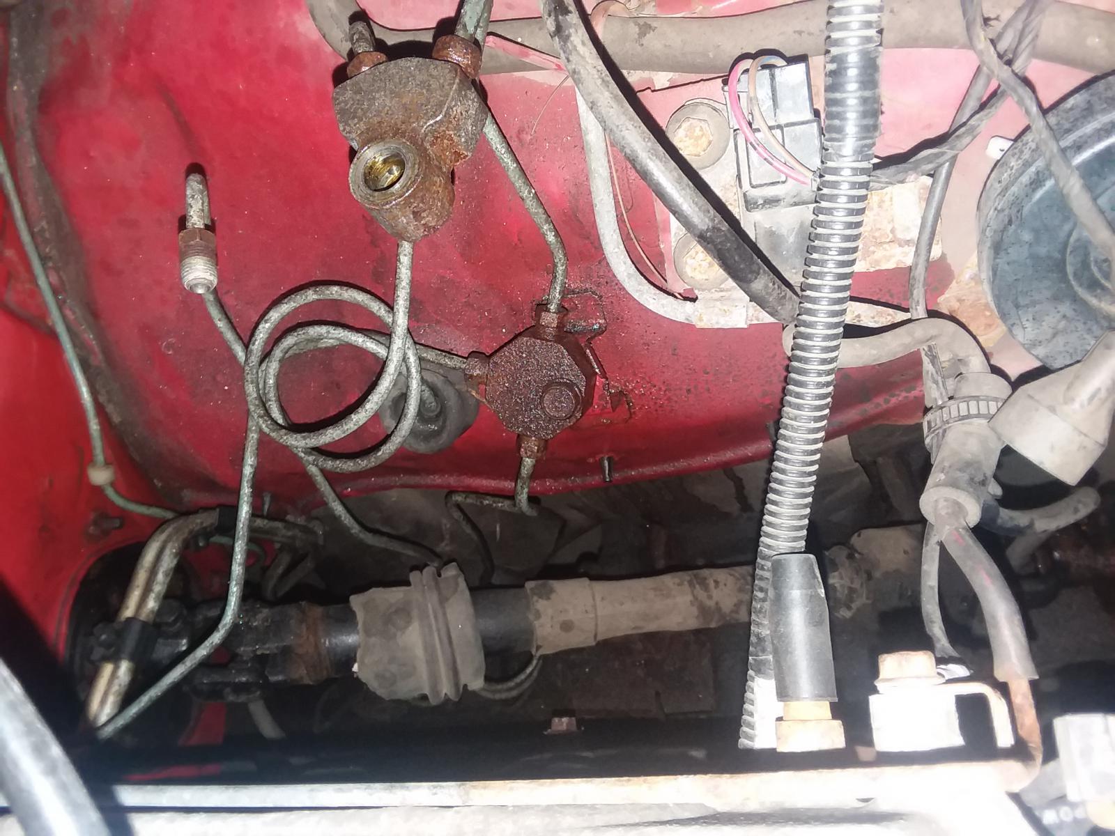

    been lookin at the rear brake lines a lil more, i appears that one line gets T-ed from the front caliper lines
    and a 2nd line comes out of the rear (closest to booster) master cyl port, drops down next to the line
    coming from the front brake line and both go back into the rear load prop valve.
    makes me think that the valve might sned more pressure from the front circuit when there is a heavy enough
    load in the bed. the ABS canister thing must be there to keep them from getting enough pressure to lock the
    rear wheels im guessing... ill have pics in the early hours or tomarra some time.

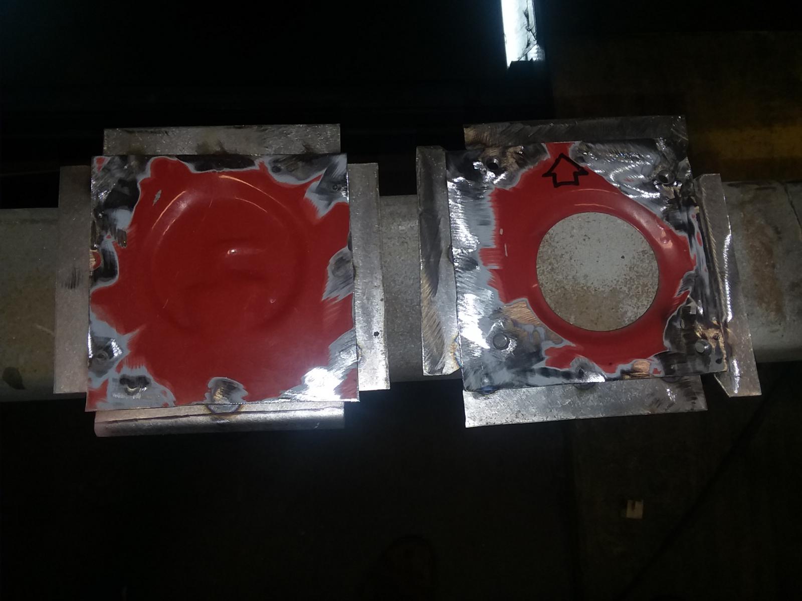

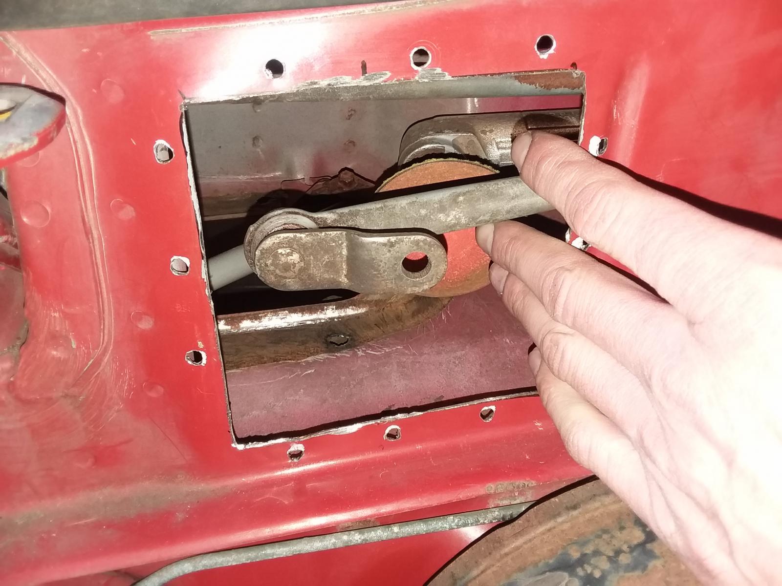

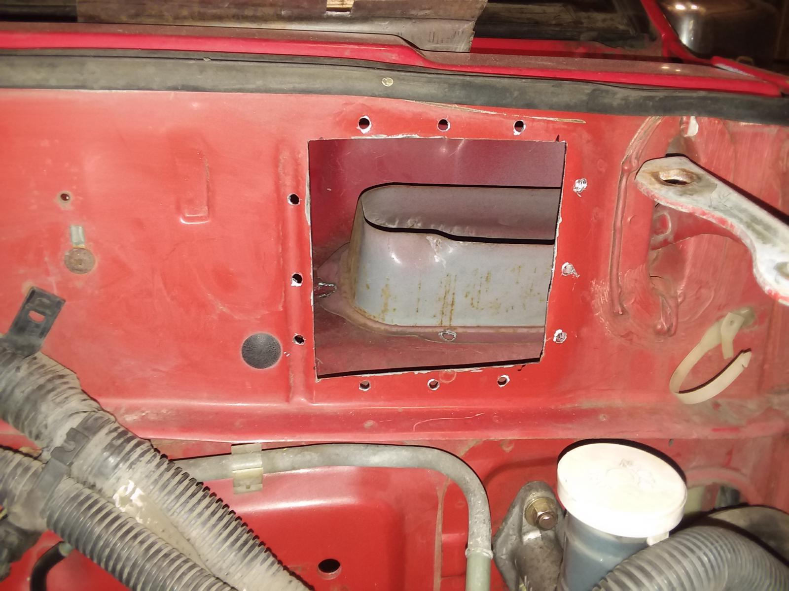

    wiper linkage done:

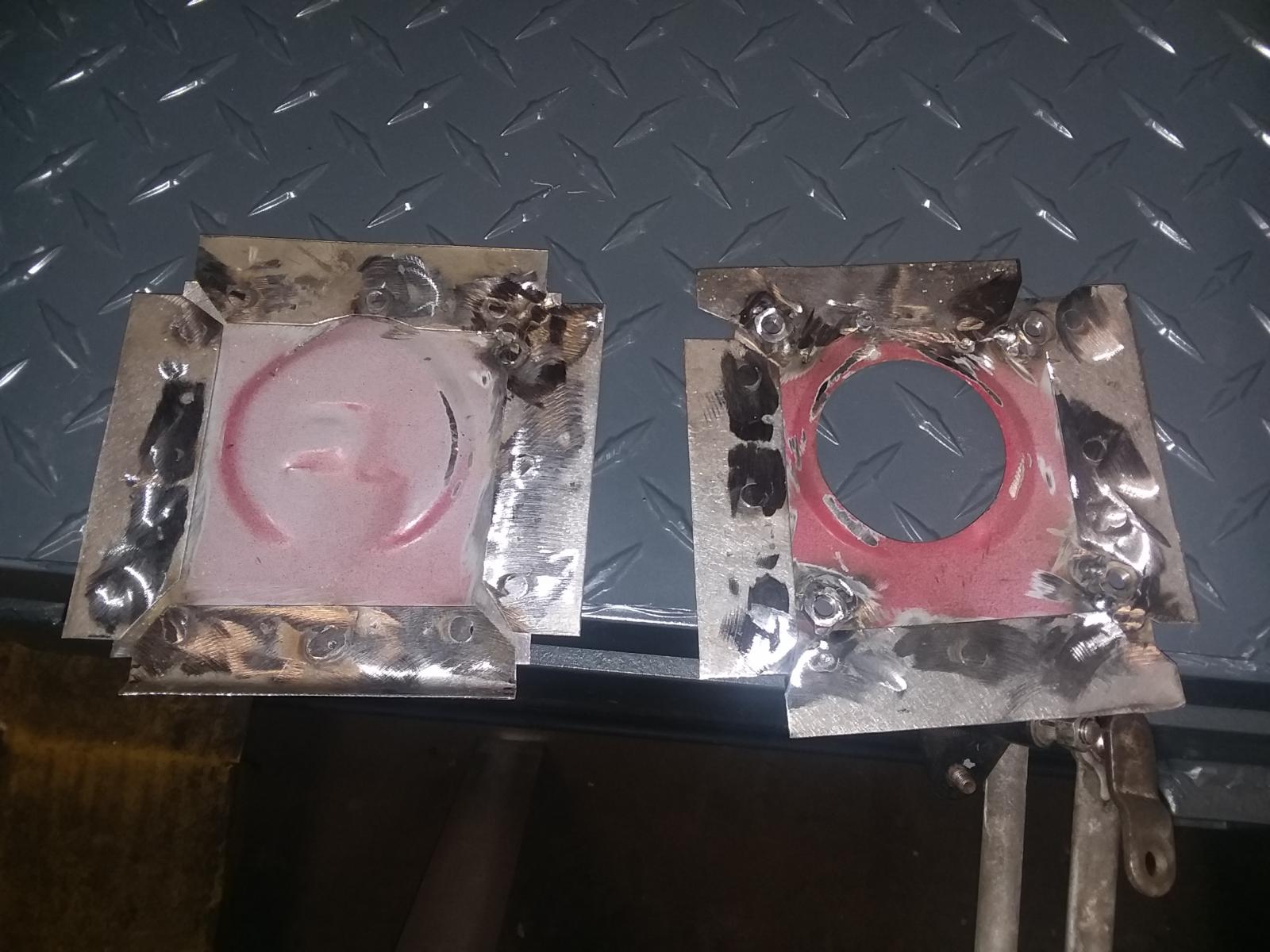

    flanged the motor mount & blank:
    and spot-welded them on the panels:

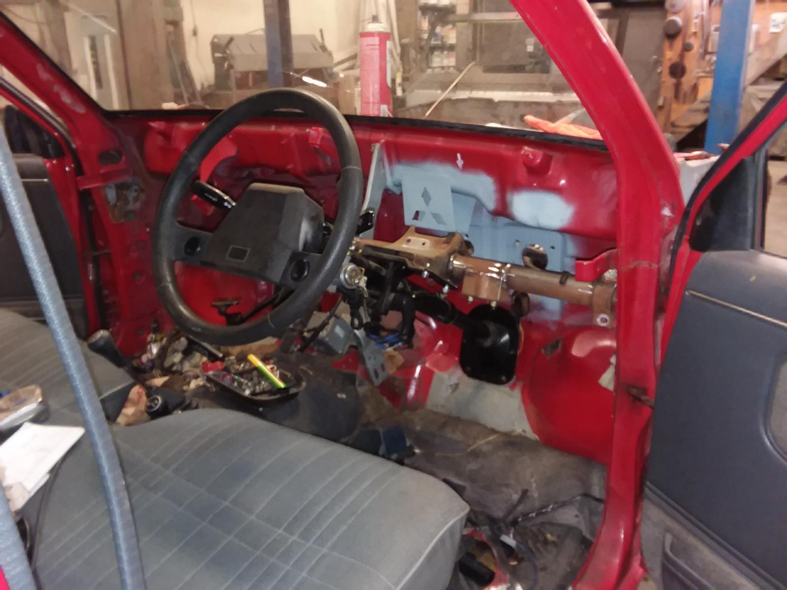

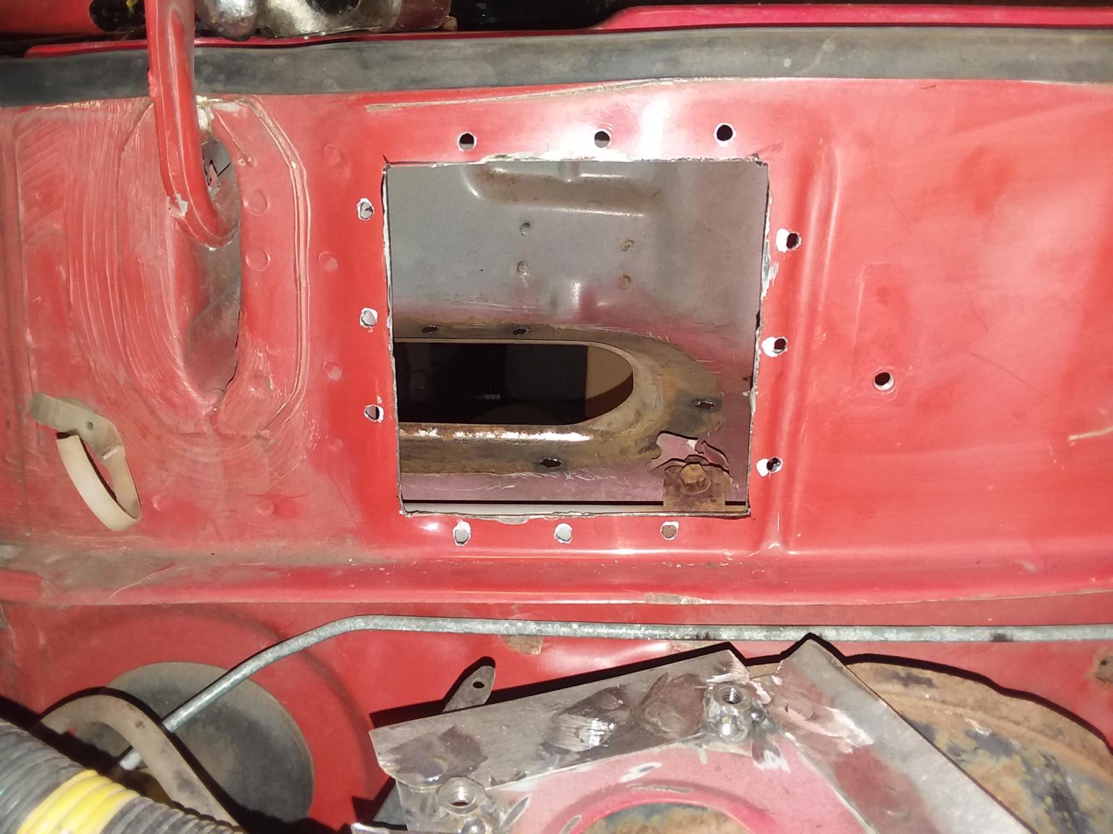

    drilled out the surrounding firewall:
    i didnt get a shot of them in place and i havent welded them in place because
    i have yet to cut the new blower intake, but i did remove the intake lip thing
    you can see it in the last pic where its getting moved to. im just going to use
    adheasive seam sealer and just glue it in place rather than of spot welding it,
    the lip and the new rain gaurd that goes above it to keep the water from going
    into the blower. once i get those installed ill weld in the panels & blend it all
    in with filler then fair it in so it looks like nothin happend....

    ah yes and the brake lines. heres the lines as they are minus the master & booster
    i still havent gotten shots of them down the frame & to the rear end tho...
    this is the cluster of splitters after splitters:

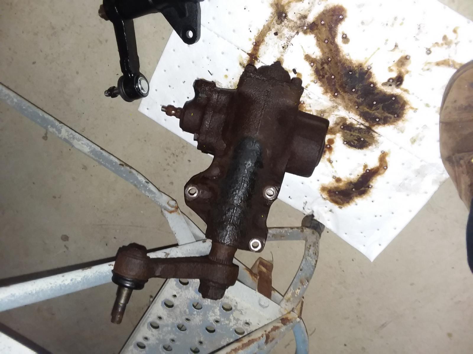

    so as far as the steering box i ordered 3 weeks ago, heres the message i got from the
    doucher wet-hand i purchased from:
    "I just received back and a fine of £200 because cwas leaking oil...I wrap again cand send it tomorrow better drain"
    in short i said that this is crazy, i want pictures of a shipping receipt, tracking number, and proof of expidited
    shipping. otherwise im turning this over to ebay for refund. totally amateur far as im concerned. i hope he did get fined
    if he cant drain a steering box and put it in a couple plastic bags and newspaper before boxing it up. what the hell.
    im kinda pissed about this.

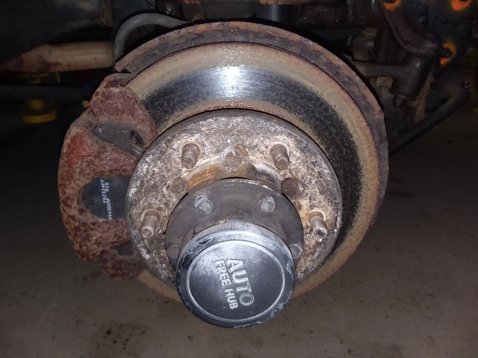

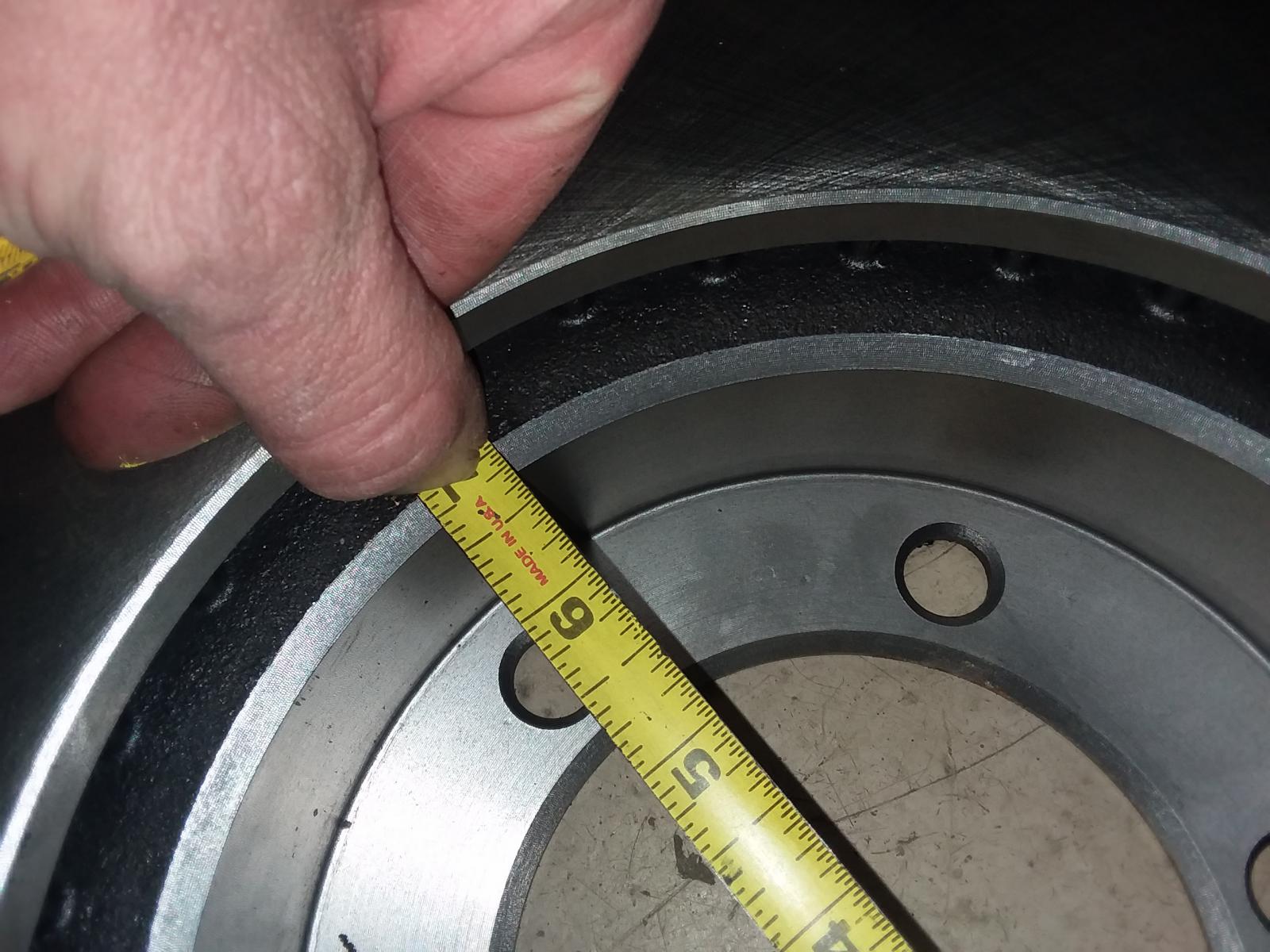

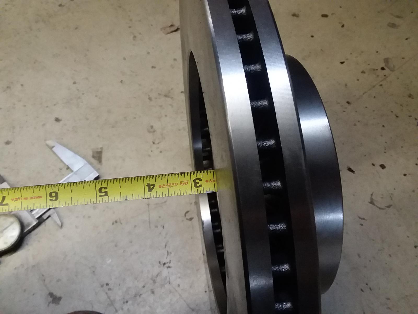

    But regardless of the bullshit, i ordered a Tundra front brake rotor for fittiment on monty here.
    my findings were fruitful-ish:
    So my first issue was that the toyota rotors bolt on in-between the hub and the wheel, where the mitsu rotor bolts to
    the back side of the hub.

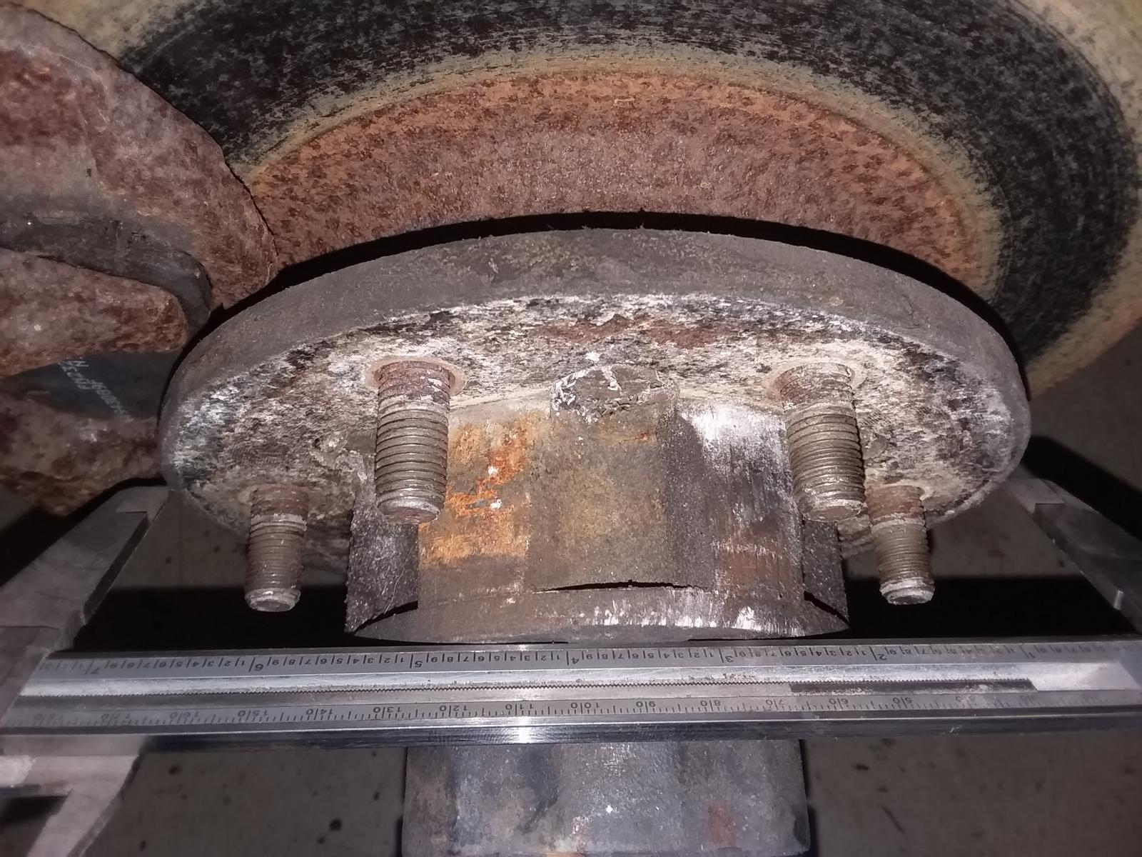

    Now, 1st i wanted to see the offset of the toyota rotor hat as well as the rotor hub diameter to make sure itll
    clear the mitsu hub and sit at roughly the same spot as the stock rotor.
    and the tundra rotor sits at the same spot as the mitsu rotor, the tundra going on as it does on toyotas,
    in between the hub and the wheel.
    the only thing thats going to need modification is the mitsu hub itself, which is quite a bit bigger diameter
    than the inside of the tundra rotor:
    but there is more than enough meat on the hub to machine it off and still have plenty around the studs,
    which might need to get swapped out for longer ones...
    i havnt gotten a caliper to play with yet, but im hoping that the rotor being close to the stock position,
    and the fact that the 4-piston tundra calipers dont need slider pins, hopefully itll be straightforward to make
    some adapter brackets to mount them up. ill post up more when i get a caliper.

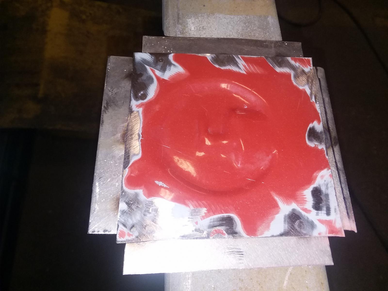

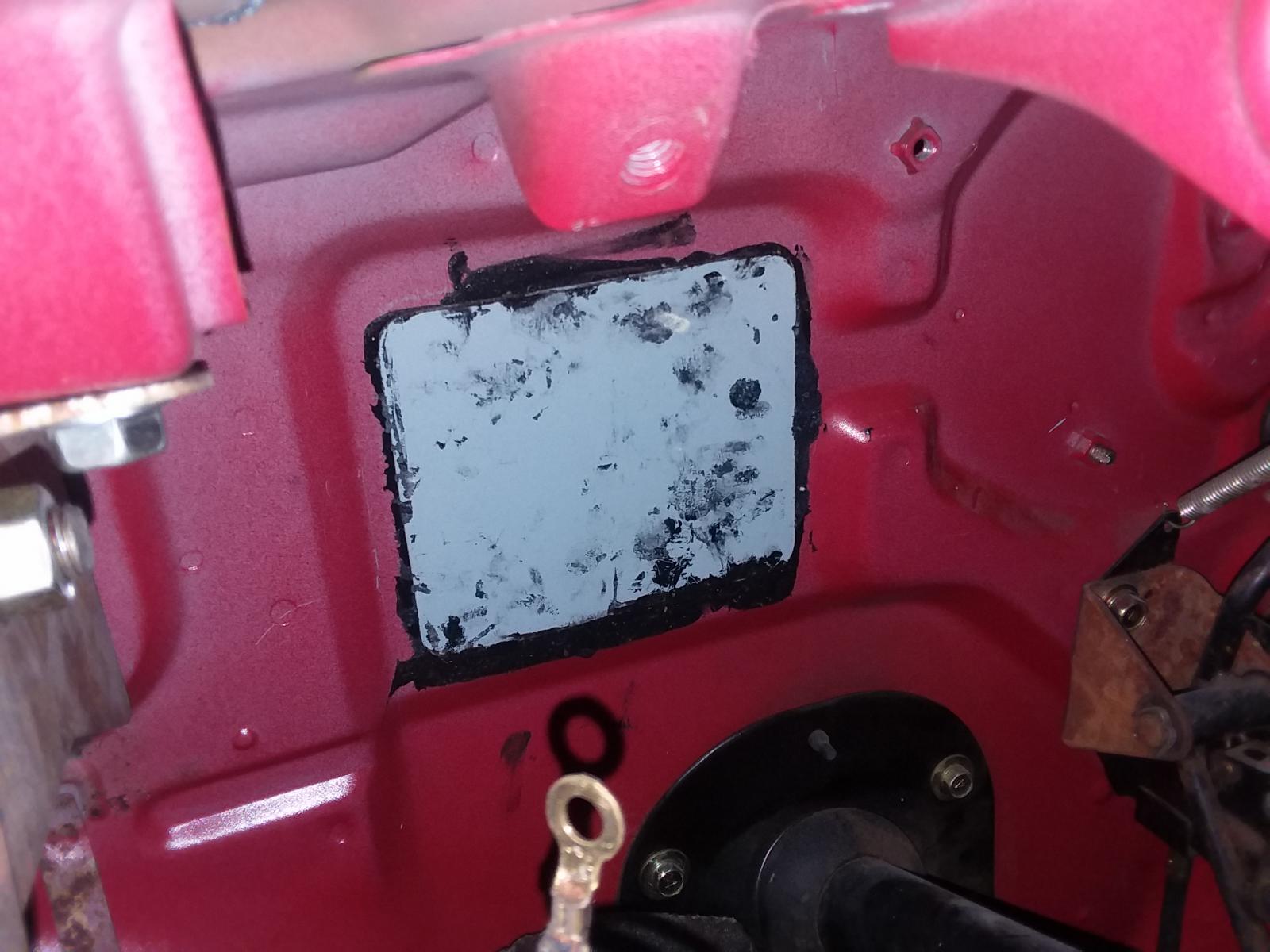

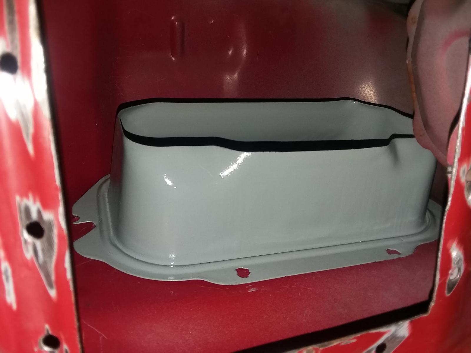

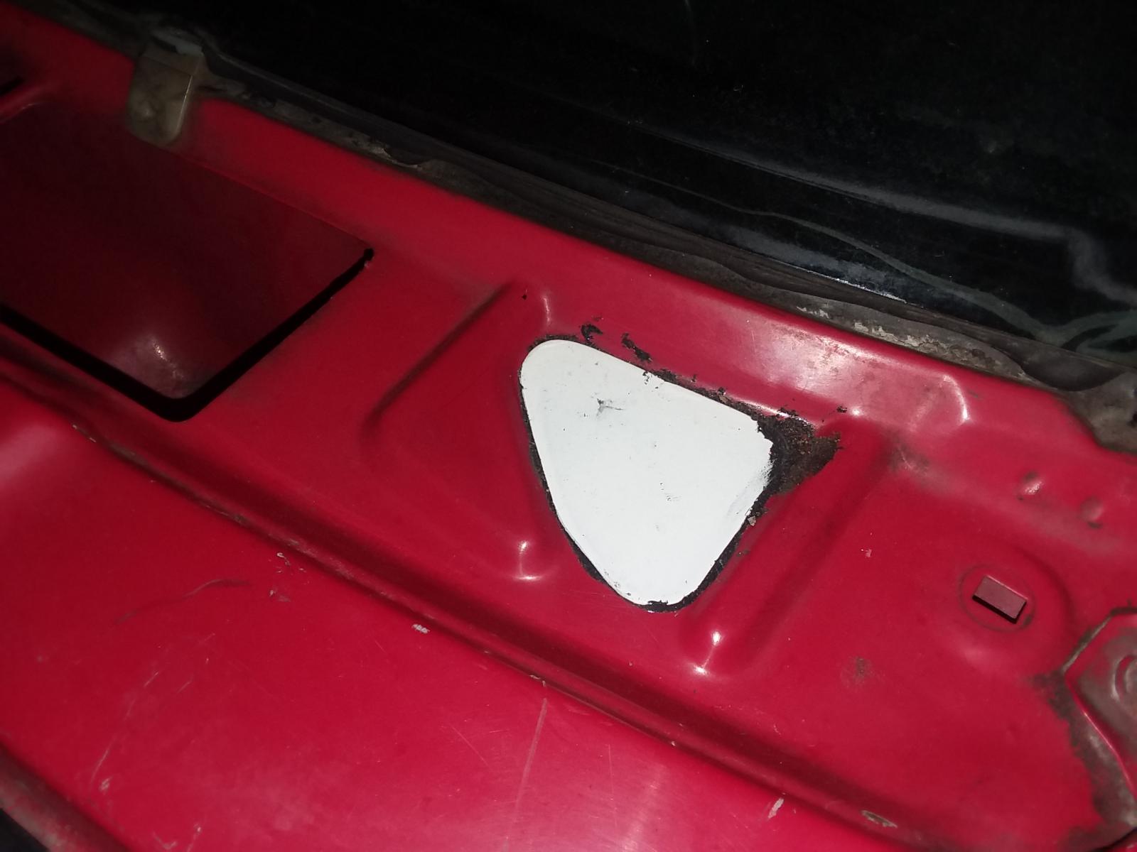

    so like i said, very little got done, but i glued in the block off's for the left-most wiper hole,
    as well as the brake booster:
    i plasma'd out the blower motor port, but theres a bracket spot-welded up under the
    dash holding it i place, i have to drill them out and itll all pop out.
    next i have to glue the rain gaurd/lip thing down around the blower inlet.

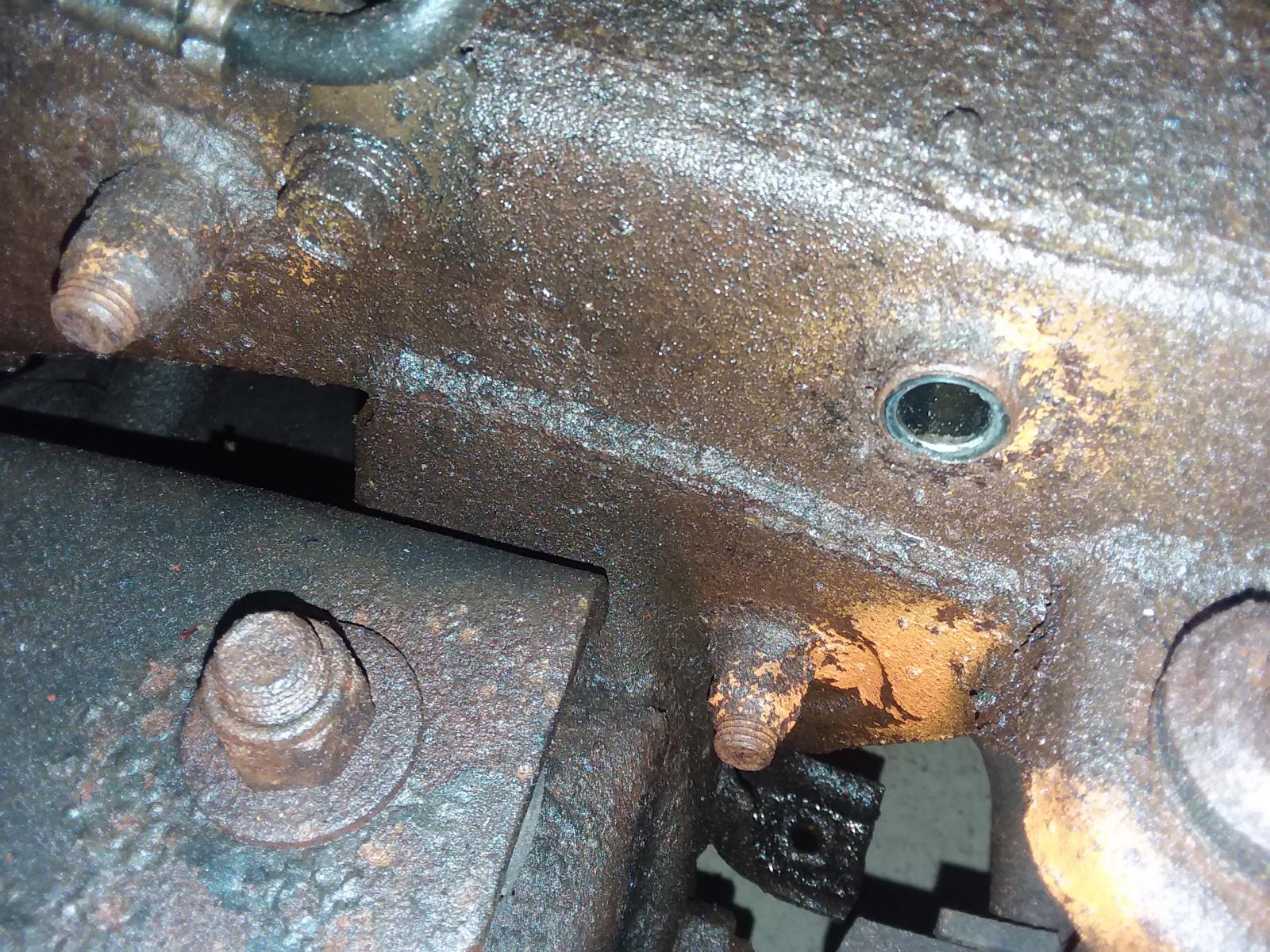

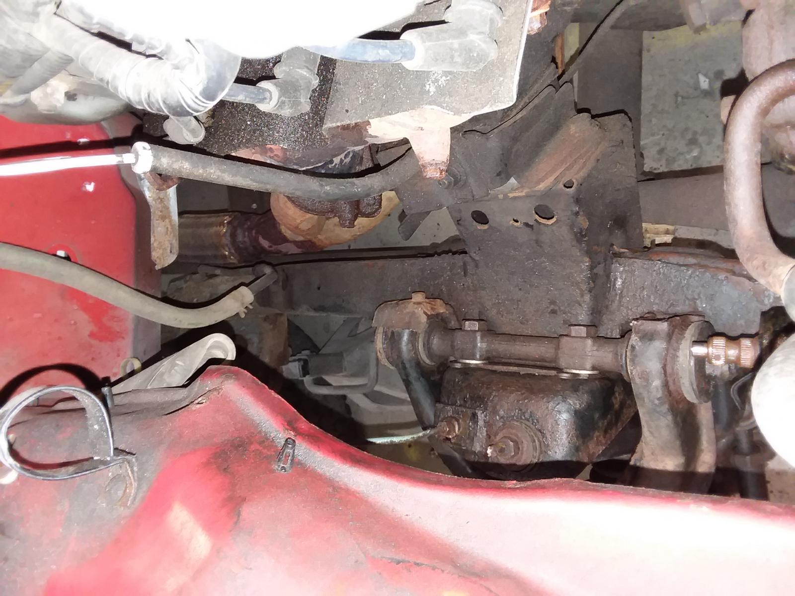

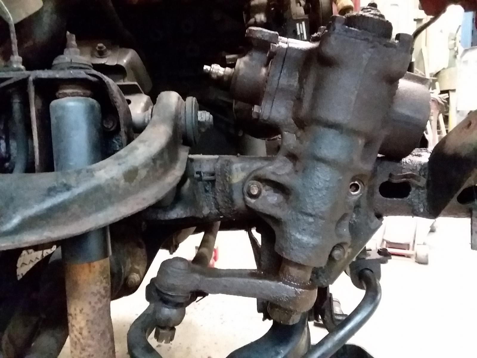

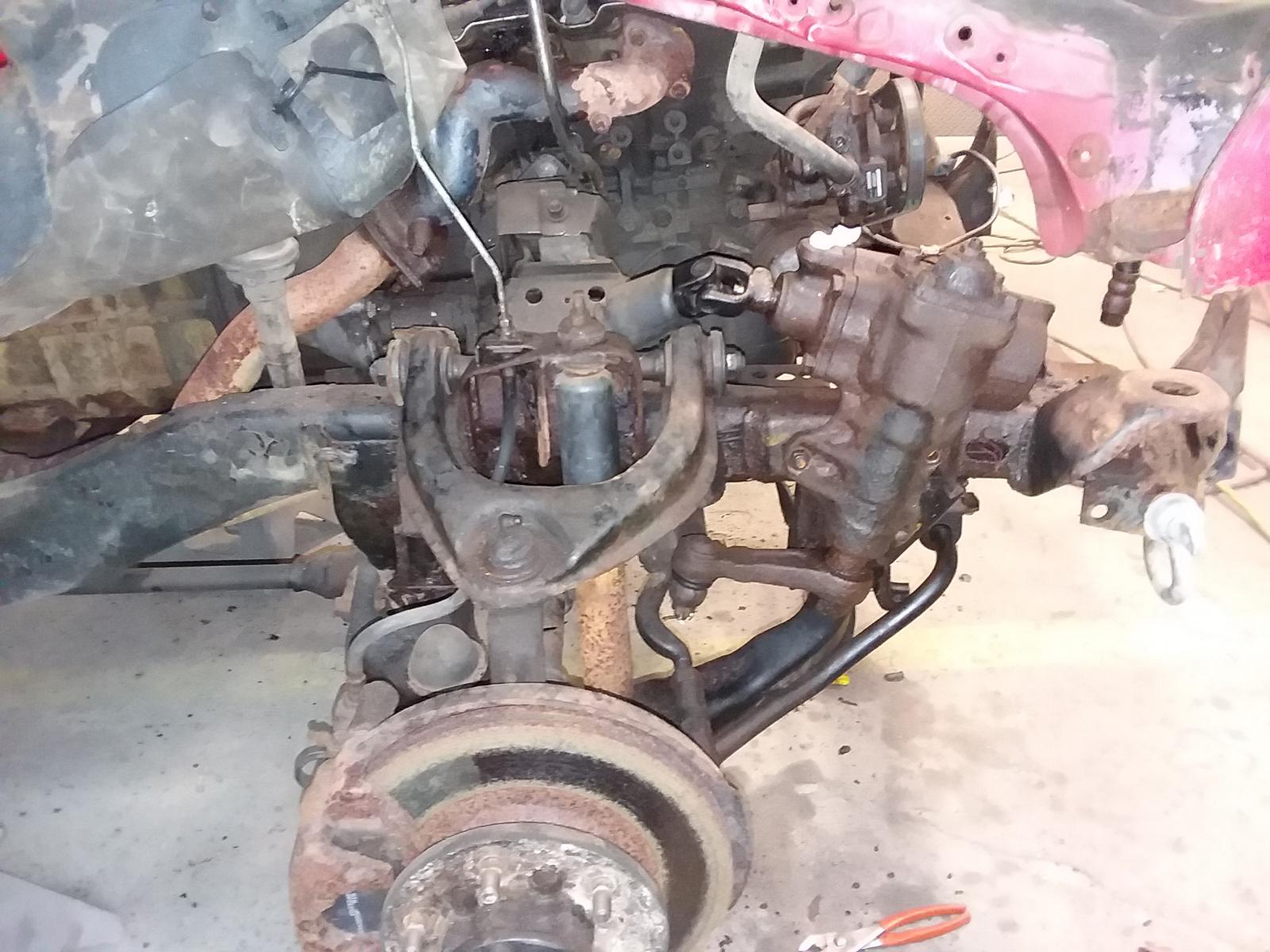

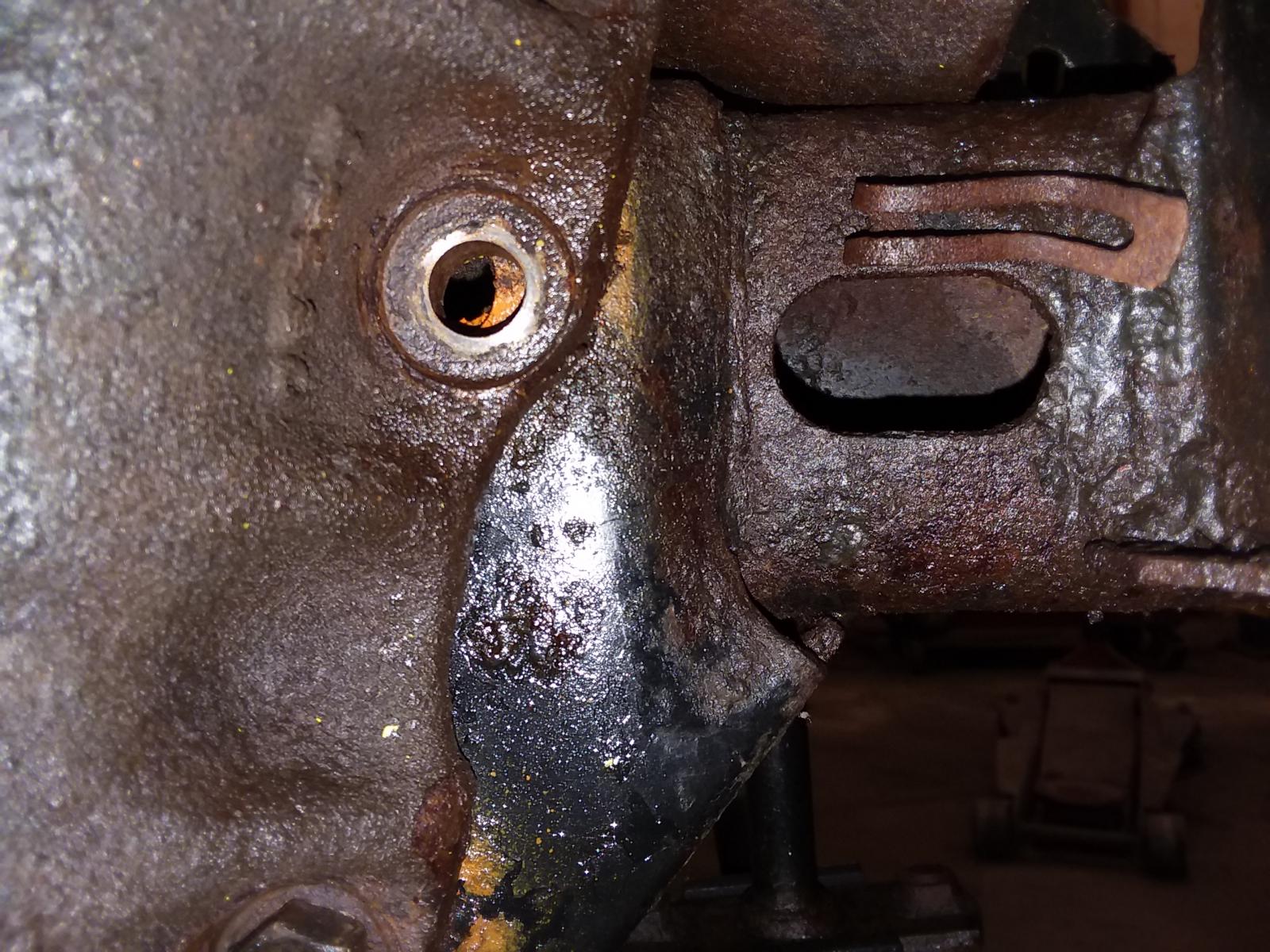

    heres the steering box mount points, minus the front upper bolt
    you can see the bosses are actually each a piece of pipe that goes all the way through
    the framerail and is welded on both sides. so i hafta cut out the rear-most boss and move it back
    about 1/8 inch, which is a small amount for all this work i will admit. but being that they are welded
    in lengths of pipe, i cant oval them out, and i dont want to use a smaller diameter bolt.
    with the plasma cutter and the MIG it wont be but like a 45min job.
    The only foreseeable hang-up will be the longer arms on the idler & steering box.
    if i cant make them clear things as-is, im going to see if the arms off my OE max idler & box
    can be swapped onto the newer mkIII L200 idler & box. if THAT fails, ill hafta move BOTH the
    frontmost 2 box mount bosses instead of the 1 rear boss, or possibly even all 3 of them forward
    to clear the longer arms (i have a sneaking suspicion that between the box and the arms that the
    steering ratio mite, hopefully, be smaller lock to lock....) but i could also see mitsubishi just re-using
    the same ratio box and just changing the arm lengths of the box & idler to decrease turns.

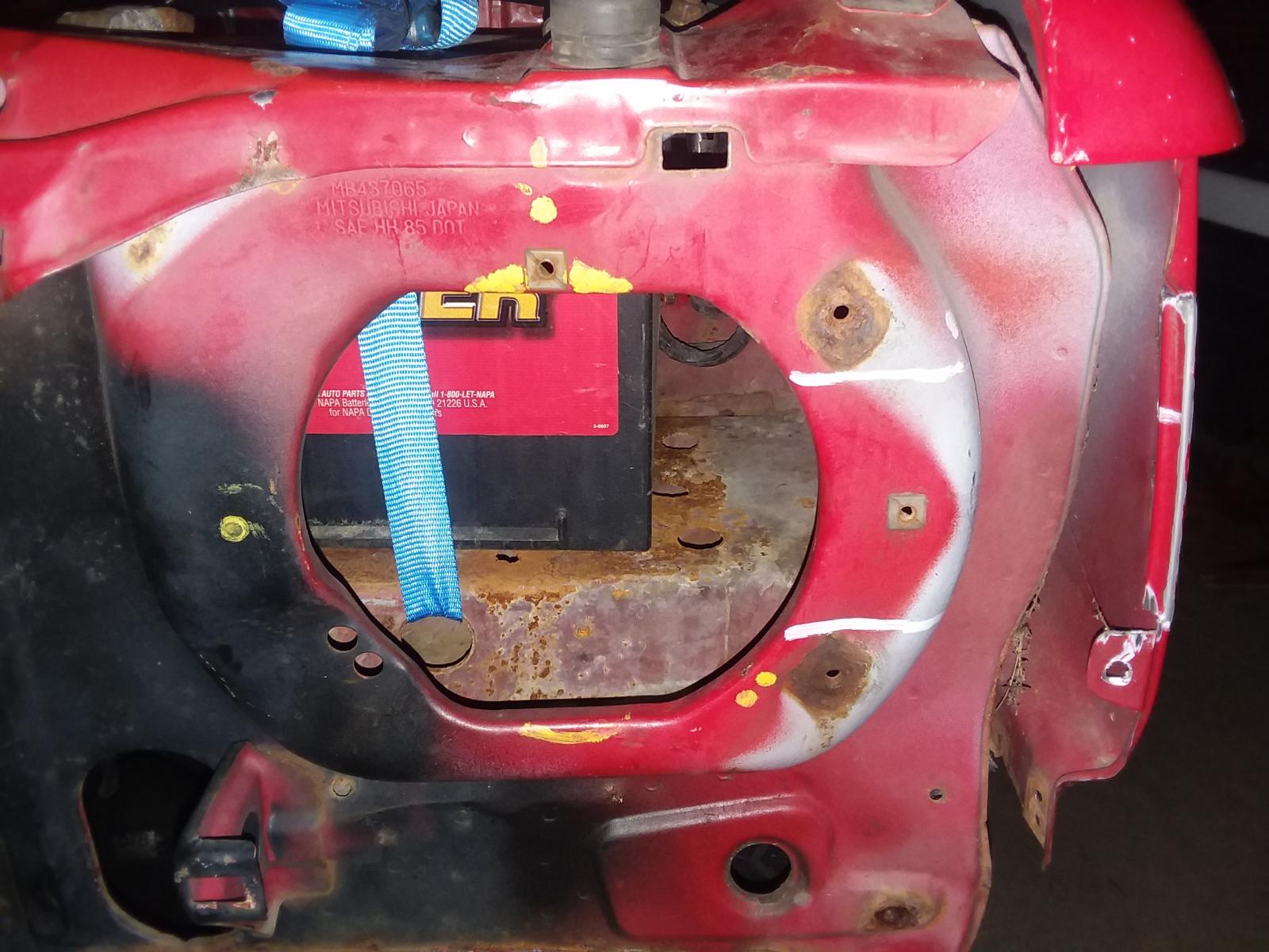

    im pondering what to do about my radiator support now. im going to have to seriously modify
    the existing headlight surround to go from the square headlites to the round ones.
    the yellow marks are where the adjuster holes need to be, and im gonna hafta cut out the parts
    in white outline to fit the montero bezels & corners.
    so im leaning heavily towards scrapping the entire OEM radiator support & making everything
    custom from new steel stock. i think itll save alot of time & look good too.

    finally.

    It looks pretty crusty, nothing a date with a wire wheel and maybe some new hardware won't rectify.

    good news thus far, the box fits the 2 farthest holes front to back,
    so i can get the box and idler arm bolted in with 2 bolts each for now, and focus on moving the
    column over as well as the clutch and throttle pedals.
    hes some crappy shots of the right and left sides:
    so ive got like 6 hours to do the column, clutch & throttle.
    and itd be nice to flip the harness over as well but im not gonna get overly-ambitious.
