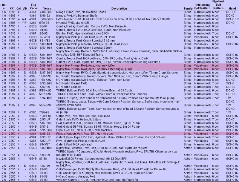

can someone help me here, I have a 1984 Ram50 LO26(two wheel drive) with a 2.0 (G63B)engine. I have the opportunity to acquire a 1984 Mighty Max with a 2.3 engine, the engine is fresh out of the machine shop (rebuilt). My Ram 50 is a 4 Spd whereas the mighty max is an automatic. I need to know if the bell housing on my Ram 50 will fit the bolt pattern on the block of the mighty max (2.0 Ram 50 vs 2.3 Mighty Max) want to swap out my 2.0 with the rebuilt 2.3 and keep my 4 Spd tranny, any and all help would be greatly appreciated.
