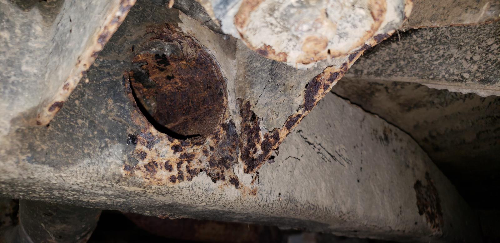

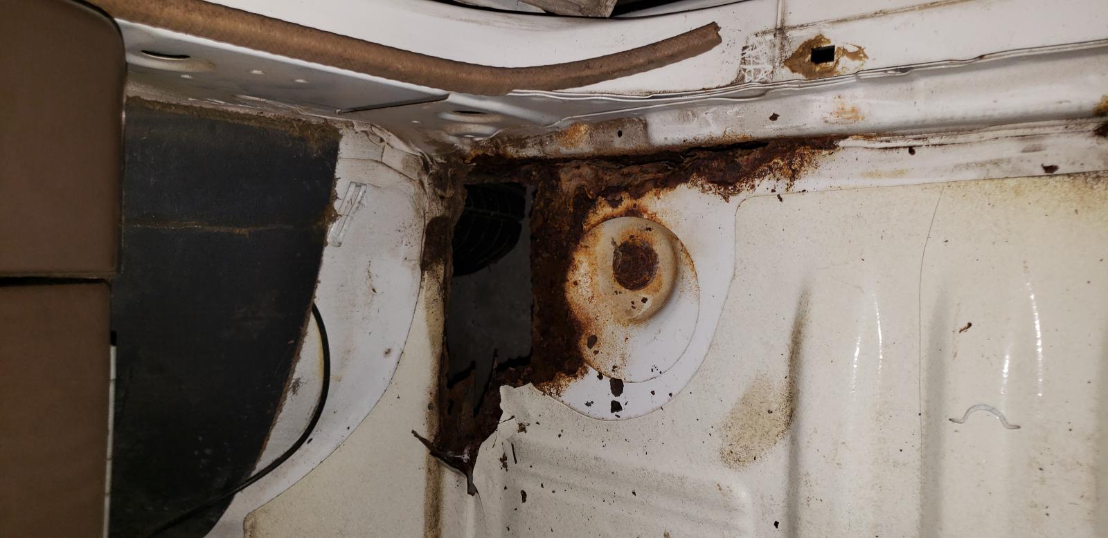

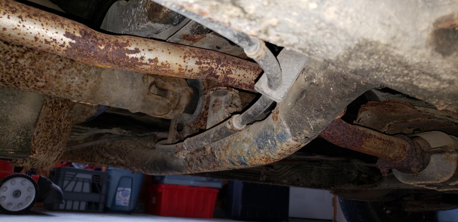

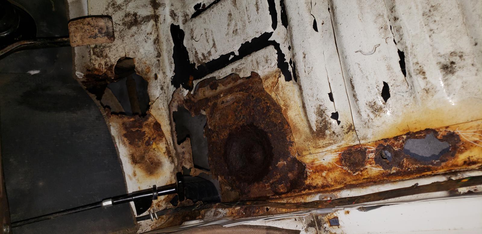

    A lot of floor pan and frame rust , runs - drives with leaks of course .... Is it worth trying to fix ? body parts like floor pans seem like they are not available
    Need advice so any links to body parts , repair parts appreciated20200426_134128.jpg20200426_134159.jpg20200426_134248.jpg20200426_134253.jpg20200426_134128.jpg20200426_134159.jpg20200426_134248.jpg20200426_134253.jpg

    They are worth fixing if you want to keep the truck.
    Find me on FaceBook
    clicking HERE.
    If you're comfortable with welding that's not to hard to look after. If you want to keep the truck you can strip it down in a weekend, then sandblast the frame and paint it in a rust proof paint (repairing the frame as needed). The cab once off can be repaired with it standing on the back of the cab.That way you can get at both sides for repairs.
