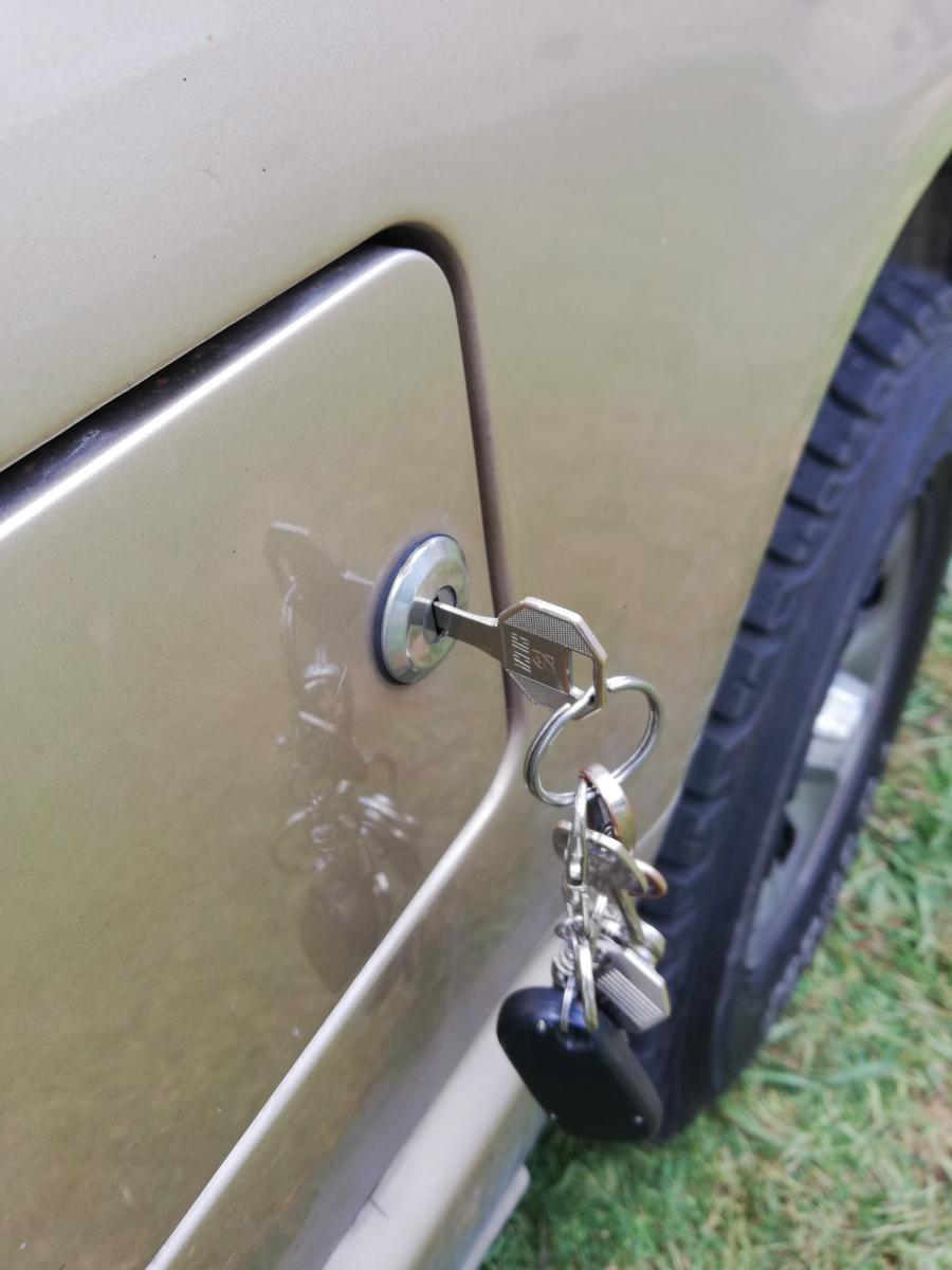

    Or get a spare door lock and make one of these
    I like that second option. So did you get a generic door lock and have it matched to the key? And then, just drilled a hole on the door?
    1,219
    I didn't add that one. But here's some photos, I have some replacement locks for this truck, the body is a little shorter. But it's the same deal.
    Possibly 2nd gen locks are longer than 1st?

    Glove box locks were there for some 2nd gen trucks but they are rare. looking in my parts catalog i don't see any locking fuel caps for the US market so it must just be overseas. looking at that picture tortron posted i would say that the fuel door lock is unique to these trucks since the one on my Dodge Conquest is shorter. if someone wanted to have a locking gas tank i would think the easiest way would be to import a factory gas cap and re key it to work with the stock key. the lock cylinder holes aren't completely round they have locking notches stamped into them and if you went with a locking door it would need to either be imported and repainted or using cutting a hole in the original door and re painting the edges to prevent rust. i must say that factory locking gas cap looks solid. most aftermarket locking ones are plastic and are easily defeated and are just useless
