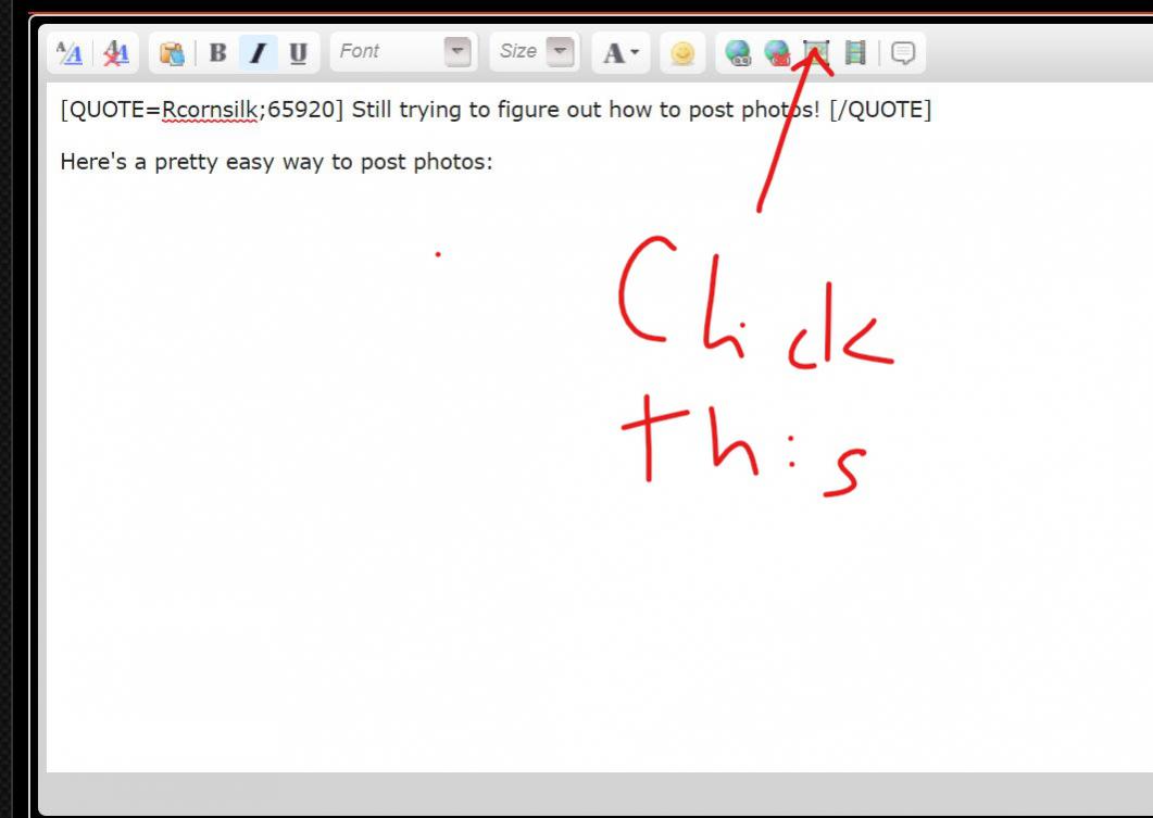

    Here's a pretty easy way to post photos
    Click the photo icon at the top of the page:

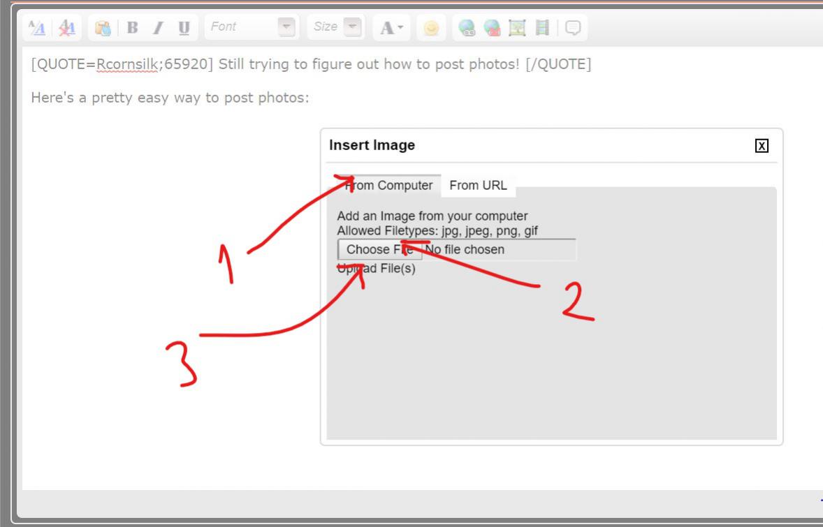

    Then this little dialog box pops up, follow these steps:
    1. click on the "From Computer" tab on the top
    2. click on "Choose File" button and select the photo from your computer
    3. click the "Upload File(s)" button- it will turn red, give it a few seconds, your photo will show up
    Hope that makes sense

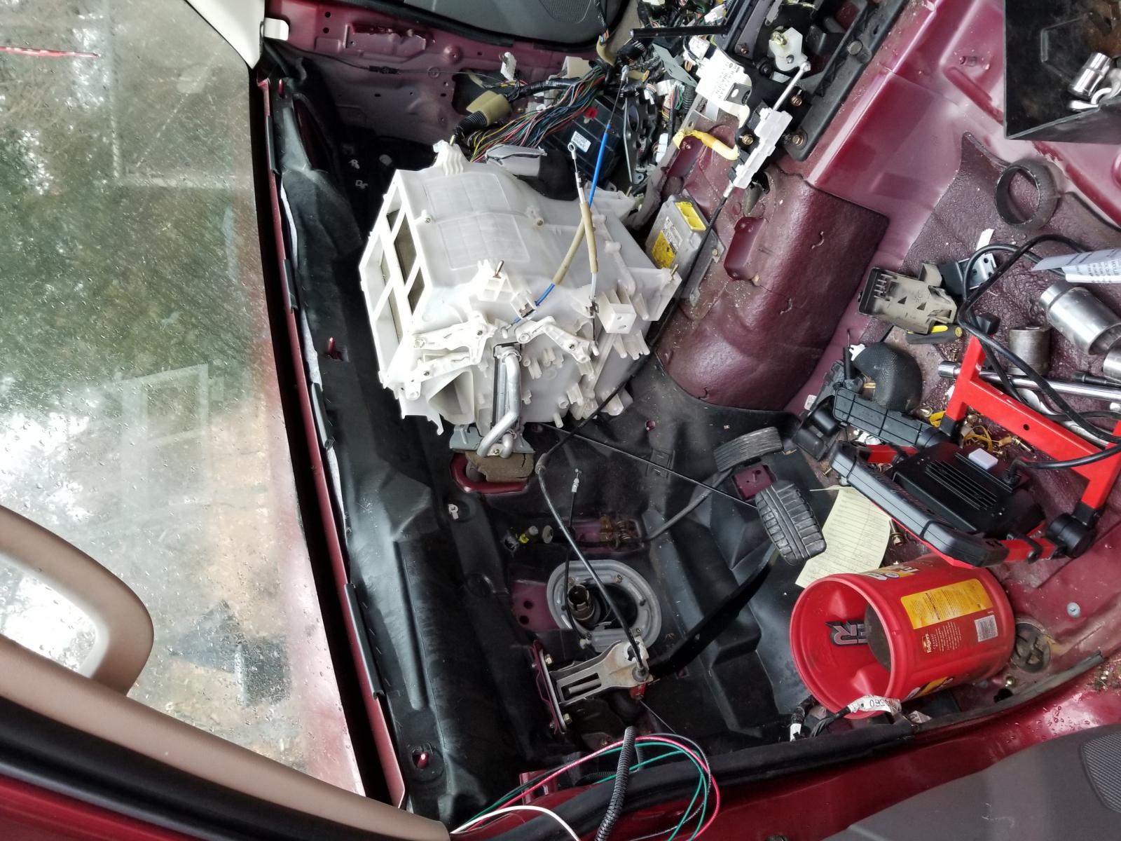

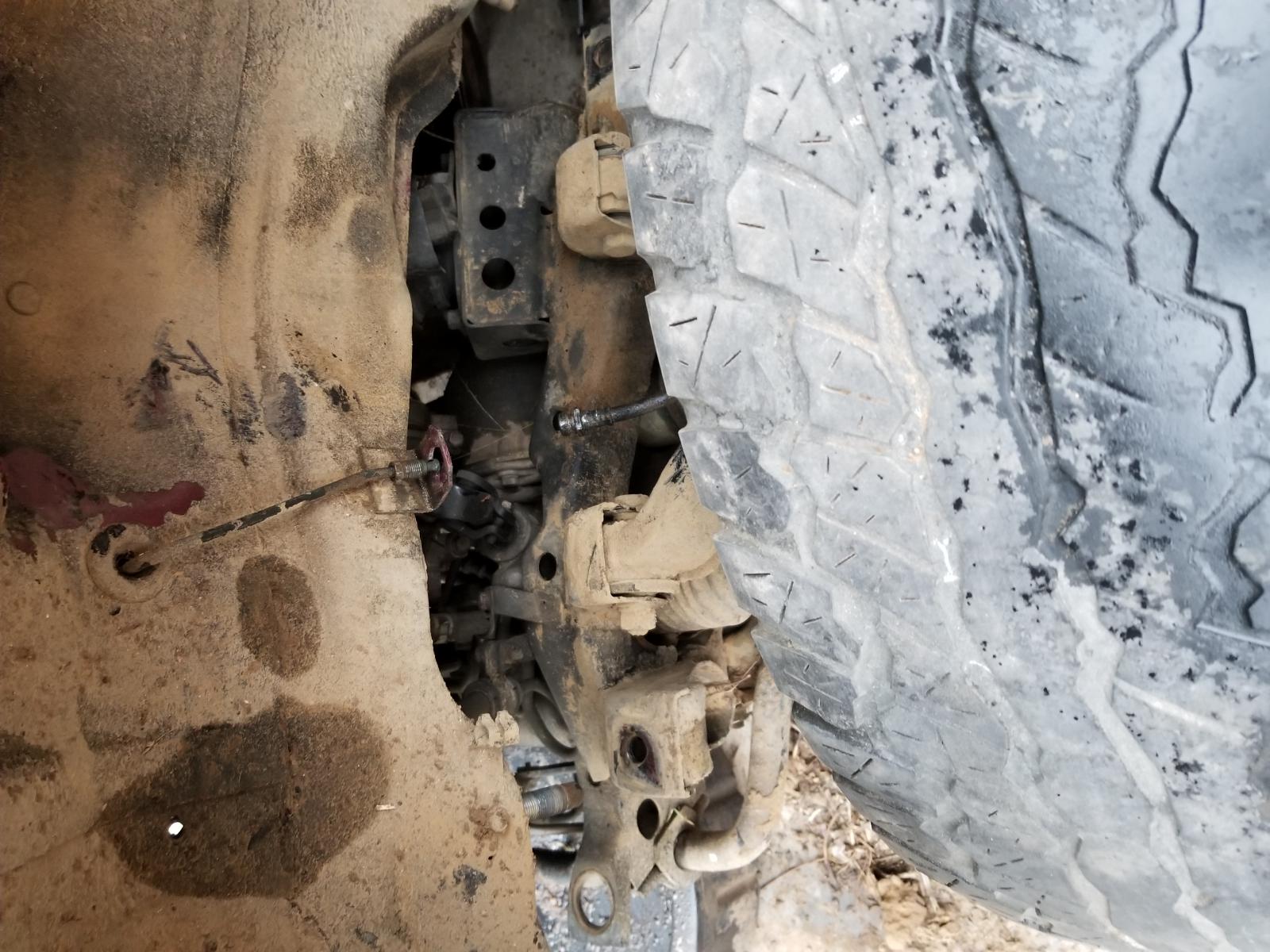

    Have no idea why they rotated,but there's the start I have. Thinking I'm gonna copy an paste the sub frame to the 50....wheels will be around 3" wider than what is on it already,but I think with flares from they guy in UK,and the right offset rims I should be good. Haven't really factored in the lift its gonna give it due to the weight difference, but I think its gonna be for sure different having independent front an back! Again thank you for your input,really loving this forum! Thanks MrPaco for the how to on uploading!

    Ok,I've got problems now! I went to drop the motor in...an it will not even come close to fitting in. The oil pan sits right on top of the front diff. The motor is out of a 4x4, will an oil pan out of a 3.0 be the same bolt pattern? Thanks any responses!

    Thats because the motors and axles sit in different locations between the 3rd gens and 1st gens. You need an oil pan that will clear it. Took me a long while to find the perfect one for our mighty max's. 2003-2006 3.5L Kia Sorento Oil pan and pickup assembly. You're welcome.
