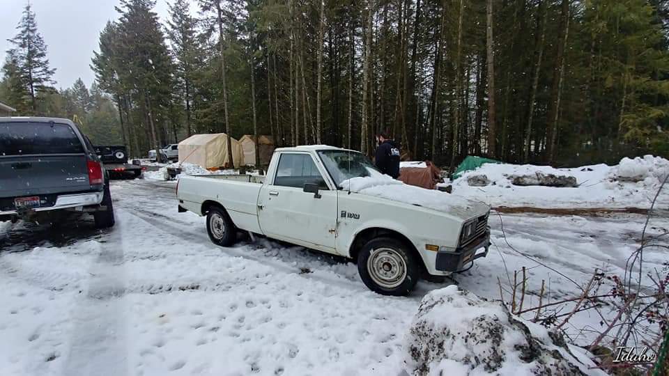

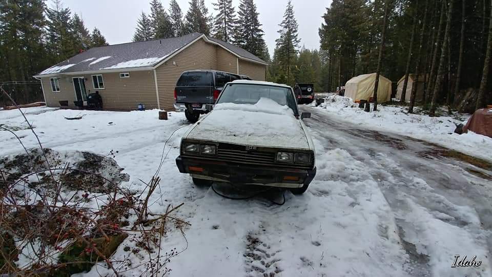

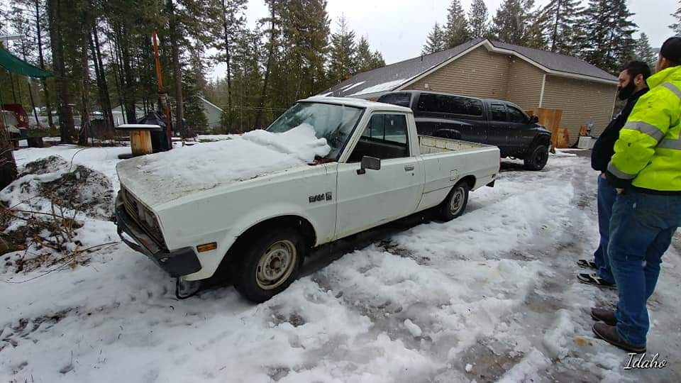

    New member here. Just acquired a 1985 ram 50 2.0 as a project for my stepdaughter that is about to get her license. Se wanted something that we could get running together.
    Currently not running, carb has been removed and has been sitting for a bit.
    Already have the weber conversion kit, actually came with it as well as a timing belt and component kit. And yes it is a real weber kit not the el cheapo.
    Plan is to pull tank and replace, already have a new 1 lined up. At that time I also plan to replace the manual pump with the p4070 elec conversion.
