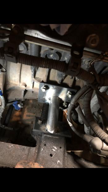

    Ok, I've been gone for a month, but I have excuses and progress. Now for some reason, every time I try to upload pictures the website crashes, so I'll have to try to upload them later.
    First off, I got a link ecu, so I can eventually switch over to ITB's. I'm going to repin the factory harness to the connector for the link.
    Next, I finally made the motor mounts. Somewhat. They're tack welded into place, and I need to add another tube so they're more rigid. They're solid mounts, which I wasn't originally going to make, but was much easier to do.
    I'll try to get pictures up later, but that's all for now

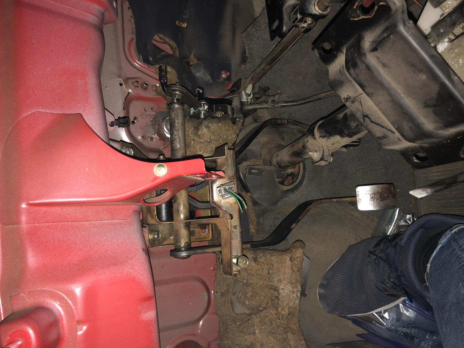

    Also, the J160 has a hydraulic throwout, and of course our pedals are for cable. It took a bit of trying and about 25 trips to the parts store, but it finally works.
    03-02-2019
    166
    Connectisuck, New England
    1991 Mitsubishi L200
    Quote Originally Posted by mcant99 View Post
    Dude the 4wd Max's/Montero's had hydro clutches, u shuda just swapped in a 4wd clutch master & pedal
    I think the spot is blank to the left of the booster on ur 2wd models.....
    Long as you sorted it out is what matters, but that is a funny spot to see the clutch master on a LHD setup
