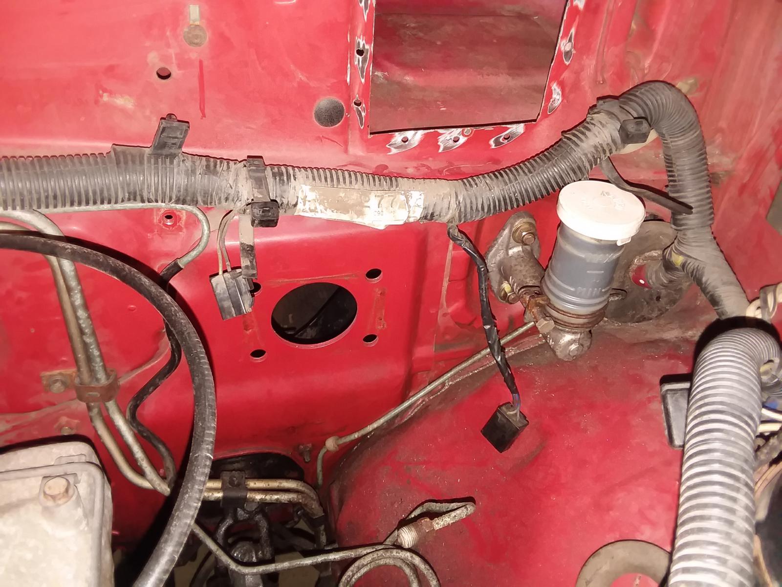

    Quote Originally Posted by mcant99 View Post
    Also, the J160 has a hydraulic throwout, and of course our pedals are for cable. It took a bit of trying and about 25 trips to the parts store, but it finally works.
    Attachment 22304
    Attachment 22305
    Attachment 22306
    Attachment 22307
    Dude the 4wd Max's/Montero's had hydro clutches, u shuda just swapped in a 4wd clutch master & pedal
    I think the spot is blank to the left of the booster on ur 2wd models.....
    Long as you sorted it out is what matters, but that is a funny spot to see the clutch master on a LHD setup
  4. #29
    03-02-2019
    166
    Connectisuck, New England
    1991 Mitsubishi L200
    this is the OEM 4wd setup. im willing to be the fittings are prob the same too...
    just for future reference
  5. #30
    03-17-2018
    19
    Middletown, CT
    1995 Mitsubishi Mighty Max
    I saw that the 4x4's did, but couldn't really source any part numbers for the master cylinder or the different pedals, but if you have them i'd definitely rock that over what I slapped together.

  6. #31
    03-02-2019
    166
    unfortunately I don't have an extra clutch pedal assembly, I know they are all over eBay tho.
    If I had the paper I'd order one from the UK for my truck and give you mine, but I'm strapped & imma
    hafta mod mine to work....
