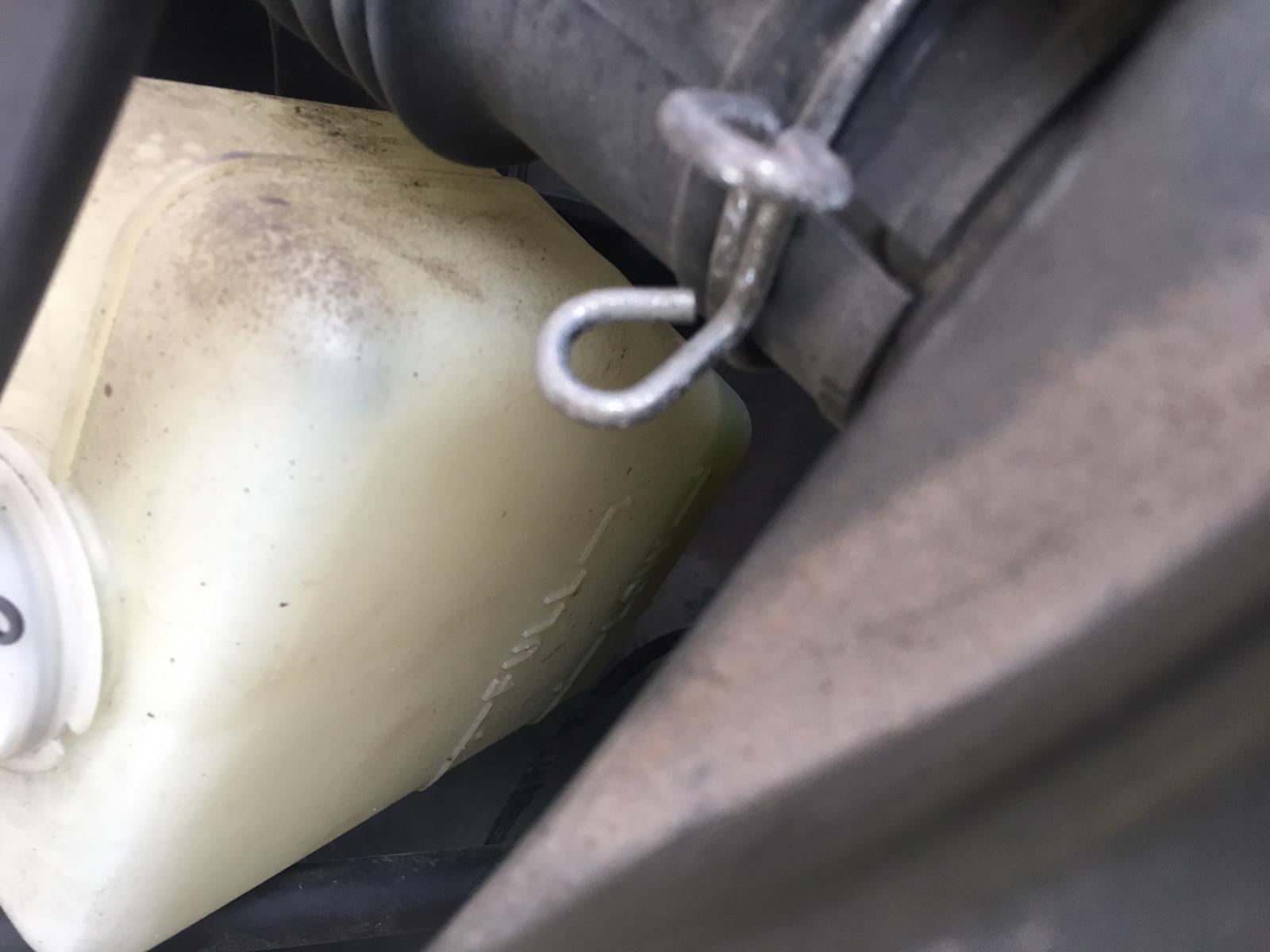

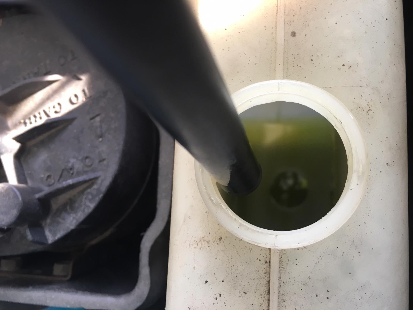

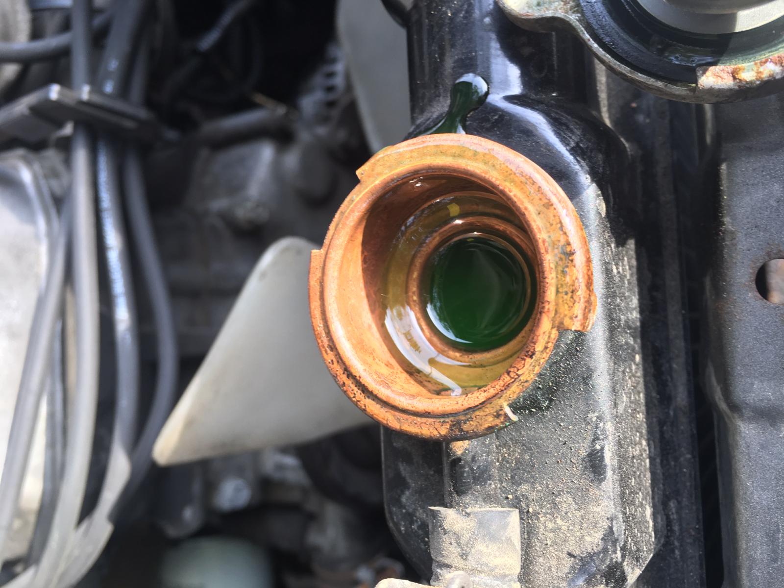

    I checked the coolant, and it looks ok.
    Here's the radiator cap off
    And here's the coolant tank, looks like the level is on the low end, but still above the LOW line

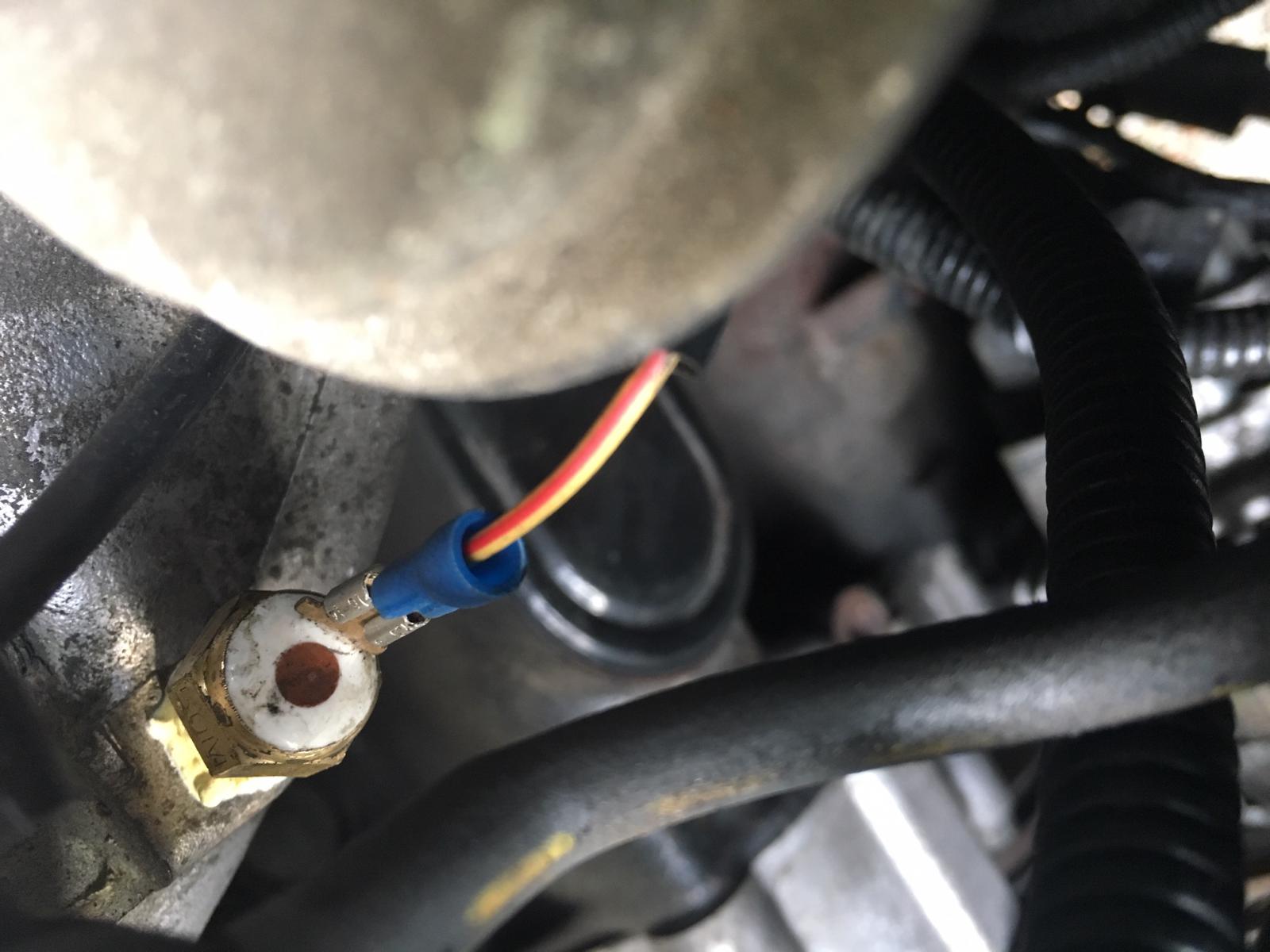

    And here's the new temperature sensor, which seems to be connected
    So if the coolant level is fine, and the sensor is connected, could it be that the (new) sensor is faulty? Or could the gauge be faulty?
    Something's obviously not right, but is there any danger that the engine might be overheating if the sensor is not reading the temperature correctly?
    My understanding of how this works is that the cooling to the engine is controlled by the thermostat, and that temperature sensor is just there to give a reading, though the gauge. Is this right, or does the temperature sensor has something to do with the temperature control of the engine as well?
    Could the thermostat have anything to do with this issue?
    Is it safe to drive right now?

    You want the single blade sensor. The Mitsubishi P/N is MD091056 according to my old parts book. Should be the same or work for the Ram 50. The two blade sensor sends info to the computer controlling the Mikuni carb, not the temp gauge.

    pennyman1 and others are definitely correct. The shop installed a sensor/switch (no/off). You need a gauge sensor (hi/low). Have them fix it or get your money back and fix it yourself. With a different gauge sensor, if the gauge still registers low, the next one to accuse in this line-up of suspects is the thermostat. It may be stuck open or rated too low. The correct rating is between 190 and 195 degrees.

    Does the on/off O/D sensor have one blade like the gauge sensor? Do they look the same, other than maybe a different part number?
    The sensor that is on right now, the one that is reading funny, has one blade.

    Both types have a single blade. Depending on the manufacturer, they may otherwise look similar. I have no experience with the O/D switch except in ads and I wouldn’t trust their accuracy. The P/N is best whenever possible. You’ve done a thorough investigation so you’ll very likely get the right part. The shop was too busy to make sure they got and installed right part.
