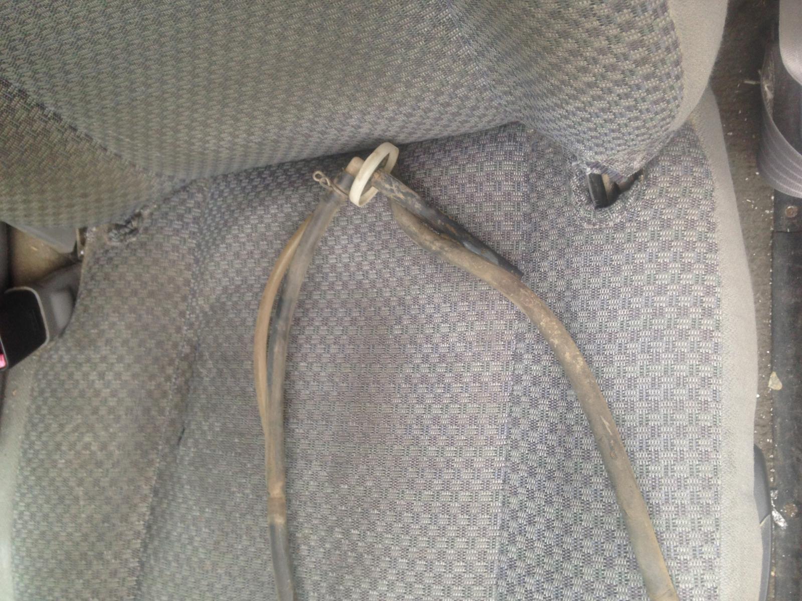

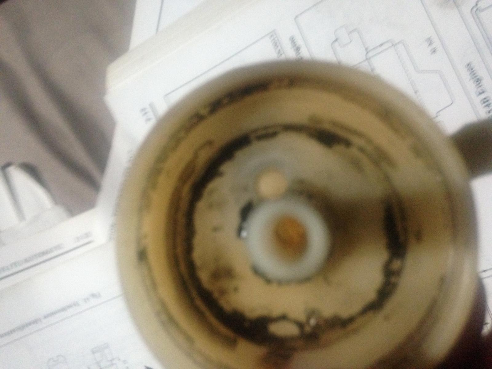

    EDIT: Okay, I understand the vacuum thing - drawing from the reservoir back into the system. Are the hoses to the reservoir old?
    There's a small diaphragm in the top of the radiator overflow return. If it's funky, it won't seal up the bypass port and the radiator won't be able to draw coolant back into the return. If the whole tank is looking rough, might be time for a new one...

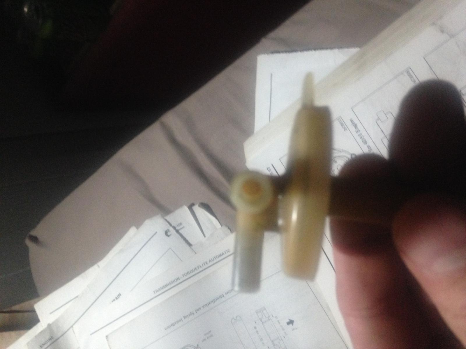

    Thank you geezer! Are you talking about the cap? I took the time today to check the reservoir hose, as royster suggested, seems to be "okay" but does look aged, going to replace. And looked for what you could have been talking about. Are you talking about the cap?
    Do do I just try and find a universal overflow tank that has a similar setup?

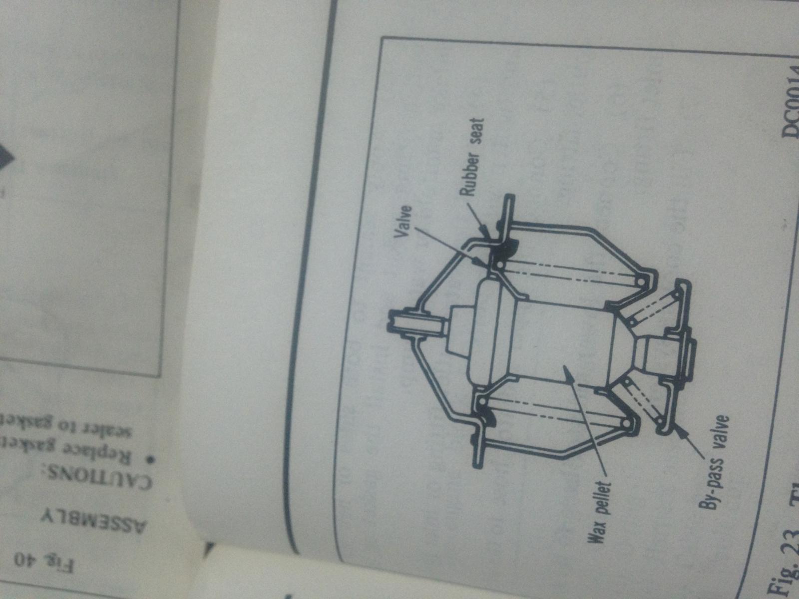

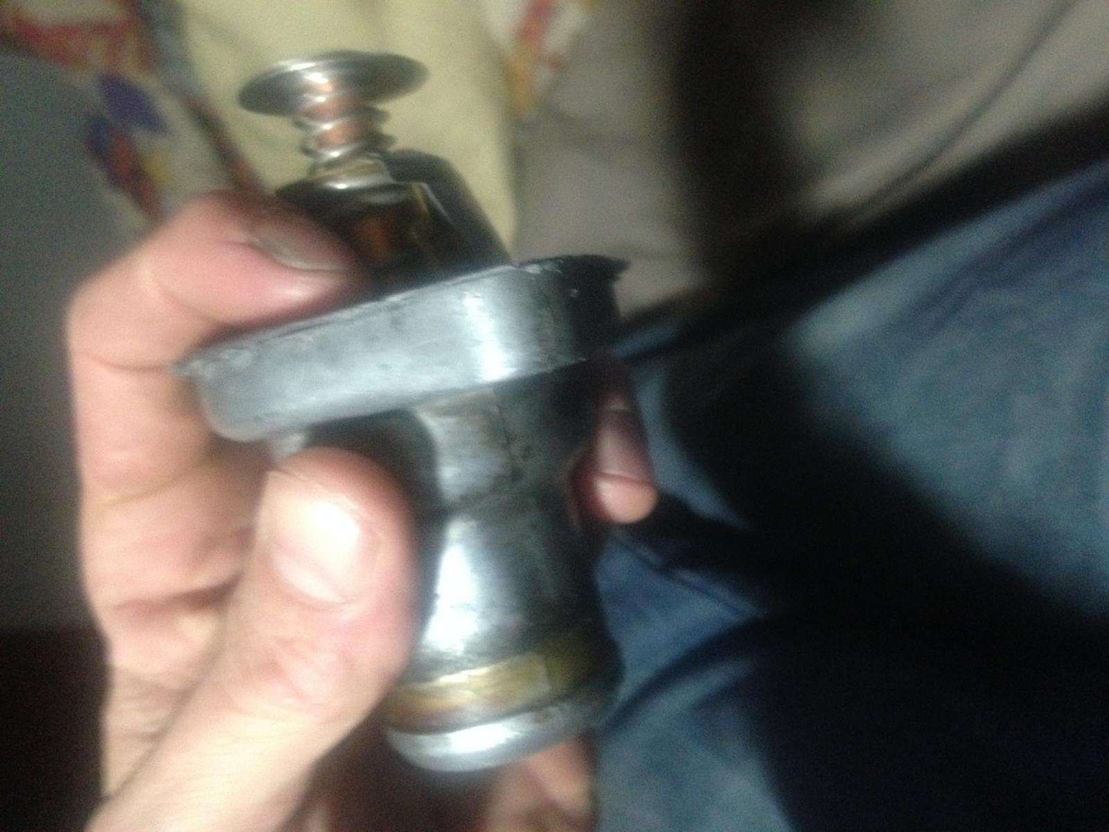

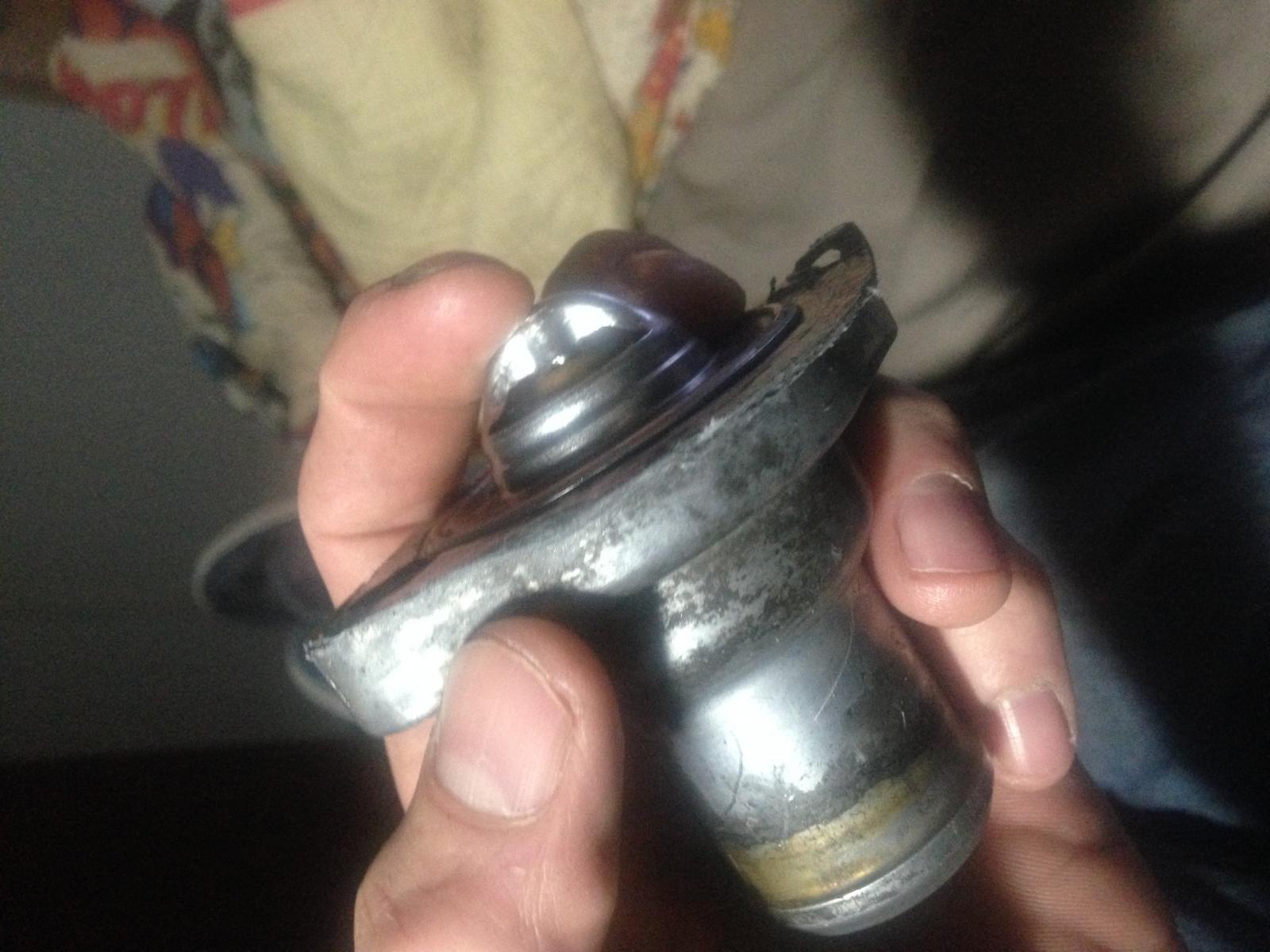

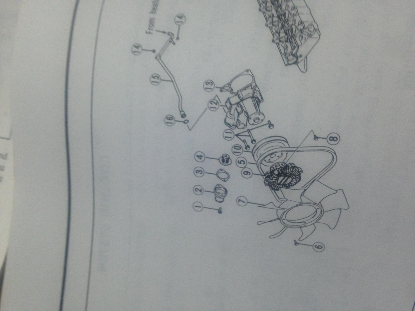

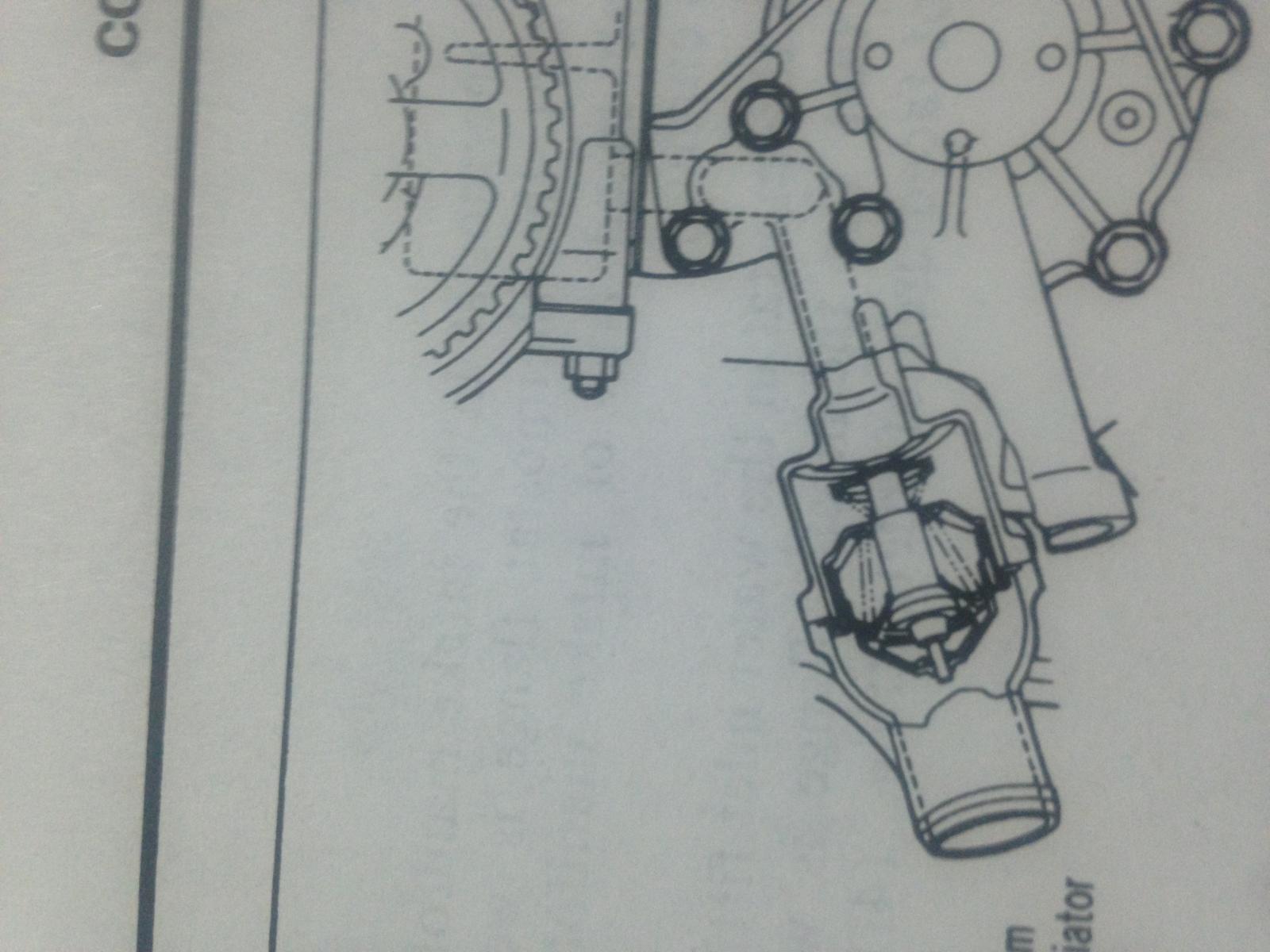

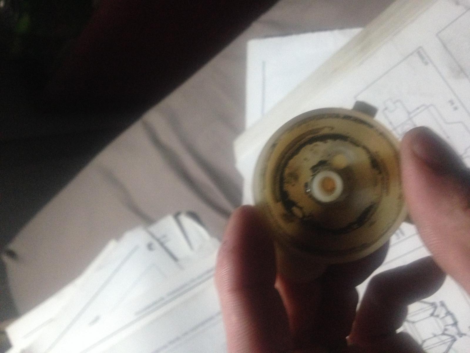

    Well, it's cold here today, but before dark I was able to warm up the truck, flush the fluid, and went ahead and took off the thermostat after I got home.
    Note the picture of the thermostat itself. It looks nothing like a normal thermostat.
    That cap should have a rubber gasket (diaphragm) in it.
    Yeah that picture in your post (#3) is what a normal thermostat would look like - but it's a cross sectioned image. It would have a tensioner spring around the body of the wax pellet. And that black stuff in your overflow tank cap is all that's left of the diaphragm that Brad was talking about. Either find a decent overflow from a JY or one in the magical land of ebay...

    Awesome. Started calling salvages, no luck, going to have to go in person to the pick and pull that I know has a couple of these trucks tomorrow. I found these on eBay, they look close, what do you guys think?

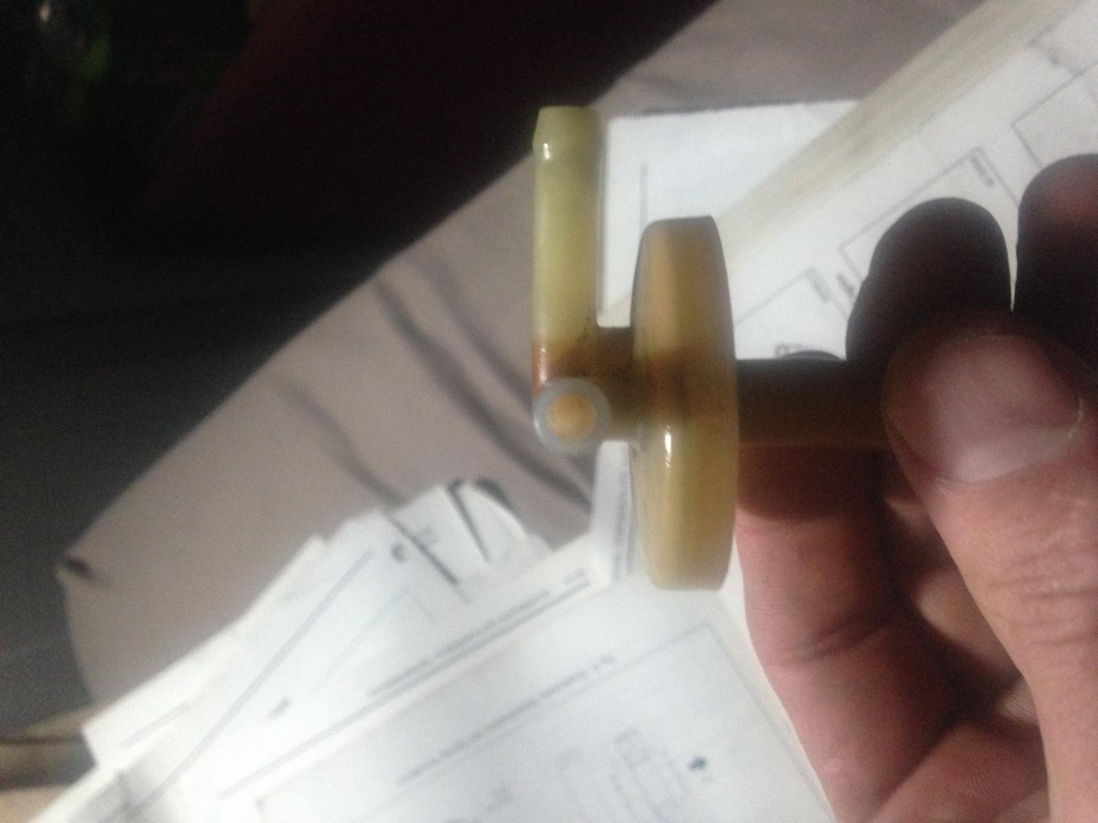

    Just popping in here, first off there isnt normally a gasket on the overflow tank since it doesnt need to be sealed.
    On your tanks cap, there should be a hose coming off the bottom that drops down into the tank, i do not see it in your pic. Did you remove it for pic or not have one?
    Next, thermostat should be installed as pic #1
    Finally, if after fully warmed up, you have bubbles blowing into the radiator or overflow, you likely have a leaking headgasket or cracked head.
    The heads tend to crack between the injector boss to valve and leaks compression into the cooling system.
    Shame you started putting that garbage leak fixer stuff in, really gums things up

    I do have the hose that goes into the fluid of the reservoir.
    working on flushing that crap out.
    I have suspected a head gasket leak in the combustion the whole time.
    going to get some more flush product, follow royster's lead, remove the radiator and flush and back flush, get some hose to replace that reservoir hose, still going to follow geezer's advice and find a replacement cap and reservoir, but I did some reading and a leak in the system would cause the return hose to collapse and not pull fluid into the system. If it's a combustion breach, it pulls fumes from the breach when the system swells.
    After cleaning it up again I will install another new thermostat and cap, new hose to the reservoir, inside the reservoir, and hopefully find a cap tomorrow. See what happens. If it's still not right I have an appointment Wednesday with a shop to do a pressure test and a dye test to confirm the head gasket issue. I really appreciate all the input, from everyone.

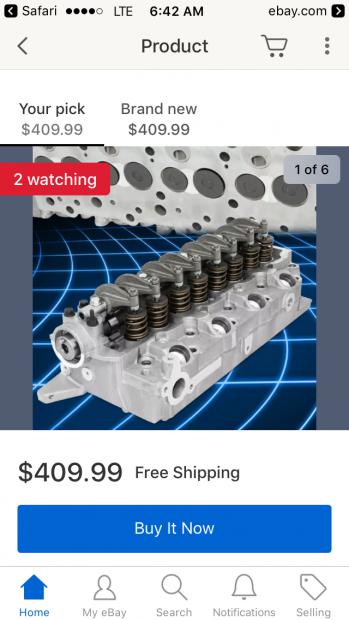

    Well, I got the new reservoir cap on, and a new radiator cap, bubbles galore, ran it open as well and now it's just continuos bubbles. It's a head breach, gotta be, at this point. Started breaking it down yesterday, had to get some tools, a flexible extension, and swivel for getting to the harder bolts and a socket driven Allen set. Got the radiator off and started cleaning it hard core. Still getting sealant out, I'm giving it a once over then taking it to a radiator shop to get all the love they can give it.
    I should have the head off today, confirm if it's a gasket or a crack. I've got a gasket, but I am considering doing the 56 swap anyway, reading on here, it is quieter and maybe better?
    this is the right head by your guess? And the ARP bolt numbers in the diesel section are what I want as well?
    01-18-2015
    250
    Inwood WV
    1991 Mitsubishi L200
    4D56-T
    if you order ARP you are looking at a 2ish week wait, and i think it was $430 for everything lol. I will say i liked the arp better lol
    Head wise, the d55 and d56 head are the same, the only difference is the cam and rockers.
