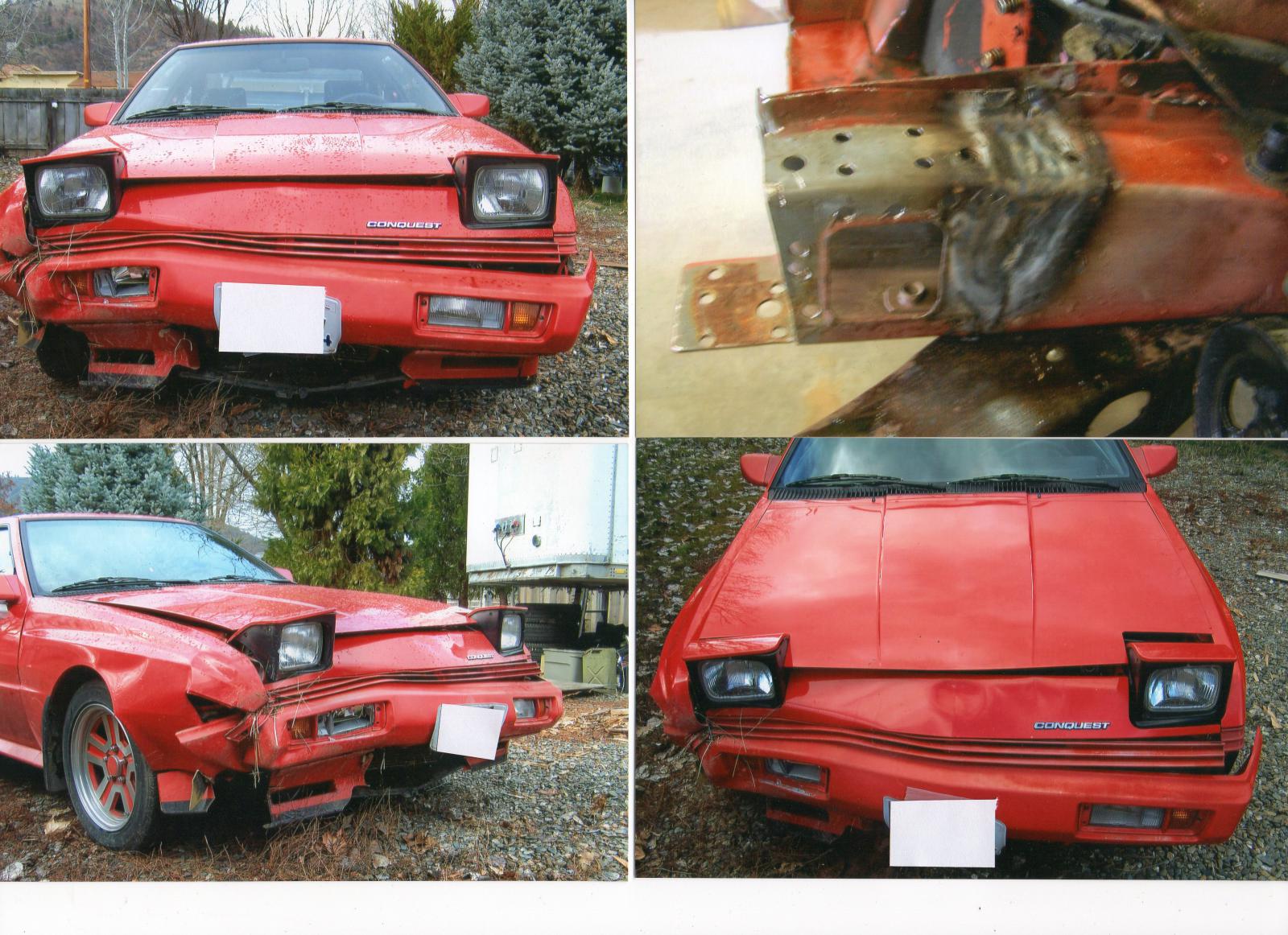

    I highly agree with this! Back in high school I had worked a summer job 2-3 years saving up for my dream car, a starquest, I finally saved up to buy one and traveled out of state to acquire this dream car of mine. It took me many months and disappointing times of calling on ads only to have the car sell within hours of its posting. well I went to the bank to get the money to go buy the car out of state hoping that the 1 or 2 other people looking to buy it before me would flake out. When I was in the bank getting the money the lady at the counter asked me what kind of car I had saved up for. when I told her she said she used to have one and absolutely loved it...until her boyfriend went and raced it and blew up the engine. after that my family went up to Portland Oregon to buy this car and we lucked out in that the other parties didn't buy it so I did! the guy I bought it from, the original owner warned me that it was a tail happy car. later that night we stopped at a motel with the car on the trailer in front of the lobby. the guy at the desk came out and said it was the same car he was looking at to buy but didn't for some reason I cant remember but he said his dad owned one when he was a kid but said his sisters boyfriend stole it and wrapped it around a pole! I should have gotten the message by now!
    fast forward a while and after I had replaced the bad clutch that the car needed when I bought it and had some miles under my belt both driving normally and crazy, a close friend of mine went driving one night and I decided for some reason that I should show off. I was approaching a corner that seemed much wider than I had thought and decided to punch it in 3rd and send the car sideways around the turn and before I knew it I had screwed up big time! the car went too far and I had the wheels locked in the opposite direction when the back end decided to grab and send the car right into an rock embankment.
    All that hard work was gone in a second. I was in a pretty hard spot in my life and it nearly put me over the edge. I regrouped and lucked out and found an identical parts car and went to work. over 200 hours later I found myself with a car that was never quite the same. I hope to eventually fix it the right way but thats besides the point. had things gone differently me or my friend could have been seriously hurt or even killed. sure I only hit the wall at about 30-35mph but the car almost rolled and had it hit differently the force could have been more head on and really hurt us more. I had neck issues for the next few years after that but had things happened differently it could have been worse. I learned that as fun as driving is you never really understand how wrong things can go when they do.
    as to the modding of your truck its yours and you can do as you please of course, but try to avoid anything permanent because your tastes will change. When I got my truck at age 14 I did all kinds of mods that I came to regret later and took a lot of work to change later. I painted my dash black and it was a nightmare to fix which eventually required replacing with a donor, I cut holes in the door panels for some cheapo walmart speakers that I then realized kept the windows from opening all the way. I learned more about speakers and found some quality ones that fit in the stock location that sounded way better. Im sure there are a million things I have done only to regret later but luckily none involved any cutting metal on the body or anything too permanent. my advice is if you modify anything keep the original part and if you have to cut up a part try to use a donor part to use if possible and when it comes to aftermarket radios use an adapter harness, its a million times nicer that cutting up the stock wiring and you'l thank me when you go to replace it in the future hope all this saves you (or anyone else reading this) some future grief
