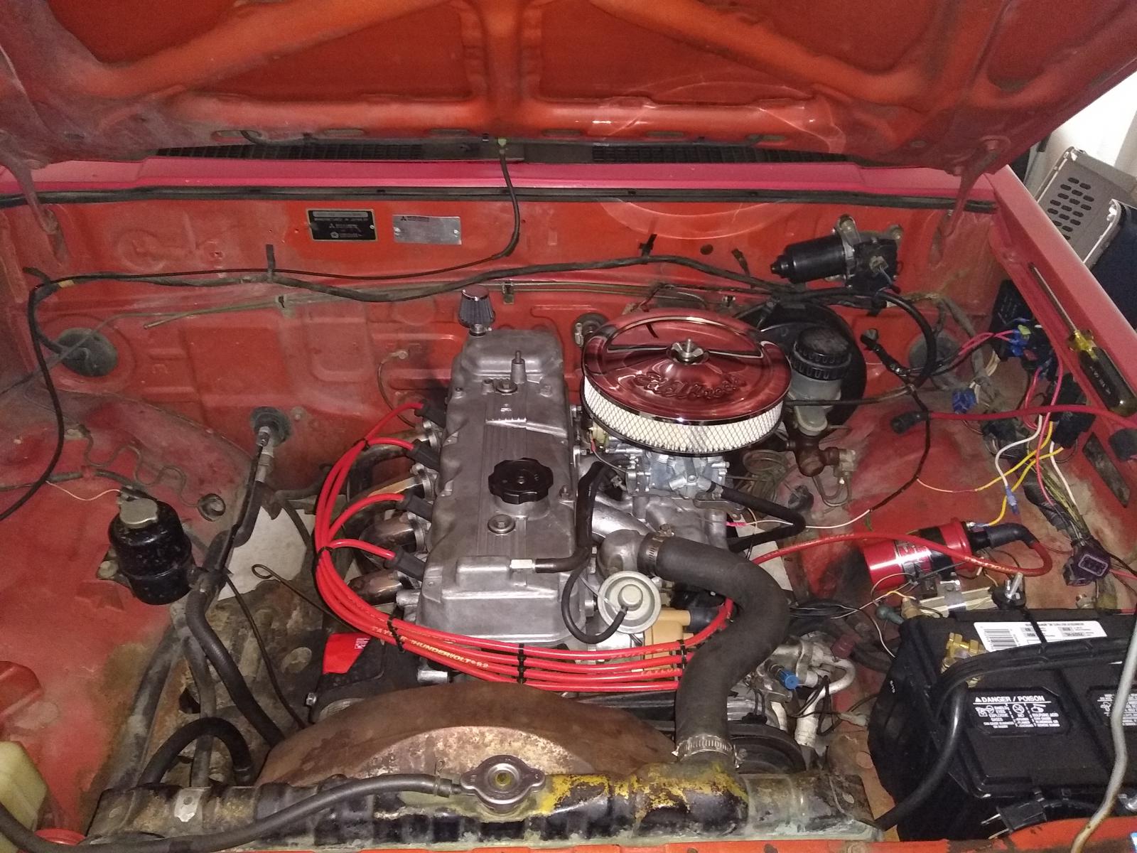

    Got the adapter on (with a little modification) and a 10" round air cleaner (with a little more modification)
    I had to file the K&N brand adapter just to get it to fit onto the Weber, and I used the original mikuni carburetor's air cleaner stud with the adapter's bracket.
    I know the air cleaner says Edelbrock, but that was the only one I could get on short notice.
    I put the longer coil wire on it, but I haven't gotten to replacing the brake hoses because I'm soaking all the connections in the special sauce just to avoid potentially ruining the hard lines.
    Today I'm working on figuring out the A/C wiring, and I might get around to doing the brake lines. Maybe.
