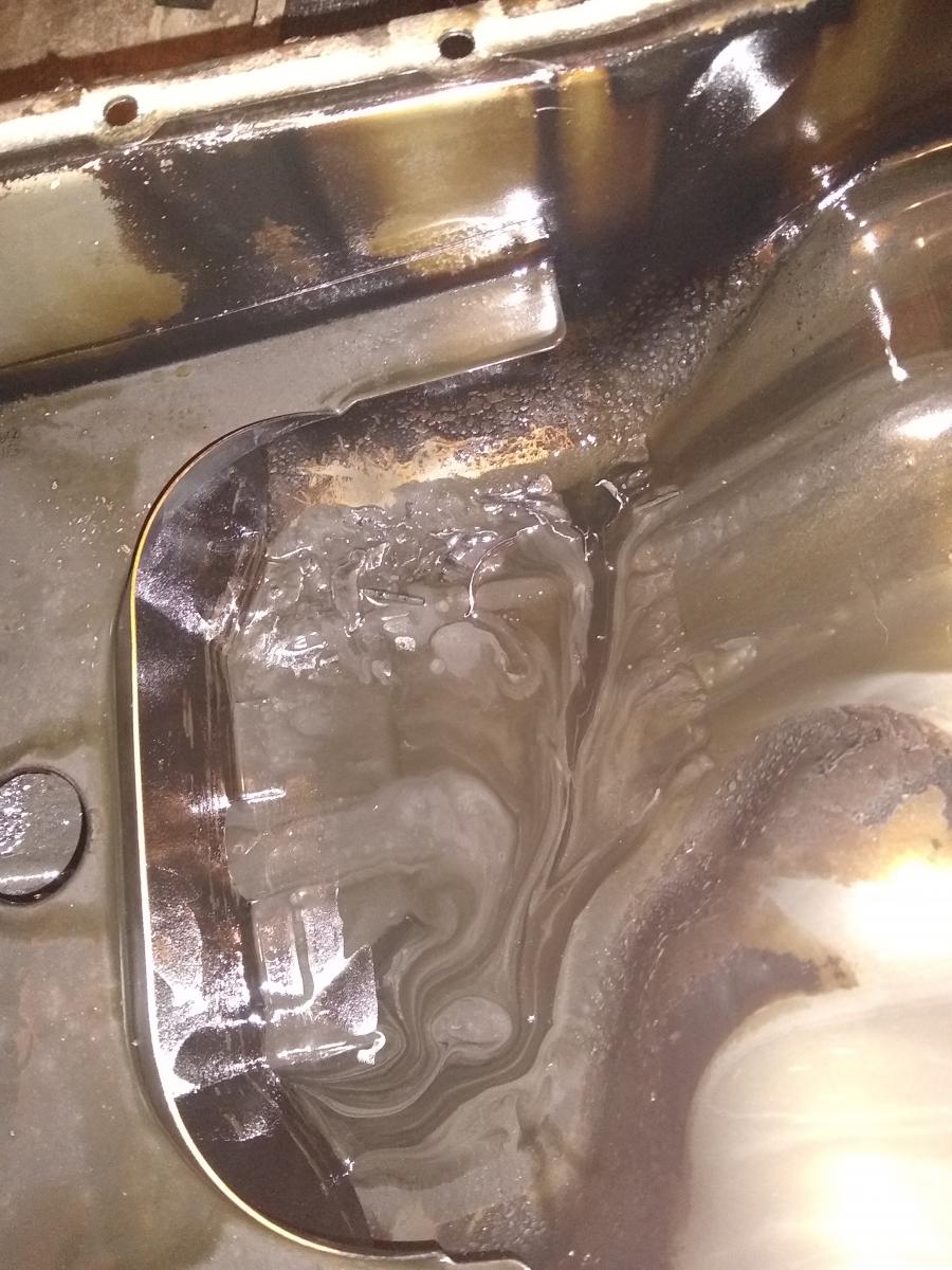

    Got the oil pan off, and found out what went wrong...

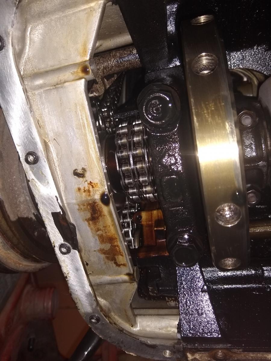

    Floppy chain.
    I'm going to say that chunk of metal looks like a bearing that fell out and got caught in the chain... and destruction ensued.

    The sketch level here isn't as high as I would like.
    I still have to get the engine fully out and get it taken apart, but I've made progress and I'm claiming it as a win.

    It would take catastrophic damage to the engine for a bearing to make it's way out of a journal. Could be from a balance shaft? When they fail you get a huge drop in oil pressure which sort of follows what you experienced.

    That's what I'm thinking, that it's a balance shaft bearing. Above that bearing there's a piece of the chain sitting in the pan...
  15. #290
    4,762
    ...and all of the shiny mud in the sump are bits of cast aluminium from the timing cover as it got ground off by the chain. The question will be - delete or not delete the shafts? There's a good chance that at least one of the balance shafts is chewed up as a result of the bearing failure (my money is on the exhaust side)
