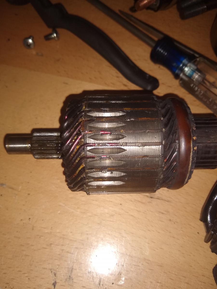

    Starter melted.
    I have another armature and set of brushes, but I'm gonna have to re-solder the brush holder in order to make it work.
    I looked online, but none of the local parts stores have starter brushes in stock.
    It seems that, for whatever reason, I am particularly rough on starters. I don't know if it's something I'm doing wrong, or I just have terrible luck.
    At least I know how to fix the things I break.

    eek! That starter let the smoke out for sure. Long periods of cranking drastically shorten the life of starters. They can't dissipate the heat fast enough. I'd spring for a new one if you can. The insulation on the windings of the armature might not be much longer for this world.

    As for the starter armature, I swapped the burnt one out for a spare I had. Eventually I'll be able to afford a new starter...
