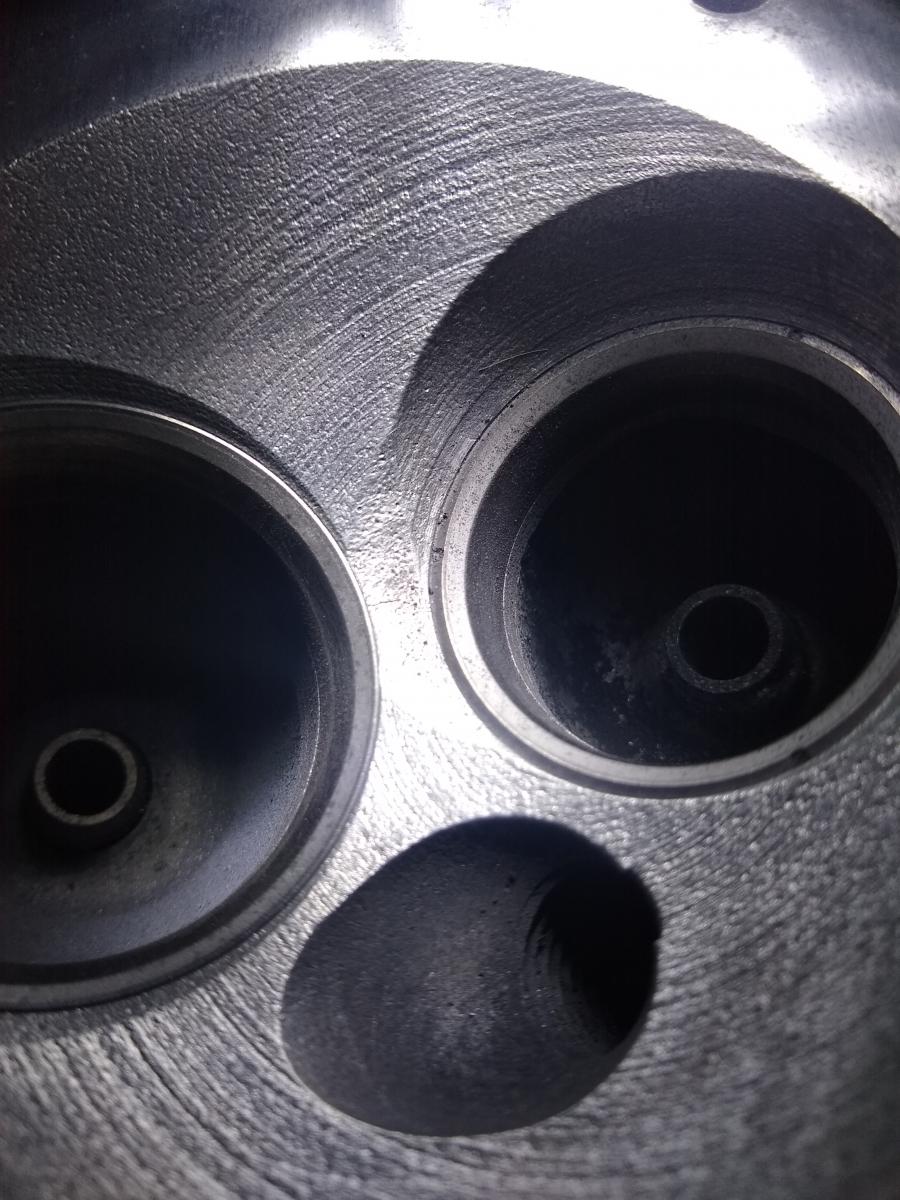

In other news, I found a problem...
It's not the greatest picture, but that's a crack between the valve seats, and all of the work I've done to this head is all for naught.
I'm thinking I'll order a new one from Engine Machine Services, they have the best price I've found so far.
			Doctorates Degree
							Oh damn. Kind of a sore point but this is the reason why I get my heads pressure tested. Not worth putting through a shop to get welded up?
			Senior
							With everything that I would want to have the shop fix, it's cheaper to just get a new head...
The good part is that I emailed Randy from EMS (Also known as Dad on starquestclub) and he's tossing a couple of goodies in the box with the head just for good measure.
I did ask about a military discount, he doesn't offer a discount on parts but he's hooking me up with some free stuff anyways. I hope I get a few stickers.
			Associates Degree
							Exactly where mine cracked, and where I purchased my new one. I got the HD valve springs and stainless undercut stem valves while I was at it. Randy is a great guy, extremely knowledgeable about these engines, and has really good prices too. One thing to note, I had to find an old stock Melling cam on E-bay for my new head. My cam was a bit scored and I wanted to replace it. All of the cams I could find at the parts suppliers were .020" over on the bearings. The new heads are bored for a stock diameter cam.
