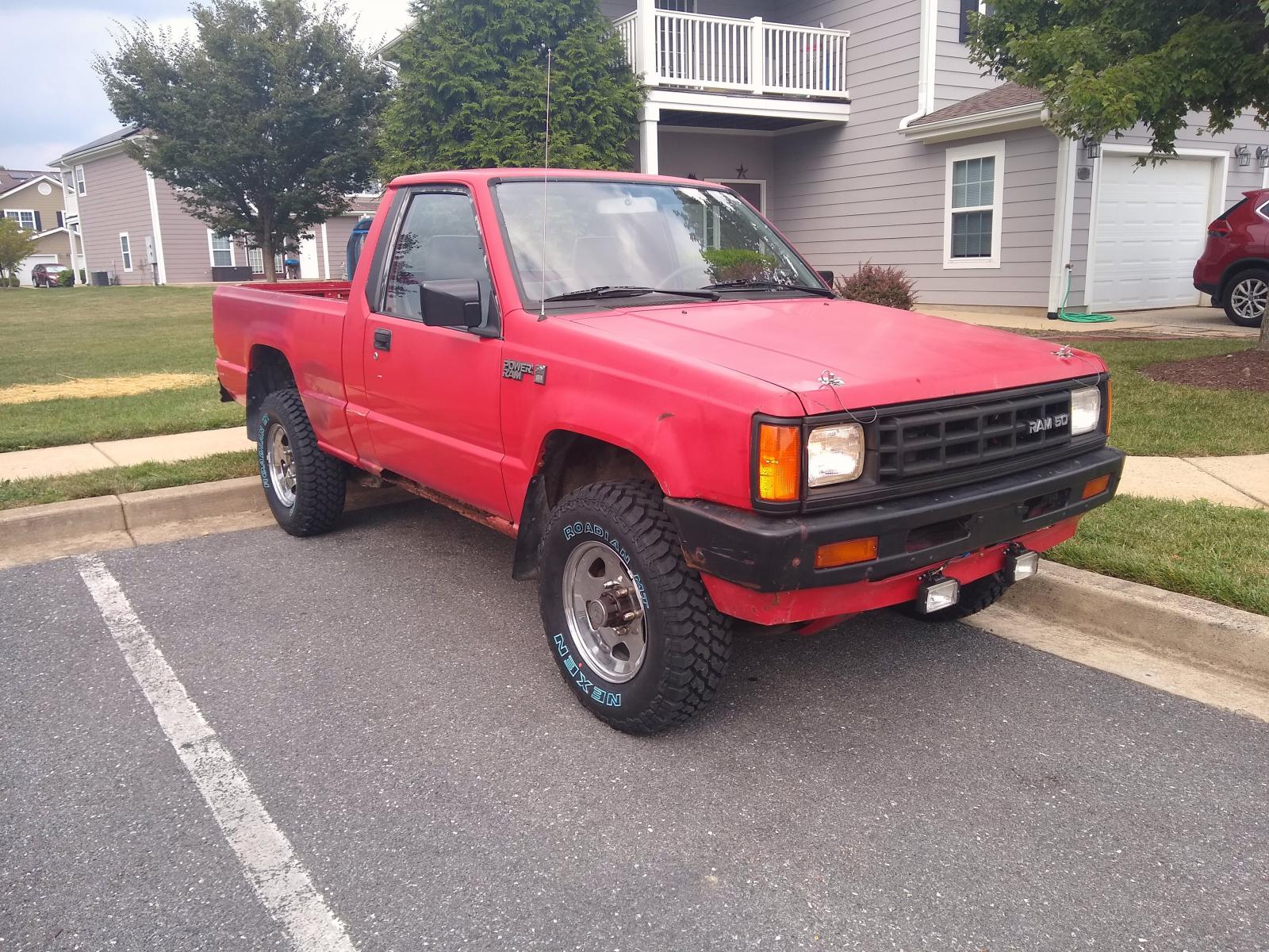

    New meats on the truck.
    It took a little while, but I'm starting to get much better at driving it. Practice, practice, practice...
    I got the new drums yesterday, I'm going to fog them black before putting them on the truck. I'll be ordering the hoses soon, just have to wait for certain bills to come out first.
    I temporarily fixed the temporary fuel tank strap I made, the two screws I used before had started to strip out so I just drilled a hole and put a bolt in. I'm going to actually fix it eventually, but for right now it'll hold.
    I changed the oil, because it was already almost completely black. I'm going to keep an eye on it and I'll change it one more time once it's turned black again. After that I'll just change it at regular intervals.
    I'm just going to keep crossing things off the list.
