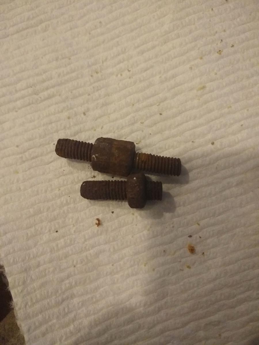

    So this happened...
    Third time pulling the parking brake lever, I heard two pops and parts fell out. Both rear parking brake cables snapped at the lever, I tried pulling them out when I first got the truck but I couldn't get the nuts to budge and left it until I had new cables... guess I'm getting new cables sooner than I expected. I will be using a chock block until I fix it, I know what happens if you don't have a parking brake. lol
    I also realized how dumb I am, I thought the firing order was 1,2,3,4 because of the Haynes manual, but I apparently can't read. Or look it up on here, or anywhere else on the internet...
    I feel really effin stupid.
